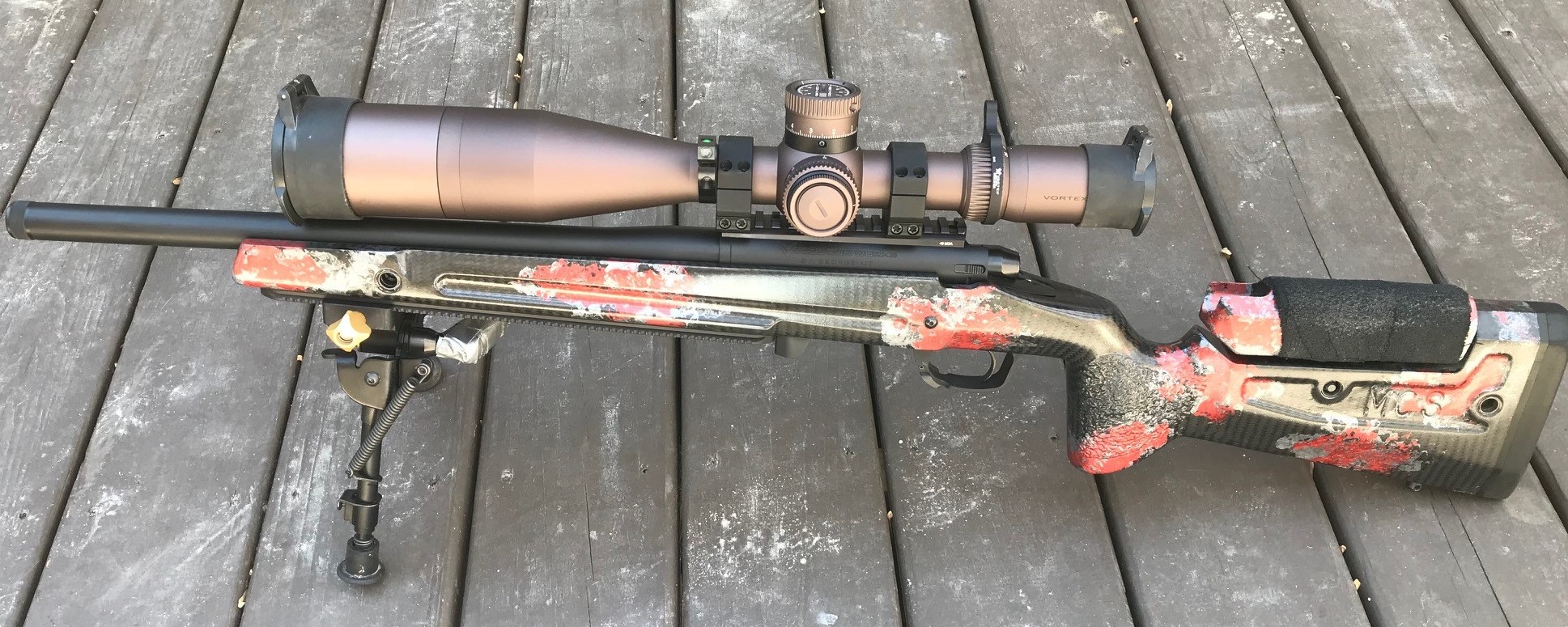

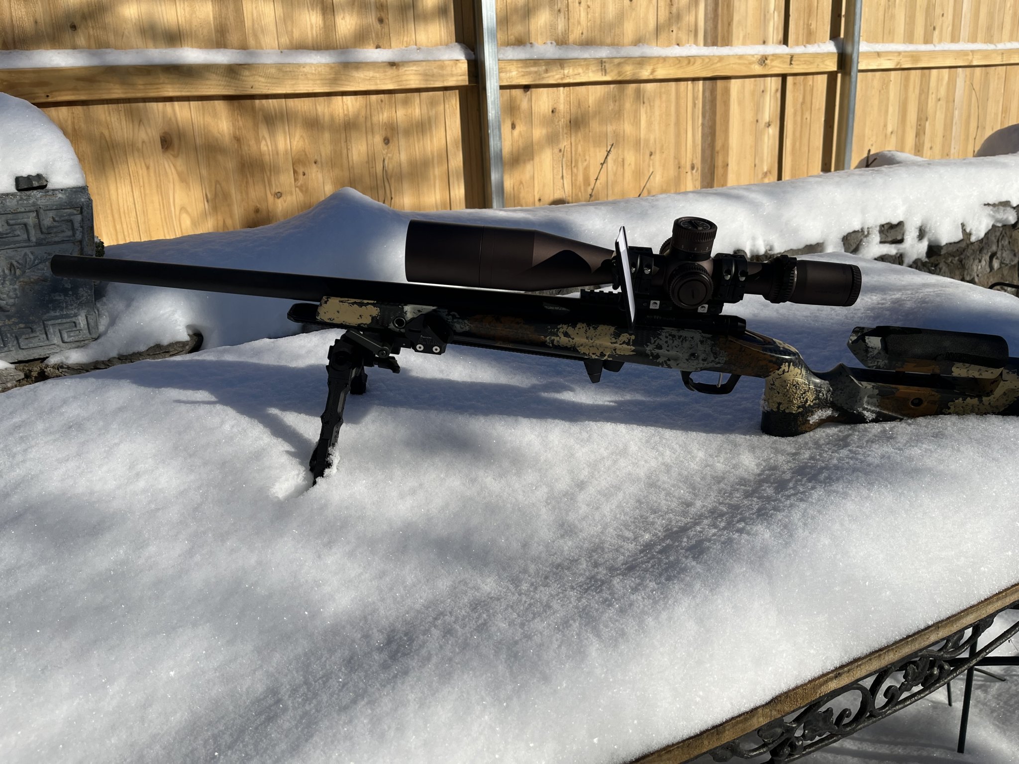

Accuracy International AT-X AICS Long forend, pre-production prototype, Vudoo 360 feeds perfectly, I know of three Vudoos that are being tested. Short forend in the lower pic is a Bergera B14R 18" barrel. If you want your AICS magazines to run every time try the original AICS. Beware of cheep imitations:)

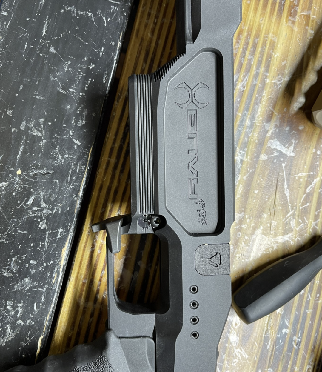

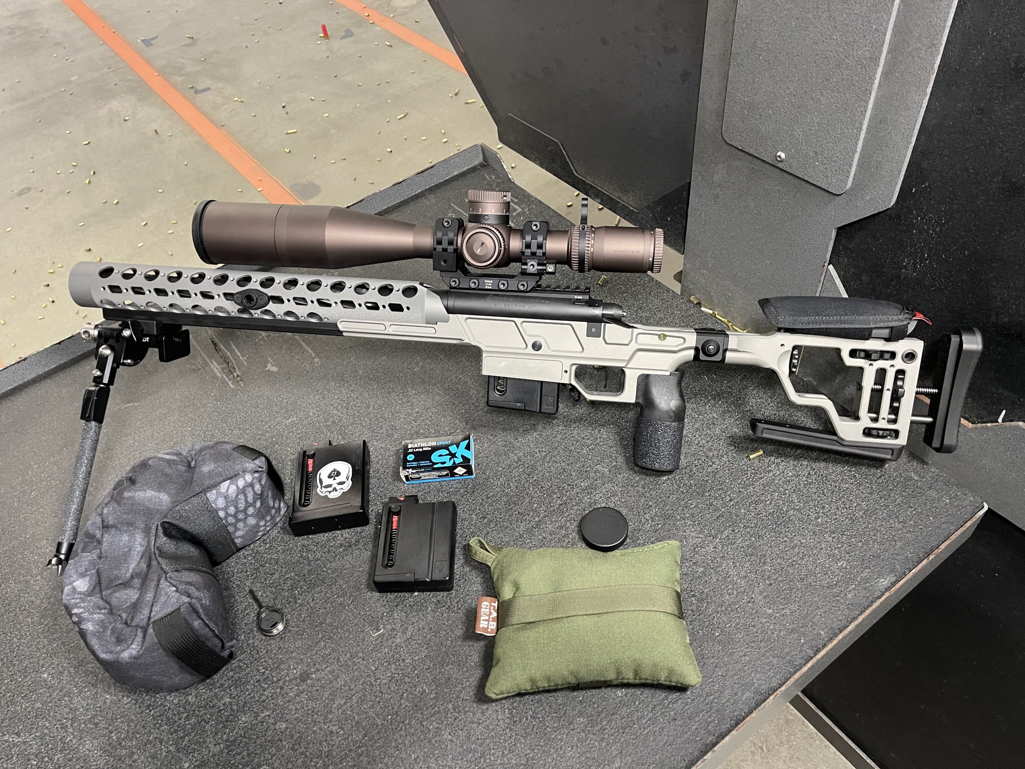

XLR Envy Pro has been my favorite for the Vudoo. MDT ACC also has been consistent across 5 different chassis w/ no modifications. The mag latch on the MDT is perfect.

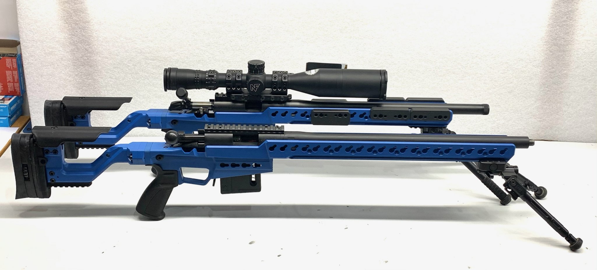

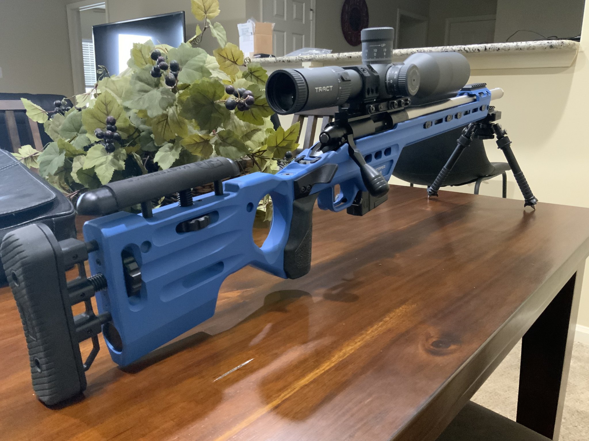

Running mine in a JP APAC chassis. No feed issues with poly or aluminum mags. No adjustments needed.

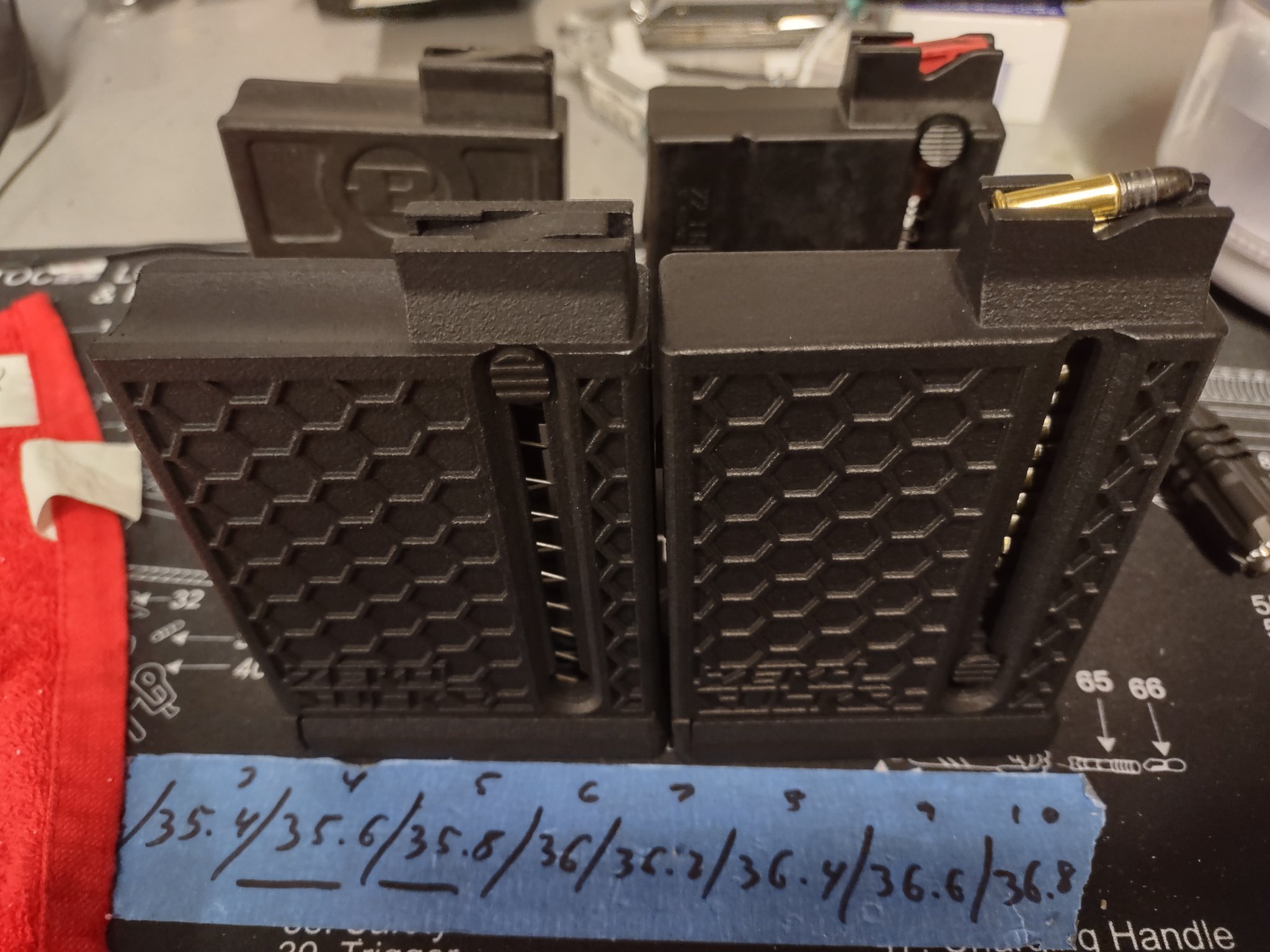

I put tape on the front and back of mag when I used an mpa chassis, solved the problem u are having. Feeding was almost a 100 % with doing that

XLR Envy Pro, feeds all magazines without any adjustments

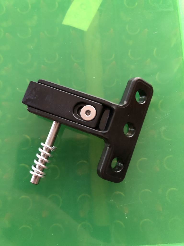

Worked on couple MPAs and resolved feeding issues with mag block and adjustable mag latch.
Just resolved foundation/Hawkins/v22 feeding issues with Hawkins extended mag latch.

My MPA BA Comp chassis feeds just fine - but it required the MPA adjustable mag latch to do so. Is your chassis equipped with one? If not, get with MPA and describe the issue.
If you have any up-down movement in an inserted mag, wailing and gnashing of teeth will probably follow.
Finally, don't confuse misfeeds arising from magazine loading with misfeeds arising from magazine being loose. Vudoo has a video on how to load the mags. If you don't see a staggered column of cartridge noses in the mag, you're likely to experience a misfeed.
Hope this helps.
Hope this helps.

I put a Vudoo three-60 barreled action into an MPA BA comp chassis and it worked well when the mag block insert was in place...but they keep falling out and getting lost. I've loctited 3 of them in place (per MPAs recommendation) but they just don't stay in or jam up the mag release.
Gorilla Glue. That's what I used. Has been in place since I glued it in in early 2020.
I have my Vudoo in a KRG X-Ray. It has been plug and play. My Bergara in the Bravo was a little off but KRG sent me directions on how to adjust the fore end and trigger guard. Took me five minutes and I never had another issue.

I put a Vudoo three-60 barreled action into an MPA BA comp chassis and it worked well when the mag block insert was in place...but they keep falling out and getting lost. I've loctited 3 of them in place (per MPAs recommendation) but they just don't stay in or jam up the mag release. I've called MPA at least a dozen times this week and no one picks up.
So, is there a chassis that doesn't need this or has an adjustable mag catch (manners, foundation, MDT, etc)?
Thanks!
Gorilla Glue works - they stay stuck...
