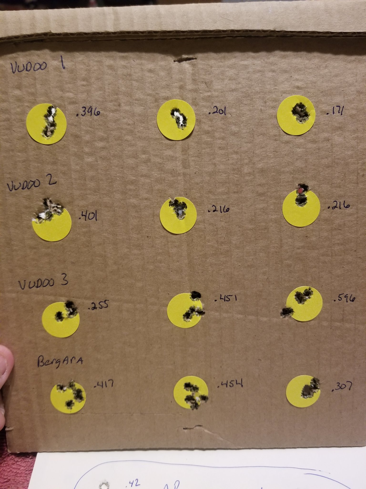

The Vudoos. What can I say. Every one of them every freaking time. The have reinvented the wheel here. It is effortless to shoot bullet holes. My timing from ahot to shot can be off. I can stay in the gun too long etc. They are just the definition of perfection. They are not ammo picky. If I want to shoot in the low .3s I use sk standard plus. If I want .2s and .1s its center x. They are truly worth their every penny.

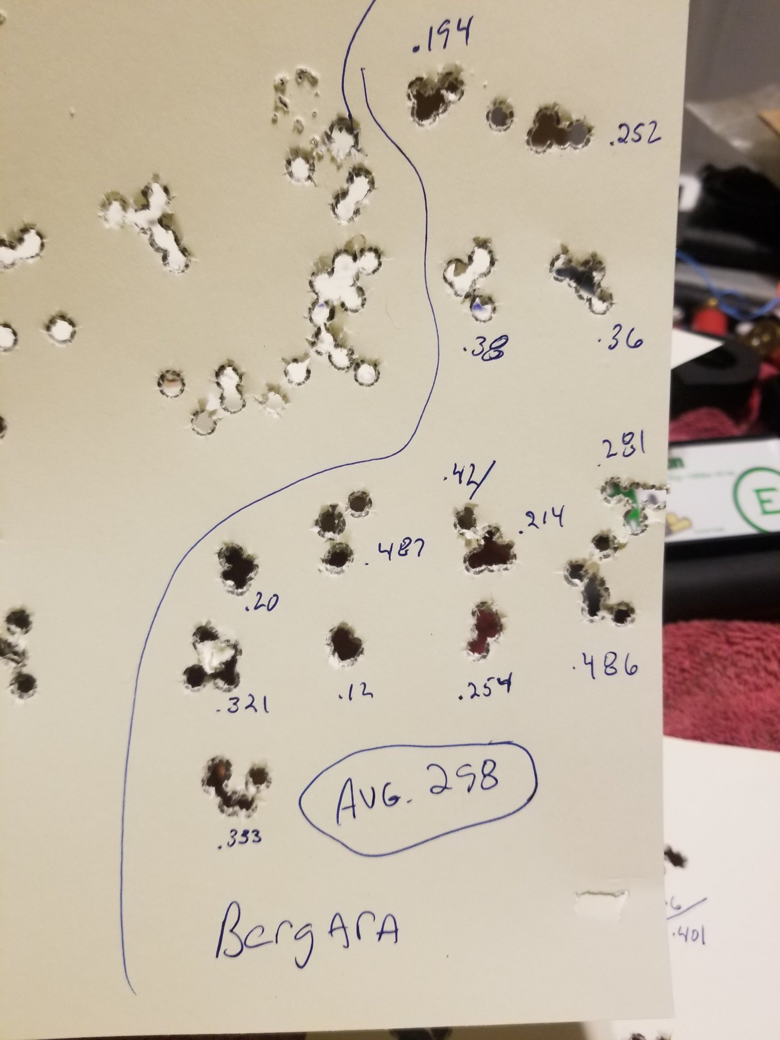

Bergaras. Okay so this one to me is a poor man's Vudoo. At least at 50yds. Both of my carbon fibers would punch .1s and. 2s avg under .3/8 but they had to have an area 419 hell fire muzzle break to do it with. Without that comp there was enough movement to effect groups. With that comp very nice. My steel version is my bell of the ball and the one gun I have shot more than the others combined. Probably 3000 rounds I would say. Automatic and getting better. I run trigger tech specials turned all the way down and in that paticular gun i am under 1lb. Never and issue. The bolt I can work it like a worn out hooker or slow and steady. Never a malfunction in my bergaras nor my cz nor my vudoo. I live bergara mag, easier to load for me than the Vudoo. And I can run the bolt much faster bc it's not made to as tight of a tolerance. I very much like the factory stocks too. The gun is very well finished, thought out, and designed. Smoking deal for what they go for I think.
Vudoo takes the cake. It's a custom rifle designed for those who want the best. I simply couldnt be happier. Customer service and folks there are TOP NOTCH. Kidd is a vudoo for the semi auto. But a cz and bergara will be more consistent and easier to shoot in my opinion. Nature of the beast. For a cheaper 700 foot print practice tool short of Vudoo Bergara. But accuracy wise they all shoot about the same minus the Vudoo. I do find the bergara to be easy to shoot well followed my cz or tikka and then the kidd.

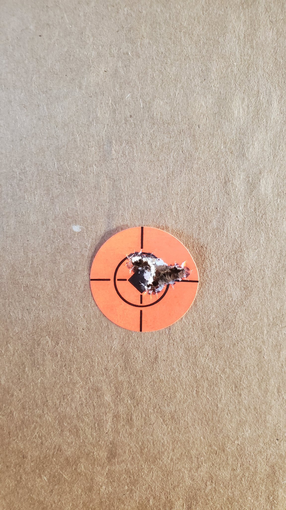

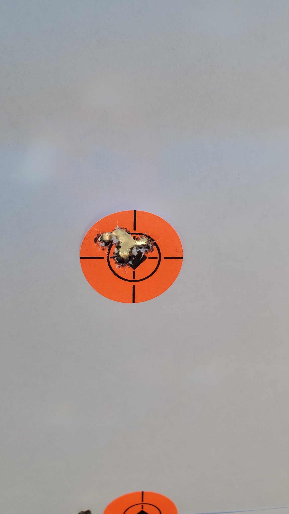

More groups

This just confirms what I have found by analyzing my rifle vs friends...My Bergara is just a poor man's Vudoo. Personally, I don't think the extra cost is justified by the results, Bergara Vs Vudoo. If I had the extra money to spend, I'd have bought the Vudoo, but I am very happy with my B14R.

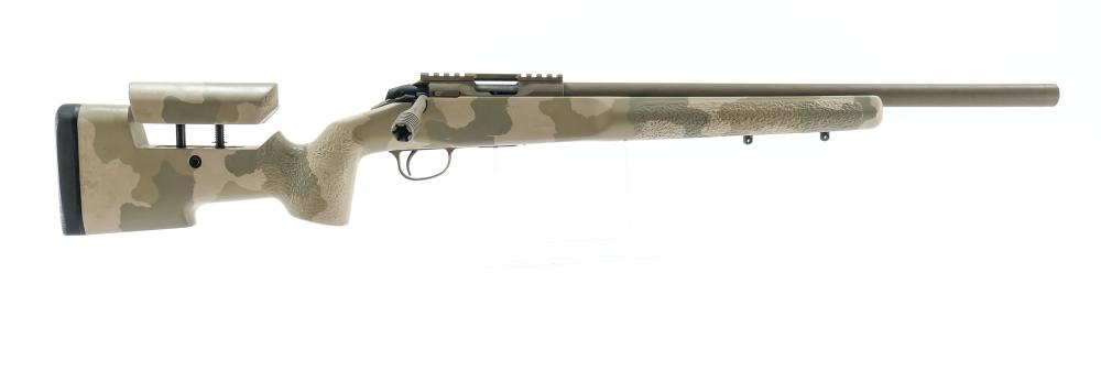

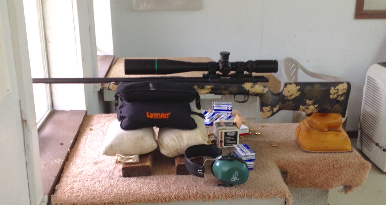

The Sako is a special rifle that was one of a limited series built by Jared Joplin of American Precision Arms fitted into a McMillan A5 stock with some nice refinements. The CZ is bone stock out of the box. I am still breaking it in but it has already recorded four ARA factory cards of 2450, 2500, 2450 and 2500 and two IBS50 cards of 248/10x and 248/11x. Those are about all I have shot with it in competition but these were unsanctioned local BR matches. I am still working on dialing the trigger to a spot I am happy with and finding that best lot for it. I would place them both at about the same level of accuracy potential but the Sako is a little easier to shoot well. I think the stock fits me better and the bolt is a bity smoother. The CZ gets better every time I shoot it. I am looking forward to some real matches with it in the spring if not sooner.

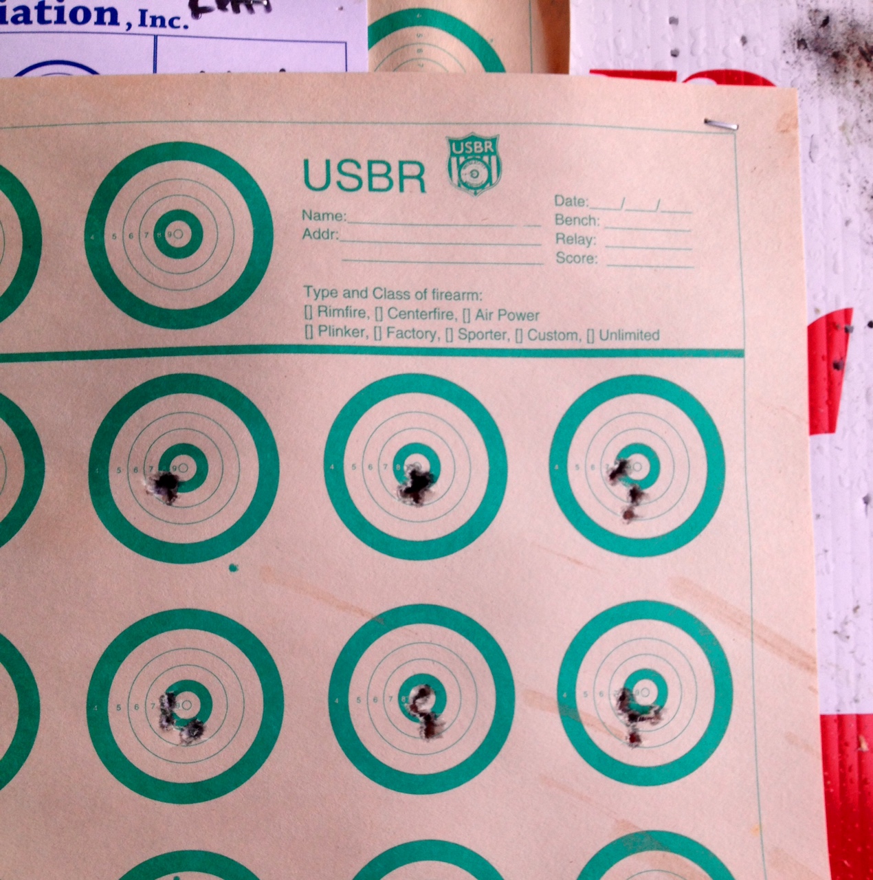

Pics - The Green USBR tgt is the CZ with three different lots of Midas+ at 50y. The two on the upper left were the best. The Blue tgt was lot testing with the Sako using different lots of CX ammo. The Sako is more consistent but not by much. They were both using the same scope at the time.
