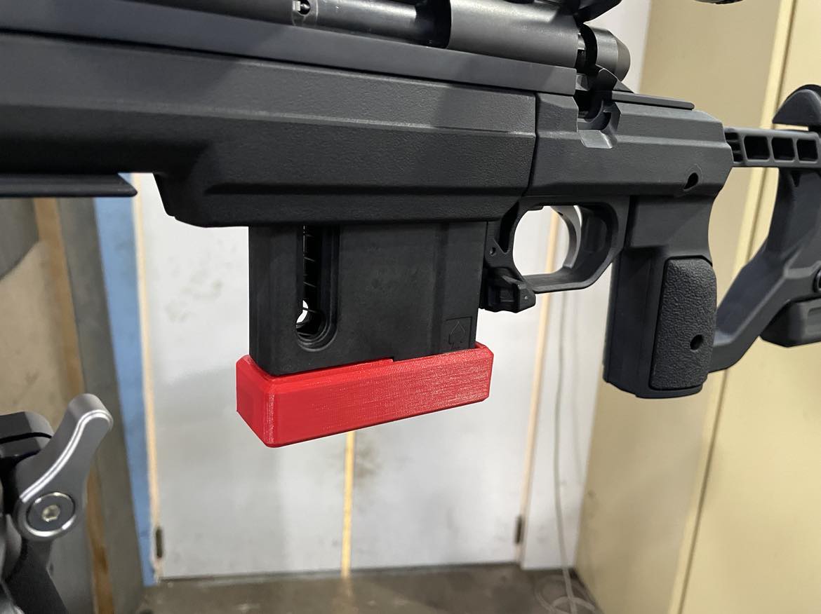

There's another option about to launch as well.

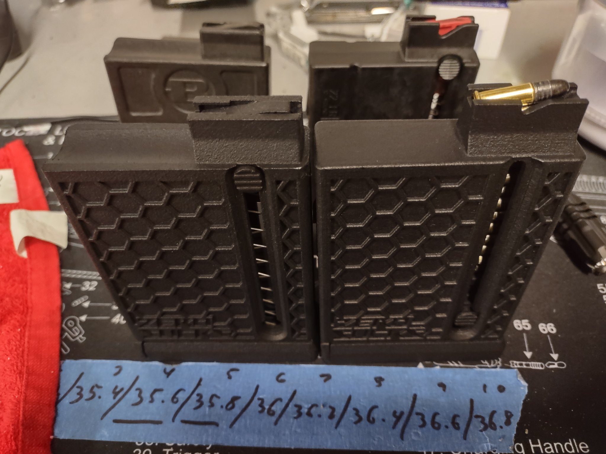

If anyone has tried the ‘Zero Sucks’ mags, now that it’s been over a year since the previous post, what did you think of them/what has your experience been?
Did I read it correctly, that these also run in the Bergara B14r? You can’t switch the standard Vudoo and B14r mags back and forth can you? I have both but haven’t ever tried it. Hadn’t even crossed my mind as a possibility, lol.
The zero sucks mag has been discontinued now that the Elite mag is out. The zero sucks was great for being printed but the Elite is injection molded with an aluminum baseplate and latch.
Thank you, I had been looking for the Zero sucks and found them to be discontinued, but didn’t realize there was a new version. Appreciate you letting me know!
