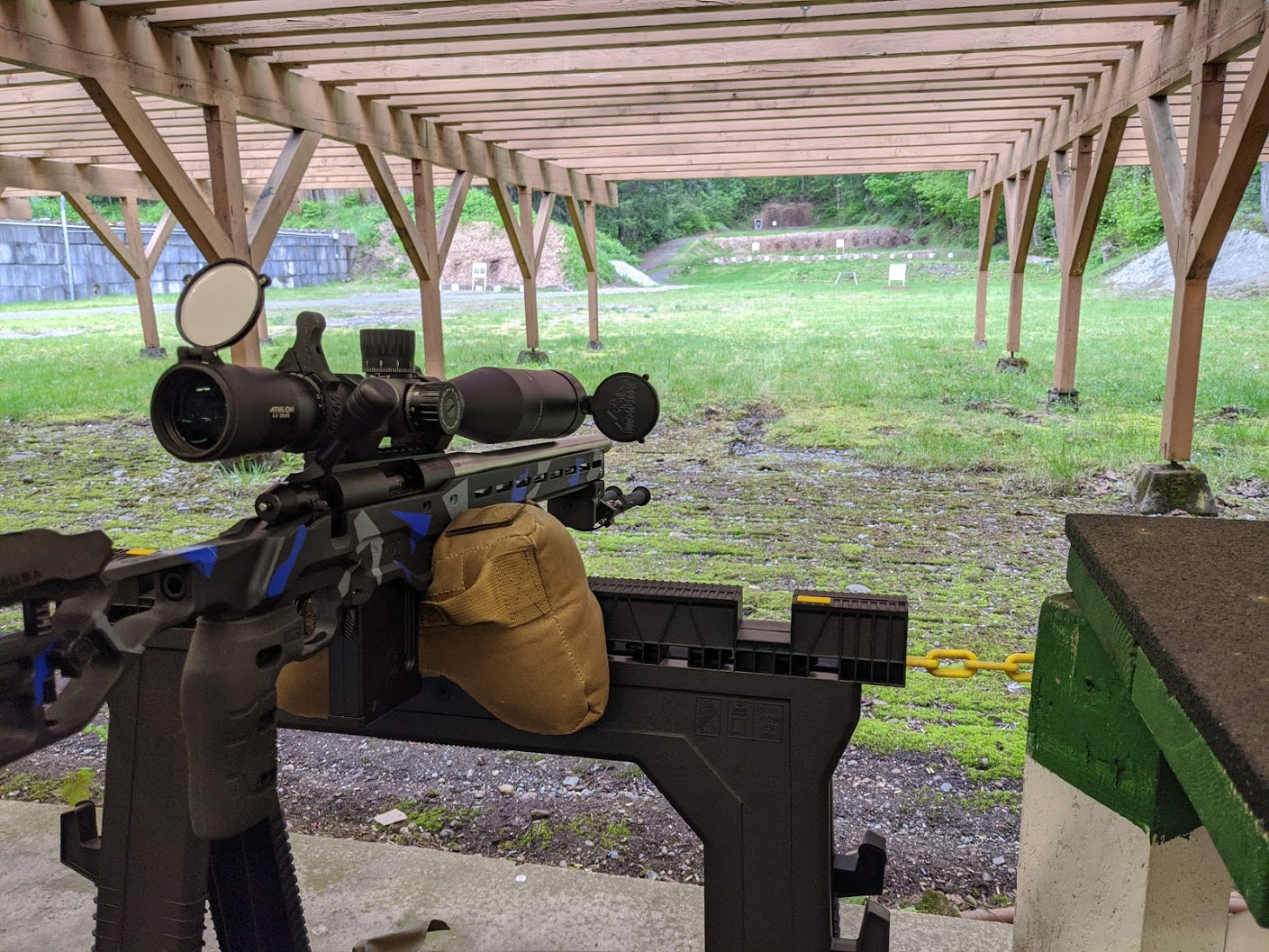

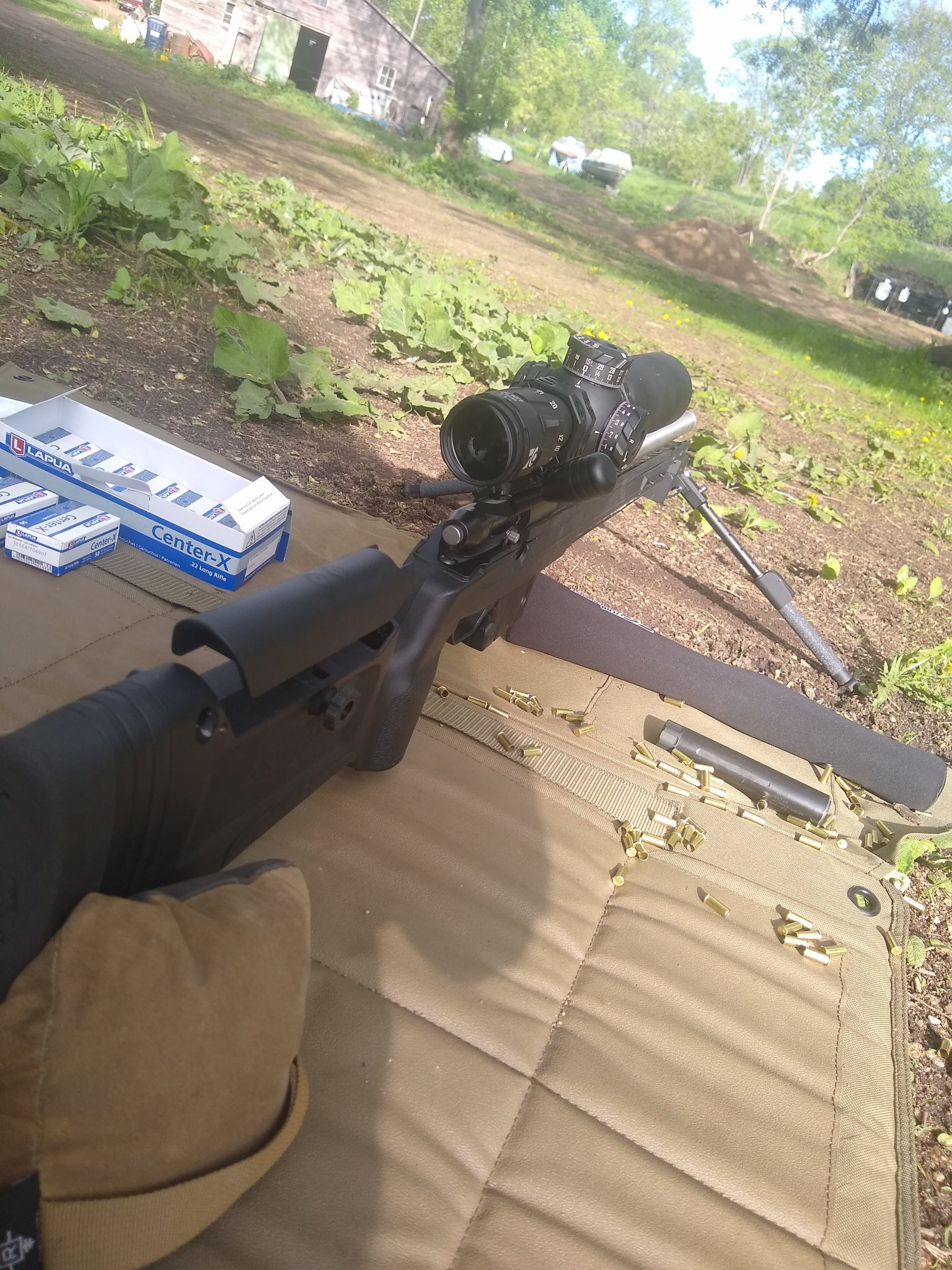

Hey guys just looking for some insight/advise. I have a 16.5 in kurki in a krg bravo chassis. I'm looking to possibly go up to a 20-22in barrel. I'm pretty frustrated with how it shoots... it'll shoot great basically one hole at 50yds for then shots then maybe a group the size of a half dollar the next 10 shots and back and forth. In shooting what I believe is a good lot of center x. Good sd's/es ect. I'm just curious what the opinion is on going to a 2 or 3 groove benchmark barrel in a 20 or 22in length...maybe that'll help settles things down. My one concern is that from reading benchrest type information is that the 2groove benchmark barrels only shoot good in the warm weather. Being from MN that concerns me. Let me know you guys think. Thanks Brent

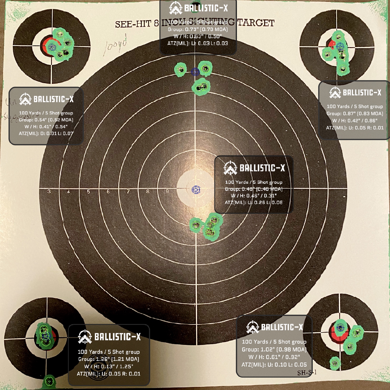

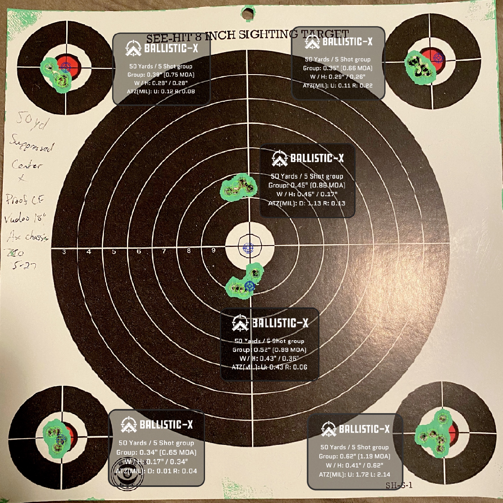

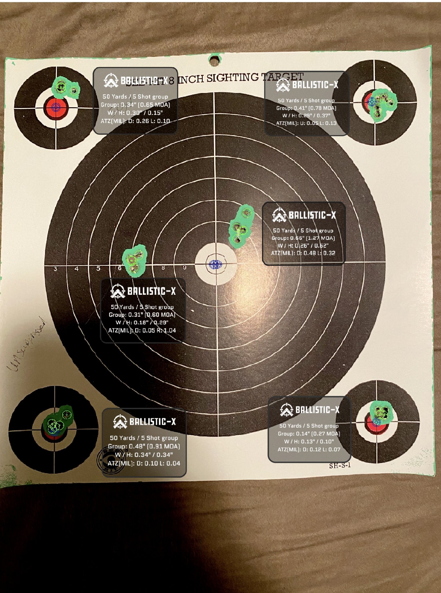

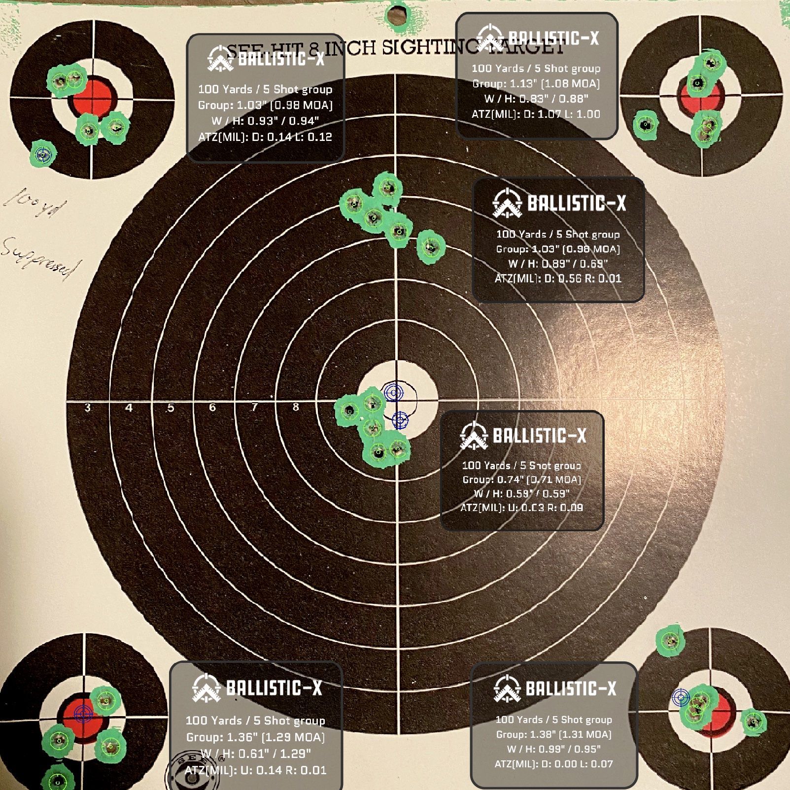

So I shot last night 4 6x5’s at 50 and 100yds indoors with and with out a suppressor. With the suppressor my groups were consistently larger with the can. Still extremely accurate but bigger than unsuppressed. Top two are suppressed and bottom two are unsuppressed

And this is with a 18” proof CF barrel and a 22TD (for the suppressed shots)

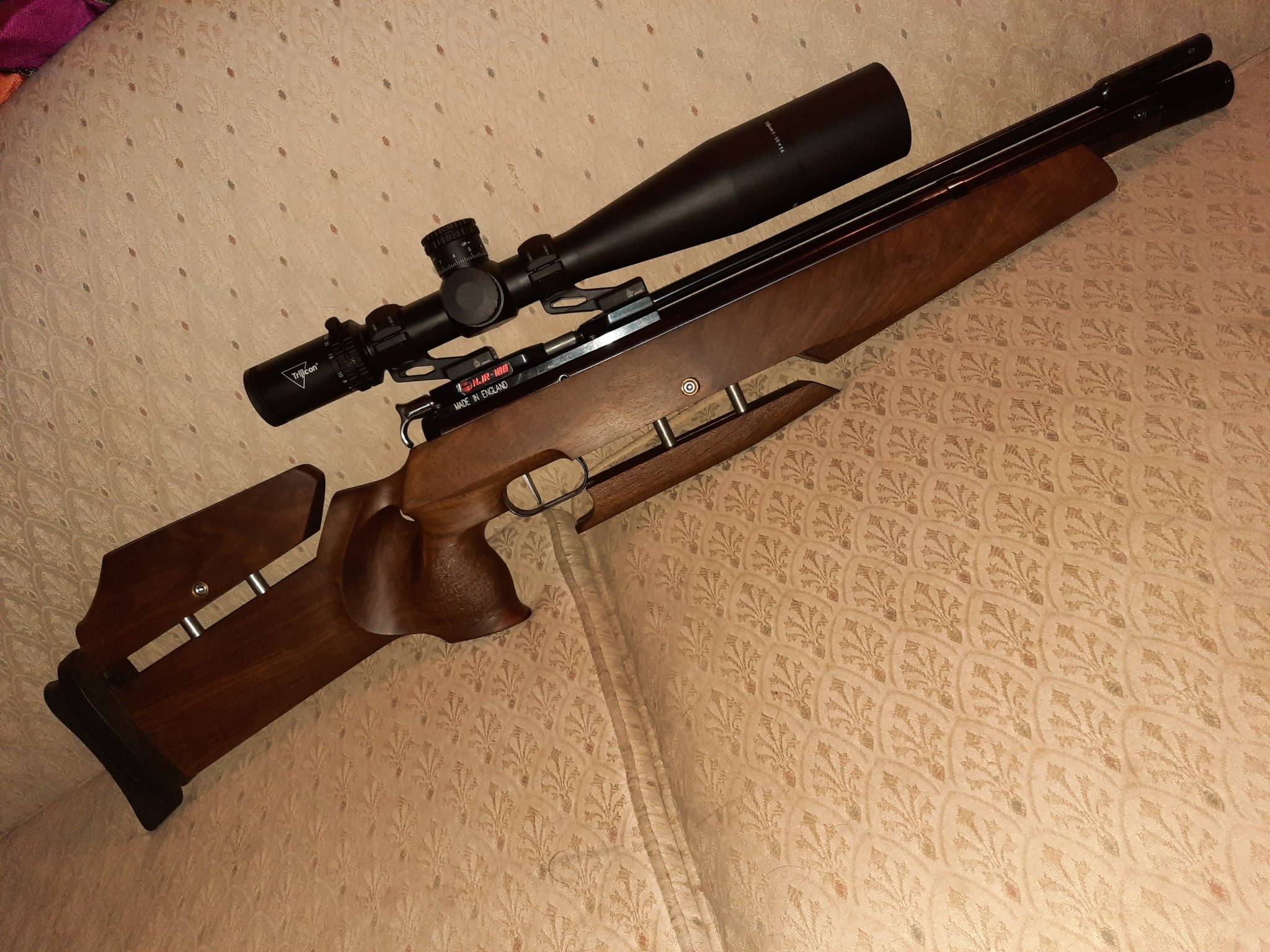

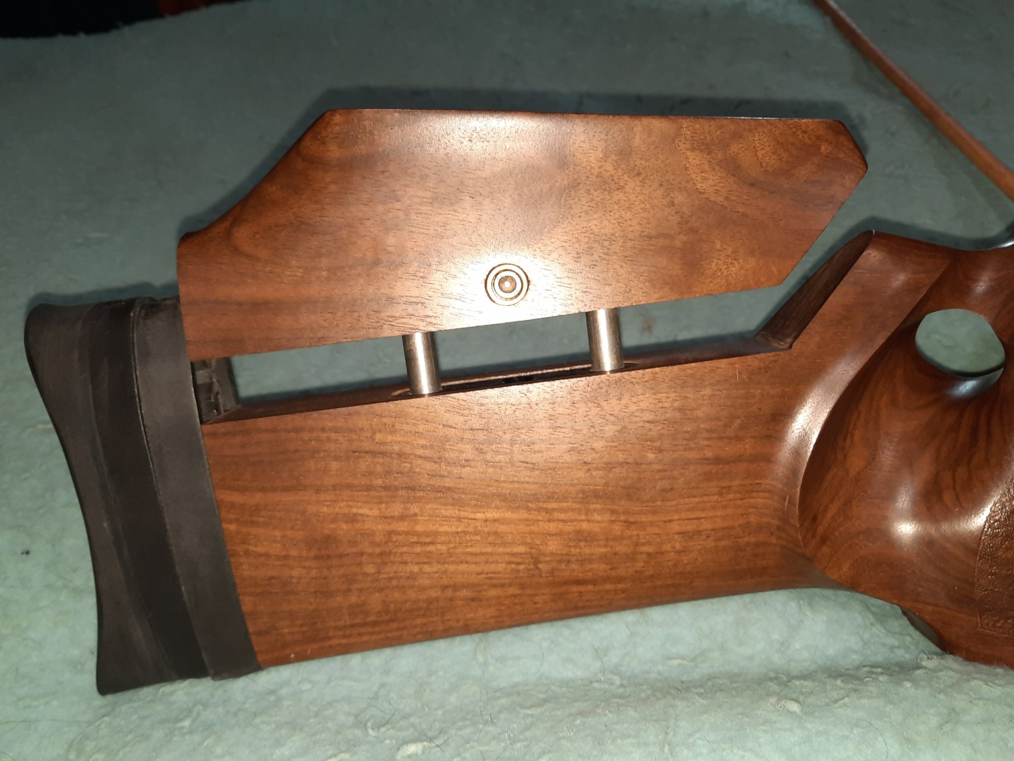

I'm sure there is a simple answer to this, why aren't you racking your guns muzzle down??
Every gun I own that has a rubber butt plate gets stored muzzle down to prevent dog ears.
You likely don't see it but I do. The top of this NJR is dog eared because it was stored butt down
prior to me saving it. Before you laugh too hard.... it's ammunition is under $15.00 / 500 for top
quality stuff. 0.03 per round and not the .44 cents that Center X costs me. And we put cans on them
with no Govt supervision or cost. This on is .177 but they go up to .50 cal.

Muzzle down? Photo of how this is done? I wouldn't want to be resting the weight of my rifle on the crown of my muzzle.
