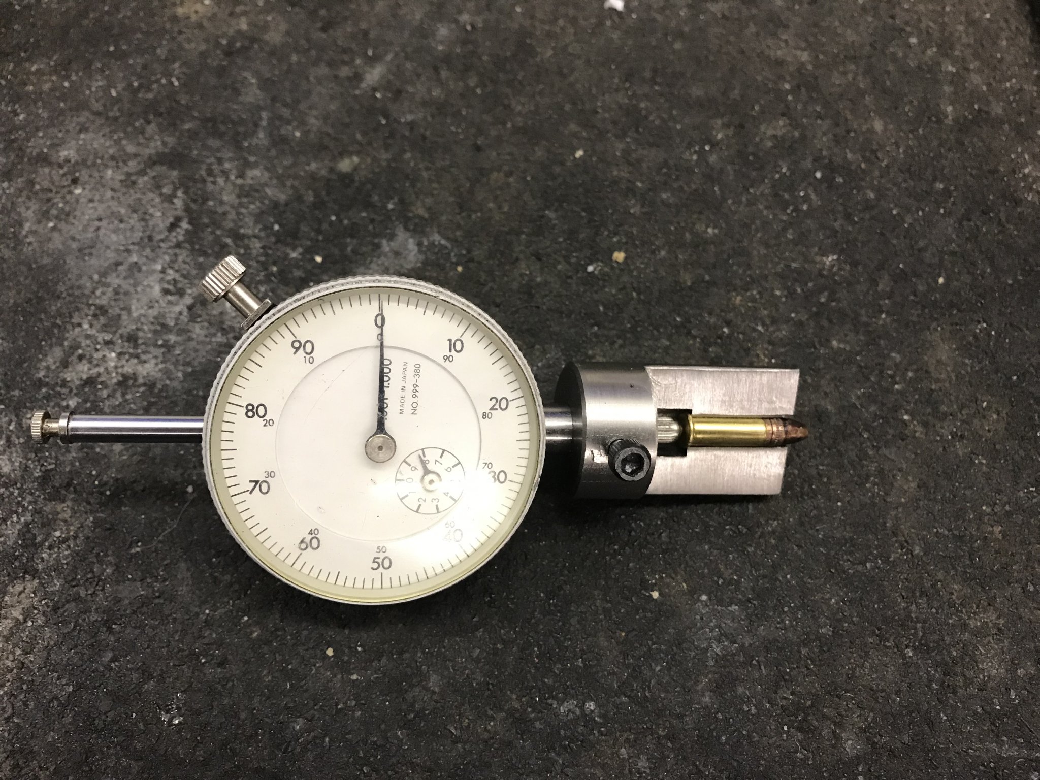

You’ll find the V-22 will not close consistently on the CCI stuff using the 22LR Ravage chamber. One box can be great and the next, not so much. In the very near future, we’ll be offering a selection of chambers for the guys wanting to hunt with their Vudoo, so CCI and other non-match type ammo will be available for use. Of course, the rifles will deliver a high level of accuracy, so no worries there.

"You’ll find the V-22 will not close consistently on the CCI stuff using the 22LR Ravage chamber. One box can be great and the next, not so much."
I made this for that very reason. I have seen cci sv up to 5 thousandths difference
I made this for that very reason. I have seen cci sv up to 5 thousandths differenceView attachment 7199642.
Exactly. I have something similar and see the same thing. We're headspacing at .043 for Lapua, Eley is .041, so when you have 22LR ammo that headspaces at 22WMR specs, the bolt won't close.
