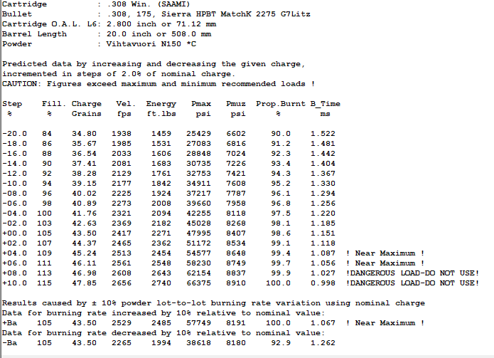

I am about out of Varget. Found 4lbs of n150 and am looking to see what people are getting speed wise and what luck they are having with it. I used n530 in a 300wsm with awesome results, and use n350 in pistols with good results, hopefully the n150 will prove to follow the same path. According to the VV site it looks like I’m seeing 43.5 as the max for n150 with a mv of 2573. That seems pretty slow to me. I will be using once fire lapua cases, br2 and 175gr smk. If anyone has any experience with this matchup I would sure appreciate it. Thanks.

It's not an ideal substitute for Varget and here's what QL predicts
