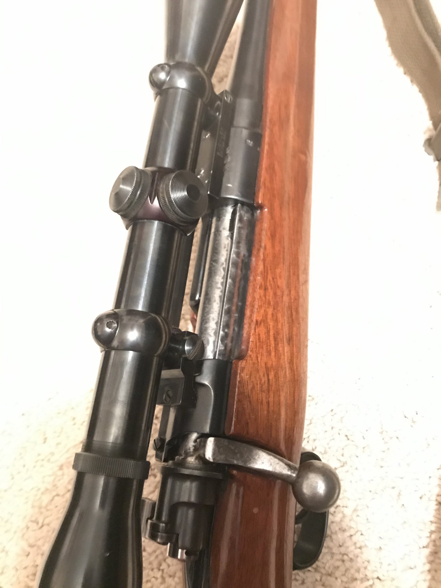

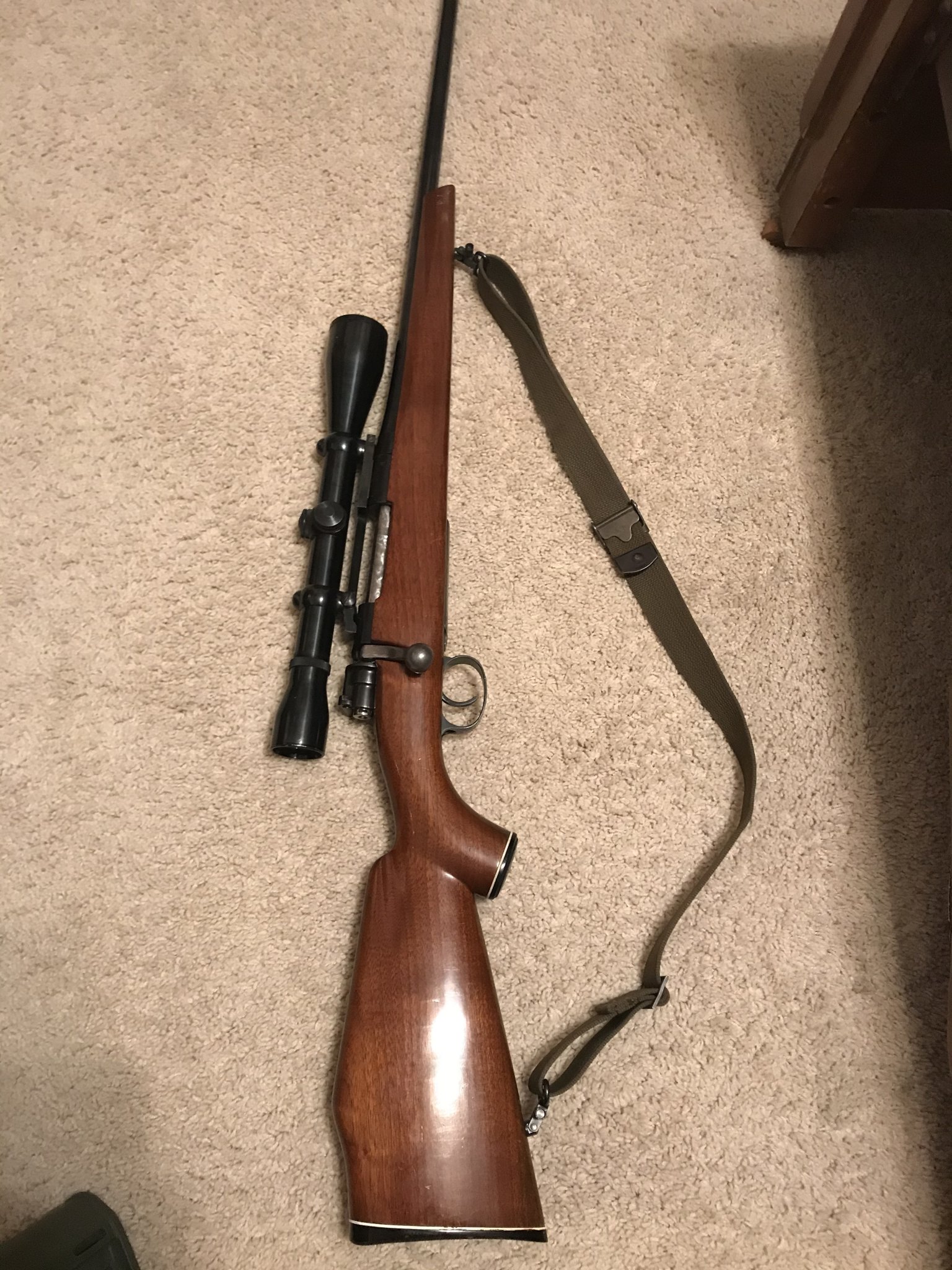

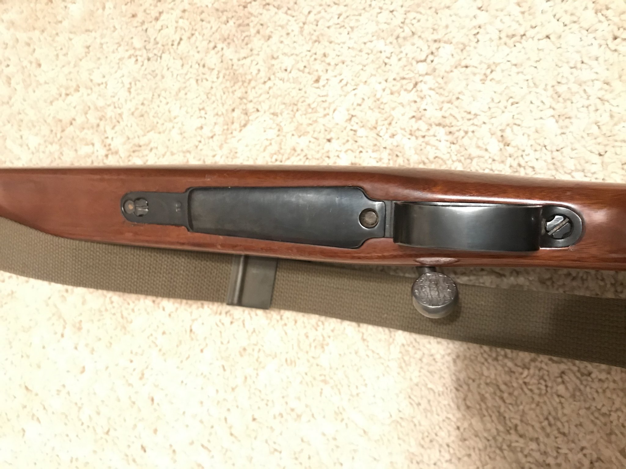

Figured I’d join in with the help me threads. I have a VZ 24 with a .257 Roberts barrel, sitting in a Bishop stock with a weaver K6 Scope. Any idea what it may be worth, and any other info on it?

Added: PS, love the rifle. What twist? Still, would run $300-$450.

Anyhow, that is a nice rifle. It deserves better glass.

sporterized milsurps as great a rifle as they may be are kind of hard to judge a value on i bought a sporterized vz24 in 30-06 for $129 if it was built up by one of the big name smiths back in the day it could be worth more but as a generalization i would say 300 tops especially being chambered in an obsolescent (not obsolete just not common)
Thanks for all the responses. I was genuinely curious as to its background and what it was worth. I gave $600 for it, and here's why. When I was 8 or 9 or so, I killed my first dear with it. My grandfather owned it. He passed away a few years back and his collection was sold. I couldn't afford to buy it then. I found the ledger showing which guns were sold to who and I called up the owner of the rifle. I told him the story, and he let me buy it back. The Weaver K6 is cloudy and dark, the trigger is long and heavy too, but it shoots fairly well. Im glad I was fortunate enough to buy it back.

Put good glass on it, a Timney trigger, and then be amazed at how well the old warhorse shoots.
