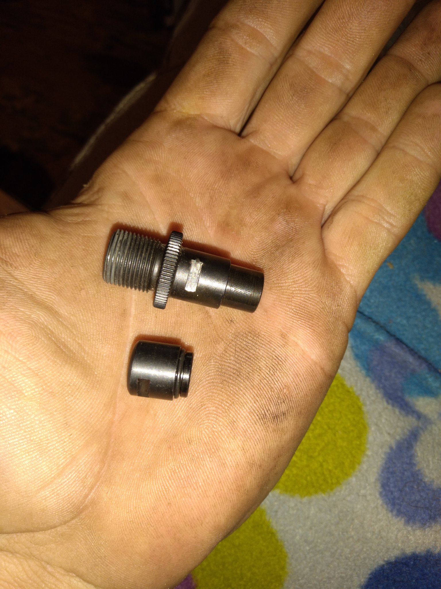

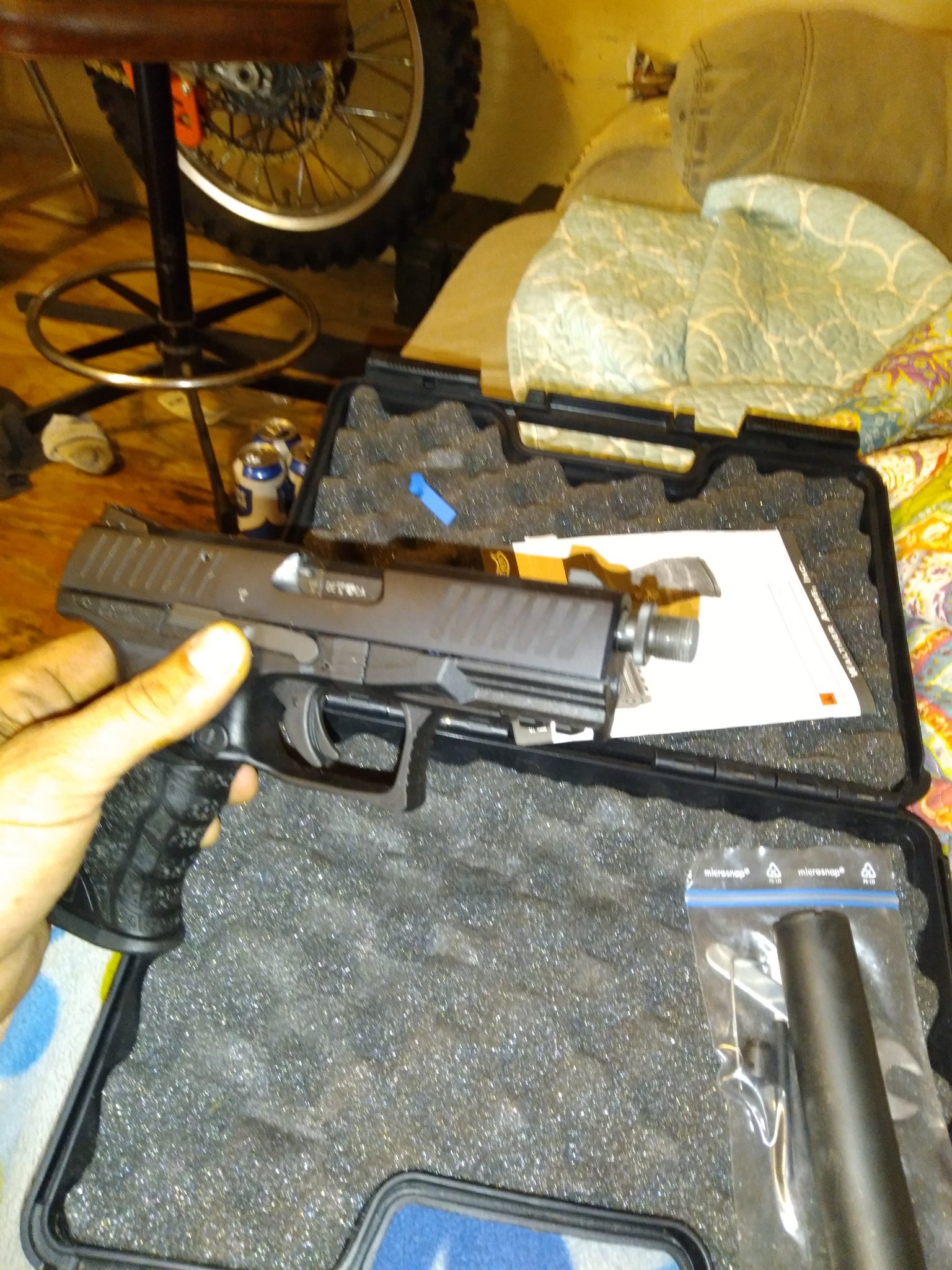

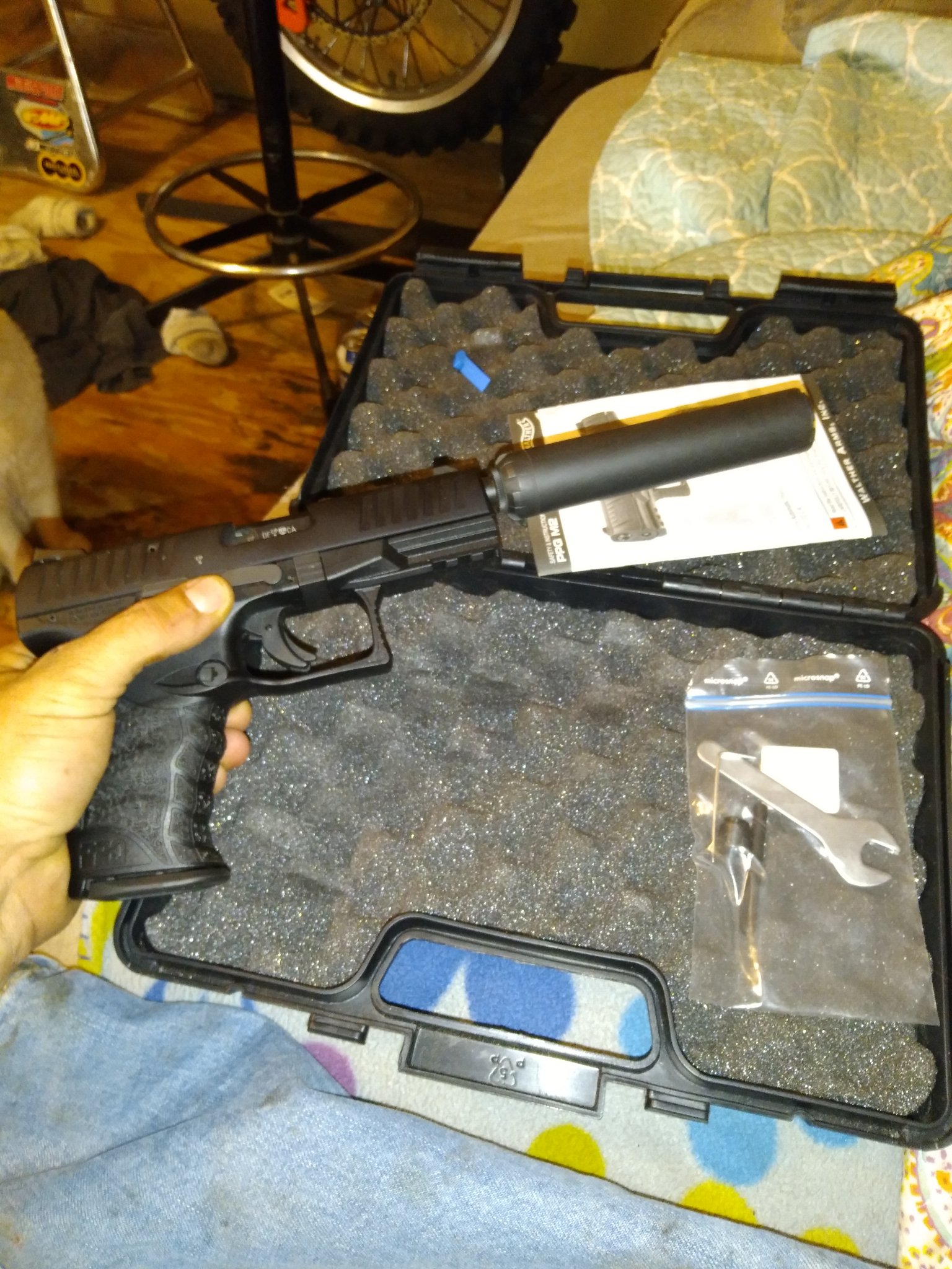

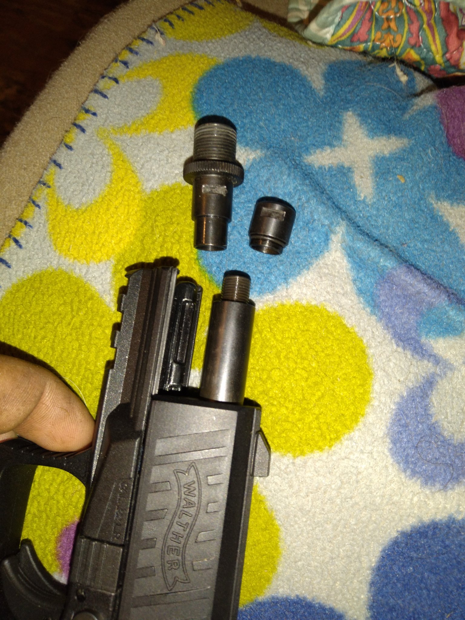

No it requires an adapter but not a recoil type one. Just a solid adapter that replaces the barrel end nut. Walther sells them for like 35 bucks i think. They gave me this pistol to replace the 4th malfunctioning ppk 22 they sent me. And they added the adapter in as part pf the im sorry our pistols dont work deal.

No it requires an adapter but not a recoil type one. Just a solid adapter that replaces the barrel end nut. Walther sells them for like 35 bucks i think. They gave me this pistol to replace the 4th malfunctioning ppk 22 they sent me. And they added the adapter in as part pf the im sorry our pistols dont work deal.View attachment 7598826View attachment 7598827
Interesting thanks for the pic, very helpful!
