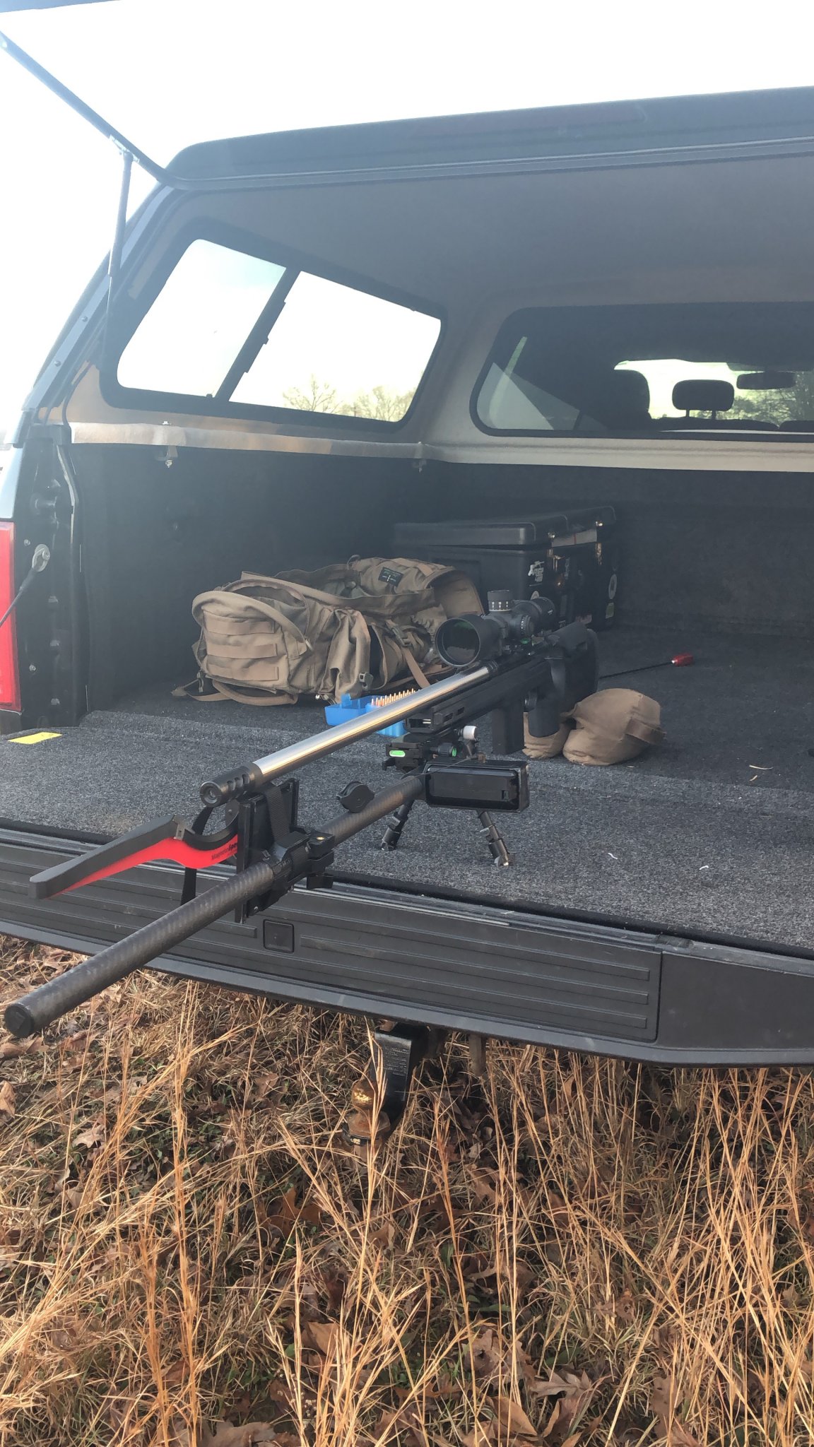

i'd go with the V3
great choice used by a lot of people on here.
consider getting a mount like MKM or Wiser makes. this allows you to mount the chrono to your gun instead of strapping it to the barrel.
this eliminates any potential POI shift and harmonic change by hanging something off your barrel. very worth it
neither of those issues mentioned above will effect your MV data. but it's nice to be able to gather MV and zero at the same time as opposed to two different steps
