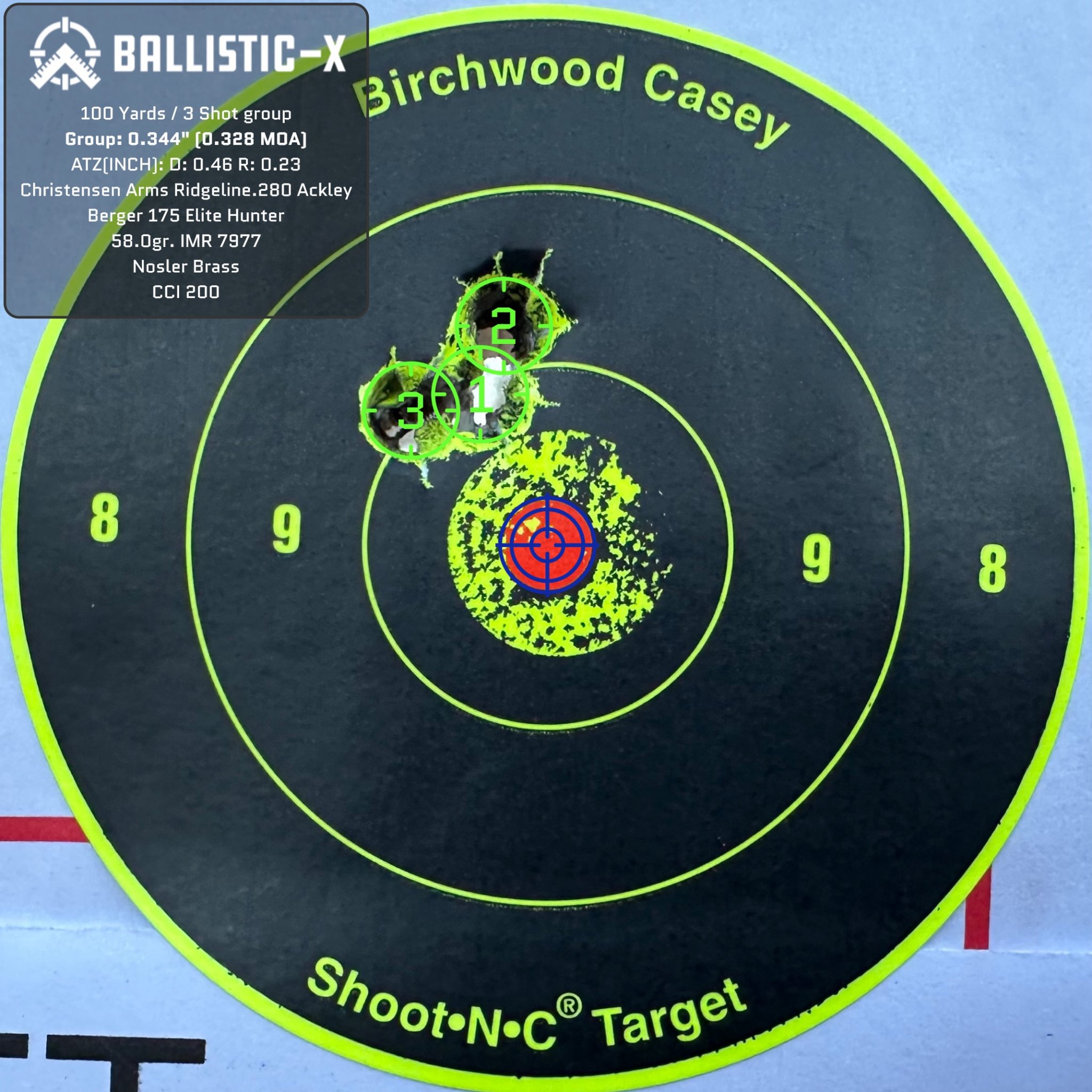

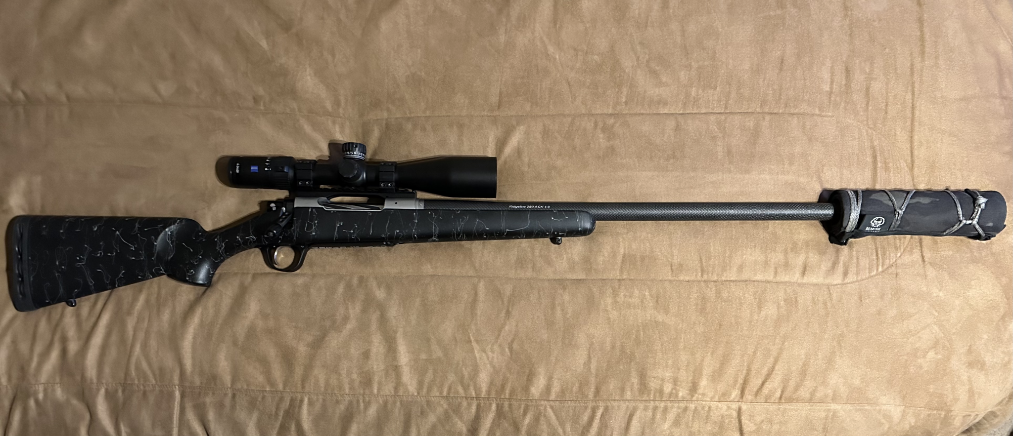

    Why no love for 280 AI?
    Too light for caliber? I’m admittedly a novice, but it shoots real nice for me…only had it out to 600 yards so far though.
    Absolutely nothing wrong with the 280 and the AI version is the shit.
    I have a Kimber Mountain Ascent (The rifle is a POS) that I FINALLY figured out a round for. It shoots the SGK 175's about 2700 fps (I don't have that card right in front of me) and is accurate for repeated shots as long as you give the #2 Dixon Ticonderoga profile barrel a minimum of 5 minutes between shots. It's lightweight for sure. It mostly just sits in the safe because it's just not all it was cracked up to be.
    I have a tuned up 700 in 280 Ackley that I had cut for the 140 grain Berger VLD. Talk about the fucking shit! The 140's leave at 3250 fps. Of course, I'm handloading, but you can just barely get that same performance from the 7 Rem Mag with LOTS more powder and the stupid belted case. This is my go to rifle for deer and the coyotes hate it too. I have a Swarovski SFP scope on it to help keep it light. I have it zeroed at 275 yards and the scope doped at min, median and max zooms. I've taken a coyote at 850 yards. It did take 2 shots and I have no idea where the first round went but that dog didn't seem to notice either. It's lethal and I love it.
