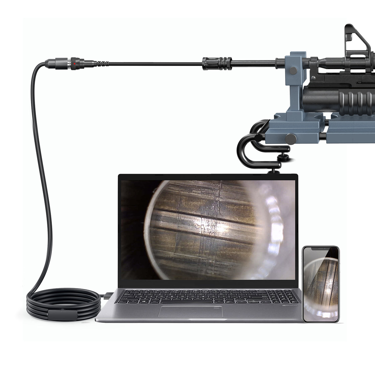

I was wondering what the benefit of the rigid is over the flexible.I have this one...works with my tablet or phone.
NTG100 45-inch Flexible USB Borescope
The Teslong NTG100 45-inch long flexible borescope is an ideal gunsmith tool. This borescope helps you see the deposits in the lands and grooves of the rifling and is a great aid when cleaning your barrel. Go to Teslong for all your gun barrel inspection and digital borescope needs.teslong.com
Their all Teslongs.Wonder if the Teslong is double the price better? I mean it's just a camera on a stick...
Their all Teslongs.
They offer a flexible 45" with no monitor (use PC or phone) $55
A rigid 26" with no monitor (PC or Phone) $99
A rigid 26" with its own monitor $160
If you have an iPhone I'd suggest the screen over the Wi-Fi models. They are a giant PITA to keep connected.What's the benefit of it's own screen? Are there features that you will have that you won't with a phone or tablet?
My flexible one does not use any app on a PCAnyone know if you need an app if using a PC?
I do. I make sure to make it reasonably clean and dry before I slide the scope through it. I tried without using the bore guide and it was a mess. Misalignment and banging around the chamber.Random question and older thread I know but are you guys with the rigid version using a bore guide when scoping?
Just be gentle with it especially at the start.I do. I make sure to make it reasonably clean and dry before I slide the scope through it. I tried without using the bore guide and it was a mess. Misalignment and banging around the chamber.
My question is: the bore scope isn’t as long as the barrel. So how does one scope the front of the barrel safely with out damaging the crown?
I hear this from chicks a lot.Just be gentle with it especially at the start.
Yeah, I agree with all you said, and that was def the reason for my concern.its very tight in a .223 bore just fyi.
I got the rigid and hook it to my PC, which is no problem.
But it can easily get wedged and scratch/gouge the bore in a .223.
I forget the diameter, but its just slightly larger than .22.
I also use a bore guide, but you have to go from the muzzle as well if you want to see that end.
Its MUCH easier on 30cal barrels, and I imagine with the 6's, but use caution on .223
Ah....maybe insert the rod into the bore instead of trying to beat your crown into submission with it? ;-) hahahow does one scope the front of the barrel safely with out damaging the crown?
