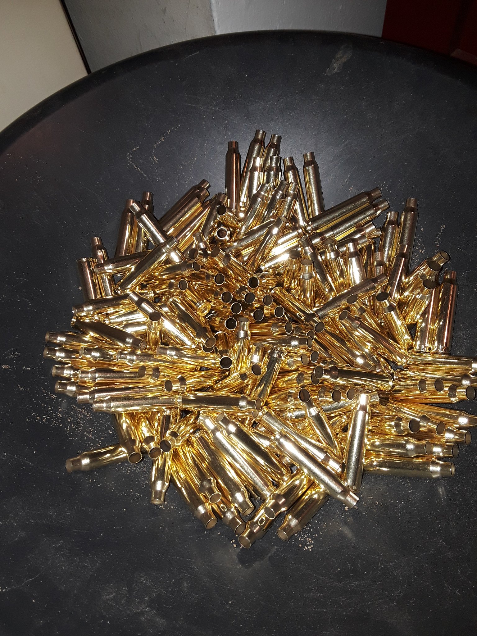

my wet tumble recipe for between 80 to 120 cases is hot water with a table spoon of dawn, a tablespoon of lemi, tumble for 45 minutes, water change with cold water and a teaspoon of lemi for 20 mins. water change with cold water with nothing added for 10 minutes and separate, wet brass gets tumbled in a towel for bulk drying then in a dehydrated for few hours for set at 115degrees.
they still come out too clean where I have to lube the neck for bullet seating.. so I dont do it every cycle... every 3 or 4 cycles.
