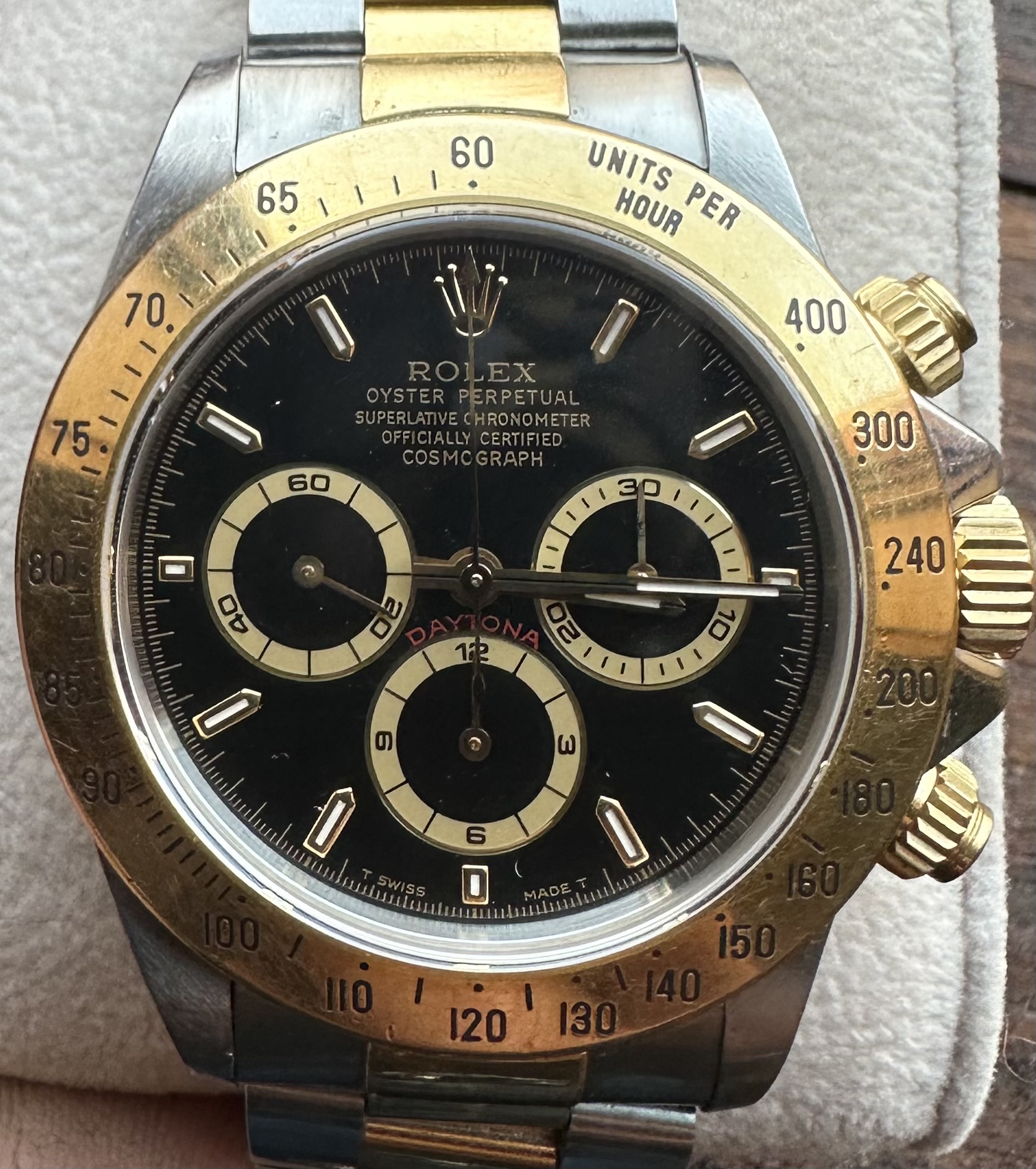

Classic tachymeter

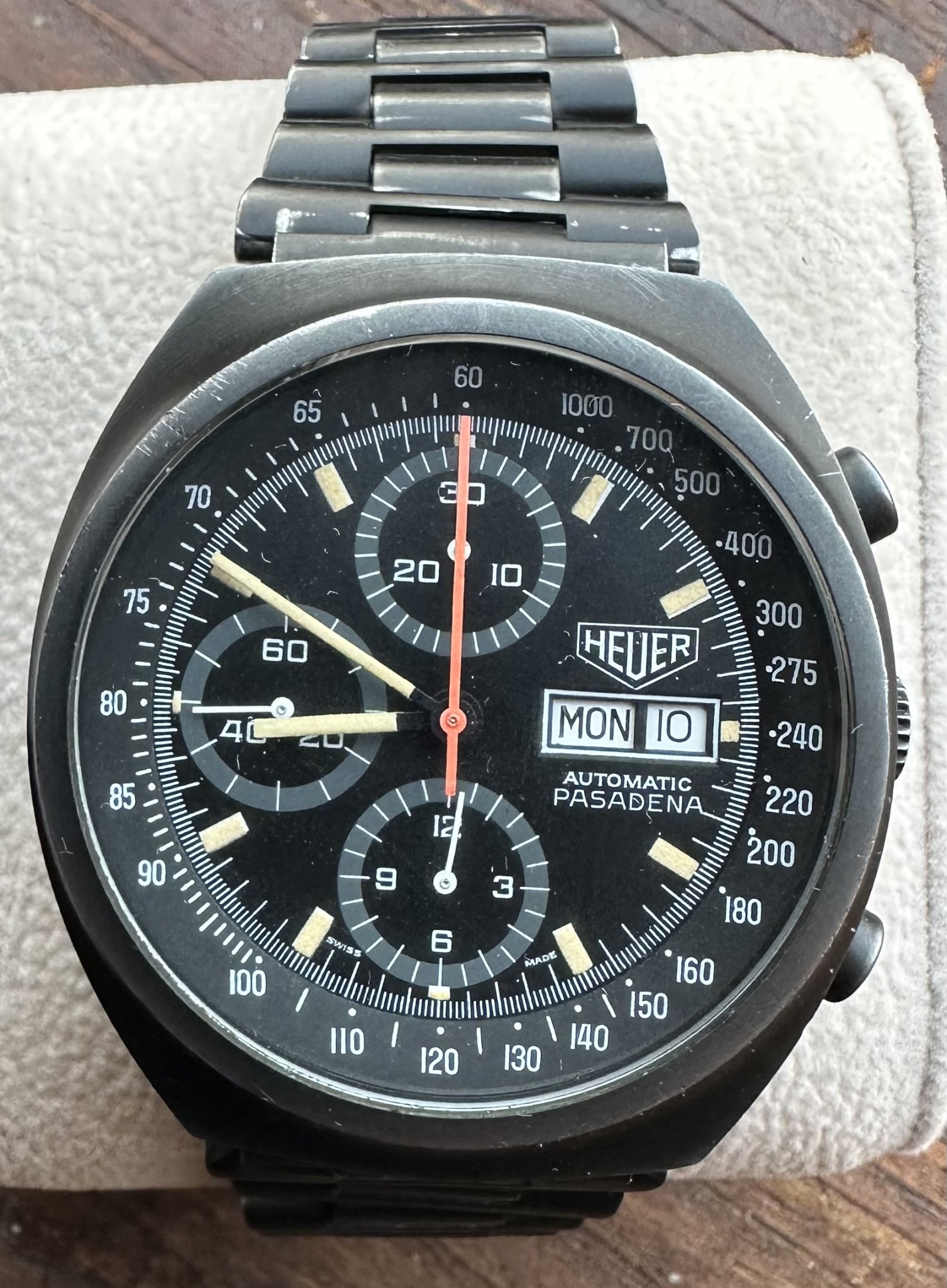

Driving watch with MPH…. Sweep hand tells you speed on measured mile.

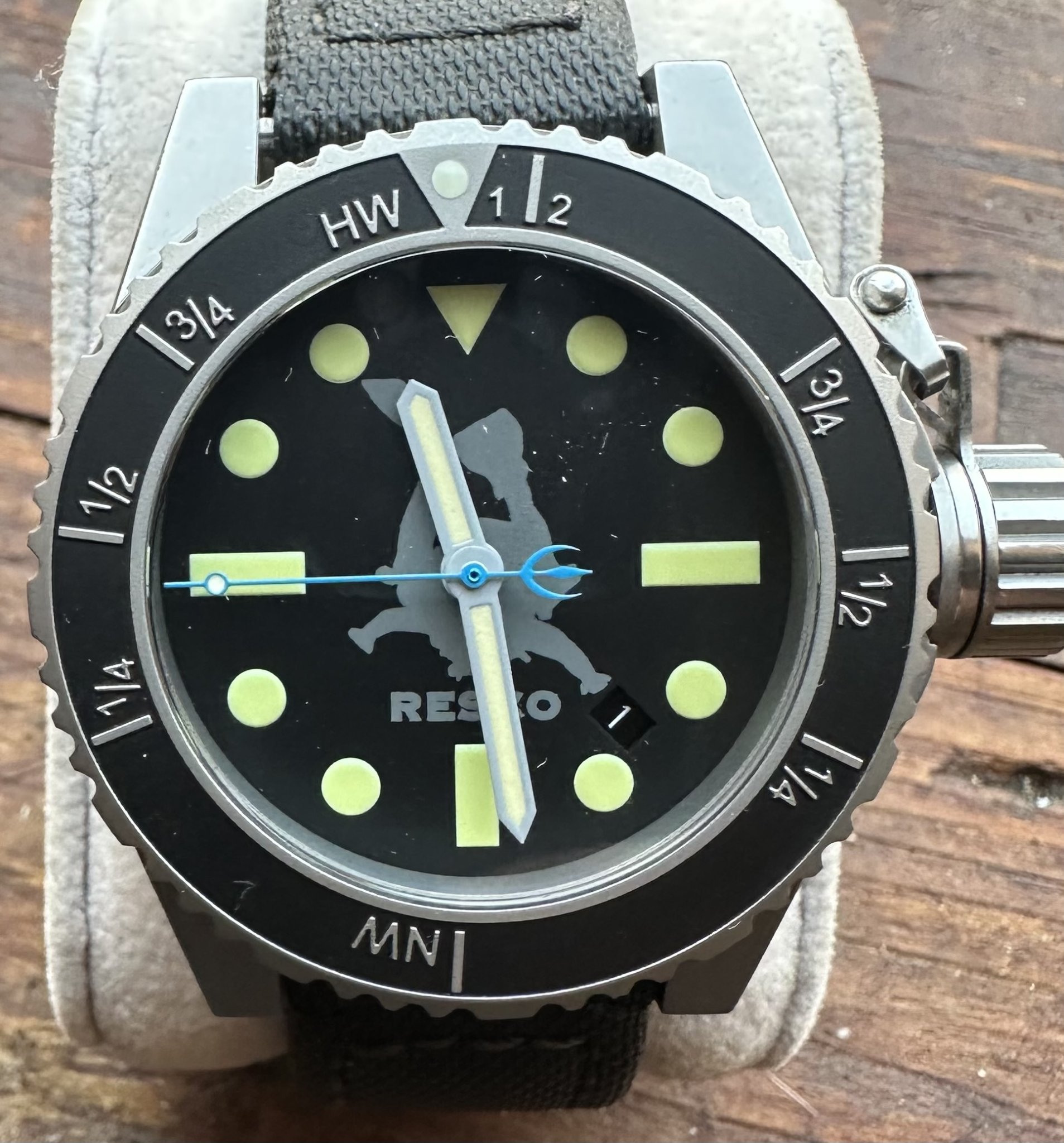

Tide bezel. Used to know when you are swimming with or against tides.

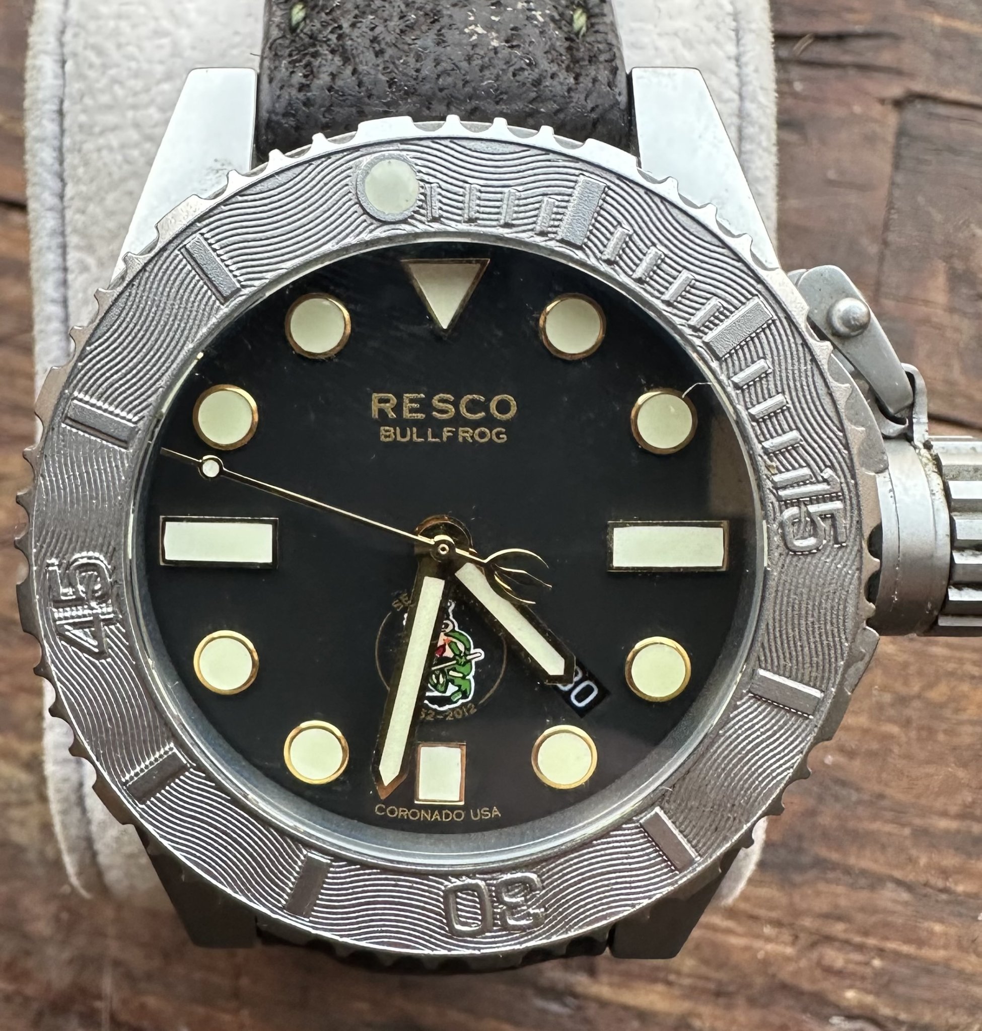

Classic dive bezel. 1 hour with 15 minute warning.
