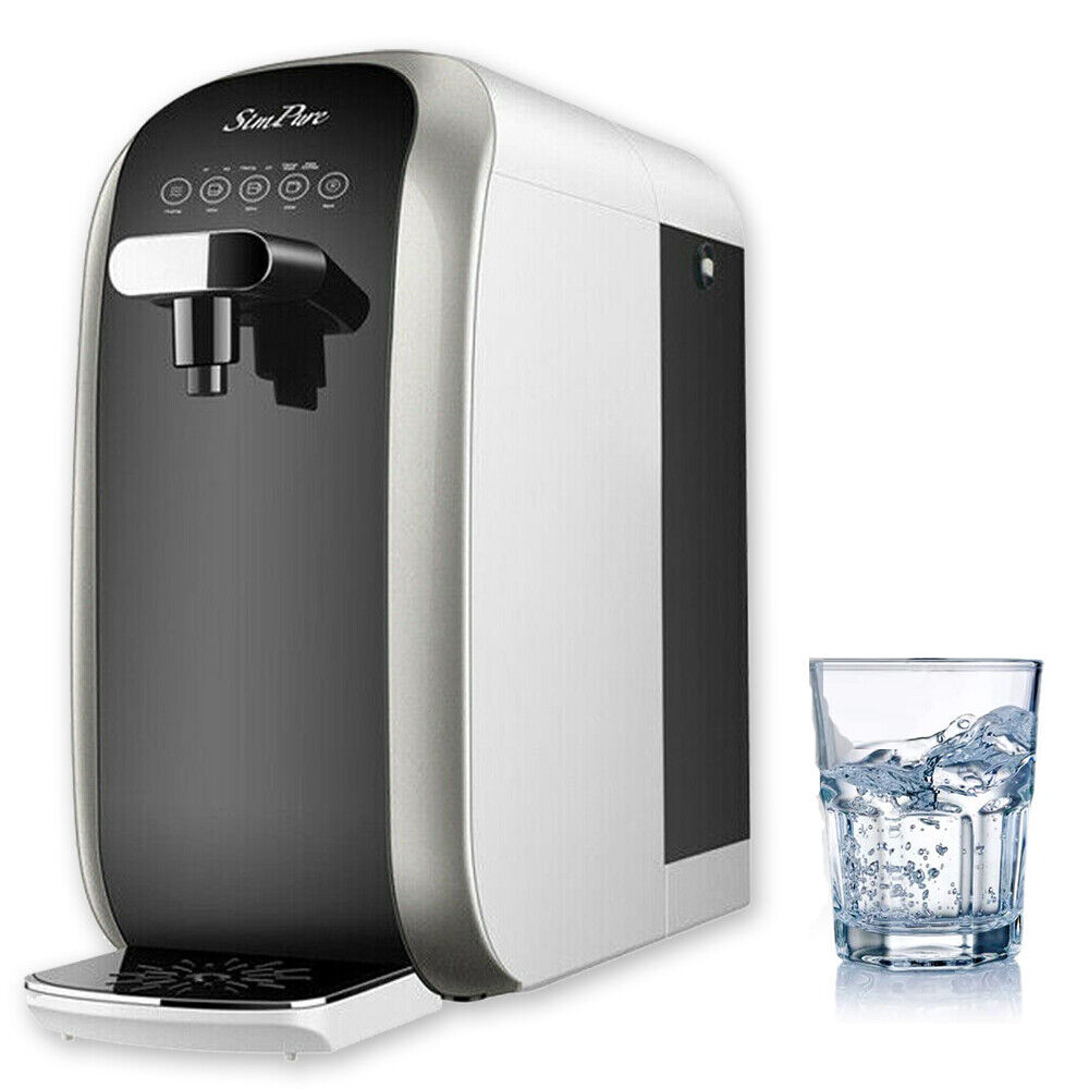

We've got a 5 stage unit here, that I've mounted to the wall but have yet to 'plumb it in' as we've simply had far too many other crises and chaos to deal with IRL.
Interesting thread, and I'm curious to see the outcome as well. Originally this was for creating a reef aquarium, but that's been parked and I'm leaning towards getting away from the 'brita-type-thing' pitcher and simply getting this unit going.

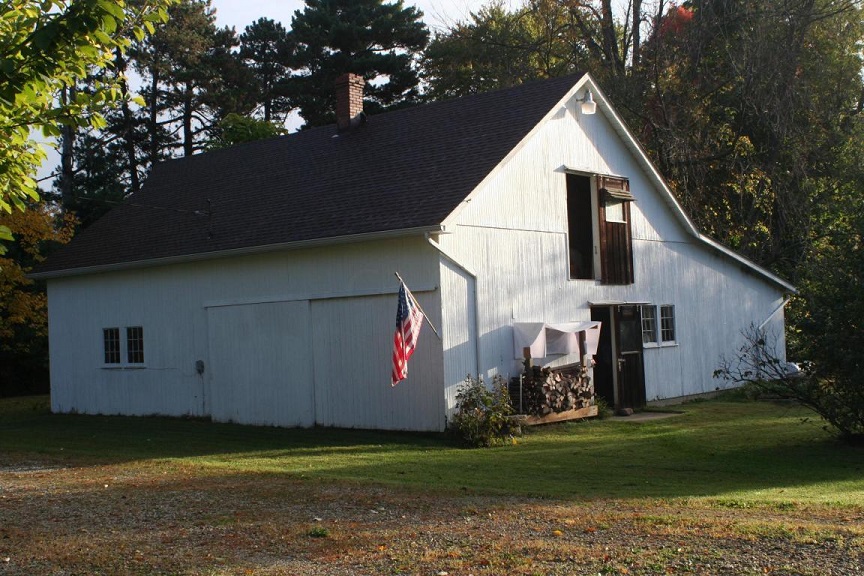

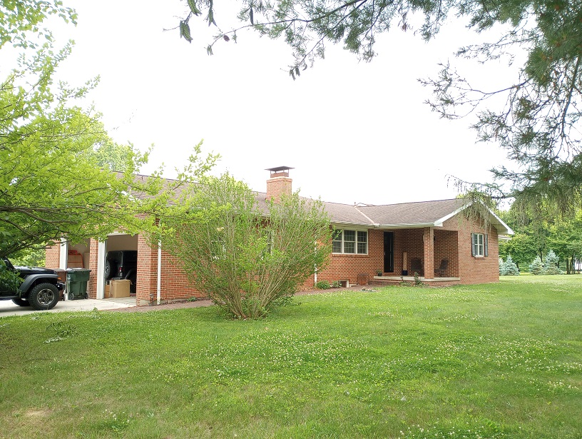

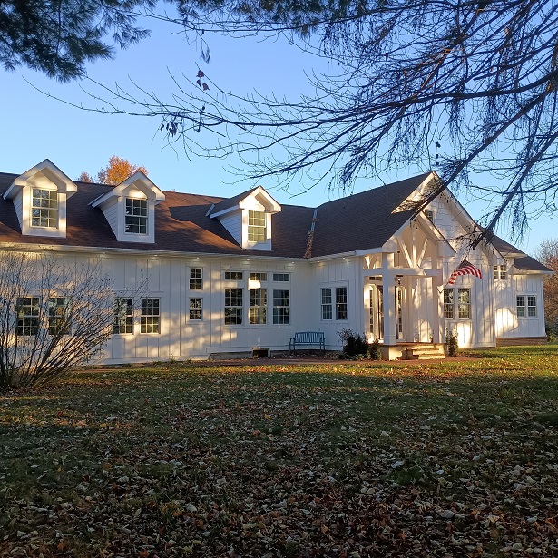

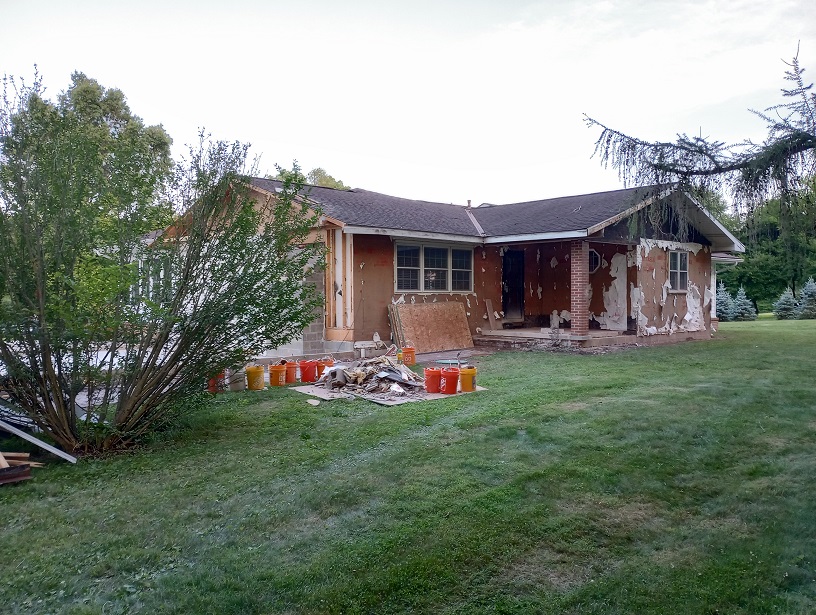

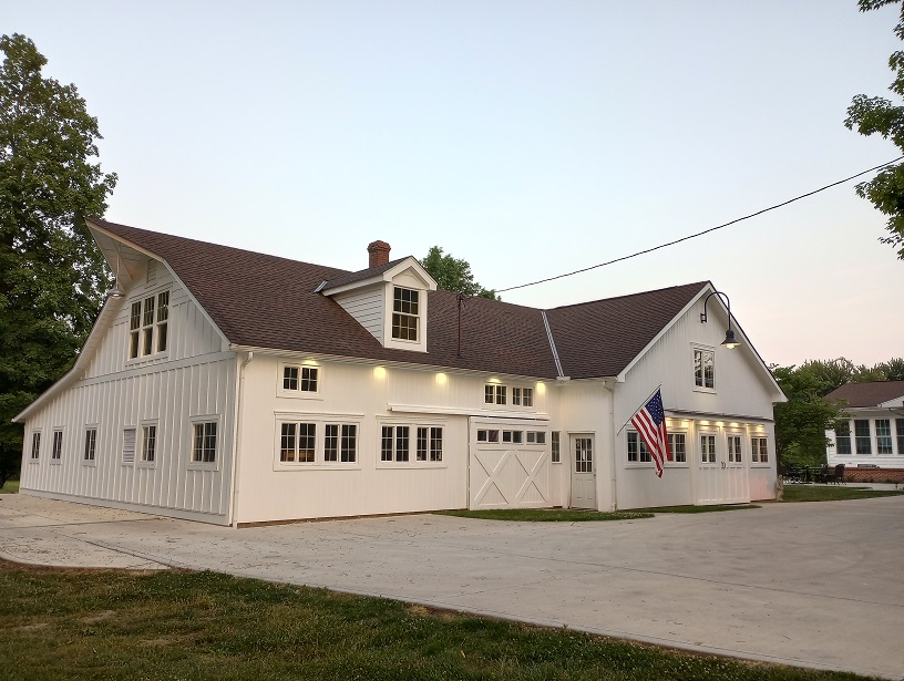

I quit my job to build my house and didn't skimp on the water or anything else.
It was a shit-ton of work, but my favorite part might be my water-waster shower - much better than my last house on city water.
