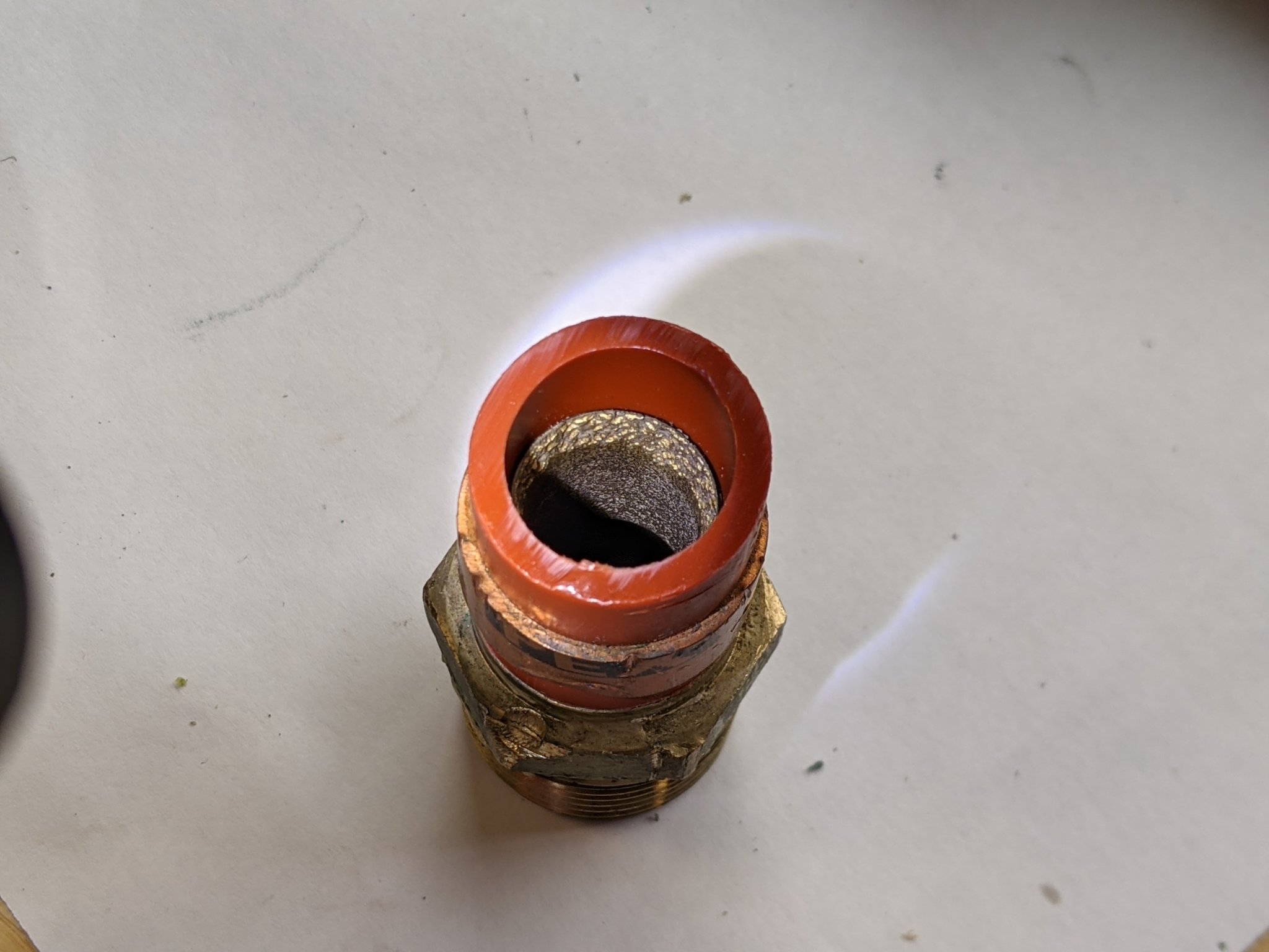

My tenant calls me the other day and tells me he has no hot water. He said I came home and the hot water heater was off and no hot water, so he lit the pilot. I told him it would take some time to heat up the tank, and let know if he had none the next day. None the next day either, so I head over. I get back there and I can hear water running through the hot water heater full blast. So I shut off the supply line to the hot water heater and it stops. We had the pipes freeze during that frigid couple weeks this winter. But all has been good since.
We get under the house, and there are two lines coming off the hot water line, that just go straight down to just above the ground. They appear to have had pipe fittings attached to the copper line, then had steal pipe caps to plug them. One was dripping and the other had completely rusty through. So there was a 3/4" line free flowing into the crawl space for at least 4 days.
I have a big squirrel cage red neck fan made from a swamp cooler blowing under now, so we can dry it out a little and get under there and solder new copper caps on the line.
Put the water heater inside some kind of catch basin, nothing deep, maybe 6 inches. Install a water shutoff sensor so if it detects water in the basin, it will close the valves and shut off the water. I have this on all my rentals. It will,save you many headaches. I also have them on the washer hookups.

Pex isn’t for exposed areas like crawl spaces. It will freeze as well. Best bet is to insulate the lines or even better encapsulate the crawl space, but on a rental not worth the expense.
It can be used for exposed areas. It will not corrode like galvanized or copper. It is not used in direct sunlight due to UV breaking it down. Pex will freeze but will thaw and return to normal service use without breaking (most of the time).
Crawling under this house is something like squeezing under a Honda accord.
You may be able to rent commercial dehumidifiers. Flex duct to blow the hot air into the craw space. If this were the SE, I'd be worried about mold and warping flooring.
Only thing we worry about around here is the water bill. It should be dryer than a fish turd in a sand storm for the foreseeable future. LOL
I am about 99% sure the pipes freezing had nothing to do with the leak. Even if those pipes were frozen, they don't lead to anything. You just never know what you will find in old houses around here. I am guessing 70 years of corrosion is to blame.
We lived there for years and never had a frozen pipe. We just have a young guy without much life experience living there. He had no idea, and I didn't think to tell him to leave the sinks dripping a little when it got extra cold. We were in the single digits to subzero for more than two weeks and got as low as -26. He keeps asking me to give him a man class, he is a good kid that recognizes his college, degrees, and work experience have left him without other important life experiences/skills. And he wants to be independent enough to not have to call someone to fix small things for him. Admirable. IMO
I swapped out copper for pex due to corrosion from well water.
Watch out for the fittings. Hard water can cause erosion, especially on the hot water lines. Here's one of the fittings my father-in-law pulled out of a cabin:

PRV is supposed to be piped to the drain as per city code. I could hear water running out the pressure relief valve if there was. Also the pipe would be hot from having hot water run through it. Also I can hear it draining through the washer drain at that house when there is water coming through the PRV.
