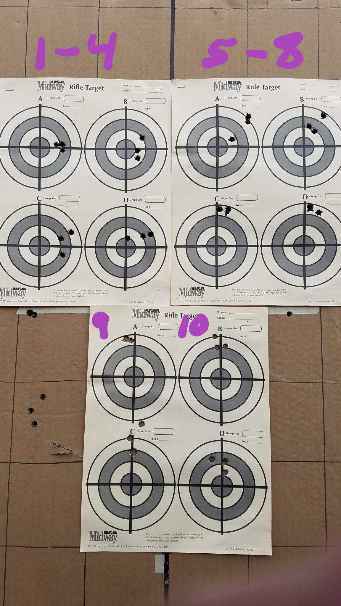

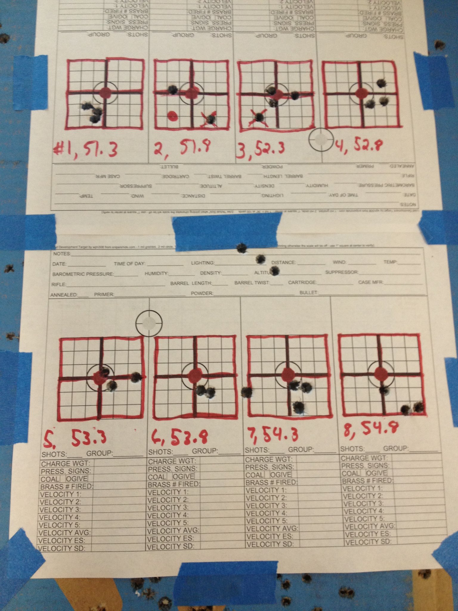

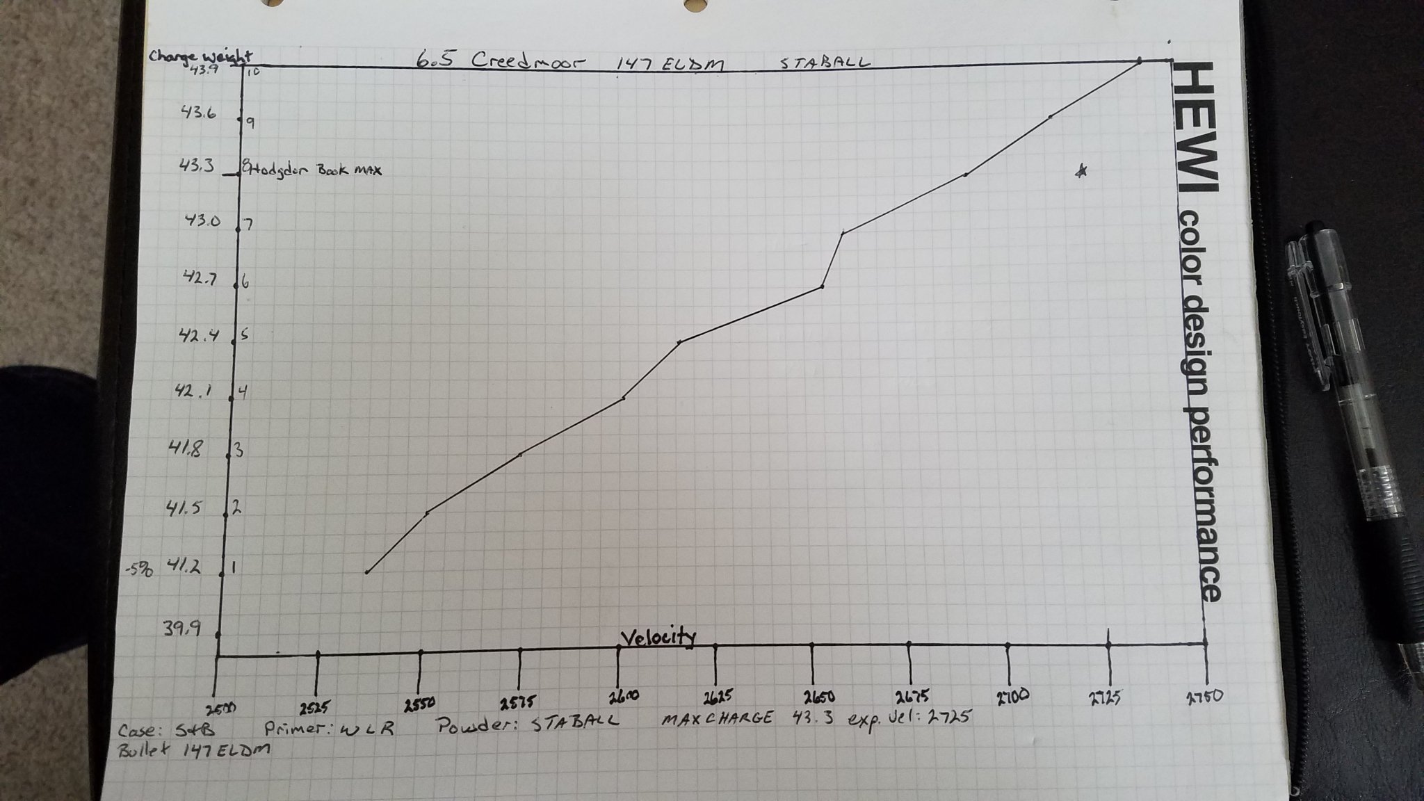

RE: POI movement with different powder charges.
Based on my limited experience actually looking at and for this, I have exactly one photograph that says it does occur.
Since that photo was taken, I haven't seen it in other rifles, but they have heavier barrels and it may not be as pronounced.
Here's the photo. The rifle is a Remington 700 with a factory threaded 6.5 CM varmint weight barrel. It was in a MacMillan stock.
The two positions that don't have the pink numbers are a different rifle and load.
The targets were shot on a nearly wind free day.
Chronograph data is here.
What does this tell us?
For me, it says that with the 147 ELDM and Staball, AND that particular rifle, it happened.
I suppose I should take one of my other rifles and test it to see if it occurs with it too...

ive seen similar a few times
also seen a bunch of barrels that seem to shoot every charge in the same spot over 3-5 grain spans...none of my rifles i shoot for accuracy are factory rifles though
i have seen a factory rem700 sps varmint 308win rifle that would stack 3-5 rounds, then as we kept shooting the POI would walk .3-.5 higher and groups would double to triple in size...the barrel wouldnt even be smoking hot, just warm...let it completely cool, and then it was back to normal, for 3-5 rounds, then walk and spread again...we confirmed it with 2 different shooters 2-3x that day
also seen a carbon barrel that would shift after 3-5 rounds...same situation, we repeated the .2-.3 shift multiple times with 2 shooters at 100 yds and 1000 yds

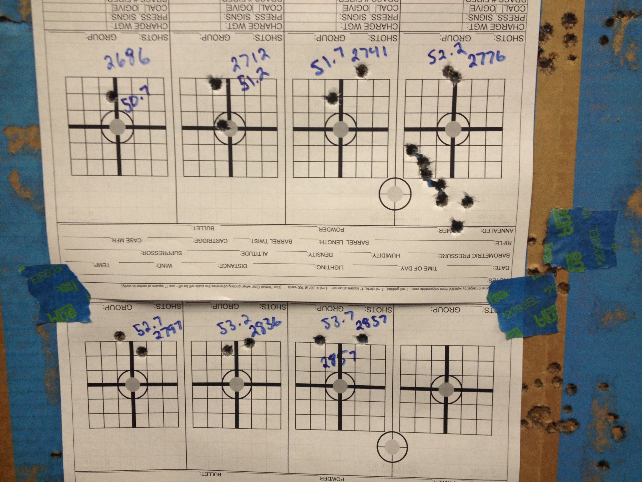

A pee shooter with an MTU barrel is not going to have near the amplitude in its barrel as a pencil profiled 300wm. I have seen OCW tests with the Dasher or BR where the POI didn't change for the entire range of charge weights. Those are rounds that are known to be easy to load for, possibly for that reason.
Here are two for a #5 contour x-Caliber barrel in 280, one is H4350 and one is H4831SC. I was hoping to find some from 6.5 Creed, 308, 300wm, and 243AI, but I can't find any pictures.
The big group on the second one was the entire work up fired over a magneto speed to get some velocity numbers. POI started low and moved up there too.
Groups doubling in size and walking around as barrel got hot was what made me re-barrel my factory Remington 308 and 300wm. My 308 and 243AI were Kriger barrels built by LRI, and are stupid accurate. The 300wm and 6.5 Creed are Criterion remage barrels, they are pretty darn accurate hot or cold, and don't walk. Same goes for my #5 X-caliber barrel in 280.

I can name 1 engineer that says nodes are bullshit and move from day to day. Says OCW AND ladder testing aren't repeatable.
Scott Whitehead. Hes a member here but I forgot his sn. We had a lengthy phone convo about it last year.
Just because someone is an engineer does not mean they have any clue what they are talking about.
And this statement is coming from an engineer.
I have worked with complete idiots with PhDs, and absolute wizards that could barely write their name. A piece of paper on the wall has only limited bearing in the likelihood that someone is a true expert on a subject.
Nodes and anti-nodes can be tracked with slow motion cameras and correlated with results on paper. It’s easy to see course nodes. It’s hard to distinguish minute changes in those nodes with small things like primer pocket methodology, due to shortcomings in the platform and shooter.
Which part of OCW does he think is not re-peatbale? POI shift between powder charges? If I have learned one thing about OCW online, its that I can't trust anyone to actually know what it is, or how to set up the test. I have seen multiple people refer to their velocity tests over a chronograph as "OCW testing." Even more looking at group size.
I would want to see someone's tests who says OCW isn't repeatable, because I have found it to be repeatable, personally reshooting with the same results, and I have also seen other people's OCW tests with the same results. I have seen a lot of OCW tests showing a node around 41.5 of h4350 with a 140g bullet. Same with 43.2 of Varget and a 175. Same with 23.2 of 8208 and a 77smk. {these are of course dependent on what brass you have. Different brass will need different charge weights. That was probably the best part about only having 1 kind of brass for the 6.5 Creed for a long time. It really shined a light on the idea that there are nodes and they are repeatable from gun to gun.
IT seems to me we have moved into a realm where some people are saying harmonics don't effect accuracy, which is false. Some also seem to be under the impression that any powder charge will shoot just as good as any other, which is also false. What has been presented to the class, is that a bad load might night be much worse than a good one, so why waste your time if you can't shoot the difference. A lot of the class, took that to mean there is no such thing as good and bad loads, which is patently false.
If I take a powder ladder with 35 shots each... And I run 7x OCW tests, and they don't all achieve the same results.. okay...
What was the point?
It's the same story over and over again. Individual offers a 1, 3, or 5 shot method of load development to narrow down the best shooting load. I shoot 20x or 35x or 50x at each variation that the method suggests, and the method does not reliably give the best results. Even if the repetition of the method eventually AVERAGES to the best results, running the method a single time is a gamble.
You've been using the method for years and you're happy with it. How much does it matter then?
Don't get me wrong, a better shooting load is a better shooting load. Harmonics are real and it's blatantly apparent that changing mass distribution and rigidity of a barrel changes how it shoots.... Gotcha. MY beef is with how people "test" and believe the results of wishy-washy data sets. 5 shot groups are not repeatable, and do not reliably accurately represent anything of the population of shots of THAT load from THAT barrel without multiple repeats of the same "test" and then math applied to the averages...
I guess first off I would want to see your tests.
Next I would ask you if you ran the same experiment 10 times, do you think you could get identical results each time? If you don't does that mean the hypothesis is disproven?
Do you remember doing labs in science class? How many peoples experiments failed? Did they disprove the science because they performed the expememnt wrong?
Last I am staring to wonder what you think OCW is. I am not even sure we are all the same page there. You aren't shooting 7 OCW tests with 35 rounds. And "powder ladders" don't have anything to do with OCW.
