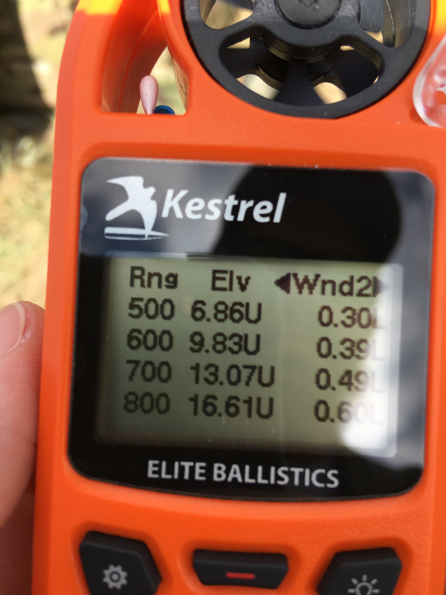

The 'range card' is a function within the Elite. You present the range interval (10, 25, 50, 100 yards), and the display provides a column for range and corresponding elevation adjustment, and there's a third column to scroll through Wind 1, Wind 2, remaining velocity, remaining energy, etc....crappy photo attached

Not necessarily in accuracy, but in work required for accurate solutions. G1/G7 often need to be trued up for accuracy. CDM/4dof is about as close to plug n play as you get.
Reactions: seansmd
Just going by other threads that have mentioned the more different ranges Hornady is running dopler on their curves vs what the AB model uses for ther CDM with their doppler. I know I couldn't see the difference for sure either way.
Would love to see an independant and current view of both models, and supporting data models that support them.
Yeah, a comparison of those two would be great.
To all:
I emailed Kestrel and only the Standard 5700 can be upgraded to the Elite, not the Hornady and not the Ruger, because they are both using a different software (not Applied Ballistic).
That said there are significantly less bullets with 4dof data ...
Well, but if you have a BC for a specific bullet you can put that data in, any bullet with any BC, can´t you?
And if so, can you save that data in both, Hornady 4DOF and Elite, for later use?
:unsure:
:unsure:
Yes you can, but then you are down to using the G7 which should be the same on both. The uniqueness of the 4DOF is is a more complex coefficient that create a more accurate curve, measured with actual Doppler. AB custom curves are similar in that they are supported by Doppler. Some on these pages have said that the 4DOF is more accurate with more measured data points for the bullets in their database. If you plan on using G1/G7 there are lots of ways to get accurate data, the Kestrels only added benefit is a device in the field that integrates environmental and the G1/G7 ballistics curve vs using a phone app and environmental data from elsewhere.
If you plan on using Hornady ammo you are good to go, and they are adding more bullets with each release I believe. The Hornady version does not have some features the Elite has on the AB, more gun profiles, and the range card I believe.
Reactions: Jayjay1
