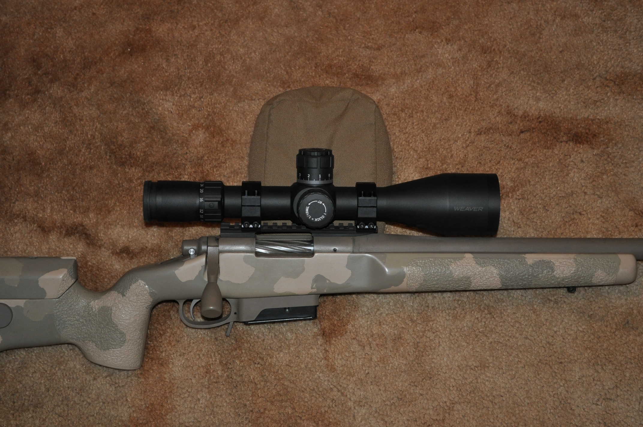

Finally took the time to get the new Weaver 6-30x56 tactical scope mounted on my M700 260 Imp 30* (replaced the Bushnell 3.5-21x50 temporarily with it) today. Vortex (Seekins) low (.92”) rings gave decent objective clearance, though it might be beneficial to have more to help avoid bbl mirage degrading the image through the scope. No issue if there’s a breeze to dissipate mirage off a hot bbl, but still...
Got the scope zeroed at 100, then set the zero stop – pretty easy procedure, though Weaver’s zero stop doesn’t allow for any clicks below the set zero like the Kahles K624i does. Next step was to run a tall target test, with my target points 28” apart. Figures out to 7.7777778 mils, so I used 7.8 mils, through three two-shot series. Got impacts 28.25”, 28.75”, & 29.0” apart. That averages out to 28.666”, for a ballistics app correction factor of .9795, which worked out pretty well when I used it back at 600yds – 1st couple of shots were within a quarter minute of point of aim. Speaking of clicks – they’re audible and pretty tactile – IOW, you can both hear & feel them. The turrets are large enough in diameter to keep the spacing between clicks (and knob hash marks) wide enough to make it pretty easy to tell what you’re doing. I never had any issues getting exactly the number of clicks I wanted.
So it appears to track pretty well – how about optical quality? Not as clear as the Bushnell when it’s set at 30x, and to tell the truth, I ran out of time before I could do any other comparisons between it and the Bushy and/or Kahles. That’s just gonna have to wait for a day when I’ve got more time, which could well be after fall harvest is over. However, I could easily see the 1st shot from 600 that hit the 3” spot of black paint sprayed on my steel IPSC targets as an aiming point. There was enough breeeze (‘bout 8mph) to keep whatever mirage there was from being a huge detriment. I’d really like to do a direct comparison between the Weaver & the Bushnell GZ series 4.5-30x50 with both set at 30x – that’s all it’d take to make it obvious whether the Weaver’s glass is of comparable quality as Bushnell is using in their 34mm scopes. As it is, I kinda doubt that’s the case, but only a direct comparison will convince me one way or the other.
I liked the open center reticle, but not as much as I like the Kahles’ open center. The Weaver’s is either too small, or the optical quality isn’t good enough, to keep track of a 6.5mm bullet hole when used as an aiming point at 100yds. What the Weaver’s reticle does lack is any 1/2 mil hash marks inside the 1st 1 mil dot. So if you want or need to hold off a half mil (wind or elevation), you’re screwed. Beats me why Weaver didn’t put more effort into designing a reticle with more usable features when they set out to market a scope to compete with others in the 34mm tube category. Maybe that’s why Midway had these scopes on clearance for $1126 – Weaver’s realized the error of their ways, and are on the verge of releasing a new model based on this scope with a better reticle? I sure hope so, ‘cause I kinda doubt they’re going to have many takers – even that this low price – unless/until they do so.
I’ll be doing more shooting with this thing at every opportunity, and hopefully will have the chance to compare it to my Bushy & Kahles scopes before long. I have a nephew in the K.C. area with one of the Bushnell GZA 34mm 4.5-30x50 scopes – might be able to get him to bring it out for a side-by-side comparison with the Weaver before too long. Sure would be nice to be able to get the Weaver with the G2DMR reticle....

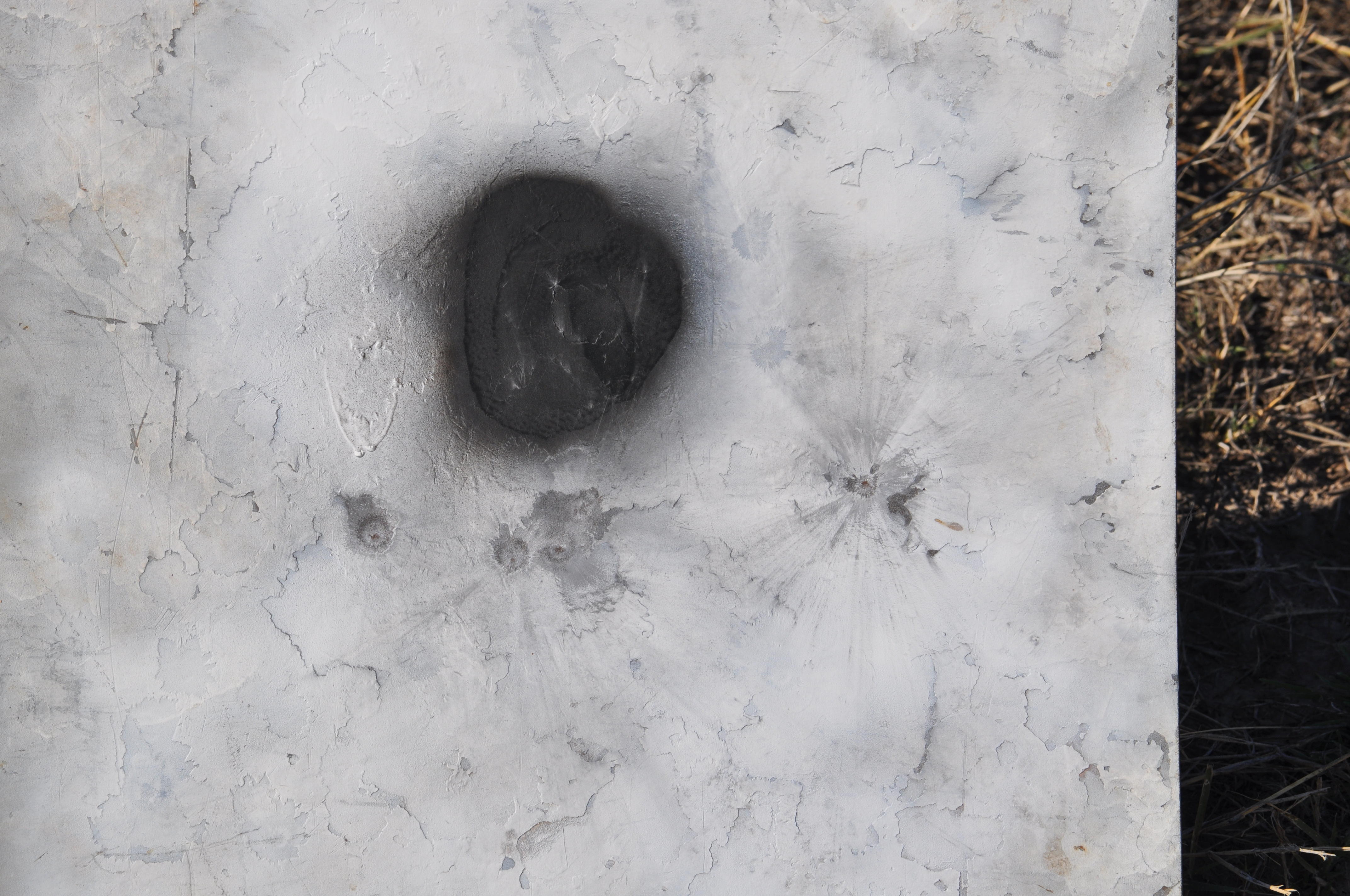

At any rate, the app called for a 7.4 mil come-up, but it wound up requiring 8 mils to get centered on steel IPSC targets. The four shot group (first one was a miss which I corrected off of) was spread 7-1/4" horizontally, but had only 1-3/8" of vertical. Given the variability of the wind, from 2:00-3:00, near calm to about 5mph, I don't feel at all bad about the horizontal spread. If I can bump the speed up a bit without introducing an increase in the vertical spread, I'm golden. Whatever - I again was running the scope at 30x, and even with the slight miarage running from right to left, could see what I thought were bullet splashes on steel. Not real distinct, but as it turned out, what I was seeing were indeed the splashes. No more distinct than they were up close, I'd say the resolution & clarity of this scope are pretty decent.
The .6 mil low impact is something I believe I'm going to have to deal with by training my app. The scope's correction factor I entered in the app (see post#71) only works out to about 600yds - after that, the impacts are progressively lower than what the app calls for. I'm seeing the same thing with the Kahles K624i AMR scopes on both my 6x47s, so it's obvious that I need to buckle down and get to work to train the app. In fact, I also shot the Bighorn 6x47 with the Kahles yesterday, and saw a similar result with low impact using S107MKs from 995yds. But, after that, I shot some Berger 105 Hybrids, and had to come DOWN a tenth & take off .2 mil from the app's recommended wind correction. So it would appear that the G7 BCs for both of the Sierras are a little high, and that of the Hybrid a bit low, rather than my chrono data being faulty. Hard to say for certain whether it's entirely the BC, velocity, or a combination of BC & velocity. I can get back to 1200yds on my range without moving the targets away from the backstop, so I'll try the training method on the velocity side of things first and see what happens.
Long, drawn-out post, but I'm still pleased with the Weaver. However, I will continue to lobby for a more capable reticle.
