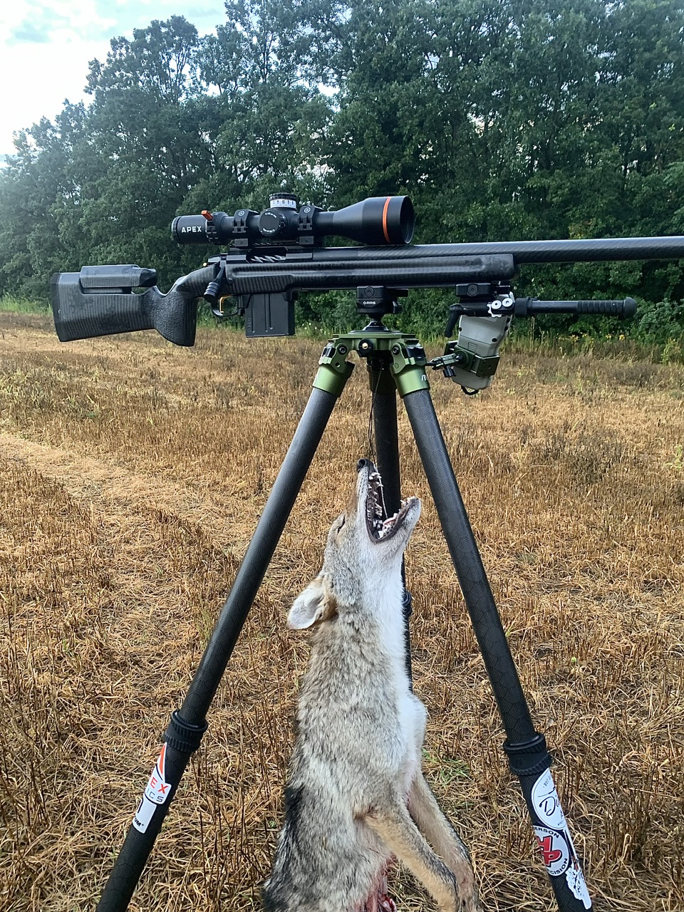

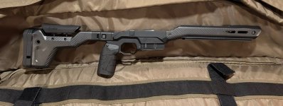

Sounds like a mid-length carbon fiber barrel in any flavor of 22 centerfire with an HNT26 would be ideal. That’s what I am working on anyway. TL3 and a couple of prefits and you have a versatile setup.

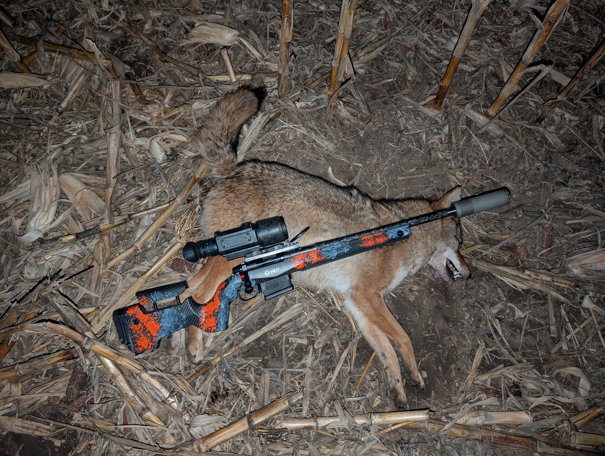

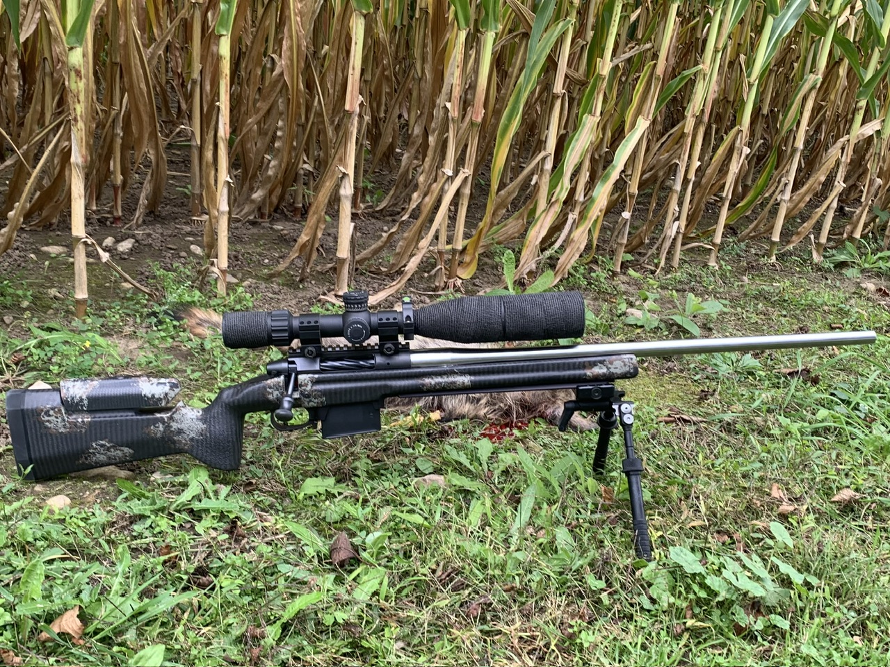

After a bit of trial and tribulations, I found my best and favorite setup. 22 GT, Hornady brass, H4895 pushing 60 VMAX at 3500fps flat in a 18" barrel. Running the Sico Sythe and the MDT CRBN stock (and also the XLR 4.0 Mag) make for a light hard hitting combo and I rarely ever damage fur.

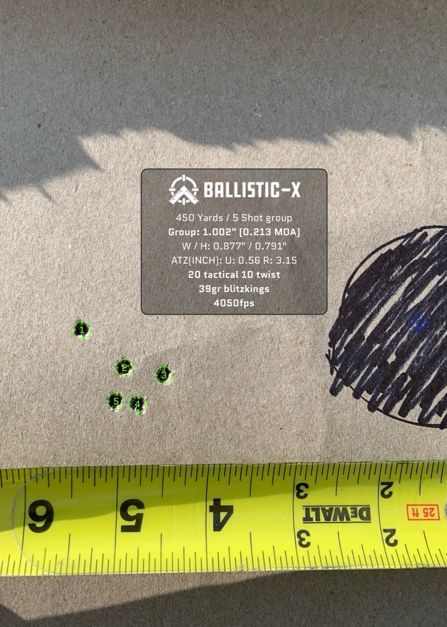

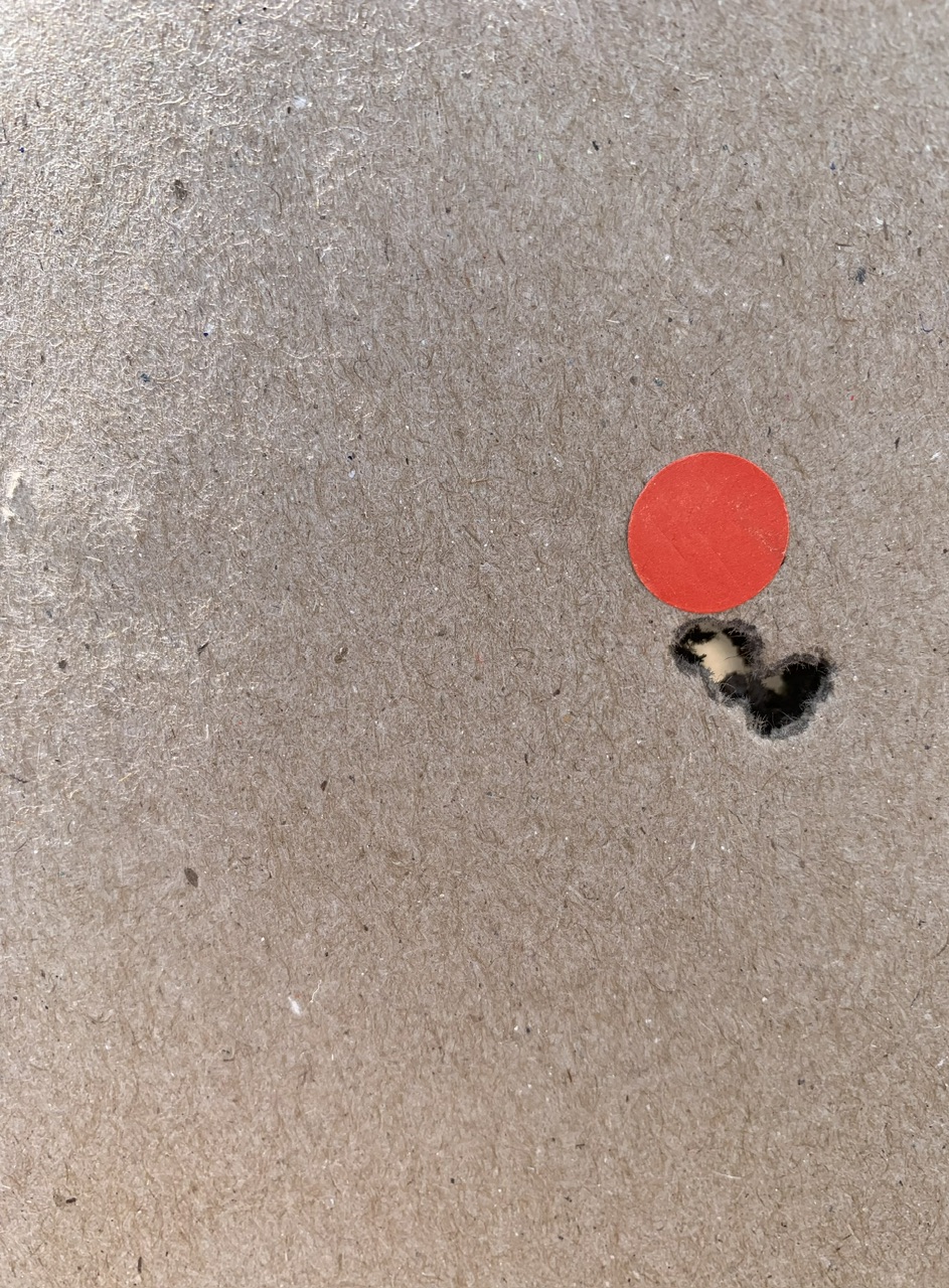

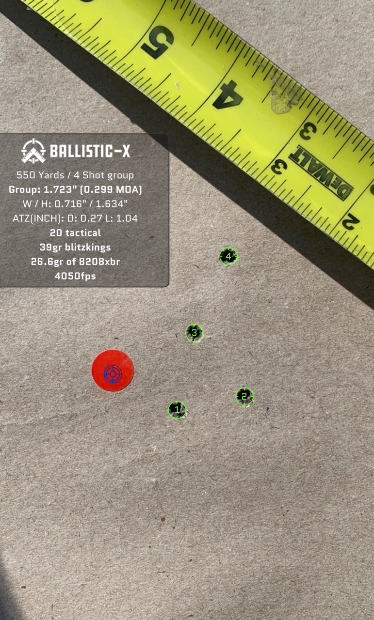

For 300 and in a 20 cal would be my choice for sure. Im running a 20 tac with 39gr blitzkings at 4000fps and 35gr bergers at 4050fps. Super fast, super flat and hammers yotes. Inside that 450 yard range it’s lights out. A 204 would be the same. Here’s some 20 tac groups
Ballistic-X-Export-2023-09-20 15:36:18.427923.png
Ballistic-X-Export-2023-09-15 14:40:54.181773.png

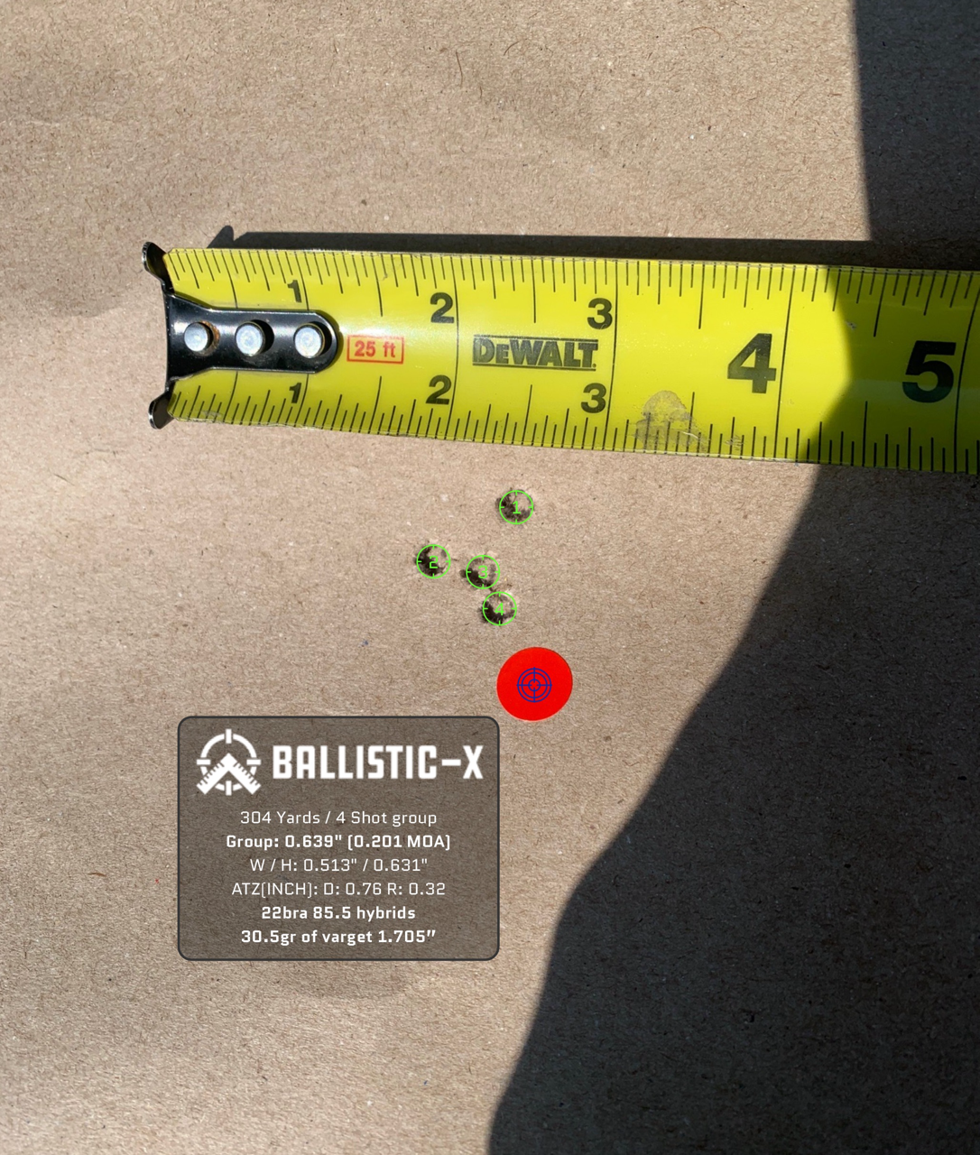

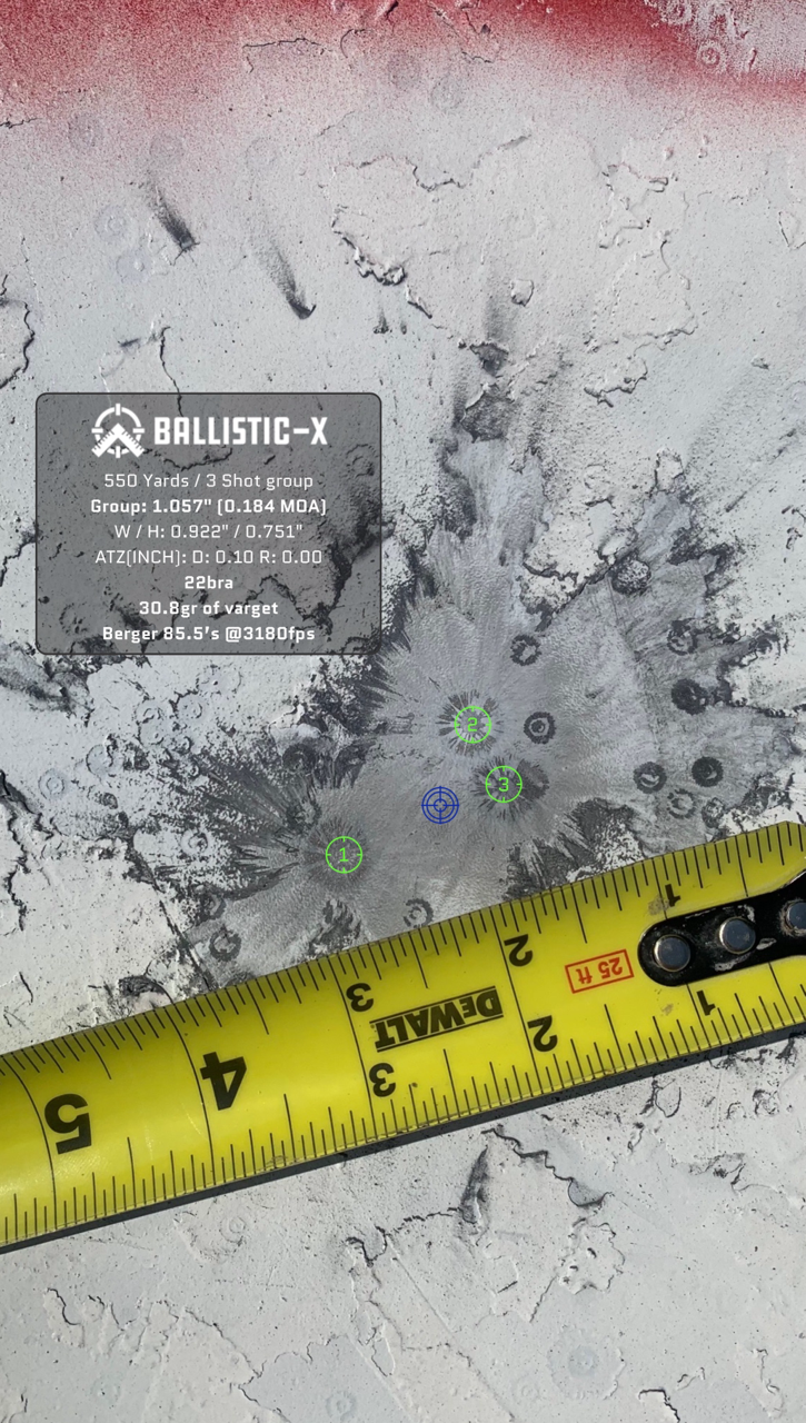

I also love my 22bra. I’m running 85.5’s at 3100-3130fps but have pushed the 75gr eld’m’s to 3400 and could imagine the 60gr bullets would be 3500+
Ballistic-X-Export-2023-09-06 10:29:59.582560.png
Ballistic-X-Export-2023-06-29 19:07:32.581460.png
