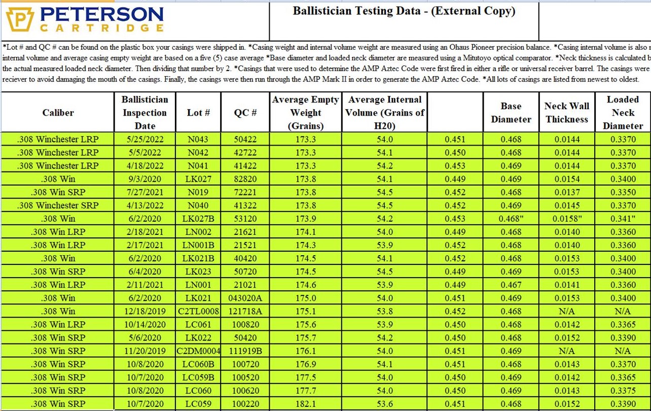

That's what I did for a test to see what the difference might be. For a box of .308 Lapua brass, I sorted them (see pic below) and compared the difference I found with that of those from the same weight.
I fired 5 of the lowest outliers and 5 of the highest outliers and found significant difference in average velocity (this test was repeated 3 times with the same cases). Then I took 10 cases of the same weight (see column in picture below for 172.8-9) and run the same test 3 times firing two 5 round groups. The average velocities for each of the sets of 5 outlier cases was as consistent those of the same weight, though the velocities were not the same and the POI's between the high and low outliers were not the same. Those of the same weight, each 5 round group were very consistent in all 3 tests.
While I found no direct correlation between any of the case's weight and volume, as an average of a group of case weights, I find there's often a notable difference in what I get on paper when there's a 3 gr or more spread . . . especially at distance.
Looks like both our tests suggest that weight sorting cases is a good practice. Thanks for posting this.

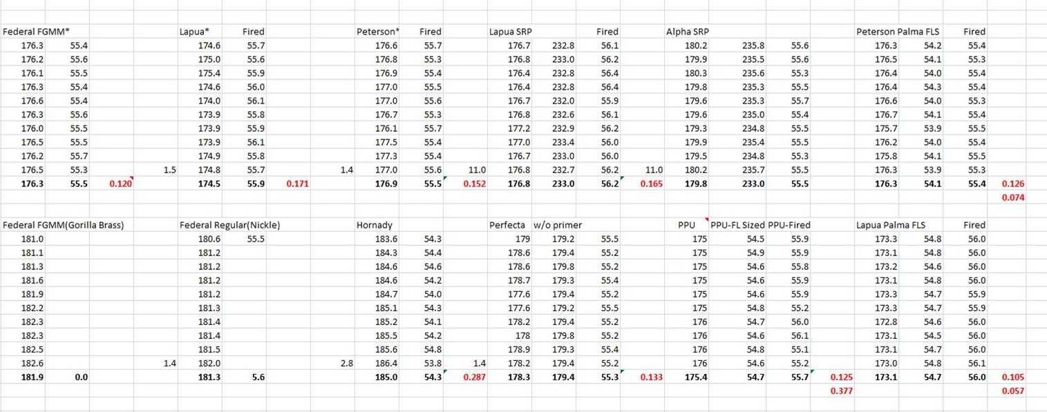

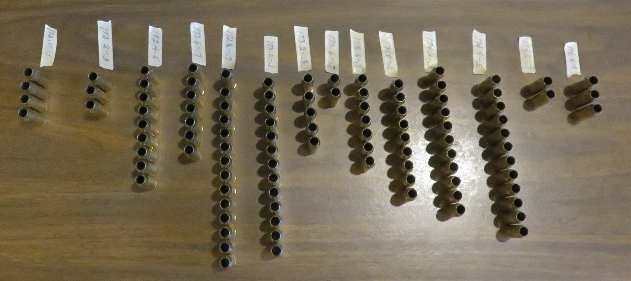

A few data points on the subject matter . . . .

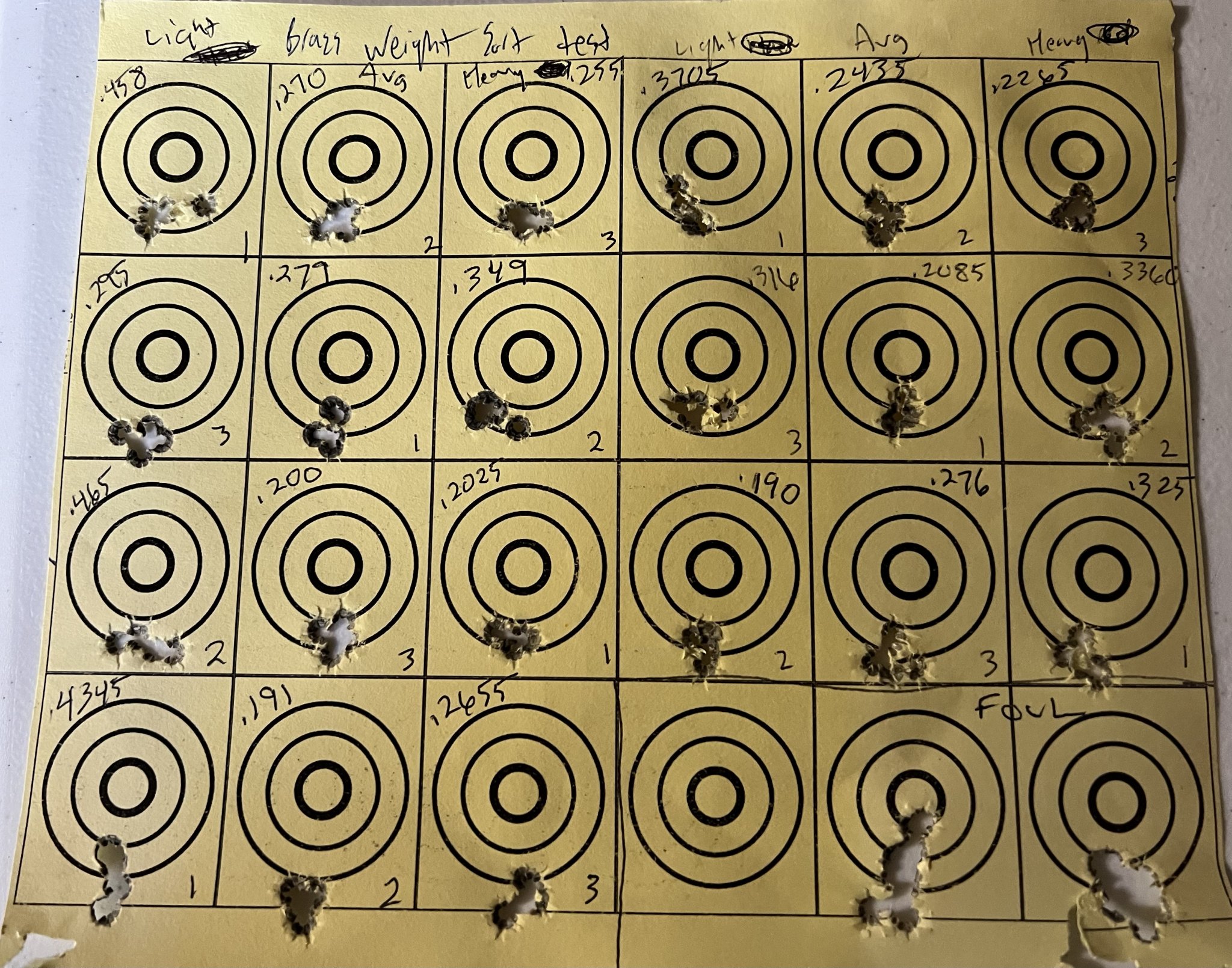

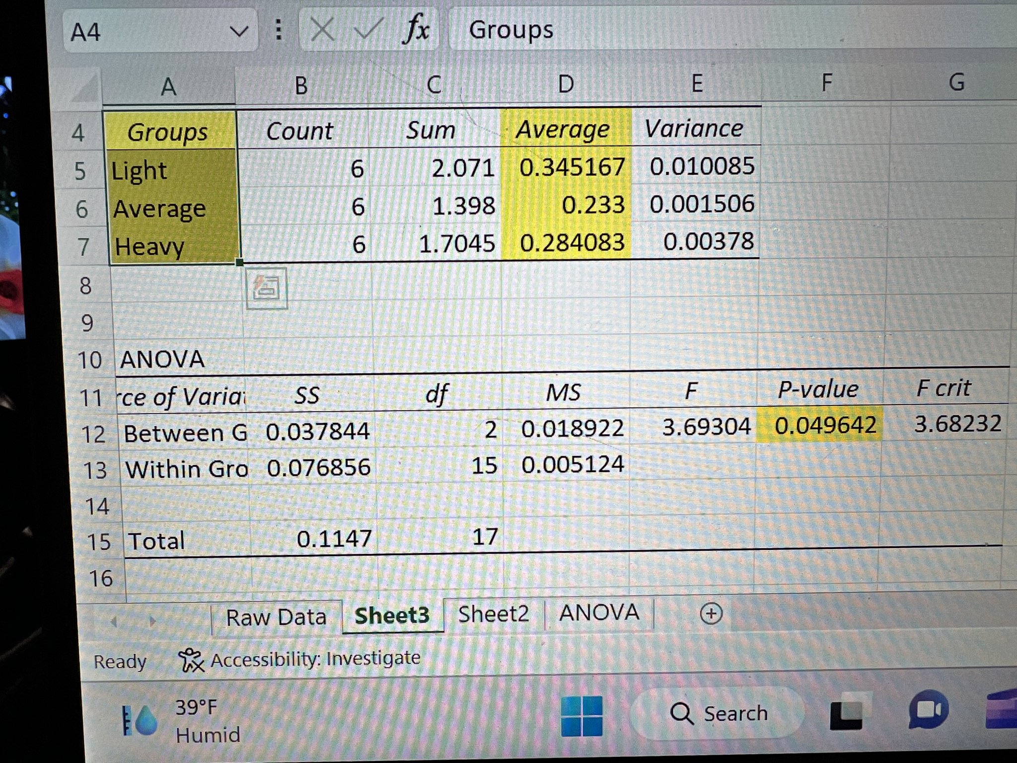

hallo
so if i understand correctly; you didnt find any velocity variance between your light and heavy brass?
your metric for group size is 'average to center' or just the biggest group size from two most distant shots?
and you shot 5-shot groups?
sincerely
No velocity differences, and groups were 5-shot measured center-to-center.
nice findings, but wrong conclusion.
if there were no differences in velocity, than it's pointless to weight sort brass. bad groups are your fault and too small sample, not fault of the brass weight.;)
We finally got one of those irrelevant comments! Yay!
Just in case anybody is taking the MarkyMark comment seriously, the sample size is more than adequate to detect a difference because it did detect a difference. The sample size needed to detect a difference is largely determined by how much of a difference you expect to find - larger differences = smaller sample sizes and small differences = larger sample sizes. Since a difference was detected, the sample size was adequate. The MarkyMark post is a perfect example of the “irrelevant” post and the type of post that can needlessly throw people for a loop because it was uninformed by actual statistical principles. An informed post would say “sample size was adequate because the ANOVA detected a difference.”
That's not the same thing as showing that it's a reliable result. Getting a statistically significant result in one test doesn't mean it's a settled conclusion. "Statistically significant" tests do not mean that robust, reliable conclusions are being drawn.
Specifically, data anomalies and omitted variable bias are very real things, as well as correlated errors and things like that that break the underlying statistical assumptions of your tests.
For instance what happens to the result if you omit "group 3" from the test? Small samples are very sensitive to outliers in the data.
Seems like your pulling a strawman here by first mentioning sample size and then later replicability. Two different concepts. The sample size was adequate to detect the difference…that much is simple. As for replicating the test, yes, by evidentiary standards we would want more replications to strengthen the conclusions. This is why I post these tests to forums like this to see if others have tested similarly. There is a post on this thread that showed that somebody did a similar test and found differences in precision based on the case weights which is the root finding from my test. Seems like the evidence is mounting. As for other variables, there are many controls built in to my tests that rule out or mimimize to a great degree the other variables.
Are the groups in the vertical columns or labeled by 1,2,3- light, avg, heavy?
The codes for the various weights are by column so column 1 is light, 2 is average, and 3 is heavy and then it starts back over on the next three columns. The numbers 1, 2, and 3 written on the target is the order the groups were shot on the same day. I shoot the codes in different orders to eliminate order effects. I have a coder code the various weights prior to the test to make the test blind. After the test is done and the data is input and analyzed, I open the sealed code envelope to see what the codes mean and then write them on the target and include them in the database. In this case, my coder was clever and ordered them in a linear fashion - light, average, and heavy. My coder doesn’t always code them in a linear way…just so happens this is how the coder did it for this test.
No, it's not a strawman. Perhaps you think I'm making an argument that I'm not. I did not say your results didn't meet your criteria for statistical significance. Nor did I say that I think your hypothesis is wrong, for that matter. I am saying that "statistically significant" isn't some magical thing that separates true from false. Further, all we have to do is change our standards for significance, and it goes away. What if we require an alpha of 0.01 instead of 0.05?
While sample size and replicability may be two different concepts, when it comes to small samples (which your is), replicability is prescribed prior to drawing major conclusions... so the comments about sample size are not as irrelevant as you might hope they are. Replication is one form of larger sample size. The point being, you should be careful claiming your test means more than it does. Looking at your data, there is the obvious chance that one bad group caused the entire result. This is why I mentioned one of the checks that is frequently done in test like this, outlier testing. In small samples, one weird observation can create a "significant" result. What actually happens is that small samples often underrepresent the true population variance, and if you get one oddball observation, it tests as significant, even though in reality it's just a small sample effect. That's the origin of the whole n-1 adjustment to variance, after all.
So, once again, what happens to your results if one labeled "group 3" on the X-axis of your group size chart at minute 3 is removed?

I don’t see any outliers that could have driven anything in one direction or the other. The outlier analysis didn’t indicate there was an outlier. After removing a set of data with what could be an outlier, the p value was still below .05. Say what you will about the arbitrary nature of .05 or .01 but having 95% confidence that an entire distribution of various values is not random is enough for me and almost all of the scientific community. The armchair theoretical points you make don’t have a bearing on this accepted practice…if it did, then we wouldn’t be able to use statistics for anything to help us understand any of the phenomenon studied in science. Feel free to armchair all day and come up with reasons to dismiss anything but please don’t use that to potentially mislead people from considering what is likely important to precision shooting.
There's really no question that heavier cases will have less internal volume than lighter cases resulting in higher pressures that push the projectile faster, which can change POI's. Molon's post above illustrates that clearly in terms of velocity. The issue here is really whether there's enough of a relationship for case weight to internal volume that makes enough of a difference to justify sorting cases by weight. Because there can such a difference in case weight to internal volume on any individual case due to distribution of the brass alloy through out a case, to quantify the relationship of a set of cases can be difficult. But, if there's a significant difference between high and low outliers, sorting them out can be a measurable benefit; and how much benefit really depends on the type of shooting one is doing. Like if one is only loading for hunting to take down game at 200 yds. or less, small improvements that might be achieved by soring out outliers for a long range benefit is pointless.
The facts are that there's a relationship for case weight to case volume. Variance in the distribution of the material of the cases muddies up the waters making it difficult to quantify. The more uniform the cases are the less one is going to able to find any benefit to sorting for the variances by weight. But, one will not know how much variance there really is unless the cases are measured. 🤷‍♂️ ;)
Reactions: Sniper King 2020
What set did you remove, and what were the results? I was being specific, and it's easy enough to post the results.
The first. Again though, there were no actual outliers so the selection of that particular set was actually driven by a request from a shooter to eliminate the fireform set with the rationale that most shooters at matches for extreme precision are not fireforming loads. For that rationale (a relevant and realistic rationale vs armchair), I removed it and reran the analysis. Results were the same.
Ok, that's not the group that I was asking about. But I see you're not interested in it.

Here's some data from my spreadsheets that I've collected for some of the brass I've used and one from Peterson Cartridge company that might be insightful for some along this line:
Is that Peterson data somewhere on the web where I can download it in some kind of raw data file format like Excel? Seems ripe for a multiple regression to see if certain measurements predict case volume and weight.
I don't recall where I downloaded it directly from, but I do have their file in Excel. But since I can't download an Excel file here, I can change the extension to "PDF" so you can download it here. After you've downloaded the file you'll need to change the extension back to .xlsx to get at the data.
  • Peterson Cartridges.pdf
