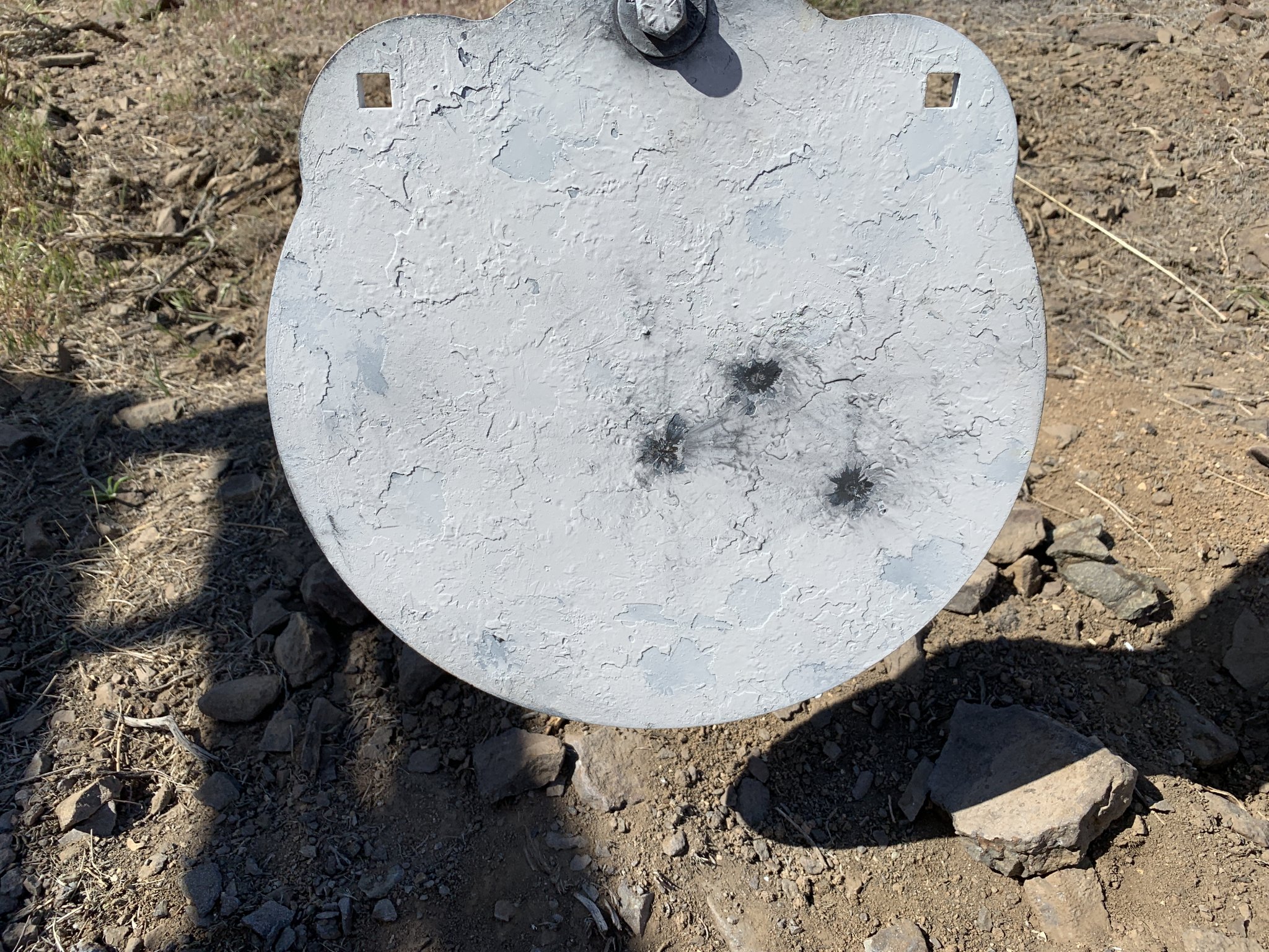

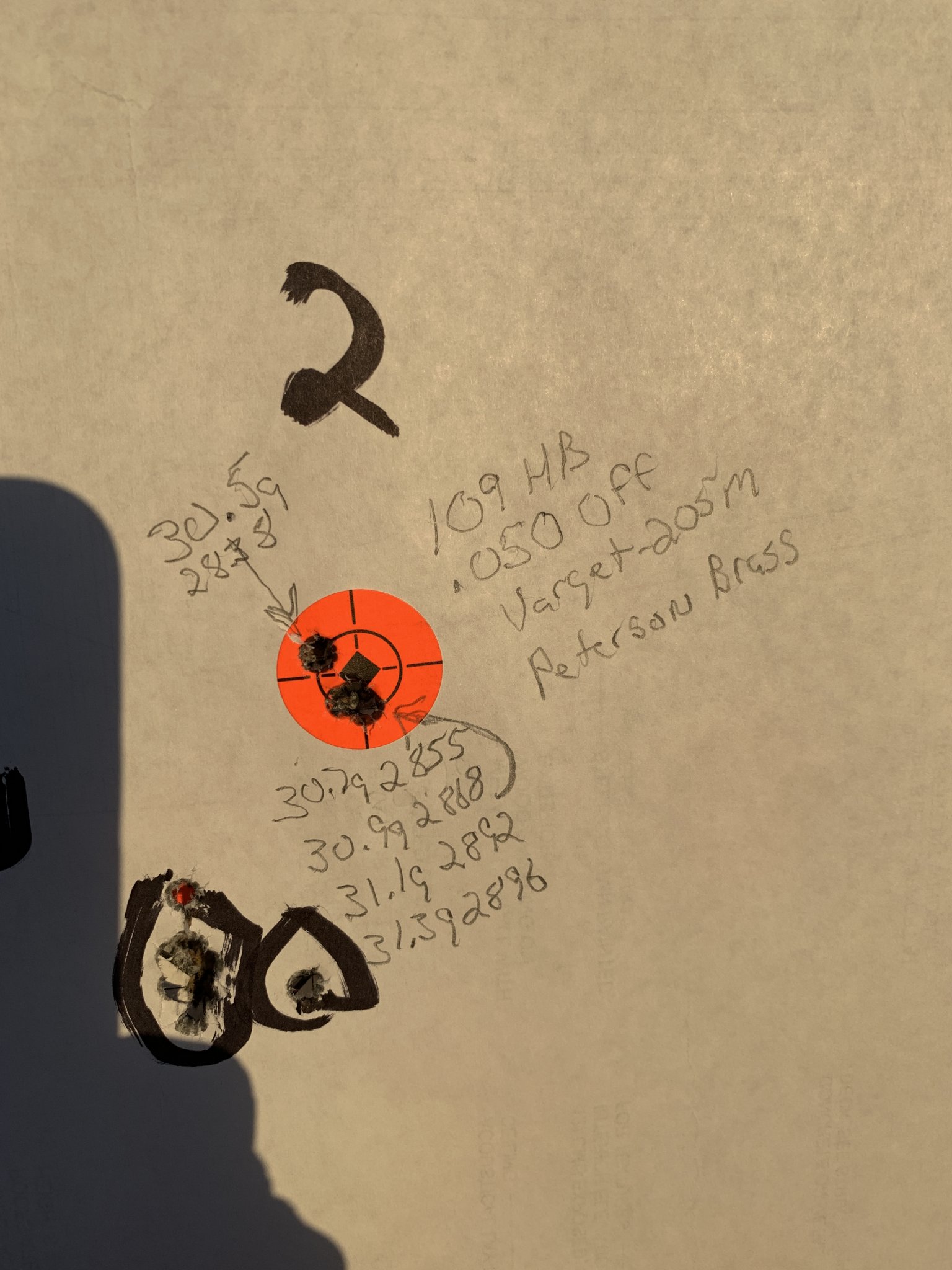

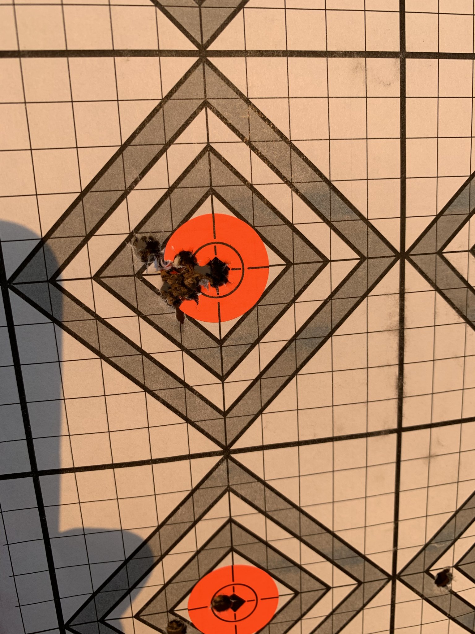

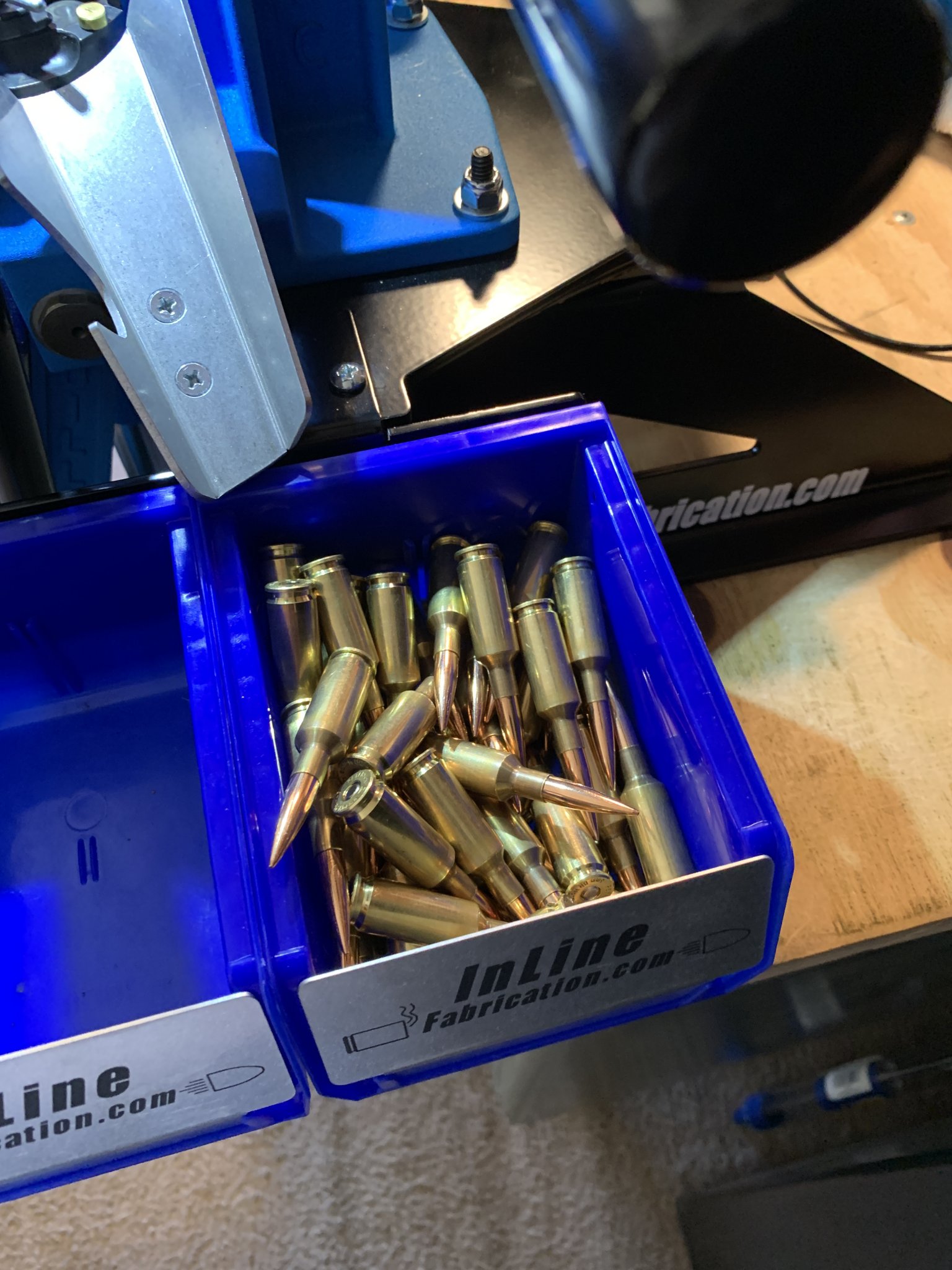

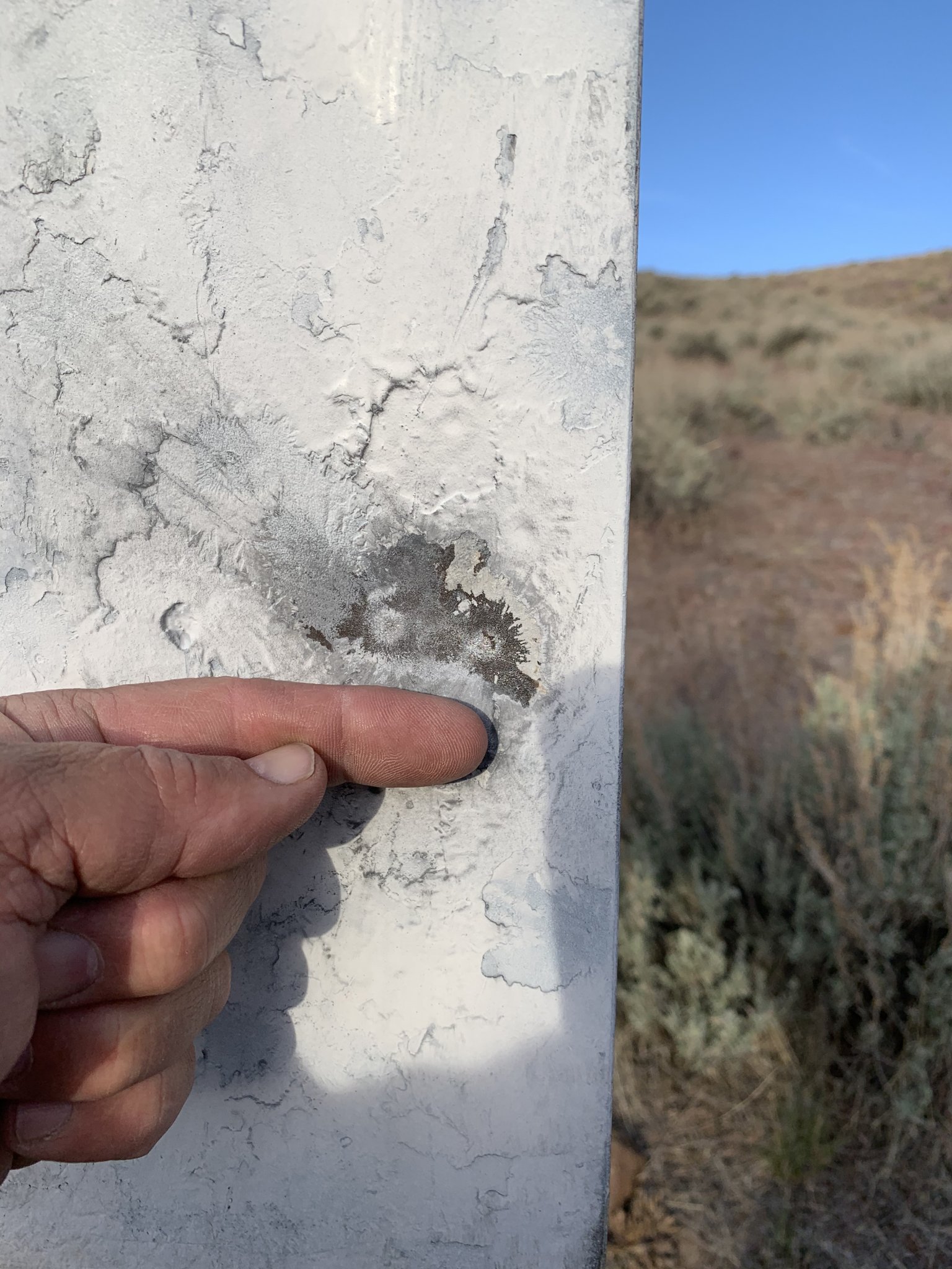

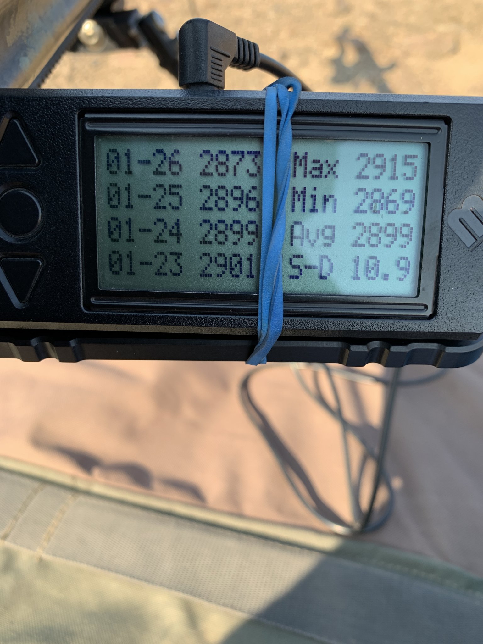

pics are not in order so bare with me here.....THESE ARE ALL LOADED DIRECTLY OFF A DILLON 550...
this is my 6BRA 109 hybrid .070 off the lands at 600yds
same day at 850yds
again loaded straight off a dillon 550
same day all 26 rounds shot over the chrony...round #1 is the one left of the 100yd group...cold clean to metal barrel
same day 10 rounds at 100yds
same day at 850yds
