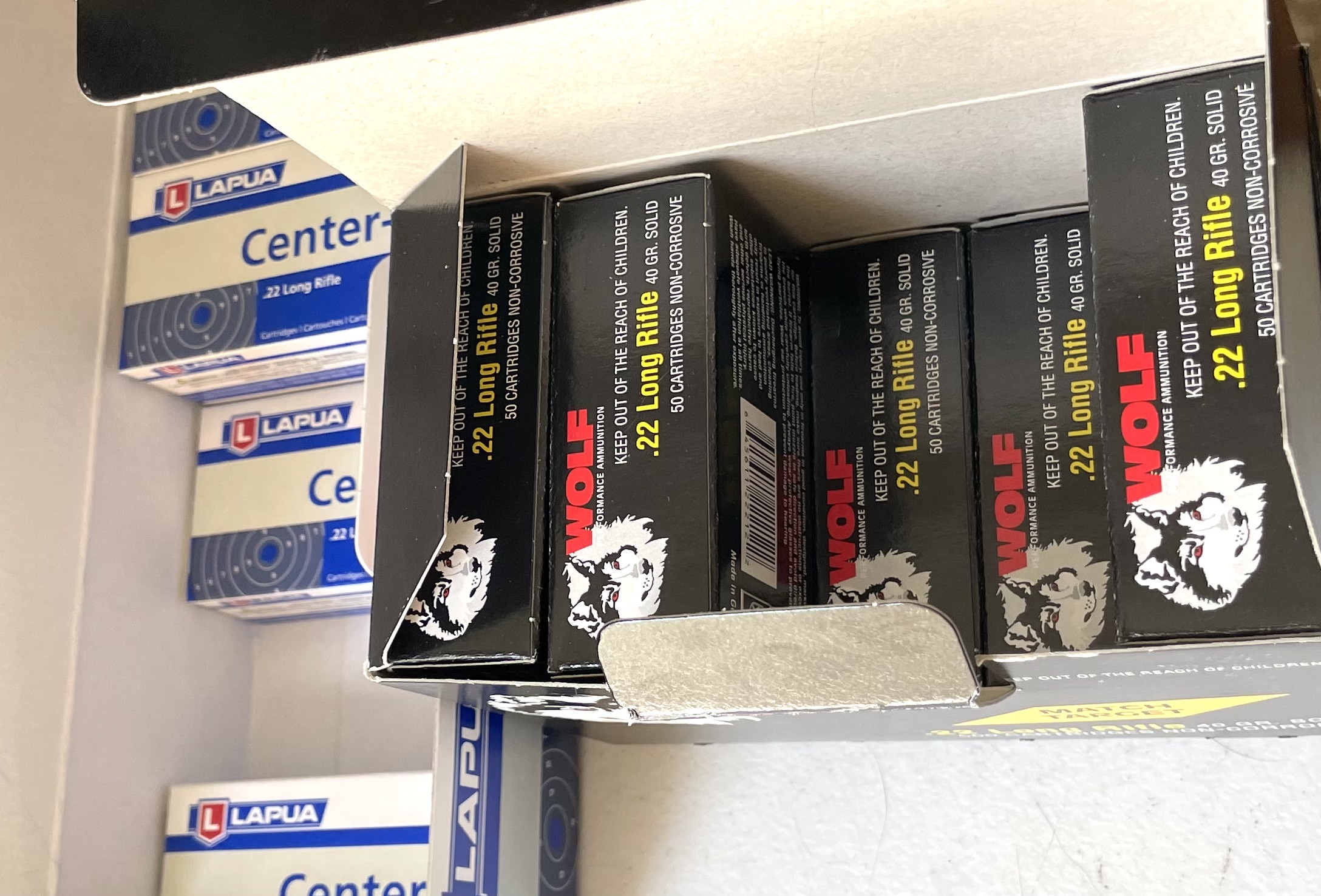

EDIT: Check this out. Lapua SKUs ship with cartridges vertical, bullets down. SK ships with cartridges hoizontal. Is there a suggestion that storage orientation affects velocity over time? If so... I'll buy into it, because this last brick of Wolf Match Target (Rebranded SK Standard+ pre-2018) I bought circa 2019 have really slowed down and become inconsistent.
In the photo, the Wolf Match Target ammo is pre-2019 rebranded SK Standard+. I found a torn, discarded SK Long Range box which has the same dimensions, which confirms my recollection that SK ammo ships with cartridges in horizontal orientation. IMG_4619.jpeg
In the photo, the Wolf Match Target ammo is pre-2019 rebranded SK Standard+. I found a torn, discarded SK Long Range box which has the same dimensions, which confirms my recollection that SK ammo ships with cartridges in horizontal orientation.View attachment 8664044
Actually not quite on SK, the bricks in a case will be vertical with the SKU side label up. The boxes within will be bullet down. But I and everyone else will open and use a brick (and likely store anything not in a case) in the same horizontal position as your picture.
