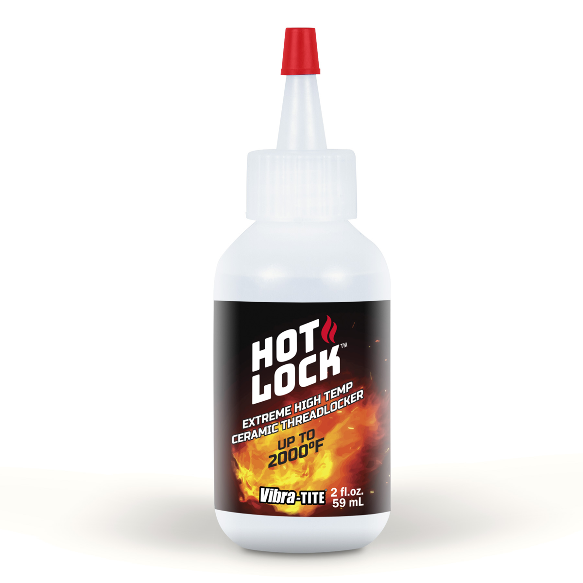

    Yes.
    I've used it for things like gas block set screws.
    But it's still close in strength to blue loctite (ie, medium strength). High-temp high-strength loctite is still what we recommend for muzzle brakes. Henkel also makes an "ultra-high temp, high strength" loctite that comes in paste format if I remember correctly, that has a melting temperature even higher than 272.

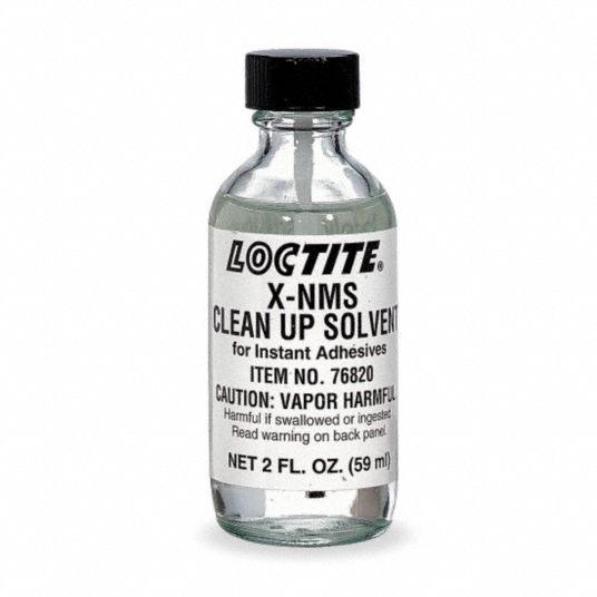

    This stuff works great to remove old loctite, be sure to use in a well ventilated area
