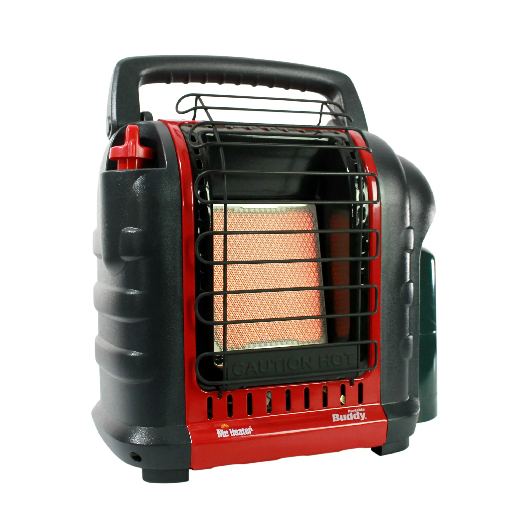

    The oil filled heaters have a thermo control dont they. No more than you'd need it just use that. Of course if the power goes off that wont help. You might want to try a Mr. Heater Little Buddy and a propane tank. On its lowest setting a small propane tank will run it at least for a day or two.
