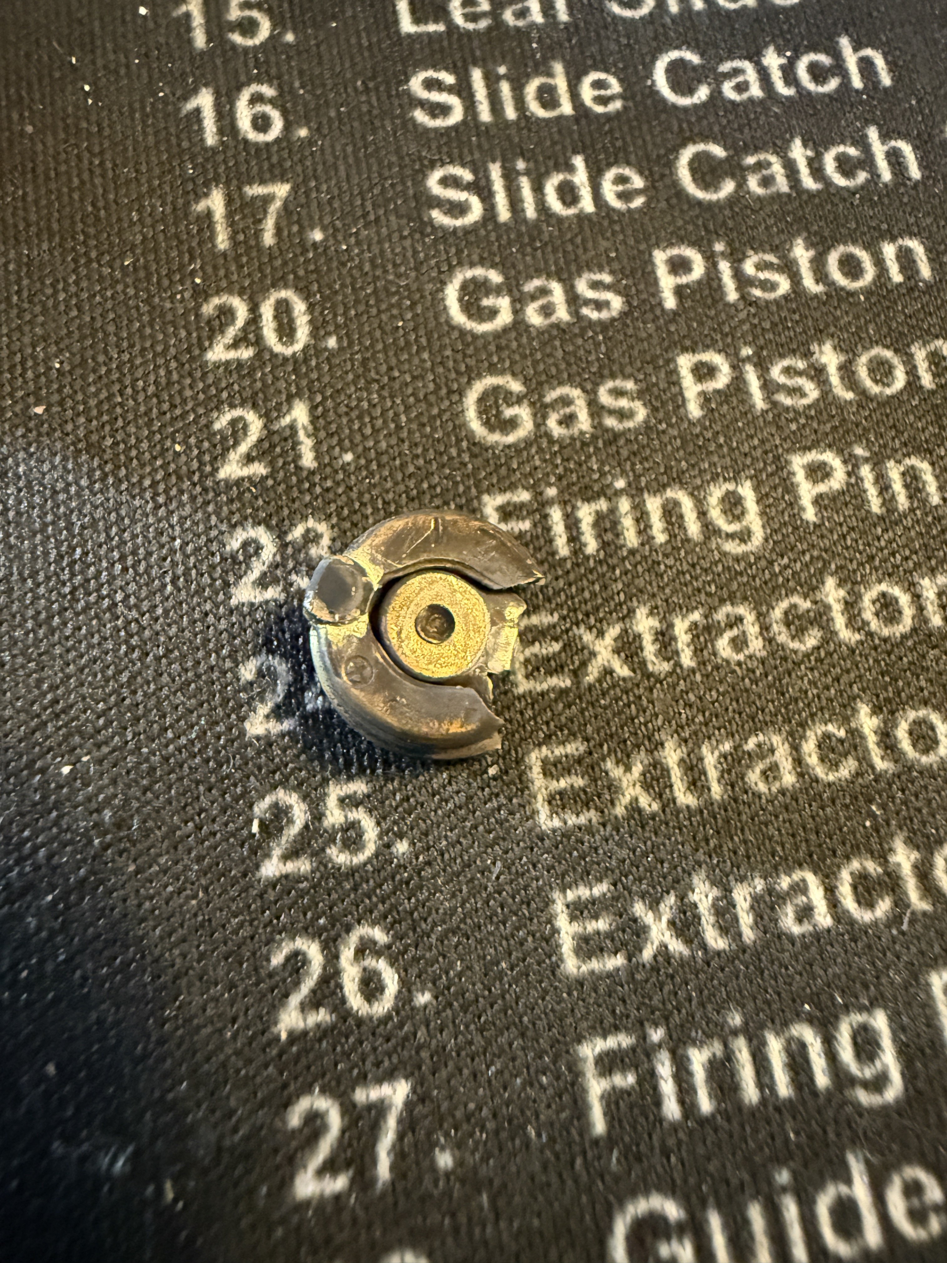

    So brand new M4 build went kaboom after about 4 mags. I didn’t beat on the thing at all. Ran a mag and let it cool down. Yes each mag was a single FRT burst but the rifle took breaks between mags, and ran perfectly until this happened.
    During the fourth mag there was a double feed which was cleared but a live round stayed in the chamber. I just dropped the bolt on that live round and sent it. Bad move. Carnage is as follows.

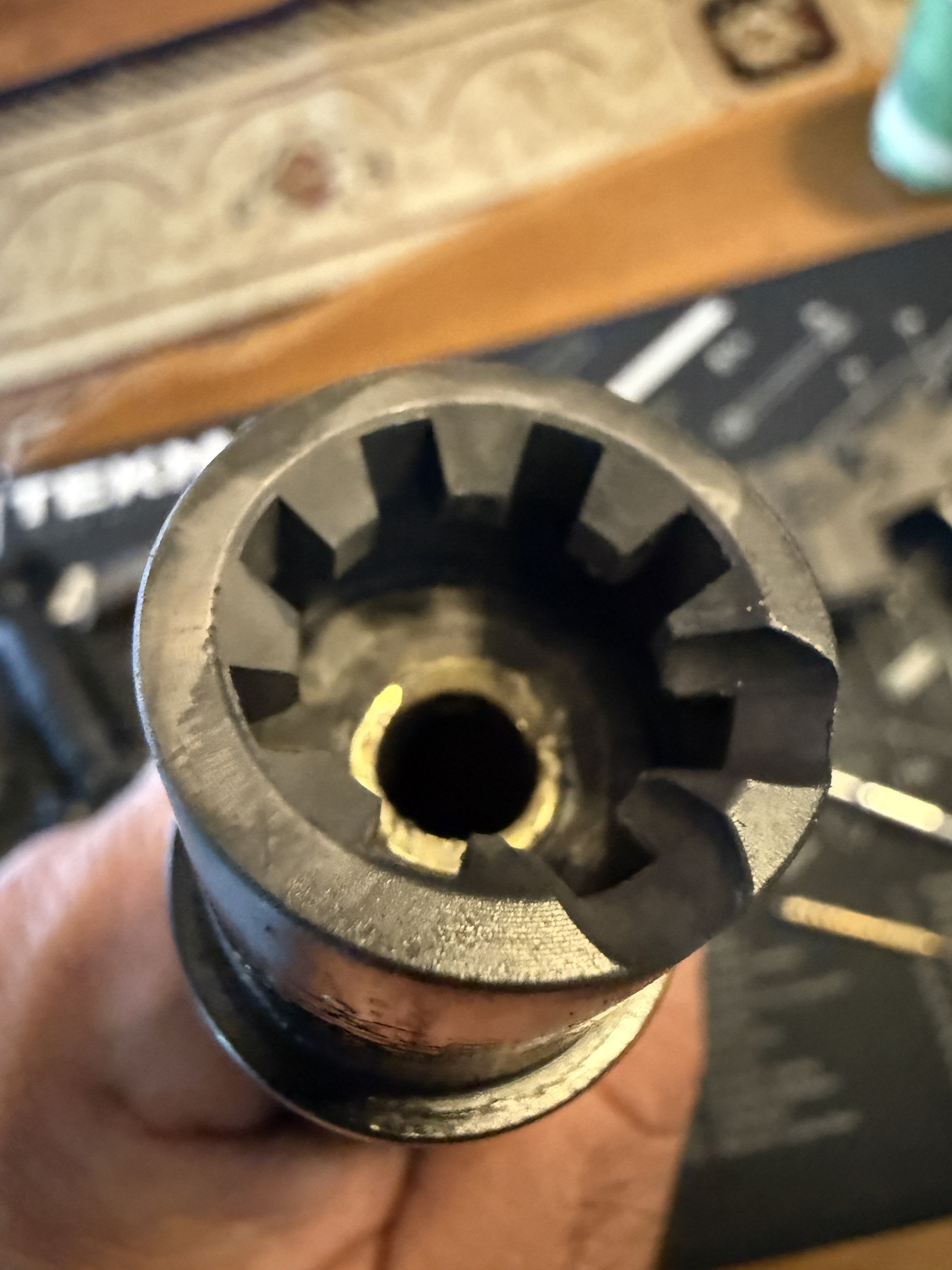

    The case is stuck in the chamber pretty good. Any tips on getting that out? If I can save the barrel that would be good. I guess I notify the ATF that this receiver is destroyed and remove it from the NFA?
    I’ve got other shit to do today but if you guys can off any advice, I’d appreciate it. I’ll check back in later for sure. Spent a long time and some decent money on this build so this is disappointing to say the least. It looks like BCG, and upper and lower are definitely trash, but most everything else looks ok to include the DTT FRT. I’d like to get the case out of this barrel.

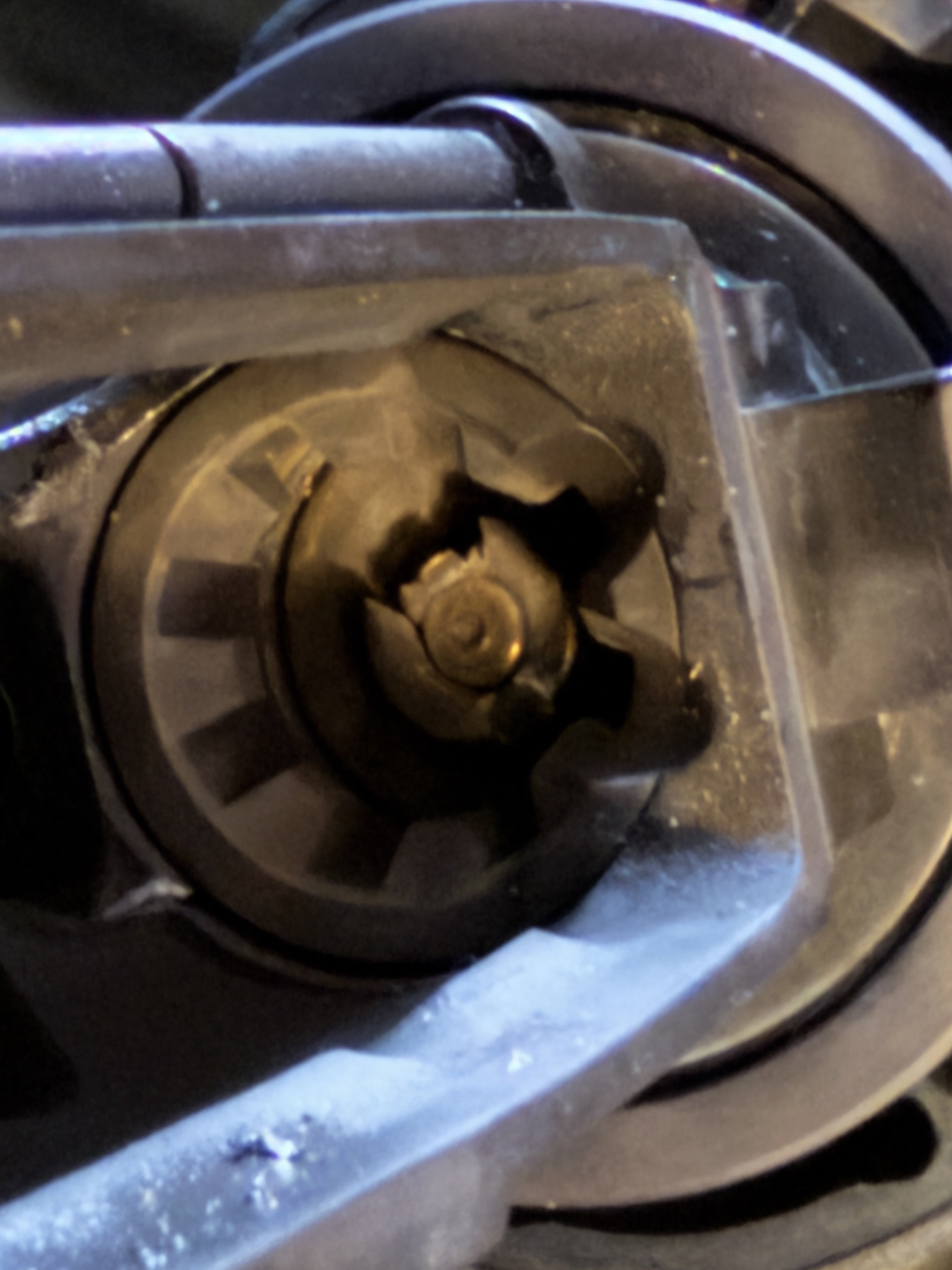

    I can hear a piece of metal inside the suppressor as well and there was definitely a strike on the end cap. I’ll contact OCL about taking a look at it I guess.
    Winchester M193 55 gr

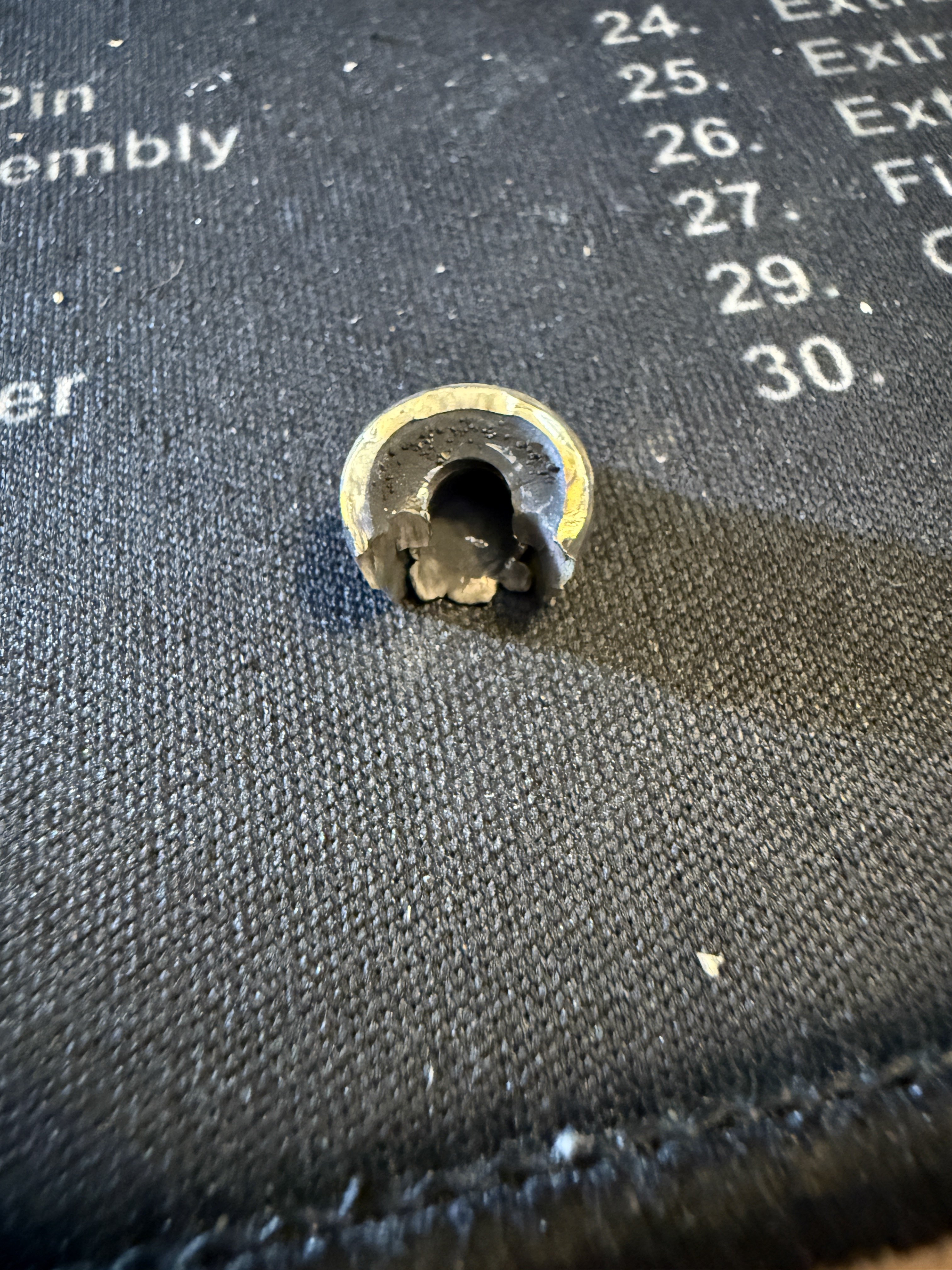

    No, just the head of the case came out. The body of the case is still in the chamber
    Decades ago i learned a backyard trick for pulling broken cases on 7.62x39 where a 3/8's tap is just slid into the case and cocked slightly with a finger while push a cleaning rod into the barrel and tapping it out ,it has never failed to grip and the rod pushes it out . 556 might require a 5/16 tap or similar .
    A dual edge easy out. Not the kind that you screw in, but ones that have 4 long hard edges. But just about anything that will bite and twist the brass while you pull should work.
    If it was me, I would not bother saving the barrel. Wasn't anything like a cut rifled custom barrel I am assuming.

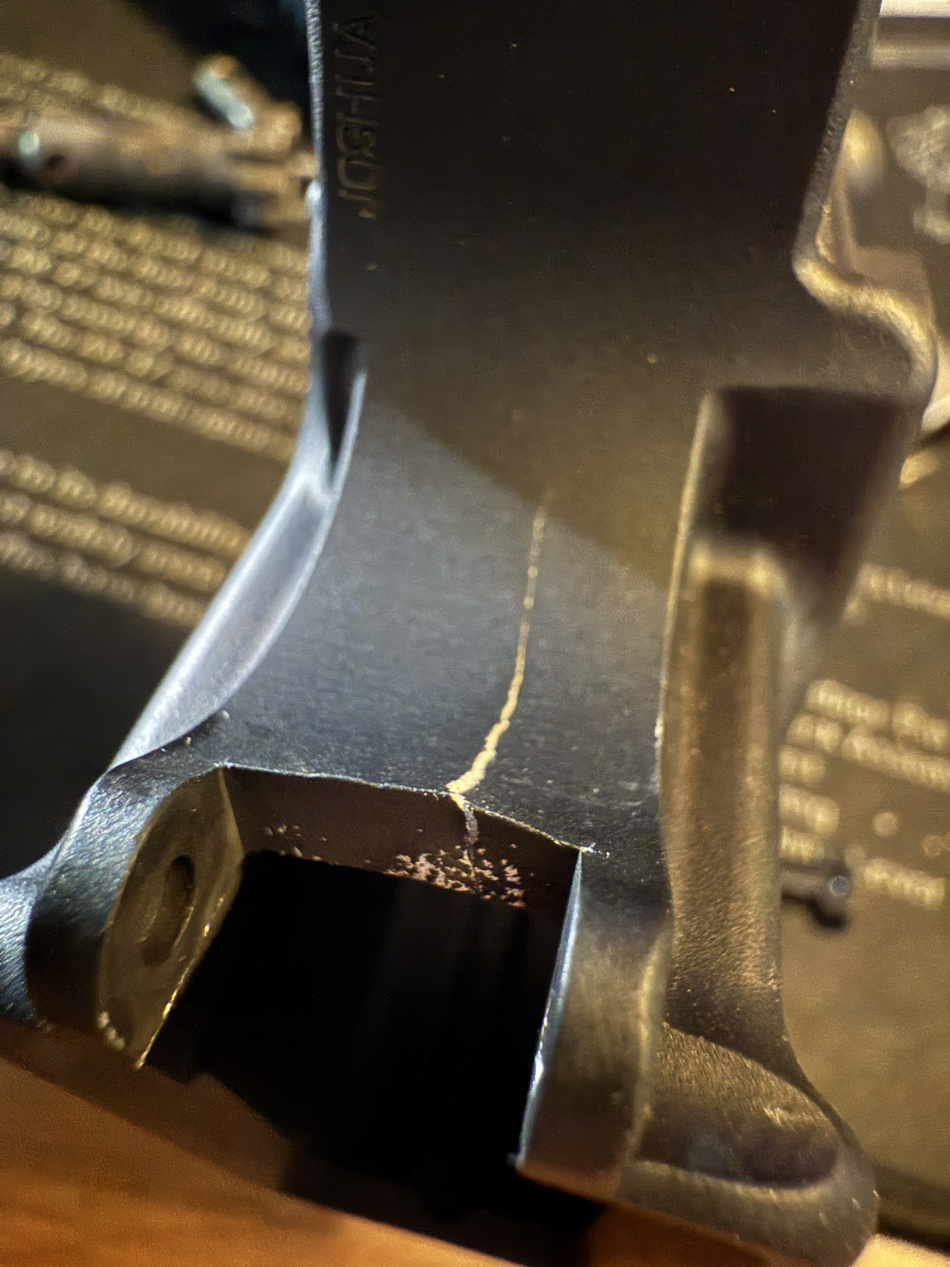

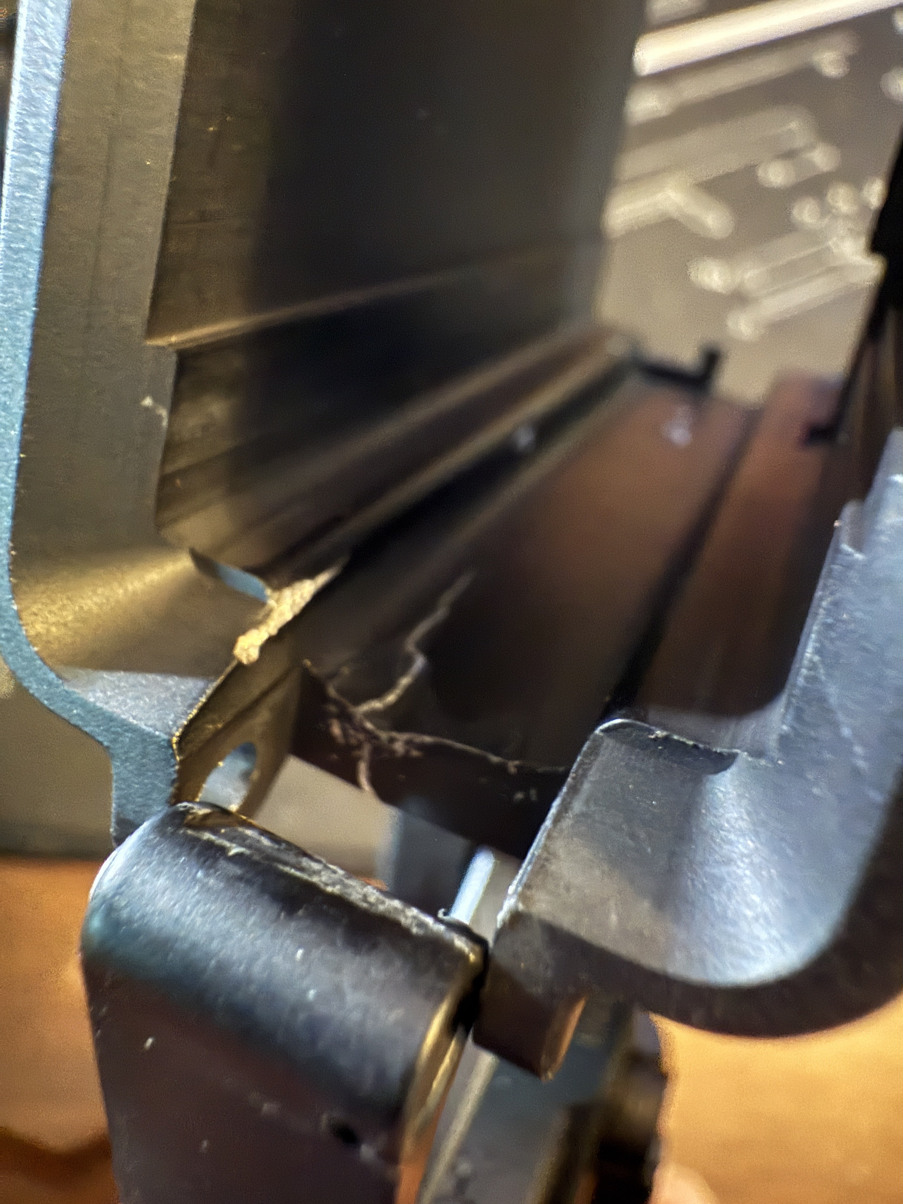

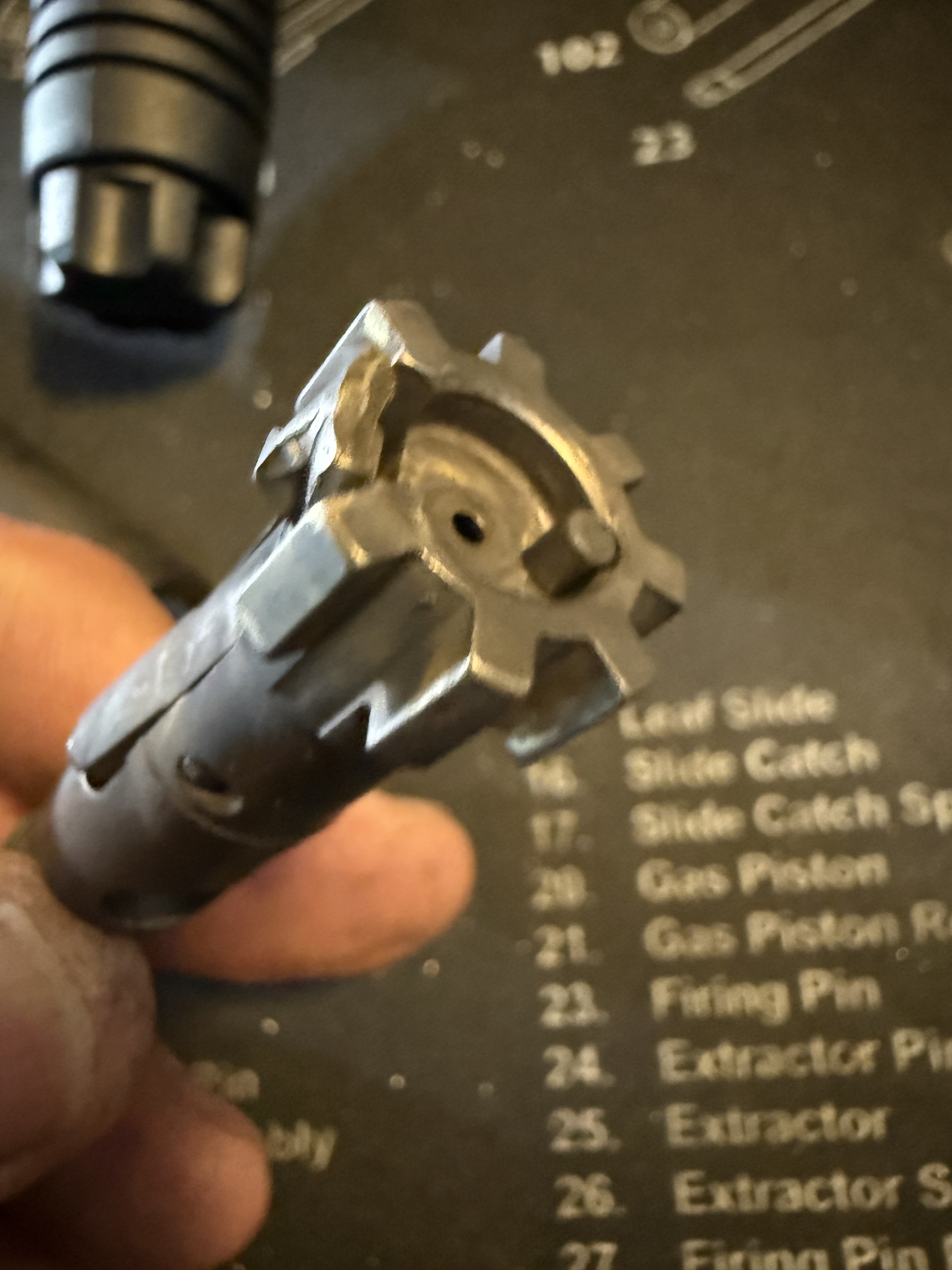

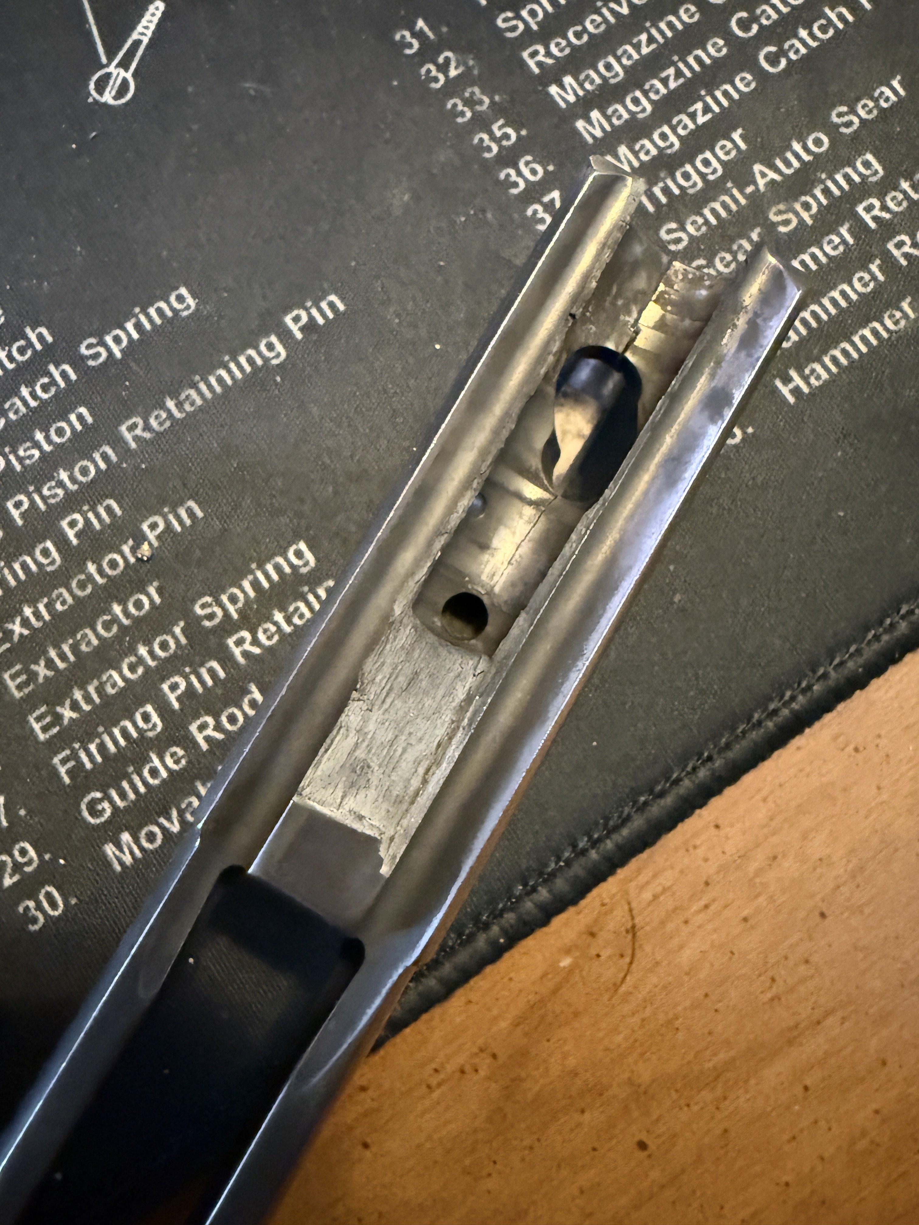

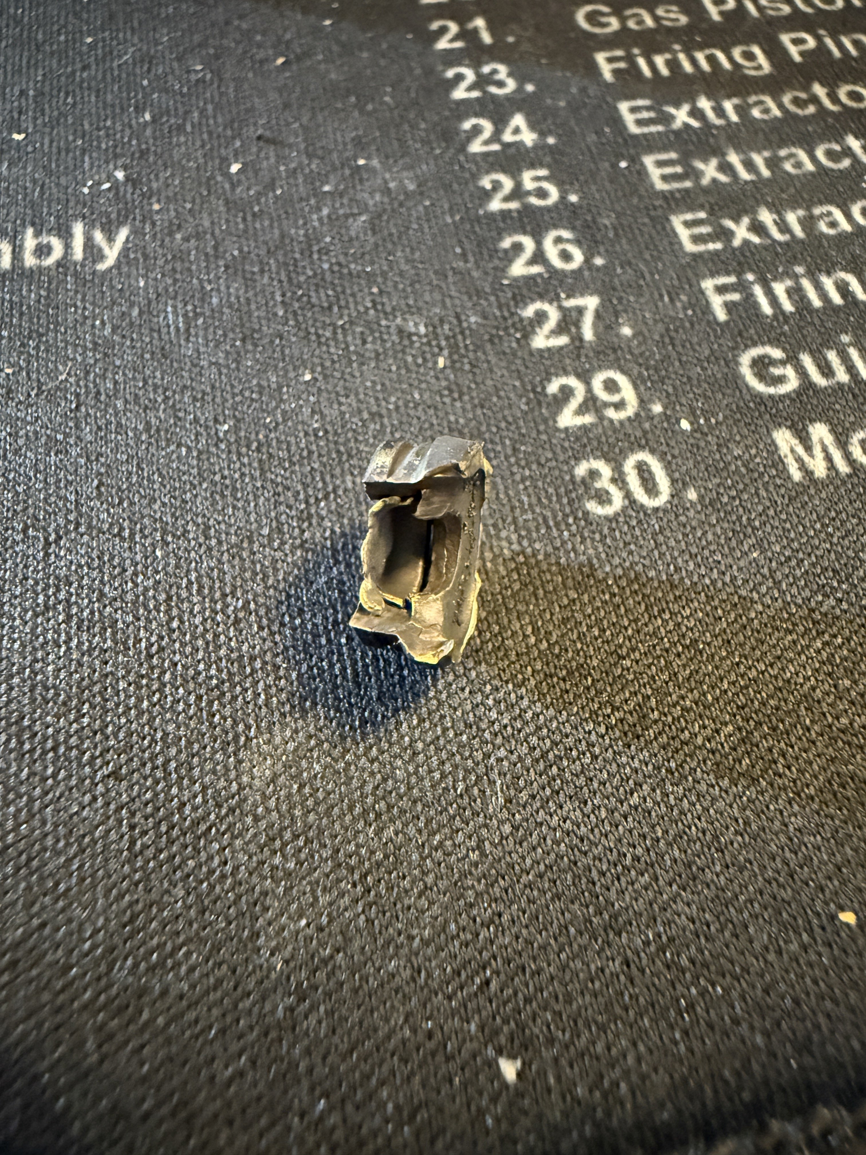

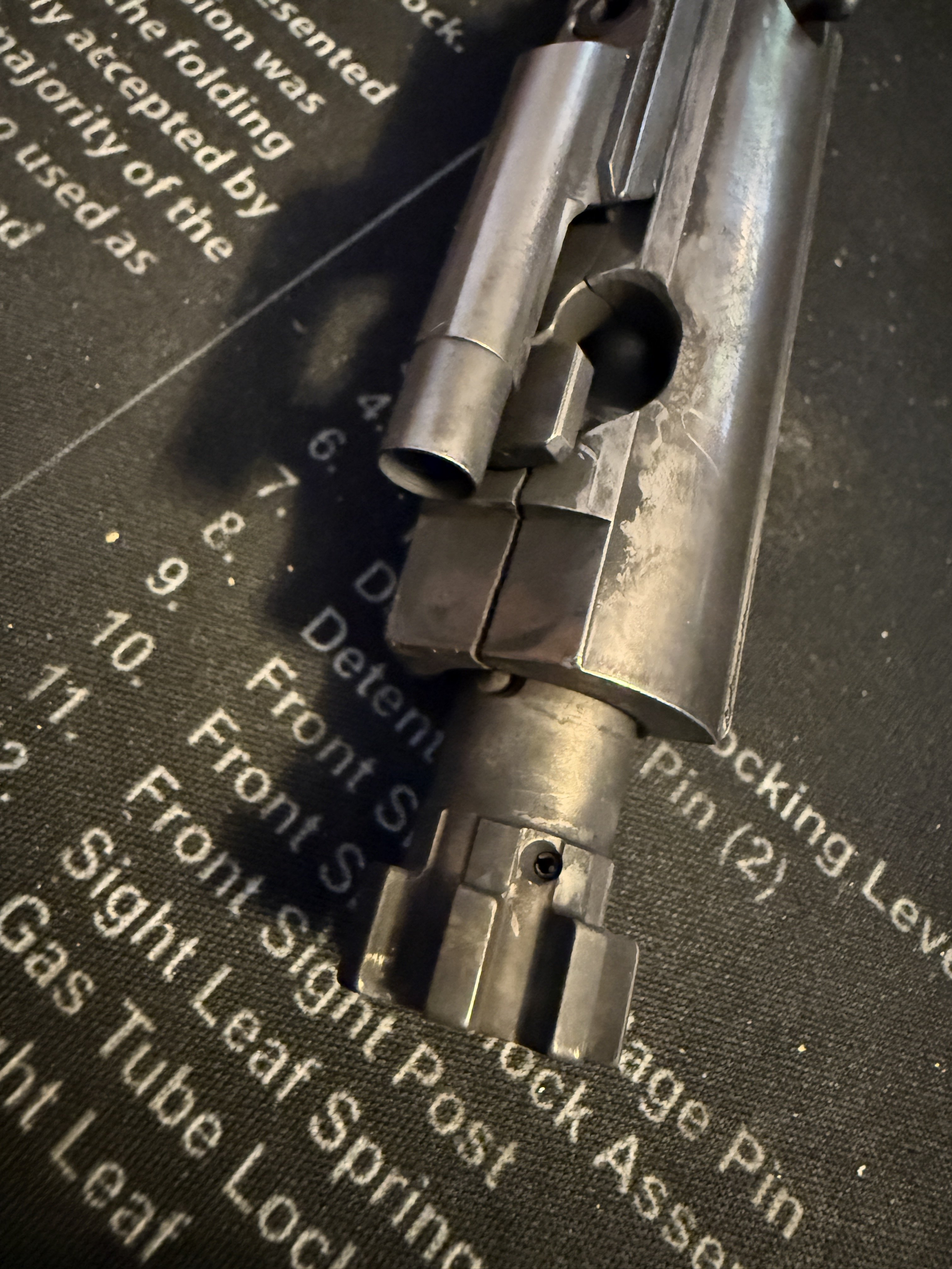

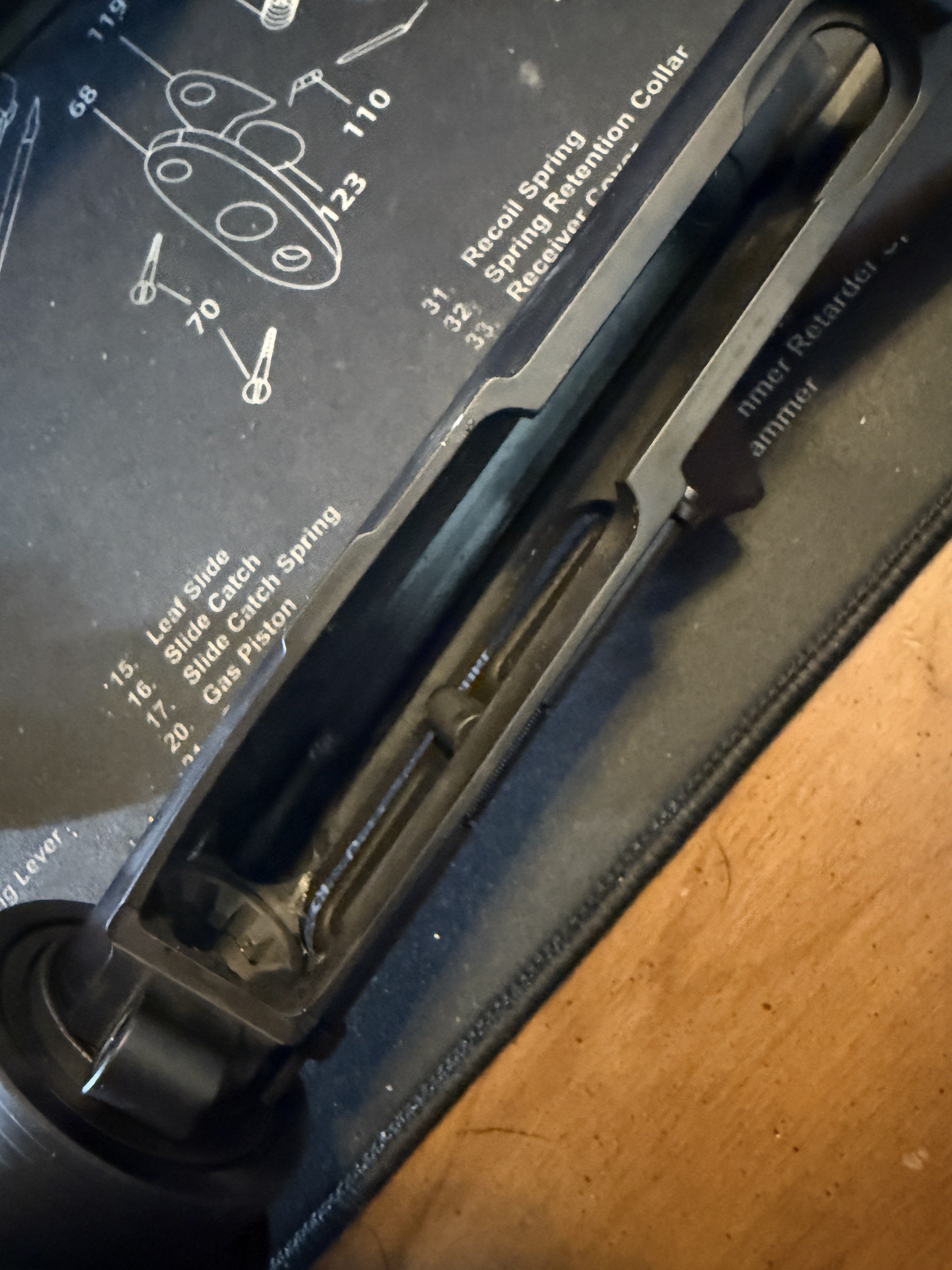

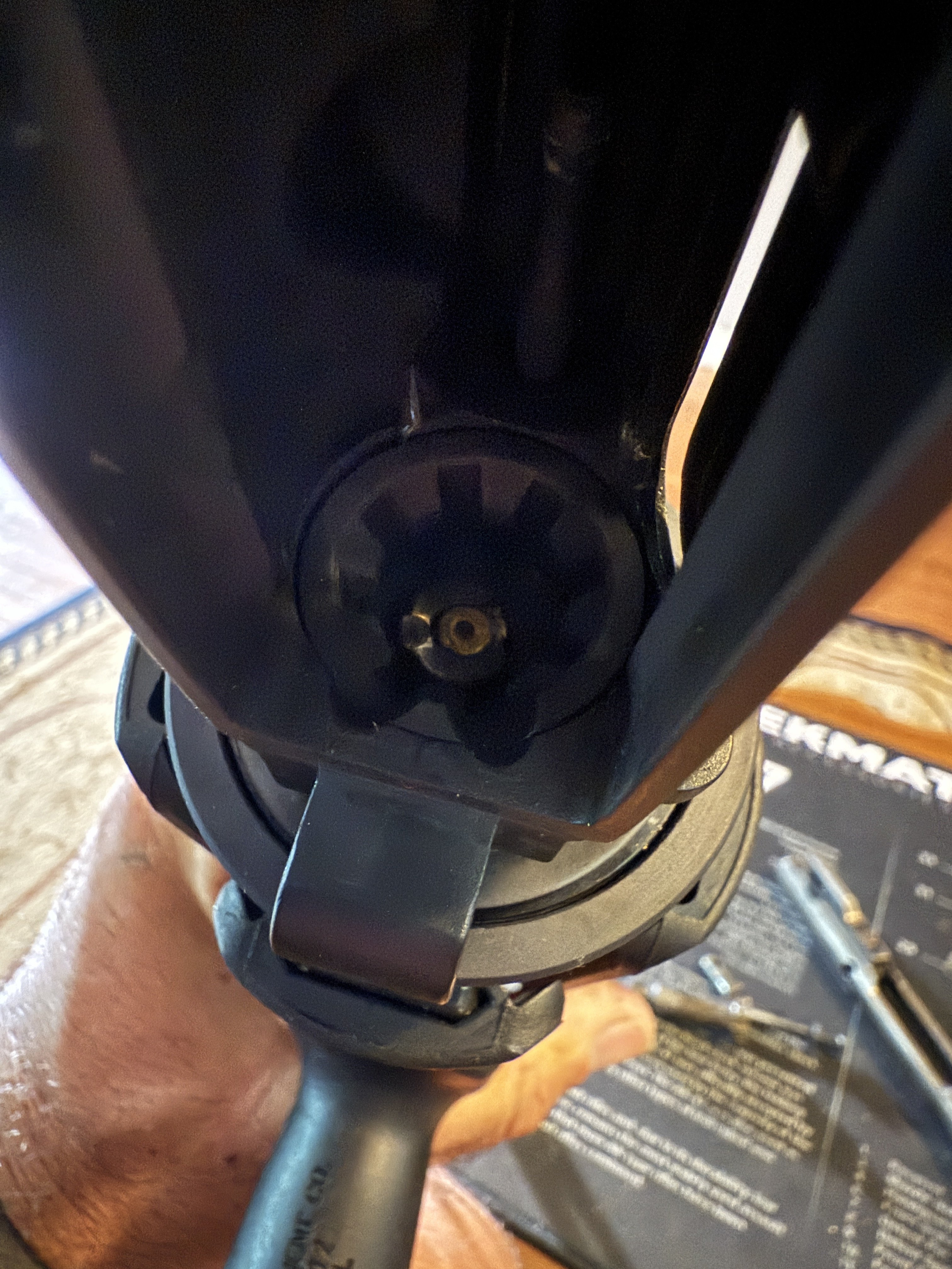

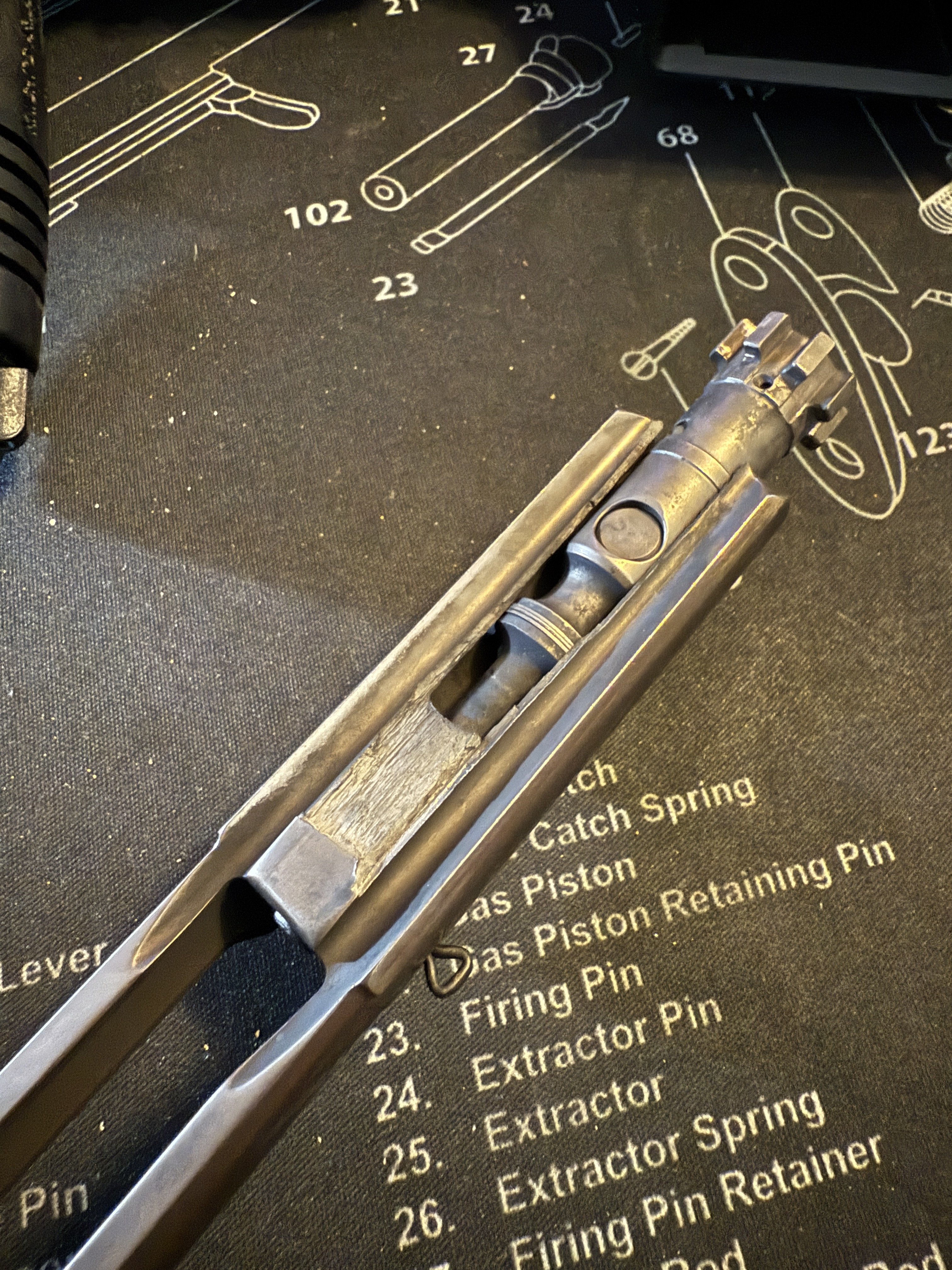

    View attachment 8717677View attachment 8717678View attachment 8717679View attachment 8717680View attachment 8717681View attachment 8717682View attachment 8717683View attachment 8717684View attachment 8717685View attachment 8717686View attachment 8717687View attachment 8717688View attachment 8717689View attachment 8717690View attachment 8717691

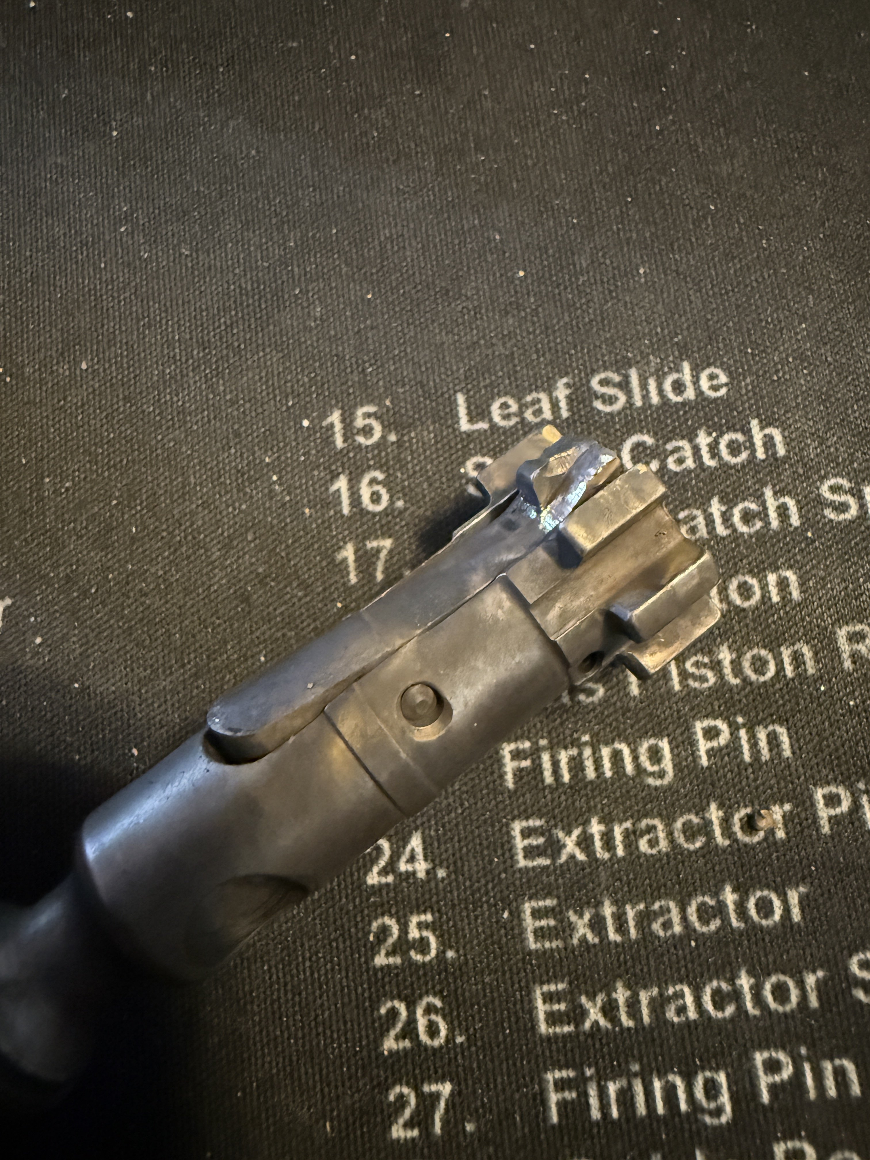

    Who made that bolt and carrier?

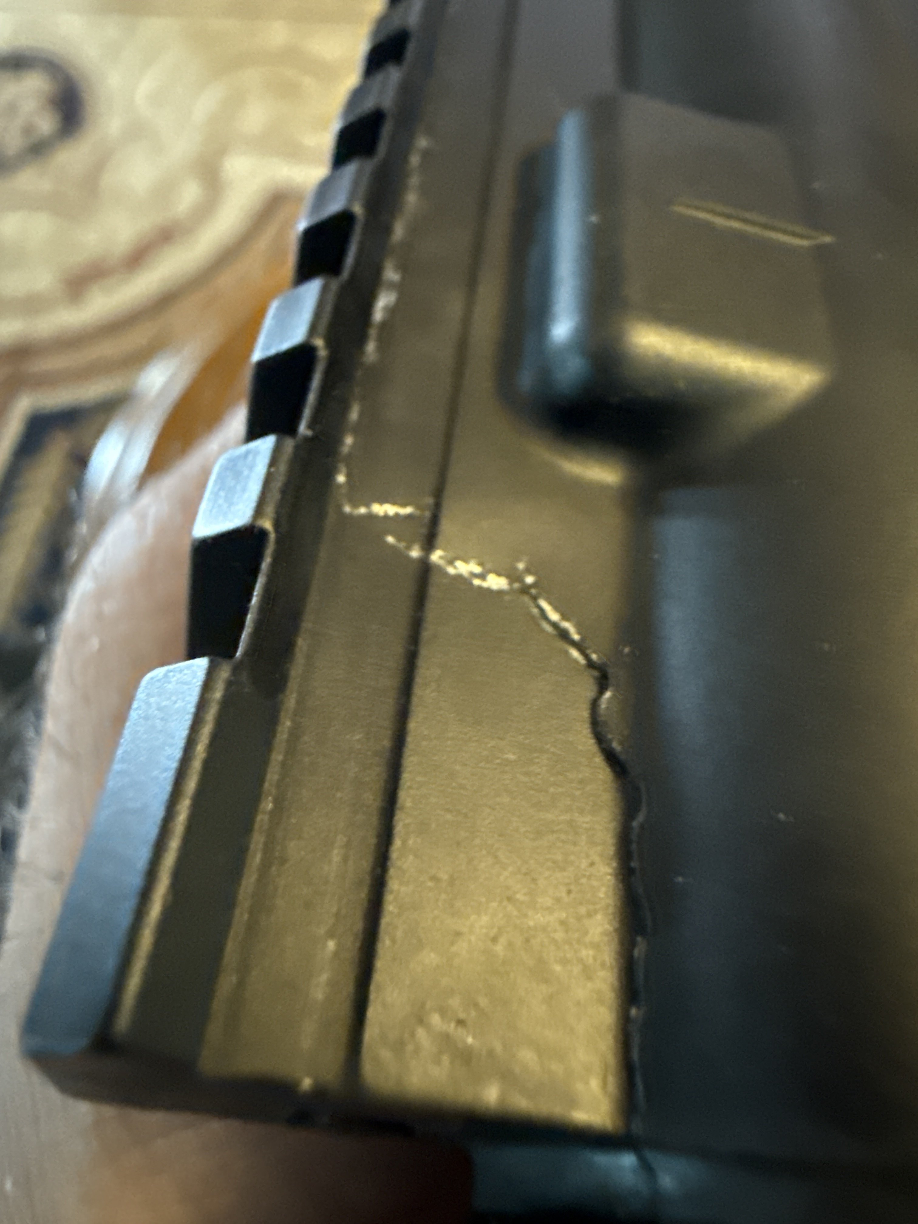

    Also while I can't tell for sure from these pictures but the lower might could be saved if you know a good TIG welder. I am one, but I doubt you live local to me. Is it ballooned out or just cracked in the magwell?
    Thanks for the replies gents. Let’s see if I can address everything in one go.
    Definitely not a custom barrel so I will err on the side of caution and it’s getting scrapped along with the upper and lower and bcg. Not sure why my cheap ass was worried about saving the barrel.
    There was no obstruction because I used a cleaning rod to attempt to remove the case and the head of the case came right off with very little resistance and the rod slid right through. The rest of the case is in the chamber still.
    The actual event went as follows, my stepson was firing in FRT mode, when it stopped and he looked at me and said “I have a jam”. I took the rifle, looked in the ejection port and saw bcg held rearward by a live round trying to feed into another live round in the chamber. I dropped the mag, locked the bcg back, allowed the double fed round to drop out of the mag well, sent bcg forward onto chambered live round, squeezed the trigger and kaboom.
    The lower is an NFA registered SBR. I assume I should notify the ATF to remove the rifle from the registry and destroy this thing beyond repair. After thinking about it a little more clearly, I certainly don’t want to attempt to repair any of this thing. I’ll just save the basic parts that weren’t affected like buffertube and stock and trigger pack.
    Still think it could have been a squib load on the round prior… the over pressure could have sent both bullets out the barrel.
    Or possibly a very overcharged case… or even more likely, the bolt wasn’t all the way into battery when it fired. Starting to think there was a partial case stuck in there already, and that didn’t allow the next round to seat in the chamber properly.
    Edit: and looking at that case head, that’s a huge impact crater from the ejector. Clearly a NATO head stamp, so assume the ammo was 5.56. was the barrel chambered in 5.56 or was it a .223 chamber? Maybe 223 Wylde?

    There’s something funny, still, about that baffle strike.
    My guess is out of battery slightly due to the case head being deformed by the second round. I don't think the bolt would have locked with the case head being dinged that bad. Not sure on the end cap strike though. That's a tough one. Maybe can walked loose during the mag dumps and was struck before the failure.

    Barrel was a 14.5” SOCOM profile barrel chambered in 5.56. I believe the bcg was fully in battery because I had to beat on the ears of the charging handle with a hammer to get the thing out of the lugs. It was clearly locked up in the lugs when I first separated the upper from the lower.

    FWIW, before I trashed the LR, if the only damage is the crack at the front of the mag well, I would try shimming the front takedown pin fit, with another upper. The LR isn't stressed much, i.e. polymer lowers work... the LR damage doesn't seem to be a safety issue.
    The overall damage seems consistent with a 300BK in a 5.56. Looking at the online autopsies of BK-in-223 accidents, the bullet usual gets extruded some distance down the barrel. If it had been completely expelled in this case, that would explain the suppressor damage, and possibly if the barrel pressure was very high as the projectile pasted the gas port, that would cause the the bottom of the bolt carrier bolt chamber burst.
