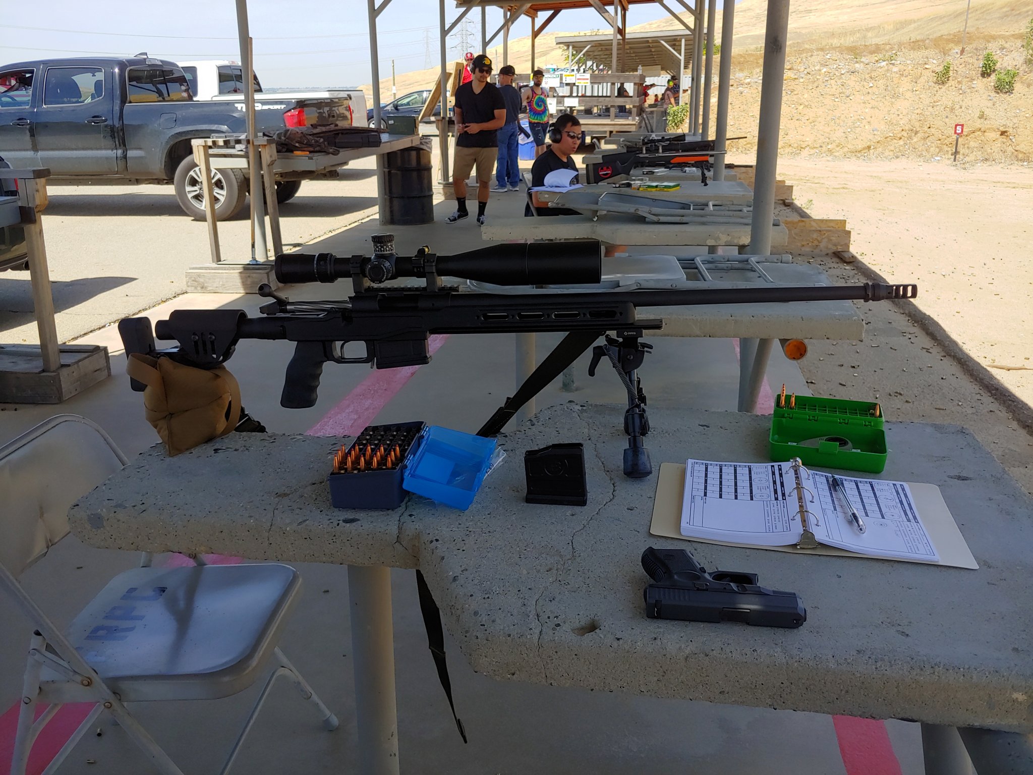

Today I took my Bergara LRP in 6.5 Creedmoor out for the second time. Rifle has 67 rounds through it and it has only seen handloads.
First time I took it out it shot flawlessly, today was more of the same until about 20rds in. Started getting what I think may be light primer strikes? I'm not really sure, it's my first precision gun and my first reloading.

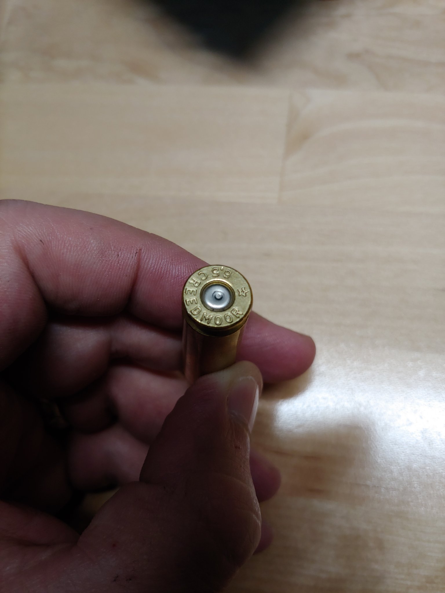

It did this about 10 times in a row and left my primers like this. None of them fired.
I pulled the bolt apart and everything seems fine, I mean it's brand new. So mainly I'm trying to figure out if it's my handloads or if it's a gun problem. Because when it shoots, it's a damn laser.
Any suggestions would be much appreciated from the new guy here!
I suspect your handloads, not the rifle. Primer hit looks fine. If the primers are not fully seated, you will get a misfire with a primer strike that looks ok. Basically, the firing pin ends up "pushing" the primer to fully seat it and not getting a solid impact. I suspect not fully seated primers followed by bad primers. Shoot some factory ammo and see what happens.
Ok that's what I was thinking but wasn't sure, I'm gonna buy a box and test it out. Thank you!

The giveaway that shows a primer that popped but had no powder to ignite is the way it has a funnel appearance with the outer edges still very rounded. If the primer had failed it would remain flat with a small dimple. The primer had enough pressure by itself to push the cup back causing the funnel effect but not enough pressure by itself to flatten against the bolt face. This is what happened to me.

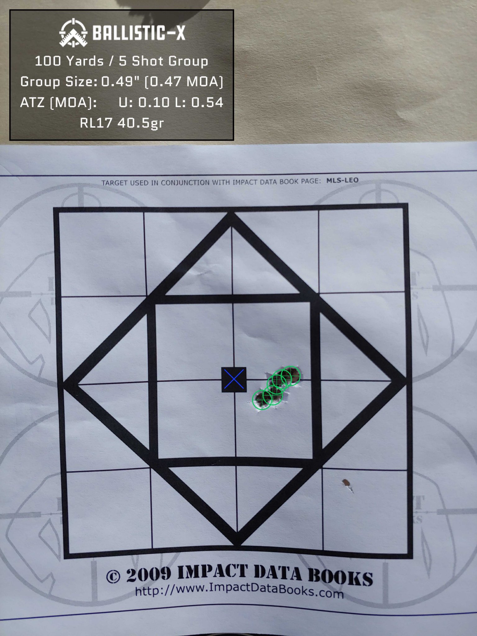

While it is very possible, I am 110% positive that there was powder. I was using RL17 for the first time testing it out and only loaded 40 rounds. Which would mean that I forgot to put powder in a quarter of them. And to throw another wrench into things, I then grabbed my box that had my H4350 loads in it (that all shot perfectly the first time I took it out) and the same thing happened to those. So I guess I can pull the bullets and find out, Im going to try and reshoot them first and see if they were just not seated all the way.
Reactions: antithesis
I'm in the primer not fully seated camp, however, you may have something impinging your firing pin.
Stip the bolt, clean the pin and spring, lube lightly and reassemble.
I’m the one in all three camps. I’ve gotten in a hurry and not powdered them, not seated them down right and had old excess cosmoline slow a firing pin down to not firing.
I’ve also had wet powder and contamined primers, by both me and the factory.
The only thing you can do here is break the cartridge down and see what you can. Pics of the powder and pics of the primer after breakdown would help.

Looks like there probably seated in to far and probably CCI primers. I won’t use CCI had a friend that had batch that wouldn’t fire every 3rd or 4th shot. I had the same problem with my 223 and thought it was headspace double checked my headspace switched to fed 205m no more problems. Won’t use Winchester because they had a bad batch a couple years ago that would blow pin holes out the side of the pocket. Winchester acknowledged it and reimbursed me a whole $30 for my pitted bolt face.
How are you seating primers? That first pic has a weird arch on the primer that looks like it was torn or weakened there or something. Are you seating primers on a press by chance? If you are, may want to try priming by hand, like maybe you didnt get the primer in square and it kinda jacked up the cup... I dunno, just a thought.
Man, you said it... today I was loading up for the first time since moving houses... everything is still sorta in disarray in my garage. Put powder in the hopper, grabbed the lever, and dropped 43 grains of 4064 on my bench like a fucking idiot. I thought to myself... "self, let's reload next weekend" and cleaned up. Figured I'd quit til I was in a more mentally prepared state.
I am seating with a redding hand primer tool
