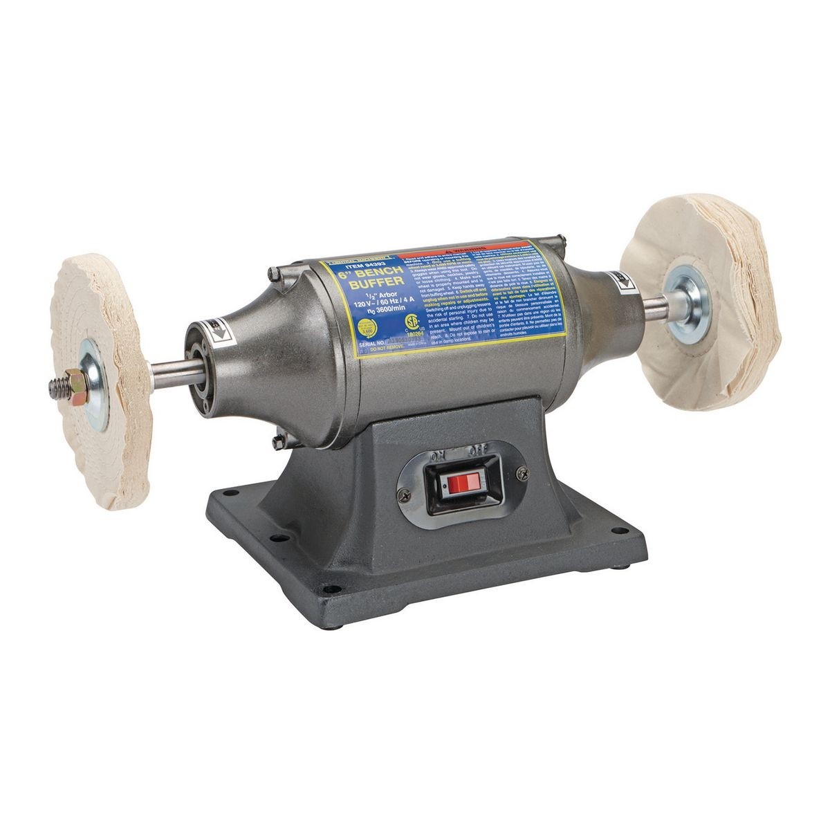

what your not polishing your brass with brasso for the ultimate in shiny brass ? Don't you want the prettiest brass at the range , clean brass is happy brass lol . Would you wash your car with out doing the tires and rims ?
Polishing brass increases your FPS and lowers your ES and SD. Its a trade secret, shhh dont tell anyone.
