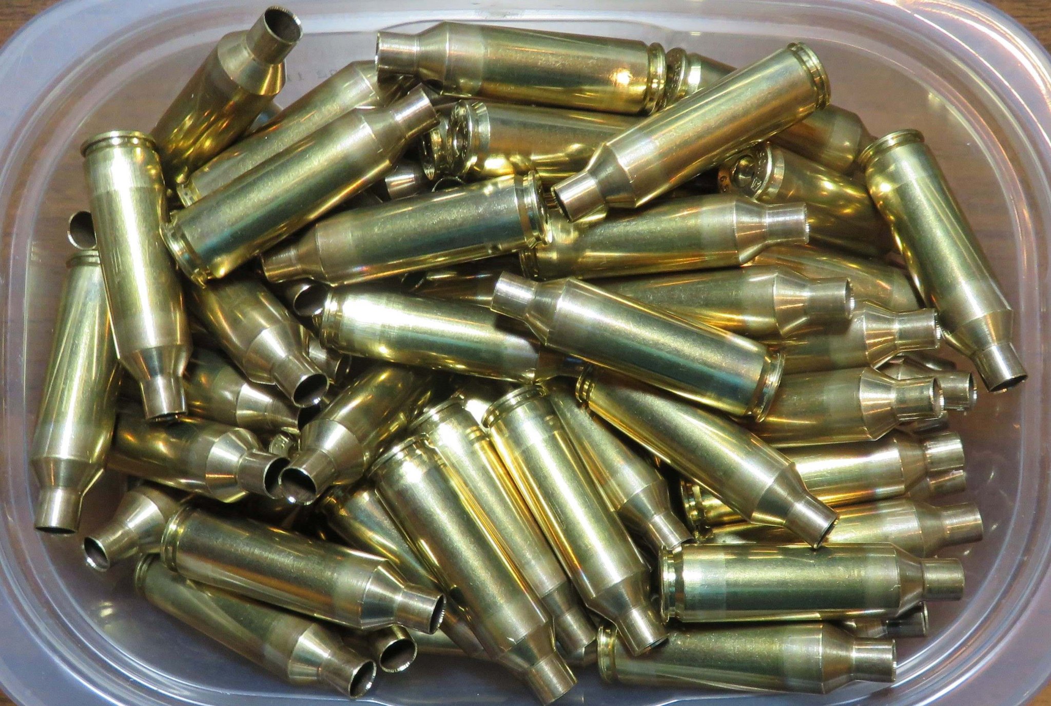

I wet tumble without media. Sometimes dish soap and Lemishine. Sometimes just soap. Run time about 20 to 30 mins. Rinse in cold water then bake in an old toaster oven at 240 for 30 minutes.Interesting view - how long are / were you wet tumbling and with what media?
I've been solely wet tumbling for a few years now and have had no issues with damage, "peening", or anything else. I've looked for slight damage with a loupe several times - nothing. For "precision" brass I wet tumble for about 20 minutes without any pins or other media and it comes out perfect.

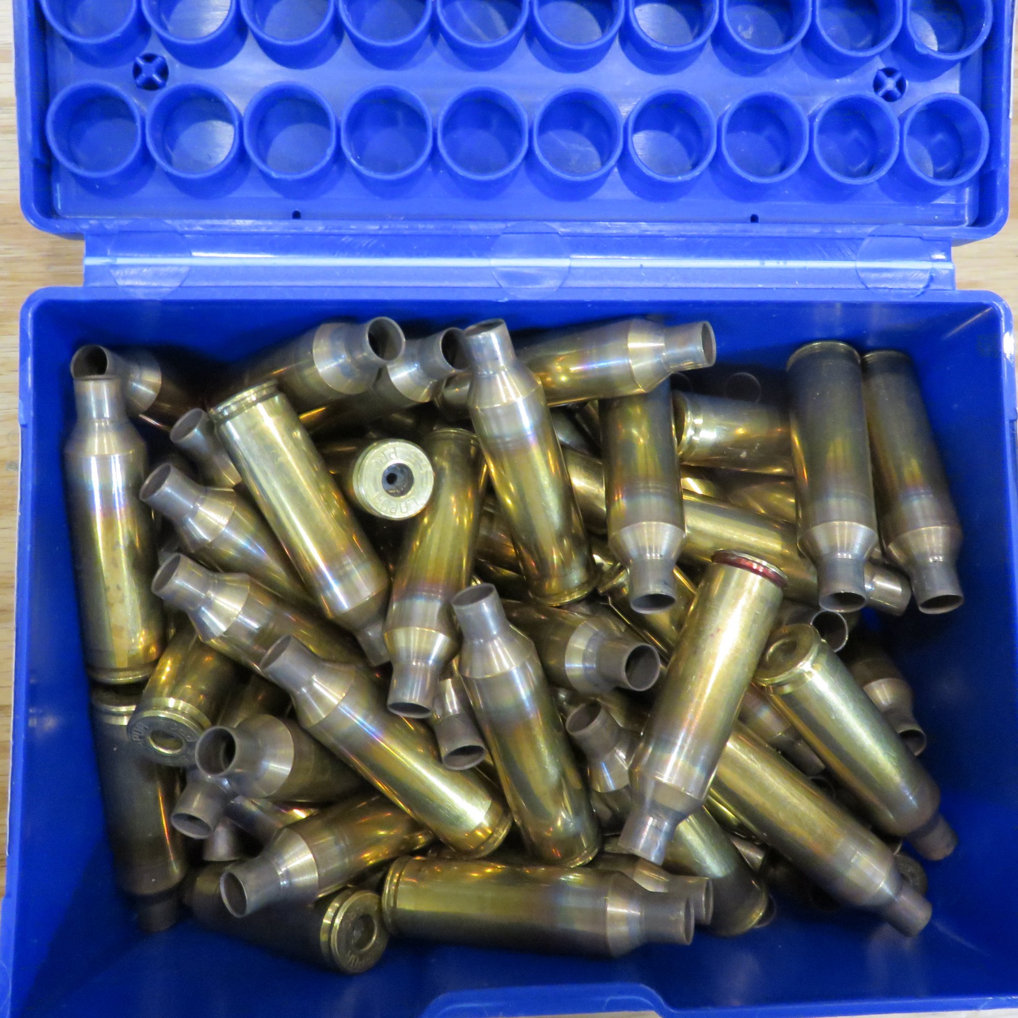

When I shot handgun silhouette, you were all but asked to leave if anyone looked at your brass without a welding mask on and were not instantly blinded. Seriously, it was kind of expected to have brass look “much” better with “much more” shine than new. We all got OCD about our brass being really nice. So, back in the day, before all these “new fangled methods of cleaning brass, we tumbled the shit out of it, making sure it was extra bright.I've tried a bunch of different ways: pins, no pins, long, short, fast, slow (using a variac) even tried some stuff I found in old Benchrest threads around the net, like throwing a few tennis balls in the drum (to take up unused volume and help slow down cases when flying around in the drum), and then thought I cracked the code by cutting up some unused Pelican foam I had lying around and throwing that in there to help (vastly improved and almost cured the peening for the most part).
For me, once the number of firing cycles on the cases started to get up there... chambering issues and the peened/rolled/mushroomed case mouth lips would eventually show up (with the only cure being a significant trim job, outside deburr would actually sort of make it worse or at least more apparent to the eye). I don't care about chasing speed, so I run my cases well into the teens or more (until they won't hold a primer really lol), I can't remember exactly when or how many cycles until the issues showed up, but eventually, they do. I also anneal every firing on an AMP before sizing and then tumbling, and wet tumbling is no doubt worse on freshly annealed brass.
But, that's not why I finally stopped the wet tumbling... In the end, it came down to getting low SDs. Almost magically, when I switched over to dry tumbling, my SDs shrank noticeably within a couple/few cycles (pretty much cut them in half). I also noticed that when I asked more than a few good shooters I was on squads with at matches about it, the answer was always the same: dry tumble (and I don't believe in coincidence).
I dare anyone reading this to try it... hear me now, believe me later (with the proliferation of the Garmin Xero, should be easier to see than ever).
IMO it's about how the cases are handled, and my hypothesis is: wet tumbling beats the shit out of cases (and that's bad for getting low SDs).
