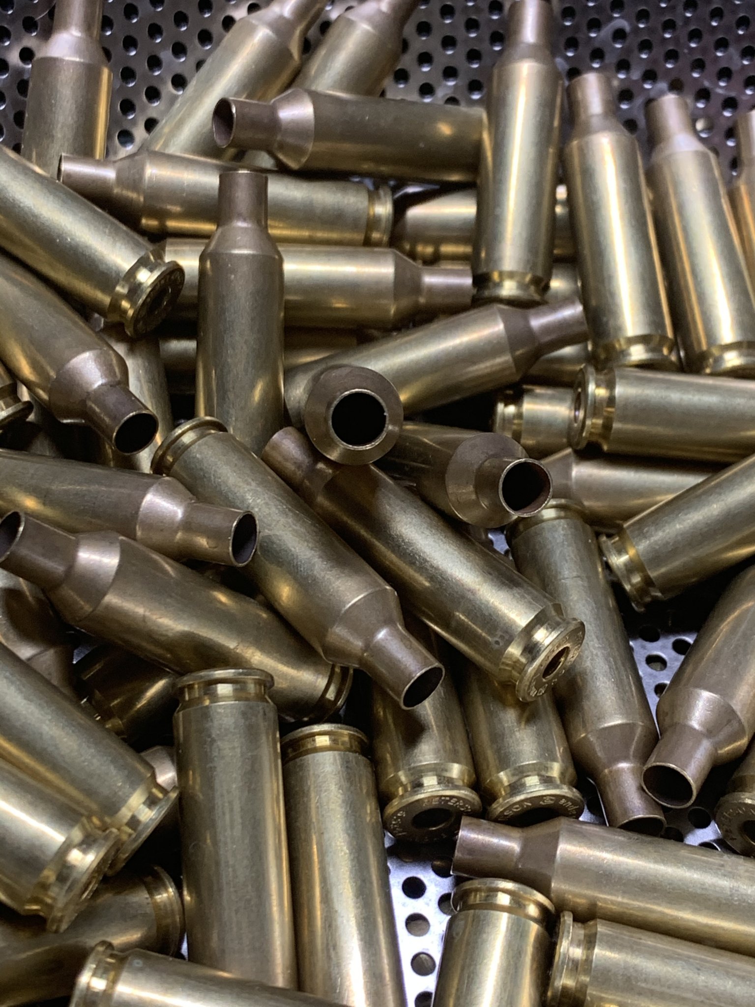

For reference, here is once fired brass. Wet tumbled for 20min *without pins*, annealer with AMP, sized with imperial wax, then tumbled for another 20min.
Run a .242 mandrel and trim/chamfer (have a henderson, so I trim every time. Takes 20min).
Pin gauge shows .241 for .002 neck tension. No lube or brushing and bullets seat at 20-40psi on hydro press.
