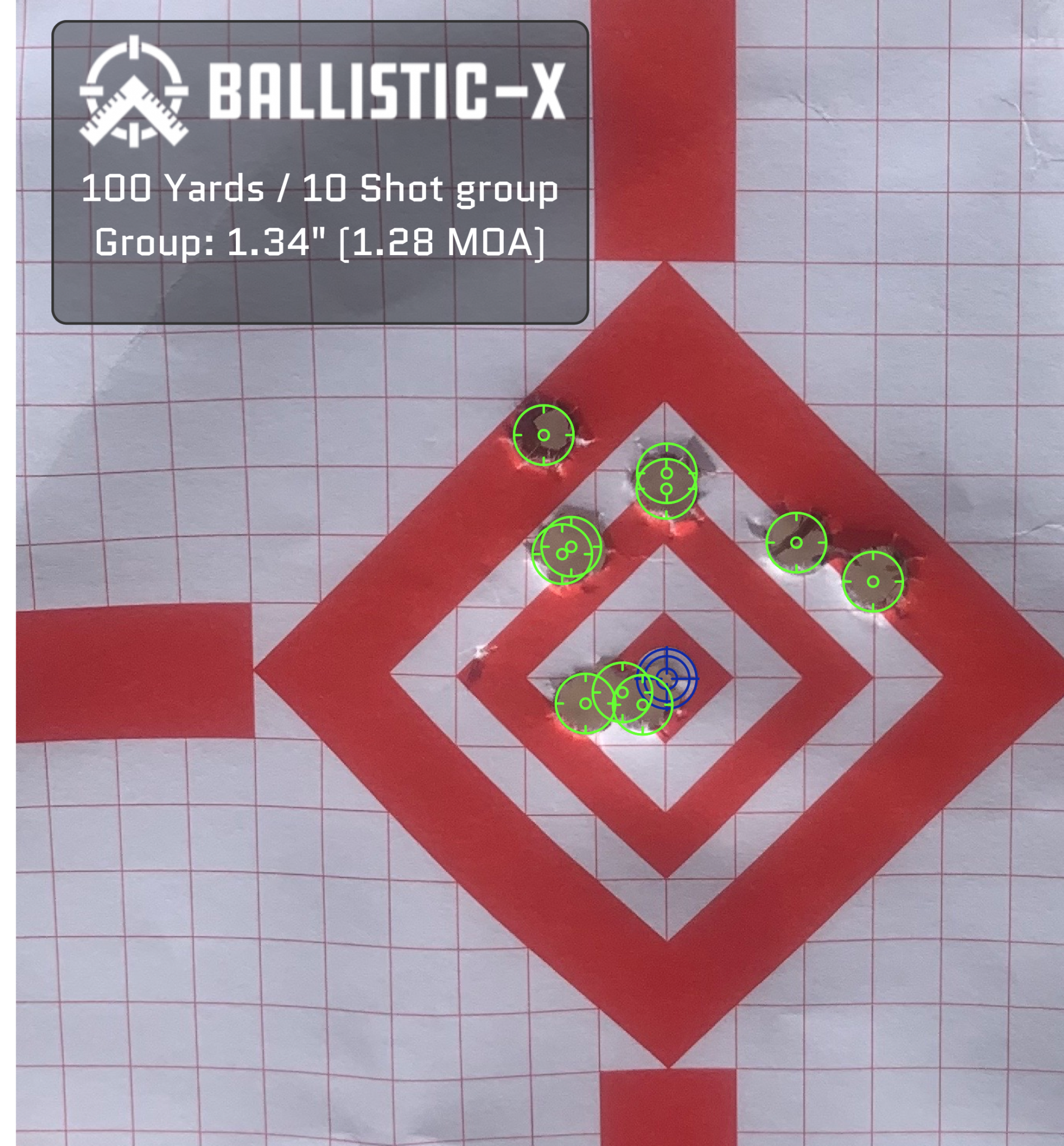

    When I shoot paper for barricade practice I'll just shoot at whatever paper is available. I want a very small aiming point, then will judge after the fact how many shots I kept inside 1MOA and how many I kept inside 2 MOA for a rough sense of hit %.
    The one I tend to use the most is this target since it has the 1 and 2 inch circles in addition to the diamond for aiming.

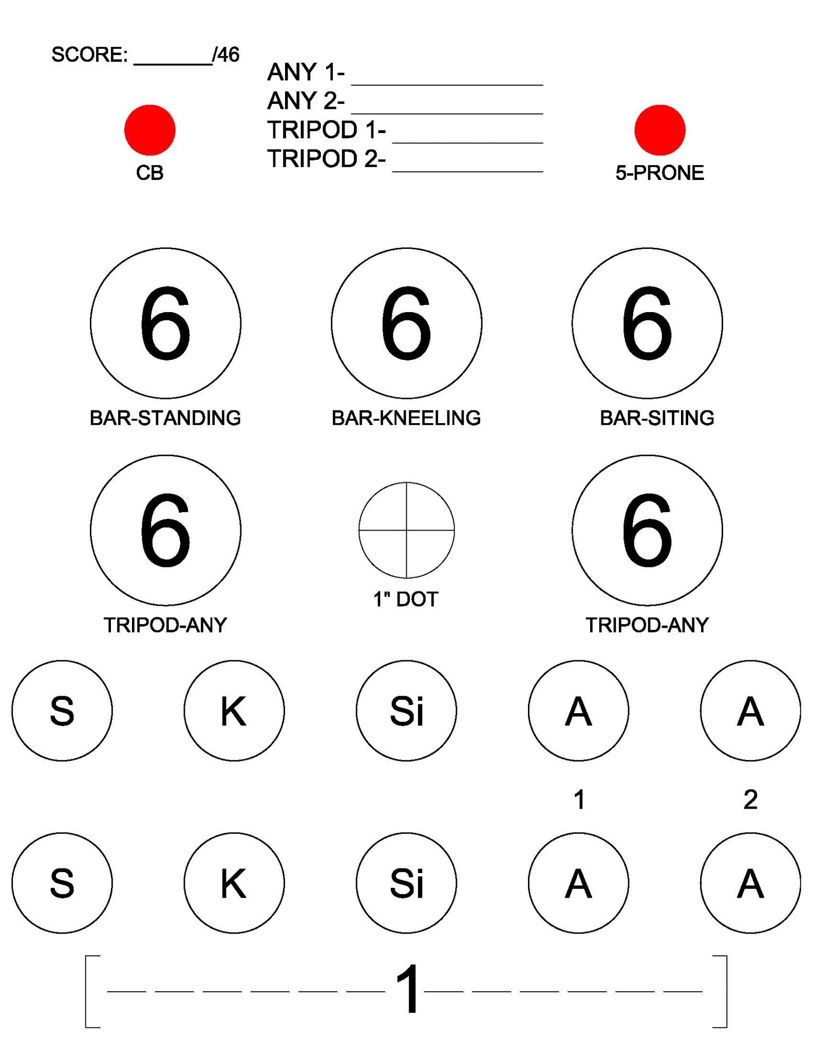

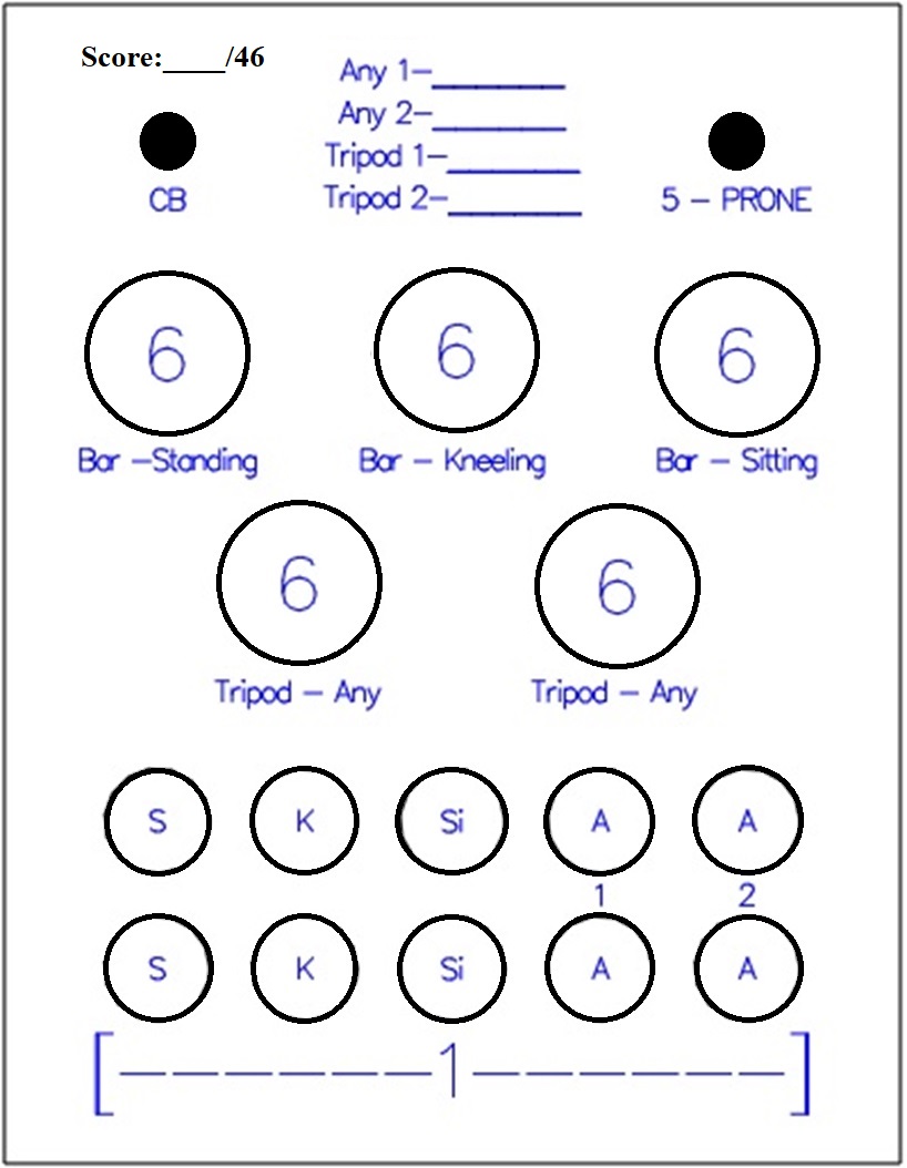

    I made this target last year with the goal of ultimately doing LESS prone shooting, getting more training out of the ammo I do shoot, and at the same time, monitor my proficiency off of barricades in standing, kneeling and sitting positions, as well as tripod stuff (either as primary rifle support or secondary support).
    The whole target can be shot with under 50 rounds
    Big circles are 1.5 MOA
    Small circles are 1 MOA
    Ill shoot a cold bore prone, then a 5 round group prone at the start of the series.
    Two shots in a barricade position, then break position totally, and re-engage. 6 rounds total in each
    The bottom series is a positional dot drill... Standing, Kneeling, Sitting, Any position x2
    Monitor your score and time throughout the months.
    EDIT TO ADD: If someone knows how to add a dead nuts 1” calibration to the target somewhere, for use with Mobil group measuring apps, I’d appreciate it!

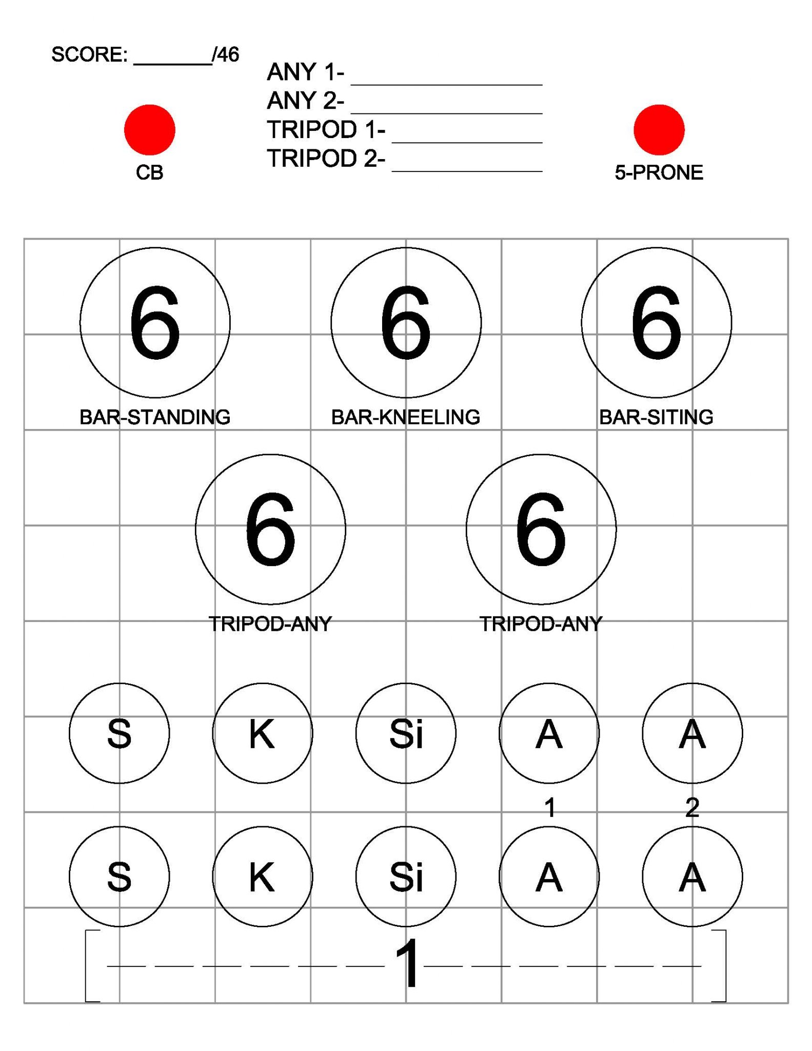

    I just added a 1" grid to the background. I wasn't sure if you had a rhyme or reason for the dot spacing and/or dashes around the "1" at the bottom. I scaled your image for the dashes and just spaced the dots symmetrically. Let me know if this is in the ballpark of what you are after. The PDF is scaled for standard letter (8.5" x11") - so do not print to fit.

    Here's a cleaner version with a simple 1" dot with cross hairs. I also revised the spacing of the ten (10) 1" dia. dots so that they are 1.8" from center-to-center (i.e. 5 mils @ 100 yards). I static mount my optics to check tracking, but I also like to draft my targets with known spacing for simple gut checks while shooting. Spacing gets a little big, and you might miss just off the edge of the paper. Anyways, let me know what you want revised, and I can probably get it done today or later this week.
