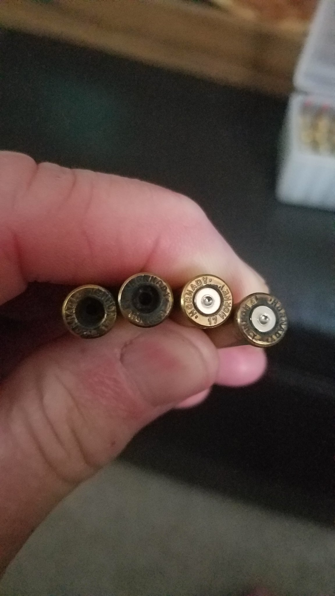

Here's some 17 Hornet that have been shot over pressure. Look at how large the primers have grown.

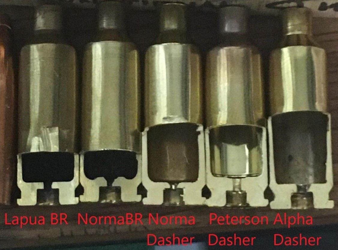

Let's see if I can help . . . take a look at these pictures:
Notice the differences in thickness for the different area's on these various cases and the little differences in design. On the chambered case, note how much of a case in not inside the chamber.
Imagine the force vectors being applied to the surfaces from inside the various case designs. That unsupported area at the base of the case will expand due to pressure, thereby opening up the primer pockets. But how much and how fast it does that will depend on the thicknesses of the cases as well as to the particular hardness of the cases. . . and how hot the powder charges are that's being used.
View attachment 7901522 View attachment 7901523

Thanks for the images. I hijacked one of them and I will use it to explain my question.
okay, the firing pin just ignited the primer, the powder is now in the form of a gas, it is very hot so the pressure is high. The gas atoms are pushing against the walls of the brass. For engineering purposes we can assume that the pressure vector is perpendicular to the wall - that is, straight down like the long red arrows, straight against the side walls for the orange arrows. The bolt face can be represented as a pressure vector opposite to the long red arrows. Hold off on the short red arrows.
Imagine a strange sort of sandwich - a piece of meat with a piece of bread on top. Spread mustard on the meat. Press down on the bread. The mustard will squirt out the sides - mustard yield strength is exceeded and it will flow from high pressure to low pressure.
Now think about the short red arrows. If the brass yield strength is exceeded the brass, like the mustard, will flow toward the weak areas not supported by the bolt face or the chamber walls. On the other hand, if the brass is strong enough, if its yield strength is high enough, it will temporarily elastically deform then return to shape. And that is mostly what we see. Brass can be reused several times without resizing the case head because the case head does not plastically deform - much. But not forever. Based on experience, some of the brass will exceed yield strength and will flow. In some cases the case head gets larger and since sizing does not apply to the entire case, after some firings the brass won't fit into the chamber or the bolt head anymore. So far, so good. To my mind, so far the theory and observations match.
[By the way, don't anneal case heads. It lowers their yield strength and one shot will wreck them.]
Now to the short red arrows representing pressure and force vectors in the brass. I am trying to say that the gas pressure increases the pressure on and within the brass and the brass deforms in the directions where it is not backed up by steel. But notice, right in the middle of the base is this hole where the primer goes - the primer pocket. Will the increased pressure cause the brass to deform into that hole? If yes, then that hole will get smaller and the primer pocket will get tighter. Is the primer itself strong? If yes then it resists the pressure and the brass deforms in other directions.
Back to our strange sandwich only this time no bread, it is made with a bagel. When you press on the bagel, the butter (it used to be mustard but who eats mustard on a bagel?) flows both outward and inward into the hole in the center.
And there is my question - why doesn't the primer pocket get smaller? I think because the primer resists. But I think that is not a completely satisfactory answer. Primers are not that "tough". Could it be that gas flows into the primer pocket and resists the deformation?
Mostly it doesn't matter but I wonder if case heads could be engineered so that primer pockets would not expand.
There is an open flash hole going from the primer pocket into the case so the pressure pushing outwards in the primer pocket will be the same PSI as that in the case.
The primer isn't strong enough to contain much pressure so it mostly falls on the case head and bolt face.
Cratering and ruptured primers are obvious signs of primers exceeding their pressure limits.
But yes, the primer pocket absolutely holds pressure during the firing sequence which is the primary cause of primer pockets loosening.
Go ahead and add your arrows within the primer pocket.

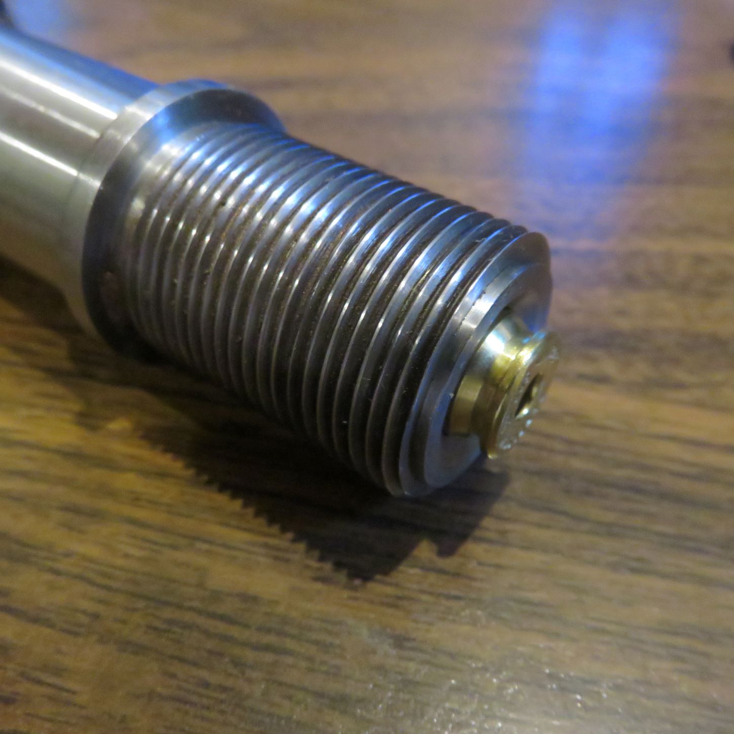

As pointed out by McCrazy, that pressure moves through the flash hole into the primer area and pushes out as well. So the force pushing out of the powder chamber into the unsupported area along with the pressured in the primer area pushing out results in the eventual expansion of the primer pocket. And as I see it, the vector for that expansion is very much like you've illustrated in the two short red lines at the bottom of you pic.
Interesting, isn't it, that a non-expanding primer pocket has indeed been engineered? o_O:giggle:

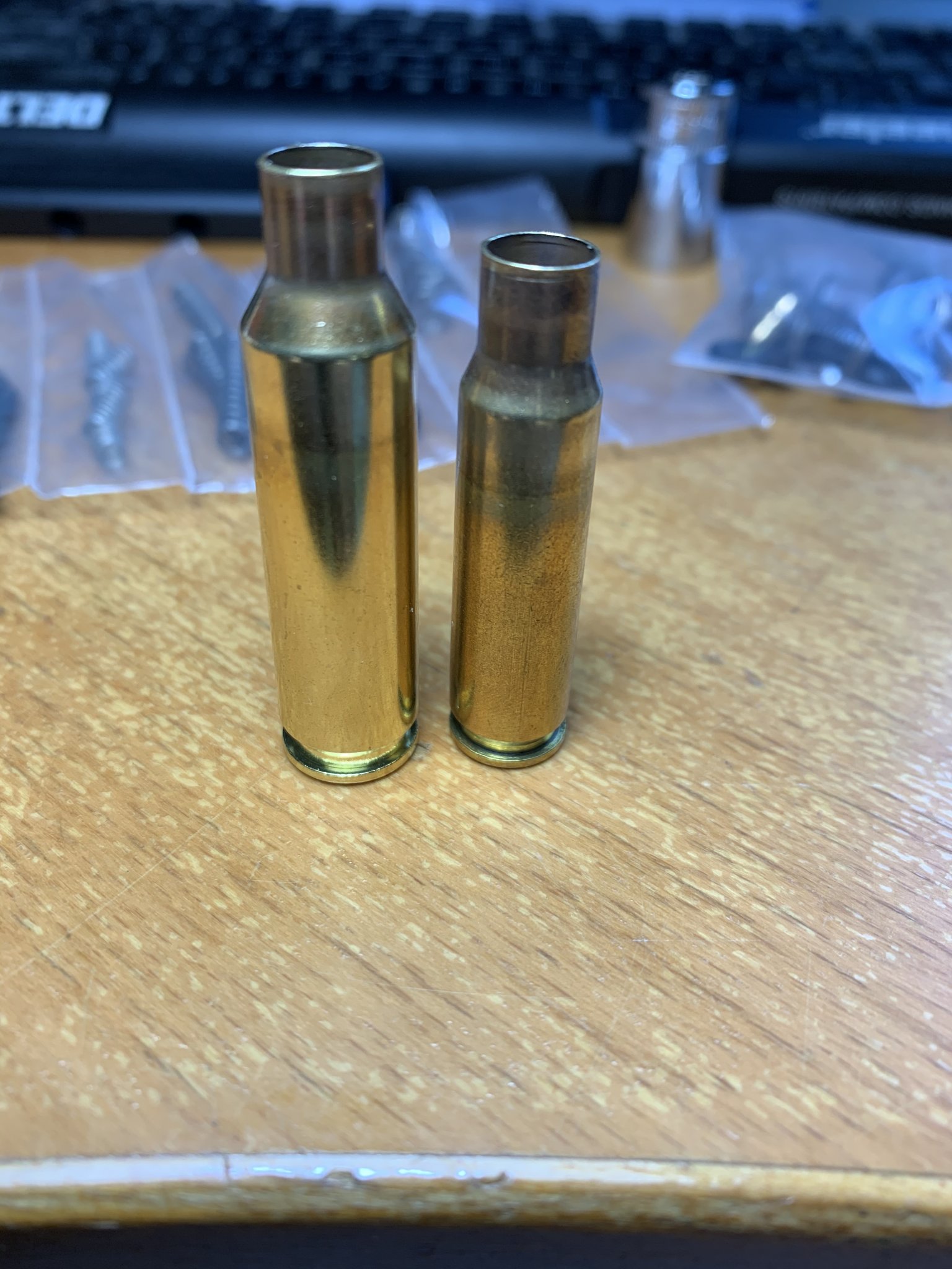

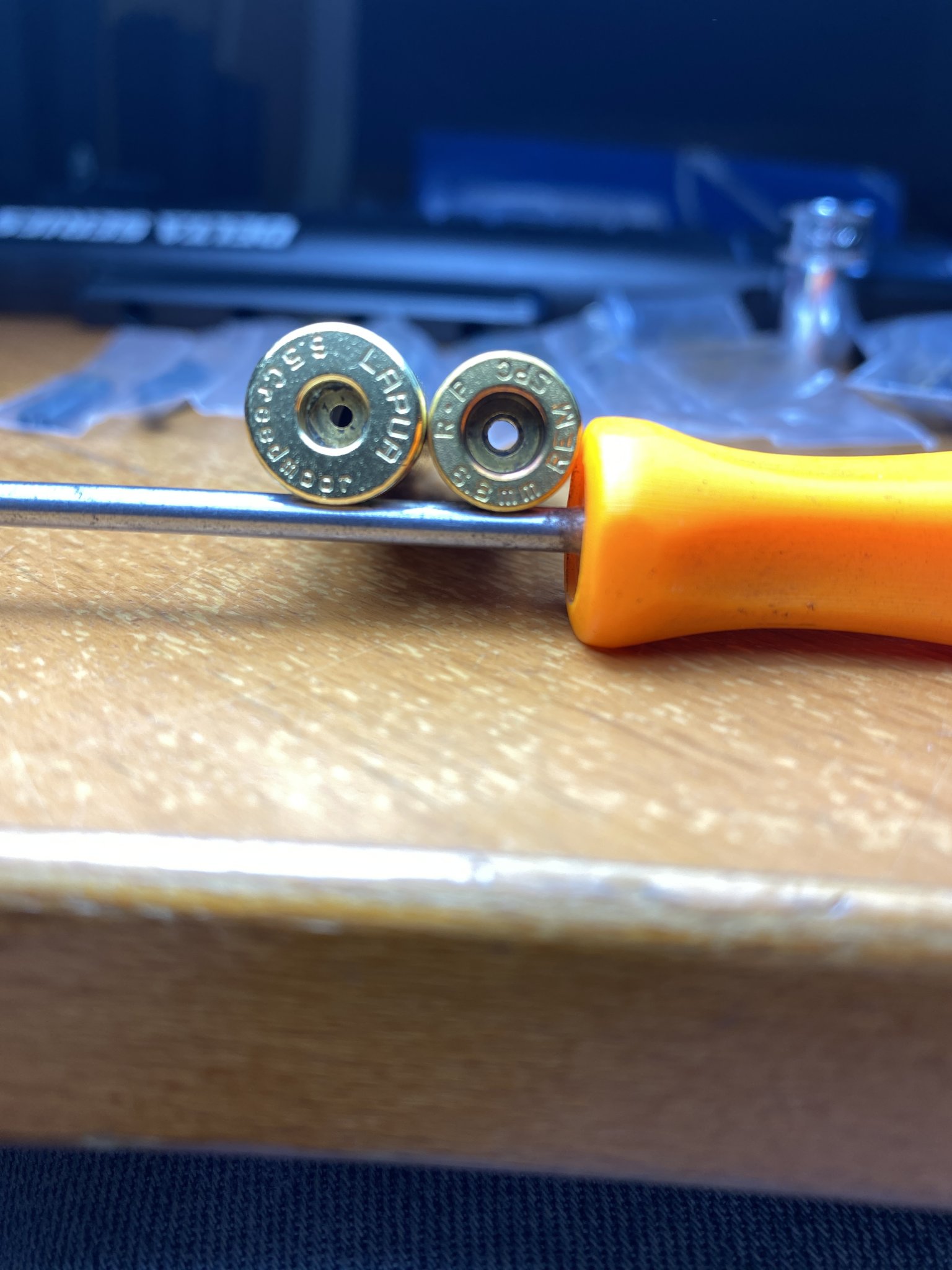

I thought it worth throwing out a few thoughts I haven’t seen mentioned.
Pressure is the obvious answer, but I’m also thinking about time & area on which the pressure acts.
The 6.8 SPC pictured is kind of a worse case for pocket life expectancy vs. the 6.5C Lapua that is optimized.
The circumferential wall surface area of the large primer pocket in the SPC is + 22% vs the small pocket in the Lapua. This is the radial wall of the pocket. The area the pressure acts on to stretch the pocket.
Pressure x area equals force. So given the same pressure say 58k a large primer pocket has to deal with 20% more force acting to permanently deform it.
The other obvious stand out in the picture is the huge flash hole on the SPC. .082 vs .063 on the Lapua. That’s +41% flow area.
So this early example SPC has a large pocket on which the pressure acts, reduced cross section due to the large pocket, & a huge flash hole further reducing cross section & allows the pressure to act more quickly. Bad juju!
Lapua has figured out that .063 doesn’t impede flash discharge at all. I’ve proven it myself testing the same load with GM205 vs CCI #41. The 41’s are the hottest small primers based on my unscientific testing via firing a variety of sml primers in empty cases. Gained 50fps with that primer switch all else same & that tells me the small flash hole is no impediment.
It can’t cost more money for the big manufacturer’s to follow Lapua’s lead & shrink the flash hole. Why don’t they?
Is there really any reason to run a large primer in any short action cartridge?
That difference is roughly the equivalent to necking a 223 up to 25cal. The effects of extra surface area on a bullet is pretty well known & same applies in the primer pocket.
It might not cost more when setting up a line, but I’d imagine renovations to a line could be prohibitively expensive. Institutional inertia is the main reason I can think of for staying with an old way…
