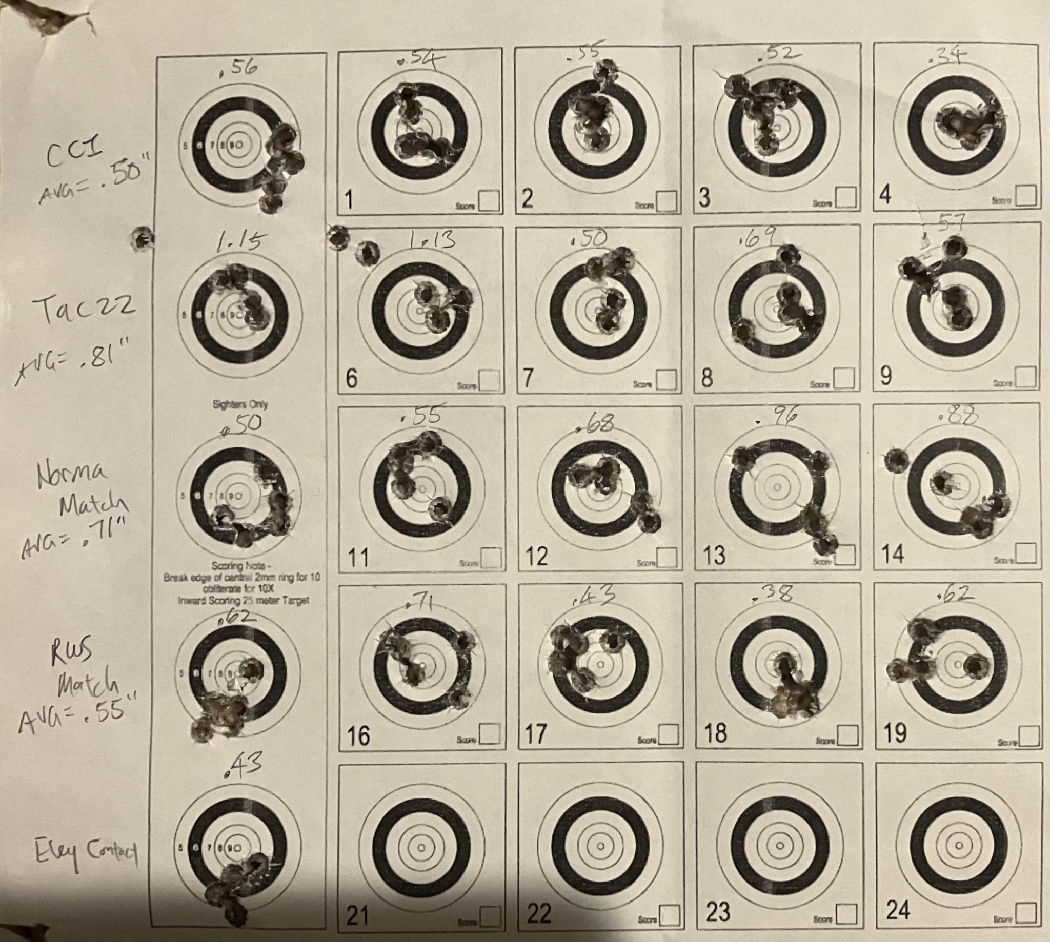

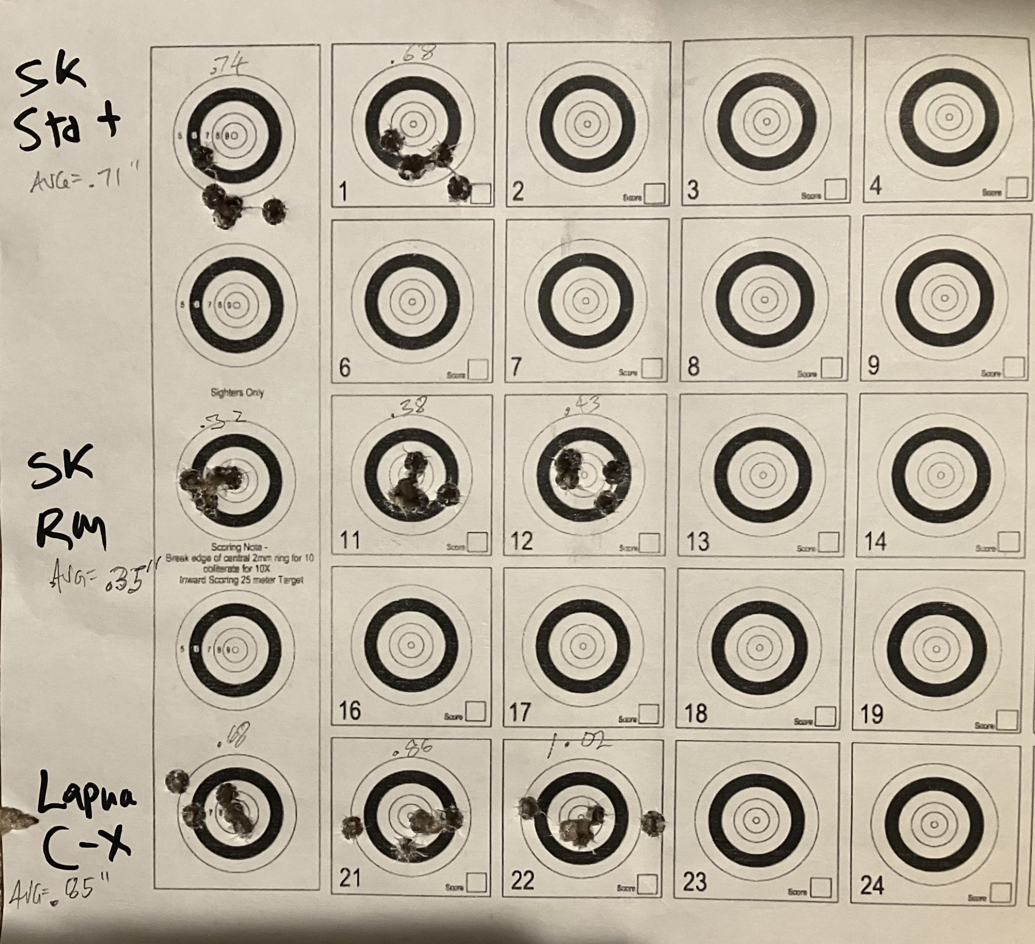

Not the same rifle but I recently dove into the 22lr precision game with my 3 CZ rifles. Lapua Center X shot very well but is almost nonexistent on the market so I have stopped looking until maybe someday it comes back to market in decent quantities. Dang near everything SK shoots extremely well with Standard Plus and Long Range Match being the best. None of my rifles like anything Eley and all I can attribute that to is the different bullet lube. Lapua and SK are a wet/waxy lube and Eley is dry. Shooting Eley immediately after the other 2 brands, without cleaning, resulted in huge groups of the 3" variety at 50 yards for me. The lubes are not at all compatible with one another in a fouled barrel. YMMV.

Example groups below, CCI SV shot well out to 200yds and was tightest in the chamber (would not extract an informed cartridge when chambered).
YMMV, happy shooting.

Well my friends! This baby can shoooooooot!!!! Holy crap! Set up a target on my local rifle range at 50 yards (spray painted orange and then sharpied a black dot in the middle of each for aim point). Needless to say the groups (5 shot groups) were fantastic. Lots of same hole with one or two slightly outside of it. Looks like CCI SV and Fiochi field dynamics are the best shooters out of my 22lr with CCI mini mag, browning match, and federal target being just decent.
Sorry they aren’t labeled but CCI SV is on the left and the Fiocci FD is all the way right.
