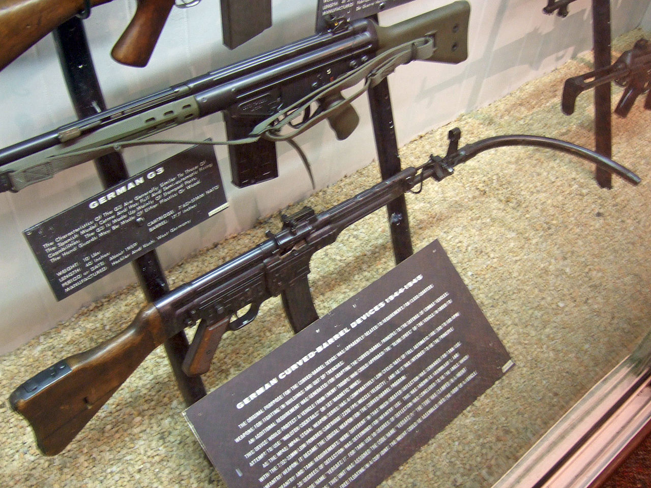

is your scope flat on top of your rifle does your rifle look like this
good luck figuring it out and fixing it .
