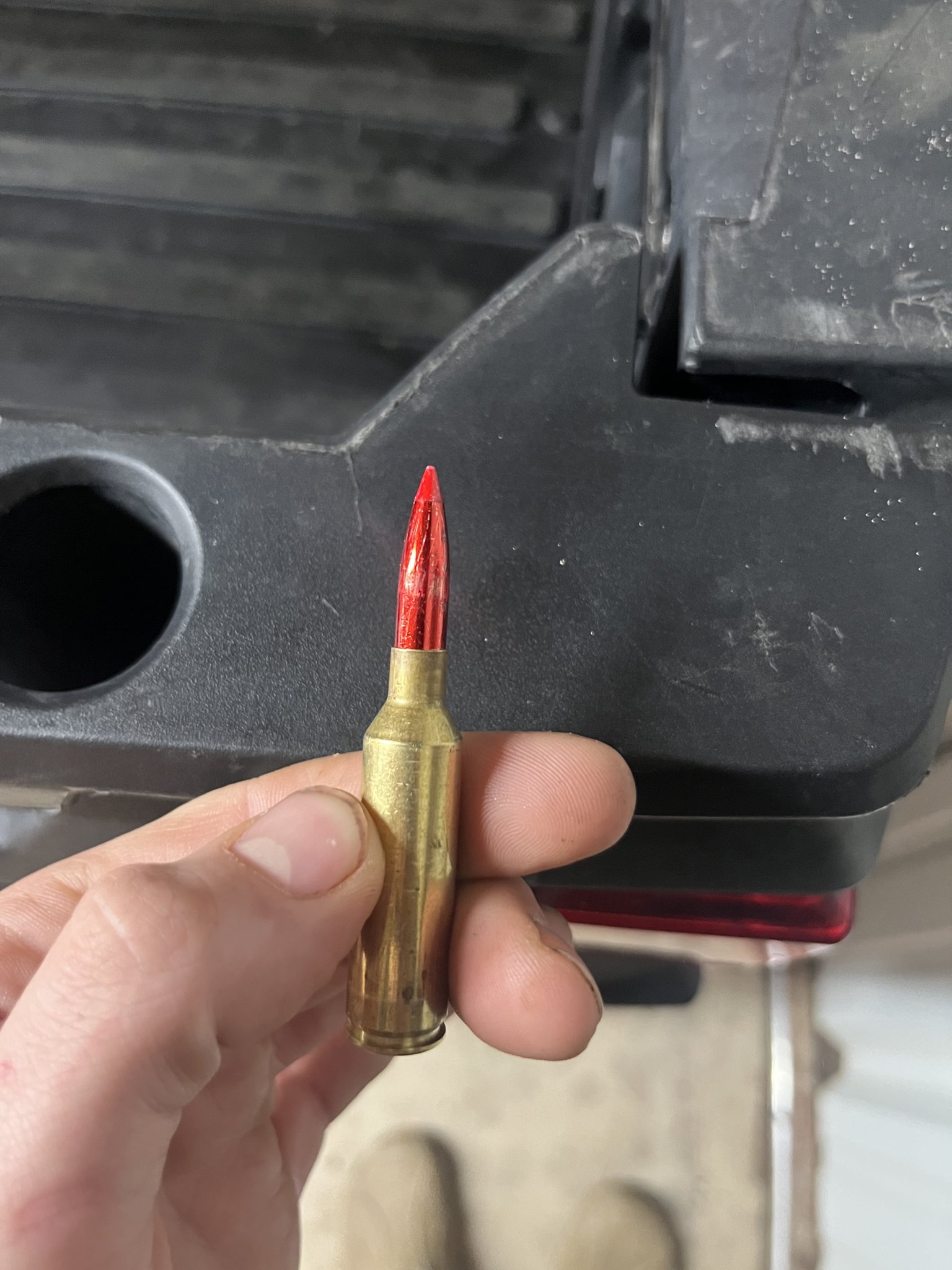

I'm Brand new to reloading. I'm currently trying to reload for my 6.5 Prc and 22 Creedmoor. The current issue I'm facing is that I can't get the bolt to close When I'm sizing, I test the case to make sure it's smooth in the bolt. Then after all the other steps when I seat the bullet to the O.A.L my bolt hangs like the bullet is too long and have to almost slam the bolt to get it to close and I'm really confused as to what I'm doing wrong. I've watched my FairShare of YouTube however I guess I didn't learn anything. Any Advice would be greatly appreciated!
Could be a number of things from that description - color a loaded round with a black sharpie, then try to chamber it. Pop it out and you should see some spots where the marker has come off. Post a picture back here and someone will be along shortly to help troubleshoot.

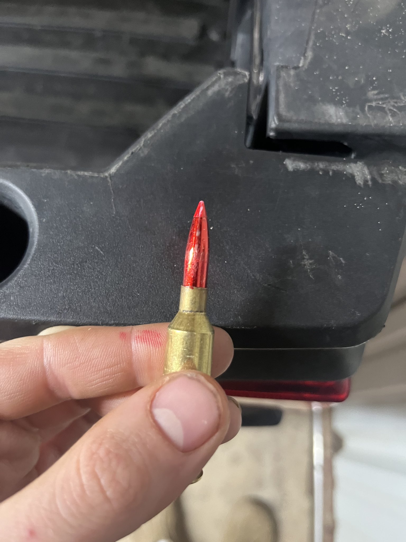

I colored the bullet with sharpie and you can’t really tell the difference. I took a video of the difference between the force of a factory load and the handload but I am trying to figure out how to add it.

I had a similar issue earlier this year and realized it was because I wet tumbled too long and it rolled the case mouth over. The brass would chamber without a bullet seated but wouldn’t with a bullet seated. Trim length can also cause similar issues. The sharpie test didn’t show me much on that issue either. Solved it by trimming the end of the case mouth off. I could feel the roll/burr it was forming with my fingernail

Two possibilities come to mind.
Bullet is seated too long and engaging the lands before bolt will close or you have a tight necked chamber and the case necks are too thick to chamber with a bullet seated. From your pics, it doesn’t look like the first.

Color the whole case to see if/where the case is dragging.
Also it looks like your case mouth has something going on, did you chamfer and debur?
How much are you pushing the shoulder back? What sizing die are you using? How many times have your cases that you are currently reloading been fired in your gun?
It does seem like there is a lip formed at the case mouth. Can you feel a "burr" sticking out there?

I'm uninformed on pushing the shoulder back. I'm currently using a FL RCBS 6.5 prc die. The brass shown in the photo is once fired Hornady brass the bullet is a 140 Nosler accubond. it was deburred. I did notice when I sat the bullet there was a slight copper ring created at the case mouth, I'm assuming came off the bullet. I don't have a real scientific way yet on sizing being that I've only loaded maybe 12 rounds in total. from the video I watched you make the sizing die touch the shell holder then procced to turn it a quarter of a turn more. that's what was done the brass shown in the photo. The brass itself was smoothly chambering.
Looking at your picture it looks kind of like you belled your case like your loading for pistol. You need to find out what in your process is doing that. If you can get a factory crimp die see if that takes care of it? Sorry best i can come up with.
You say you have a copper ring? Is it from your bullet jacket? Find that out first . Use a dental pick see if it is. Are you loading fb or bt? Just trying to understand your issues.

Swet fucking Jesus. Stop. Go get a case comparator - even Hornady - before you screw those poor cases up any worse.
I am assuming the guns that you are shooting are SAAMI chambers and you don't have a tight neck. Would help just to give info on what guns you have.
The copper ring you are seeing is the brass in the mouth/neck is peeling back some of the bullet as it is seated. To cure this take a chamfer tool and run it around the neck on the inside of the mouth of the case, this will take out the sharp corner on the mouth of the brass.
He is shooting a Nosler 140 gr accubond which is a boat tail.
The way you are setting up the full length die is fine for now. Eventually as you get more experience, get a body die and learn how to push the shoulder back a few mils, this will increase the life of your brass. You will need to buy some more tools to measure the shoulder, at this point though you should be fine.
When I start reloading for a new round I get a box of factory ammo. I set my seating die for the bullet to that depth as a starting point. Never had any issues chambering a round with that method. From there you can start experimenting with different depths, after you figure out what powder load gives you the best accuracy.
You will need to understand "shoulder bump" before you move forward. You will need a caliper and headspace comparator. After a case is fired in your rifle chamber it forms itself to that chamber. Use the tool to measure that case length at the shoulder. When you resize you want to shorten the case length at the shoulder by 2-3 thousands of an inch. This will allow for the loaded case to slide completely into the chamber.

If you are scraping copper off the bullet during seating you will need to chamfer the inside of the case neck. It doesn't take too much but a little.

Are you sure it's the bullet not letting you close the bolt? I usually have more issues with the shoulder than the bullet depth and have also had issues with the base of cases getting stuck that resurfaced again later when sizing for another chamber. This is mostly due to firing cases in one chamber and then reloading them for another.
Try chambering your resized brass and see if it chambers WITHOUT a seated bullet, this will tell you if the error is in die setup.
I would suggest some measuring/comparator guages...more than likely you are not sizing your brass down enough either at the shoulder or further down the body.
If your shoulder bump is down enough and the case is still sticking, then the base is causing the issue.

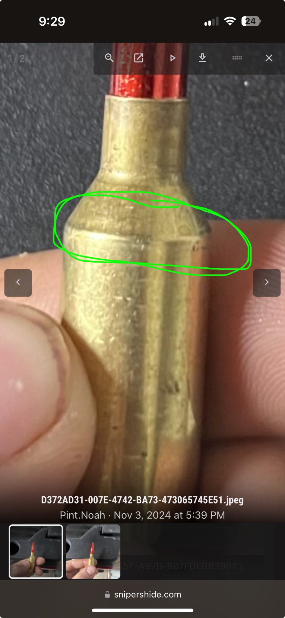

From your pic, it almost looks like you’ve got a bit of a bulge where I circled that could be your culprit (supporting the theory above). Make sure you’re putting a piece of brass in the shell holder, raising your ram, screw in seating die until it touches the piece of brass, lower the ram, then back the die off a whole turn before you lock her down.

I’m sorry I’m watching MNF and half distracted. If what I wrote previously doesn’t work, sharpie the whole damn case and bullet when seating and show us the case after that.
