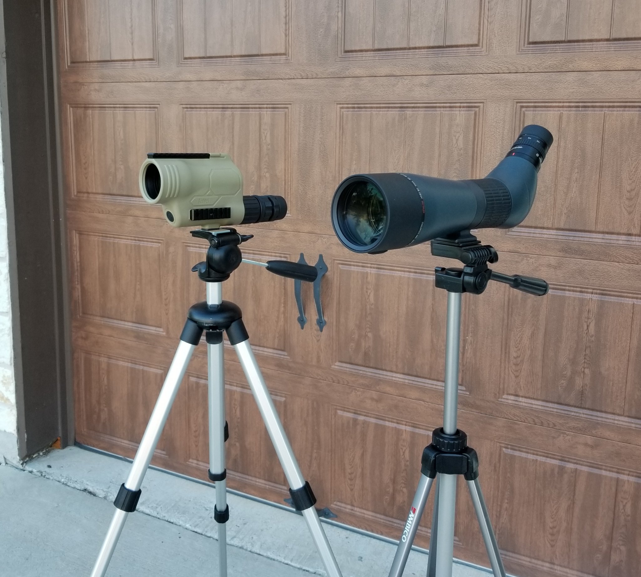

I have an Athlon Ares that smoked this Bushnell Elite.....still have the Athlon and use it regularly. Couldn't sell the Bushnell fast enough. I don't think Athlon makes this spotter any longer, but I'd look at their Cronus spotter. Best value in the optics world IMHO.
