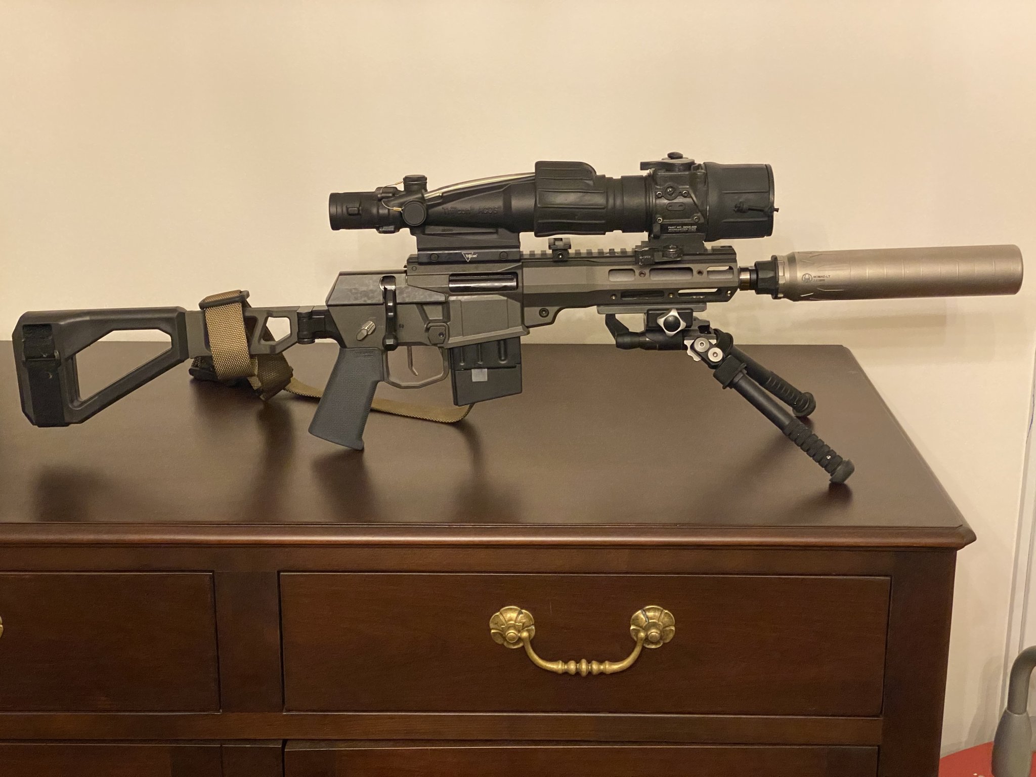

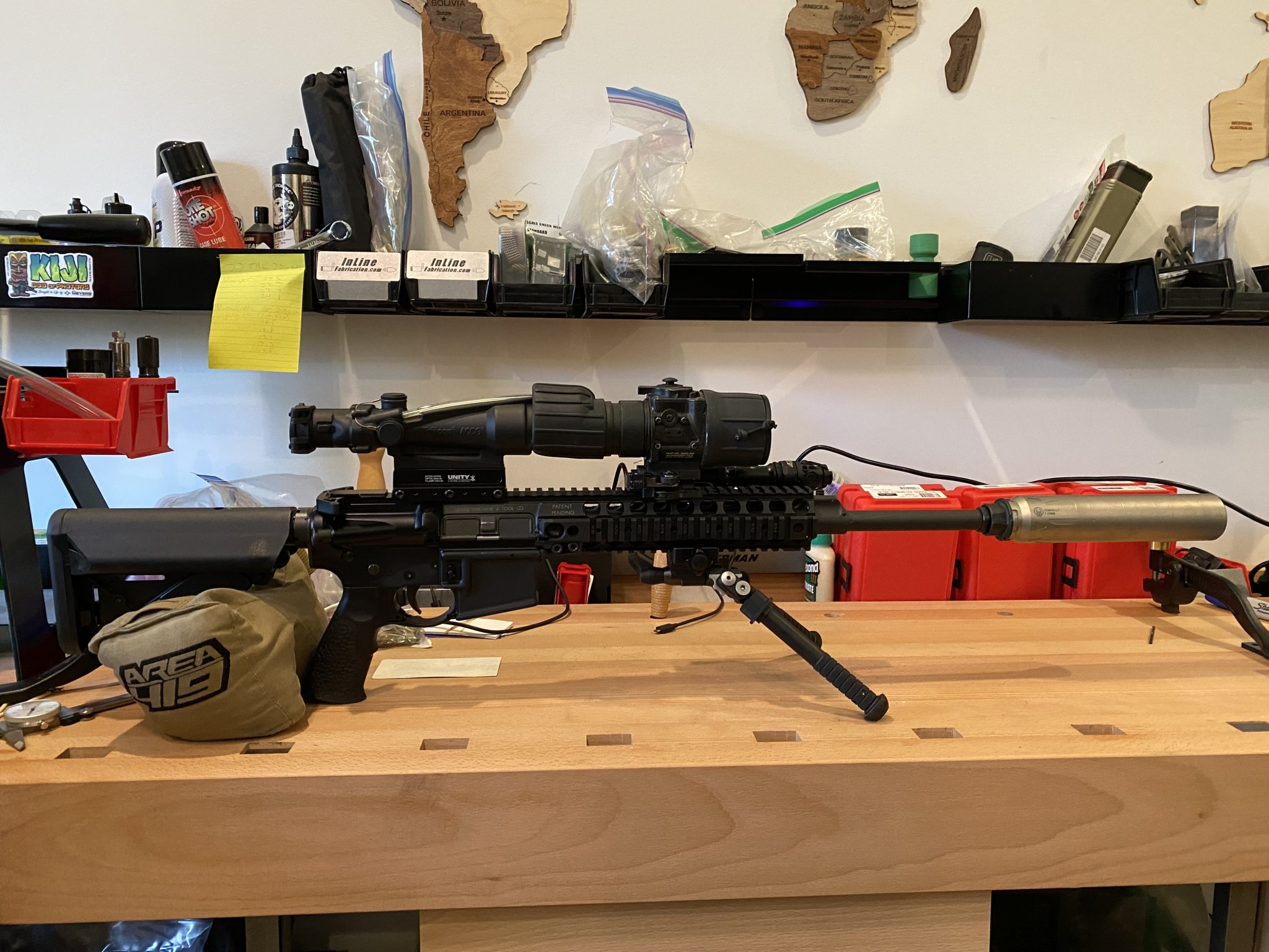

    I use my PVS-24 mostly for coyote hunting. I find it ideal for that use with one hunter using thermal and one NV. I have used it with a 3-12x56 Hensoldt and a TA-11 3.5X Acog with my 5.56 AR rifles. I also use it with a TA-11 Acog on a modified Ruger 10/22 with a Kidd barrel and Bravo stock. It is a match made in heaven with the TA-11 Acog! With the 3-12 Hensoldt it is good up to around 7 power. FYI - mine does have an Elbit White Phos tube installed by SureShot NV.
    The lightweight and compact length helps the PVS-24 work great on rifles for actual field use. The controls are also easy to manipulate and reach while hunting. If you are primarily wanting to shoot long range at night there are better options. Or if you are wanting to use it on a heavy recoiling rifle, don’t pick the PVS-24. It is supposed to be limited to 5.56 class and down.
