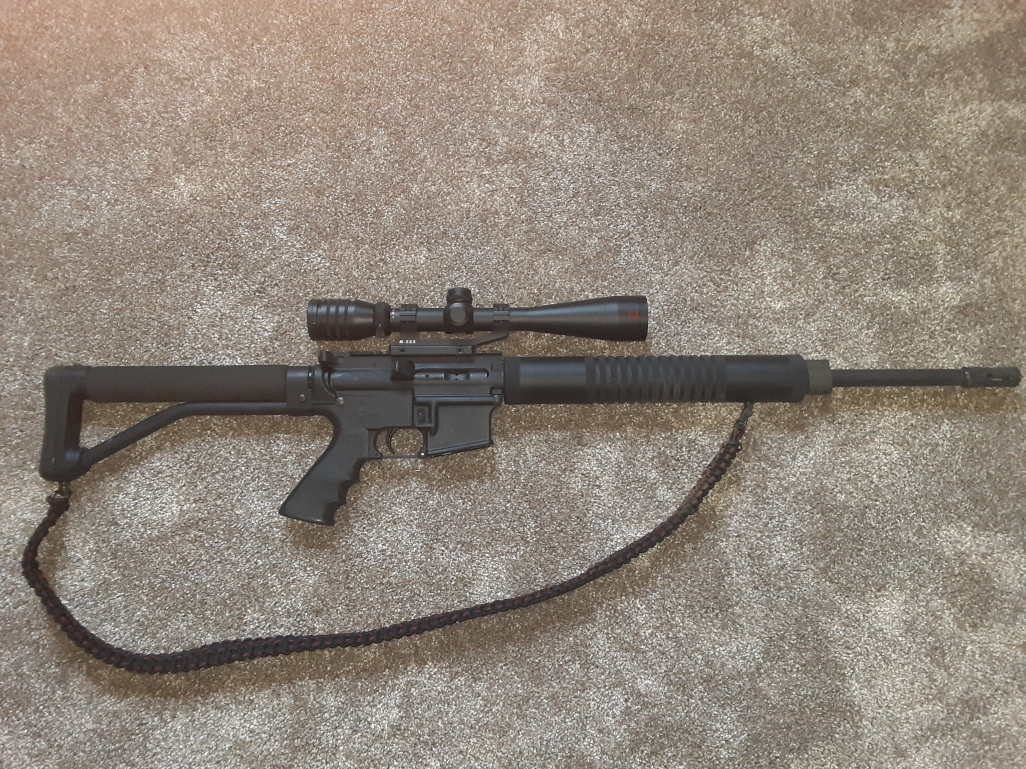

Once he sold out to Freedom Group, they became DPMS parts guns mostly with a modified Bushmaster logo that no longer included the Bushmaster ARM bullpup. I sold a ton of the early 2000s, ban-era guns, a lot of them with 14.5” and muzzle brakes, with pinned M4 stocks.
That reminds me, the cream of the crop back then for forged receiver AR-15s were Wilson Combat with precision-machined receiver fit, nice lightweight fluted barrels that were still highly-accurate, nice coatings, fit/feel/finish, drop-in CMC trigger cassettes, fixed stocks, the A2 comp muzzle device, free-floated carbine tube handguard. Once the ban ended, they got the usual telescoping stocks and flash hiders.
Looked like this after the ban expired in 2004:
