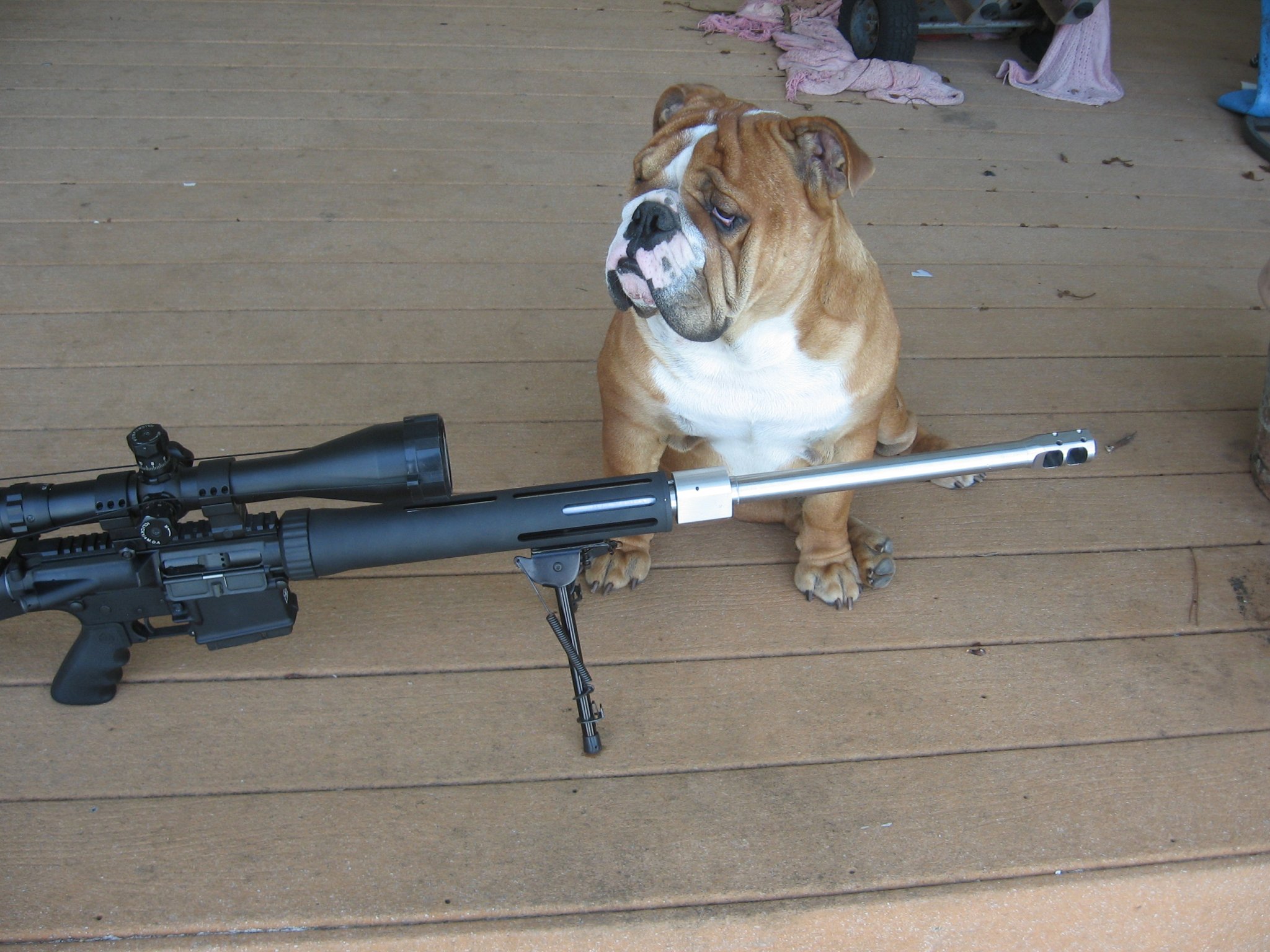

Intended use ?? paper punching/load development **, hunting , or just a new project ? Several have suggested LC brass, I would suggest LCLR brass because there is NO crimped primer to deal with. Also most 1 x LC brass has been fired in machine guns , M240's or M 60's. Just think way over sized chambers and as such will test the construction of your reloading bench when you try to FL size them.
An internet search will produce several places offering M-80 LC 308 brass and a few offering FGMM 1 x brass and maybe LCLR brass.
