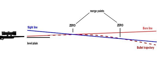

Not exactly. Spife has it in his diagram. We typically use a 100 yard zero because; with typical cartridges and typical scope mounting, the line of sight is- more or less- tangent to the arc of the bullet path at 100 yards. This allows us to dial “up” for both very close and very distant targets. However, if your bullet trajectory and/or height over bore are non-typical, you can be in a situation where you have both a near and a far zero, and between these zeros bullets will impact above the line of sight.

Absent a 5"+ high scope mount, if he is in fact zeroed at 100, it's low at 200. Yes, there are two zero points on a trajectory, but with conventional sights and cartridges, the near/far zero at 100 yards is at best 100 - 105. Caliber is not stated, nor is bore height, but a .308 with a factory type scope mount/base might be zeroed at 500 yards, and it would also be on zero at about 11 yards, the initial intersection. I await a ballistic chart showing an off the shelf configuration that would produce a 100 yard initial intersection and a 5" high 200 yard trajectory.

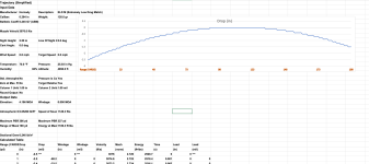

Hmmm...yeah, I was using the Hornady app, but it doesn't show as much information as yours. I'll look at this chart data a little closer, but both seem to show a plateau at 100 yards, and doesn't appear to have enough definition to show a dual cross-over the line of sight.

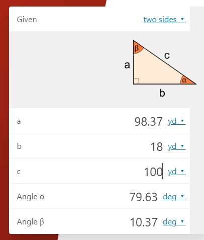

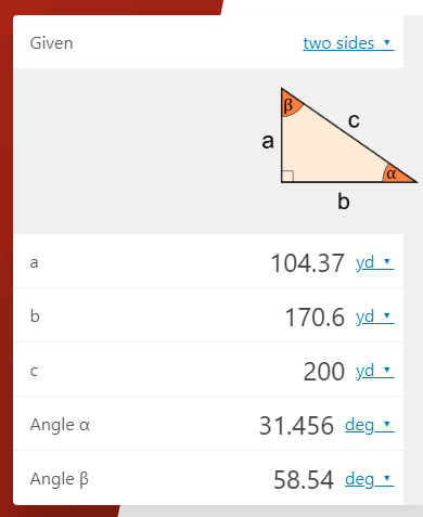

The only way he'd even get close to 5" high at 200 is with a zero distance of 18-19yds. If he had an 18yd zero, it'd mean his shooting position was 98.37yds above the 100yd target and shooting off the edge of a cliff at a 79.63 degree angle, or the other way around, shooting up towards a target on top of a cliff.
When it comes to shooting the 200yd target though, he'd only be aiming downhill at around a 31 degree angle. Angle compensated horizontal distance would be 170yd.
Agreed. Something is way off. I imagine I was elevated, at most, 10' (3 yards), so I can't imagine that affecting the shot placement by 5" high. Would the bullet even strike above the target in this scenario?

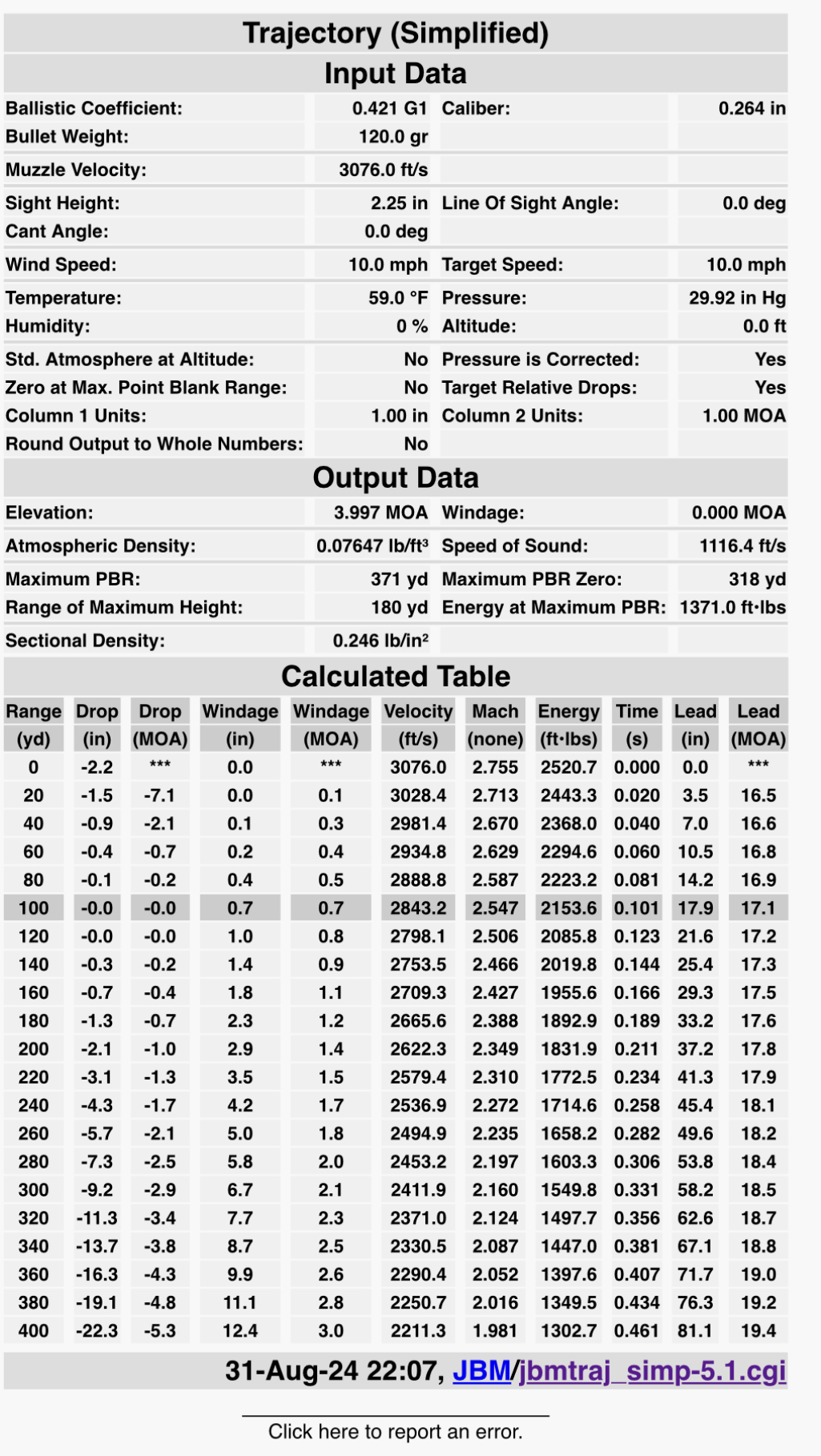

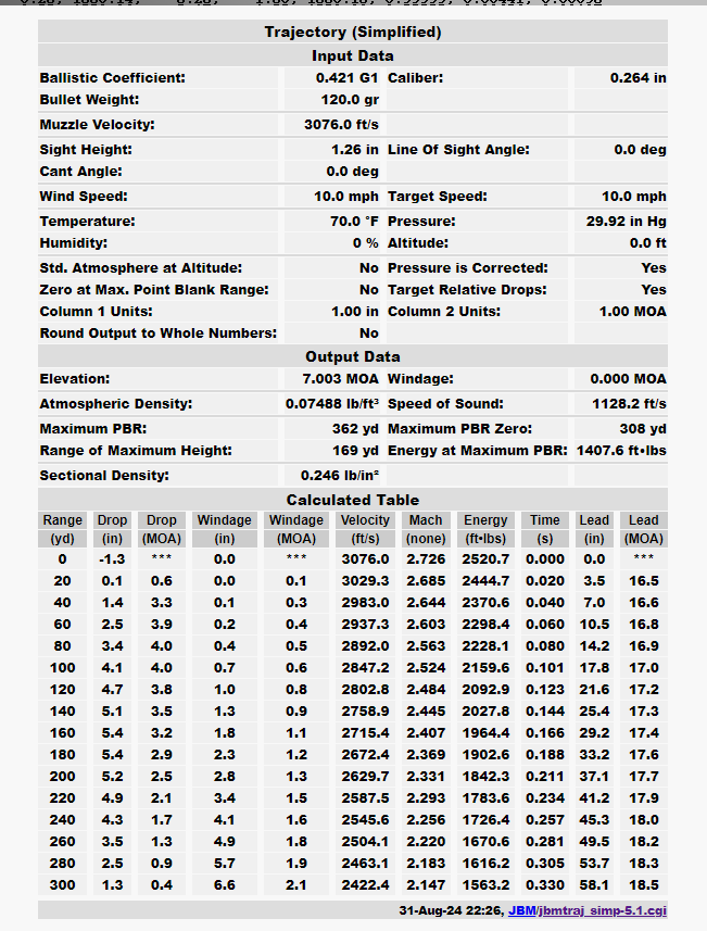

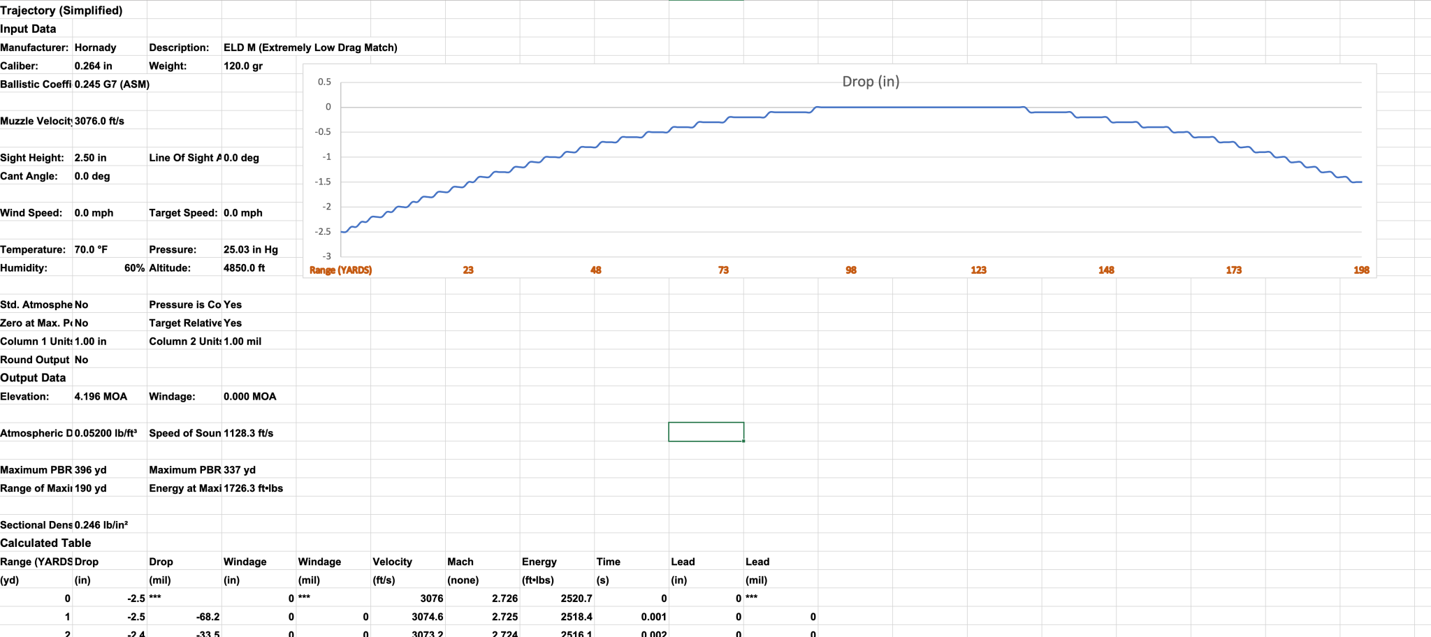

I was trying to figure out what would happen if you were zero'd at 100 yards and then shot uphill to a target 3 yards above the muzzle elevation. If you didn't make any adjustments to the scope turret, where would that impact the target? High or low? How about if we repeat this, but shooting downhill? Where would that bullet strike?
I ran some ballistic data that is a bit better than my Hornady app. I had to use a Hornady round instead of Federal, since it wasn't on the list, but I selected a 120 grain from Hornady. It's probably close enough for these purposes. This trajectory is pretty flat at 100 yards. It does appear it's highest elevation is at the target height. Interesting. But, if you let this go out to 200 yards, it should shoot 1.5" low...that's pretty close to what I expected. Either way, 5" high suggests something else completely. Is there a way to us the app to modify uphill/downhill by use of actual elevation, rather than angle? If not, I can do the math and create the angles.
