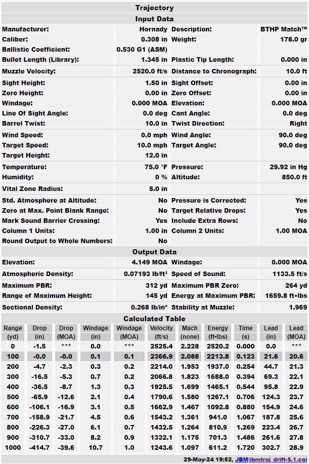

    I've not shot 178s, but the 175 Match King needs to launch around 2550 to reach 1,000 supersonic. Not sure but I think 178 A-Max is longer.
    JBM says you should be good-to-go for a Hornady 178 Boat-tail Match with your given met data:
    Thanks Sinister for the JBM, I've used the 178 HPBT in an 18 inch LW 1/10 since forever . I'm thinking this new barrel is the culprit. It's a LW 1/10 too but something just isn't right. I have about 260 rounds on it and the first one took a while to come in but by time I started shooting at distance it was already broke in and settled down. This new one is scratching my head. It's the only thing that's changed in the equation...
