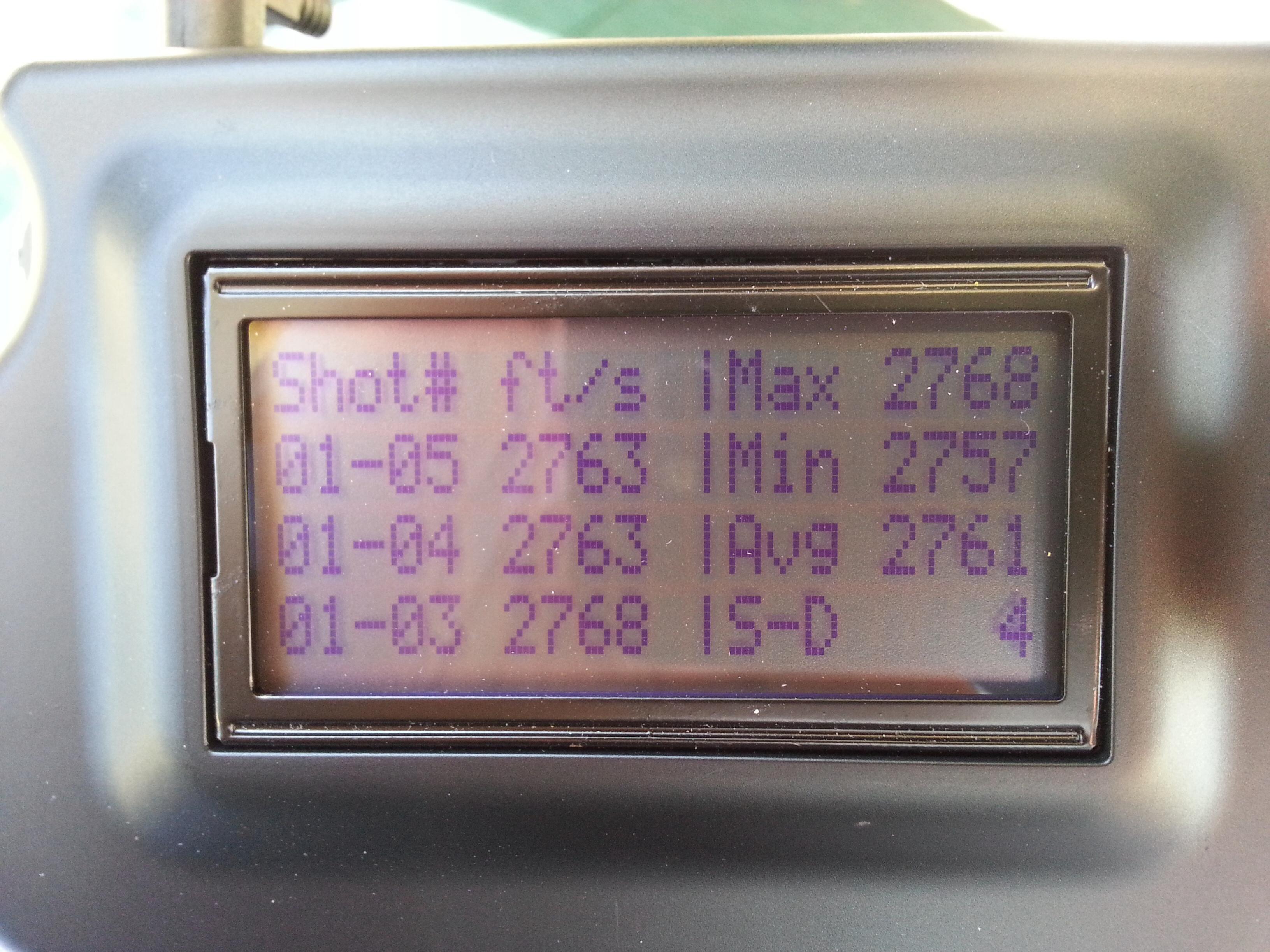

As I said before...you have to check a lot of things. A lot of contributors to aberrant velocity. I run an FX 120i scale, neck size and check case mouths after for neck tension consistency, uniform pockets, and check seating depth to the ogive on every round and when you find the load that shoots.....this is the results I get with 185 juggs, 47.6 gr, seating .090 off
D shooter how are you checking neck tension?
With a dial caliper, using the id caliper side. After sizing I will check this and make sure the case mouth id is .305. My variation allowable to me is +.0005- so basically it can be .3045 to .305. If it's looser than that I'll try to run thru the neck die again. If not it goes in the annealing pile. I use a Starrett dial caliper also. You need good quality equip because cheaper crap can vary between .0005 and .001

Great extensive research and explanation of process....I don't have the pressure indicated press but I'm sure by measuring with quality tools I am getting relatively consistent neck tension. As I said previous, I keep it within half a thou and seems to work great when I hit the magic charge weight. And I thought my numbers looked good.....

I only know one other person that takes as much care as you do with neck tension and seating pressure. He wins just about every match he shoots and blows everyone else away with x count.
