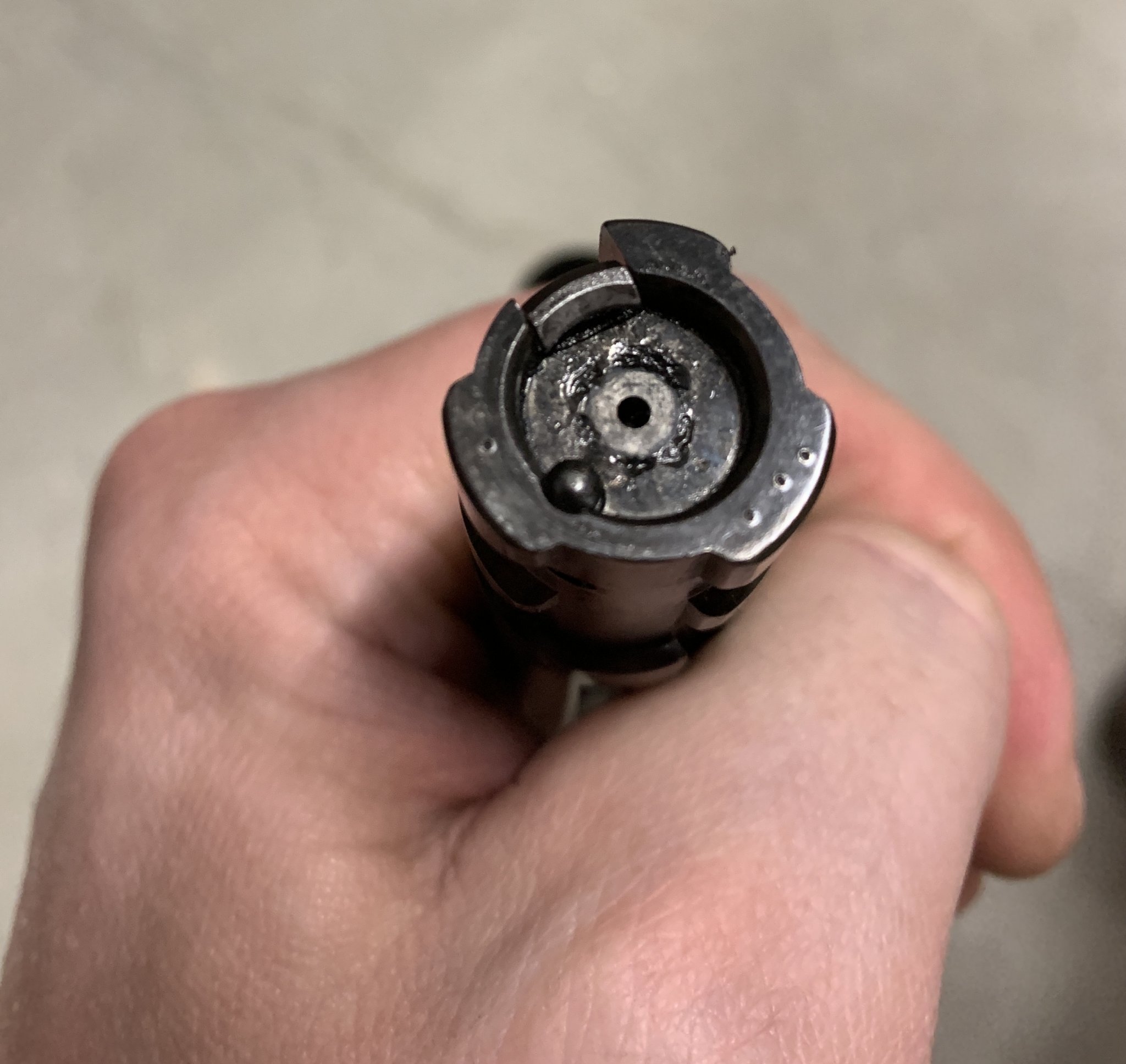

What caused this primer failure?
You can put a .45 ACP case in the bolt face, then tighten the bolt and case in your vice. Drive out the ejector pin with a punch. The ejector and pin should come out so you can clean it out if it's a brass shaving.
I've got the roll pin removed, ejector is jammed in there tight. The 45 case in the vice trick is genius! That will be perfect for reinstalling when I get things freed up.
Reactions: sinister
With the roll pin now out, smacking the bolt, face down, on a hard surface should get the ejector to move.
Surface should have little or no give or resilience to dampen the shock. And hitting “square” is key.
A few good whacks should move it. But better a few solid ones than lots of light strikes that will just peen bolt face. The G-loads you put in it are immense when you do this.
Cheers, Sirhr
Ps heck of a divot for just two failed primers! Makes me wonder about the metallurgy of that particular bolt!
Metallurgy has nothing to do with it for something like this; the steel of the bolt is made to be strong and hard, not to resist gas cutting. Strength and hardness of steel have pretty much nothing to do with how easily it can be gas cut. Try cutting some AR500 plate with a torch or plasma; it cuts as easy as mild steel or anything in between.
Reactions: sinister
You might try putting the bolt in your padded vice, dropping some Kroil down the front (that small gap between ejector and bolt body) and smacking that ejector with a brass punch. Whatever smutz is jamming that thing closed might shift or dissolve.
Wear safety glasses if it goes flying. You may have to replace it and the spring if you lose them.
Is that an LMT? I have one like it (chrome bolt, blued extractor, gold color titanium-coated ejector). The ejector has a slight body bevel, I think -- a grain of something small or fine could lock it up like that.
Failing that you might just have to drill, tap, and pull it out. :(

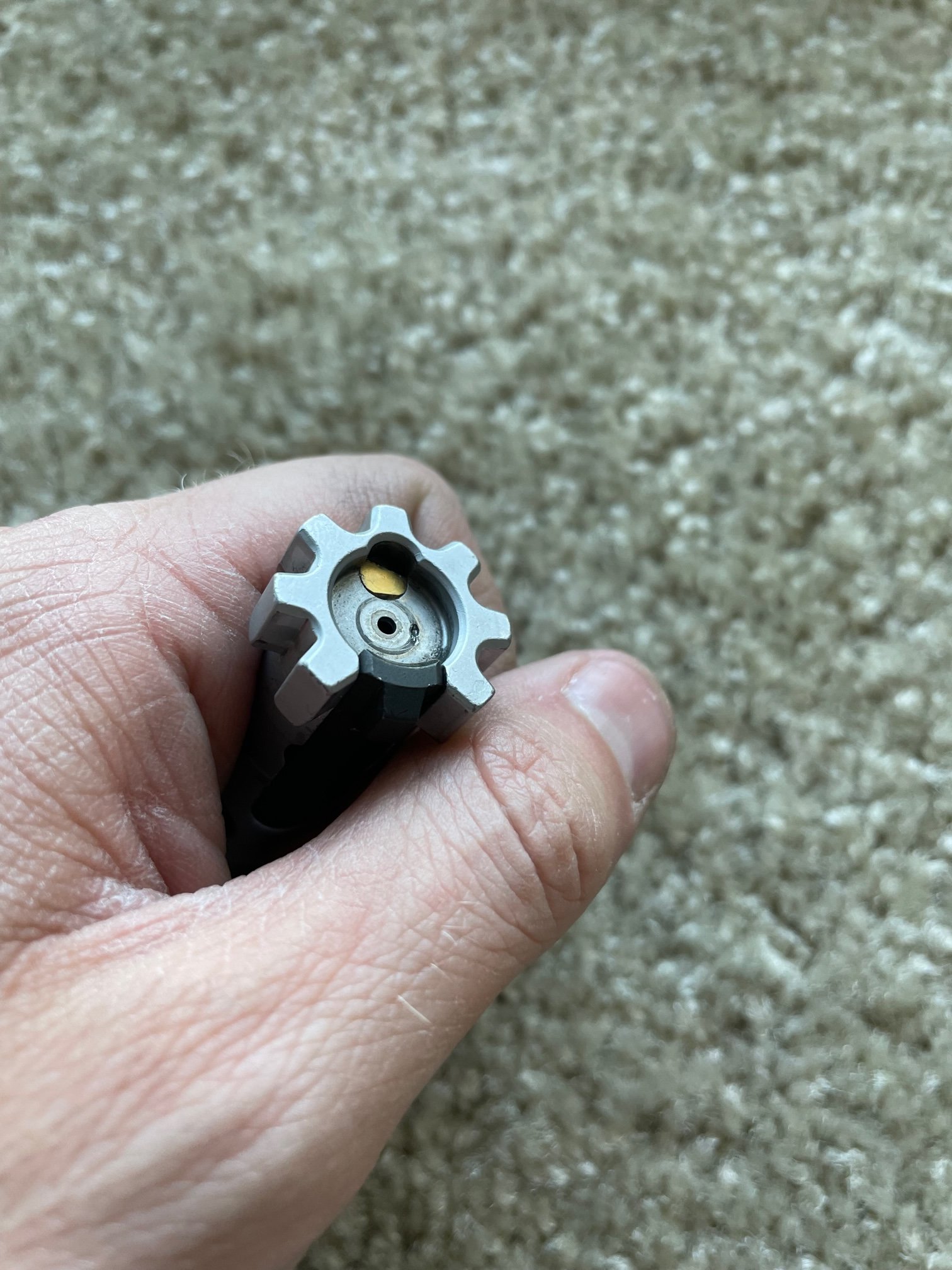

Here's bad gas leakage damage (I don't know the background to these photos, but looks like what happened to one of my National Match AR bolts using Winchester Small Rifle primers after the change to non-nickel plated. My rifle still fired but the bolt face got beat up):
e5be93fd-e75f-4a55-9c64-b3e510d6bb85-jpeg.7612859
Well the good news is you can now replace that legacy single ejector SR25 bolt with a new E2 style bolt!
100%! As soon as I can find a dual ejector bolt in stock I'm purchasing to install in this rifle.
@sinister this is an old school KAC. From the same era that LMT was using an almost identical bolt, this bolt is identical to the bolt I originally had in my LMT MWS.
Reactions: sinister

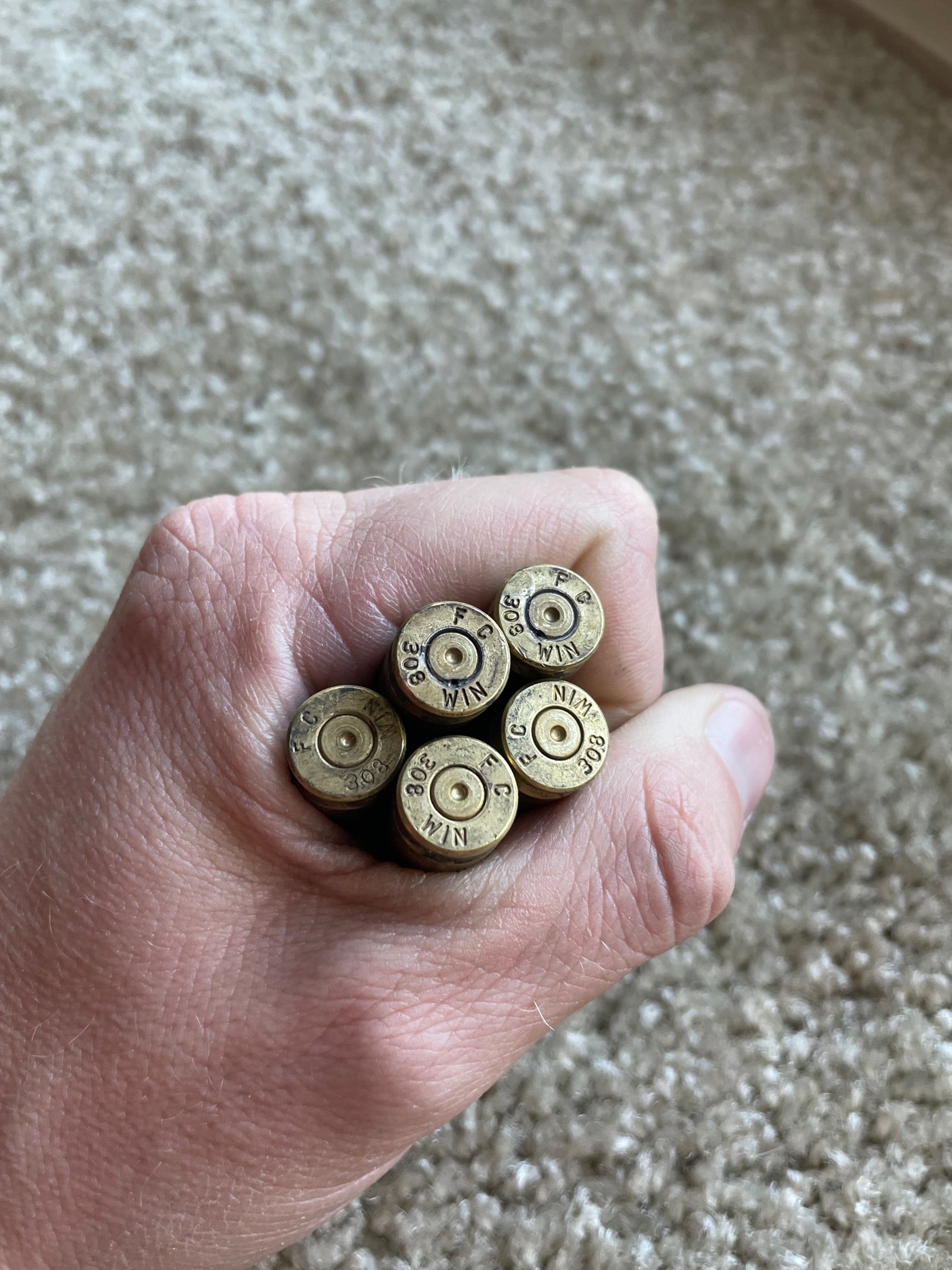

I had the same thing happen to me a few years ago. I no longer have access to the lot numbers, but I contacted winchester and gave them all the lot information and sent them photos of what happened. The had me send back 10,000 primers and offered to replace them with a new lot. I told them I was not interested in any more winchester primers. They allowed me to suit my receipt from midwayusa where they were purchased. They refunded every penny and I immediately turned around and replaced them with CCI primers.
I was not happy with what happened to my rifle, but they did make it right and even told me to take my rifle to a gunsmith on their dime. I never did as it was did not cause a safety issue as far as I was concerned. But they offered and I appreciate that.
Good luck to you.
I have had these a while, I would estimate 10 years maybe so these are by no means new production. Given my primer stash is running low I decided to dip into the WLR pile..... fail on my part.
That's probably about when I got my bad batch of WLR, had a couple pin-hole at the shoulder and etch the bolt on a .270 I had at the time. It's a bummer, but I've never had anything similar happen with CCI or Federal primers.
I think the flame cutting welded the extractor to the bolt body somehow
That bolt is trashed. Call Winchester and see if they will replace the bolt
Yeah this thing is majorly stuck. I got more aggressive and hammered the bolt face into a wooden block multiple times...... still no luck getting the ejector to move.
The bolt is headed back to get worked on so we'll see how it plays out. Win is sending me packaging so I can return the primers I have left for inspection.
I'll be sure to update as I learn more!

I'd say time to order a replacement bolt. If your swapping bolts I'd check with a no go gauge just to make sure headspace is within spec. Don't want to tear up another bolt or worse...
I'm gonna check my primer cache...I don't use many win primers, but I've bought up pretty much anything I can find since the plague started. Hopefully I don't end up regretting it
Reactions: m1ajunkie
As soon as I can find a new spare bolt in stock I'll be pulling the trigger. I've notifications set everywhere haha.
Then I'll run the new bolt as the primary bolt and keep this etched bolt as a spare once the ejector is fixed.

This is the classic Winchester primer failure. If you remove the primer, you’ll see that it’s cracked along the side of the cup, and gas leaked through the crack.
They crack because they’re too hard; I suspect Winchester skipped an annealing step to save cost, but don’t have proof other than the failures. It seems to be specific to the large primers, both rifle and pistol. It’ll happen with mild loads too, even 35-40Ksi stuff like 30/30, in case you’re tempted to save them.
Back when it was common you could call Winchester and they’d reimburse you for them. It took some phone time to get it done, but I had a whole case swapped out. No idea what they’re doing about it now.
This is the predominate reason for the failure. I've seen it with Federal also. The paid to replace a bolt on a Barnard because the cups where too hard.

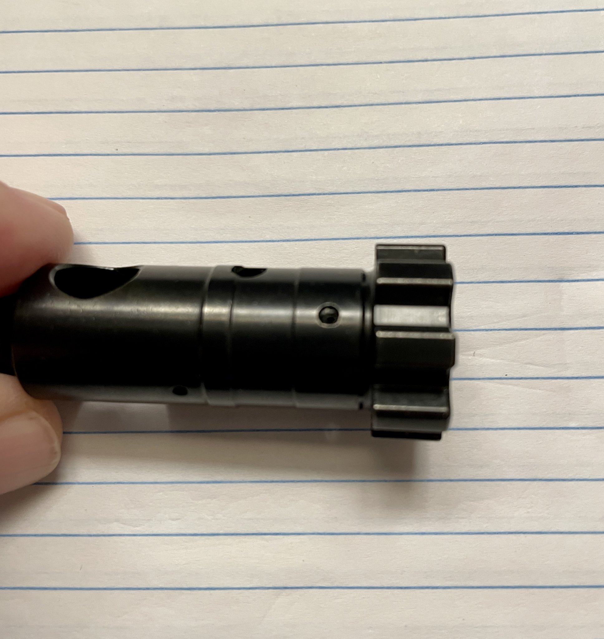

Get a can of compressed air, turn it upside down and spray the ejector. It's like liquid nitrogen. I did this with a piece of brass that was "permanently" stuck in a small base resizer. Worked like a charm.
The concept here would be doing this would make the ejector extremely cold and it should shrink up I assume?
Touche, he's a pic of the bolt. You'll notice the ejector is stuck down..... this is the other problem I'm trying to solve. Removed the roll pin and zero luck getting the ejector to budge. I assume a piece of primer is wedged in there. I've smacked it, tried driving it deeper let it soak in brake fluid, zero luck.
I think you probably broke the ejector retaining pin and probably spring. There’s a little retaining pin on the side of the bolt face. After you drive the pin out (see below), hopefully the ejector can be coaxed out and then you can simply replace the spring and retaining pin (put a little clp on when replacing). I’m guessing your ejector was bone dry but possibly the hot primers overpowered the small parts.
Yeah I pulled the retaining pin and still no luck so I reinstalled the pin. Don't want the ejector flying out if it does break free when I send it in for repair haha

You can pull it out or push it out.
If it was teotwawki, I would put the bolt between two hardwood blocks, put it into my drill press, drill a small hole into the ejector (think scope base screw), thread the hole, run a screw into the threaded hole, and pull it out.
If the world has not ended, I would find a machinist who could do that correctly. This is a bit small so you want someone who has the right skills and tools.
Another possibility - force high-pressure air into the roll-pin cross-hole. Put air into one side and block the other side with wax or something. If this works, that ejector is going to come out of the ejector hole at high velocity - make a plan to catch it or you may never see it again.
