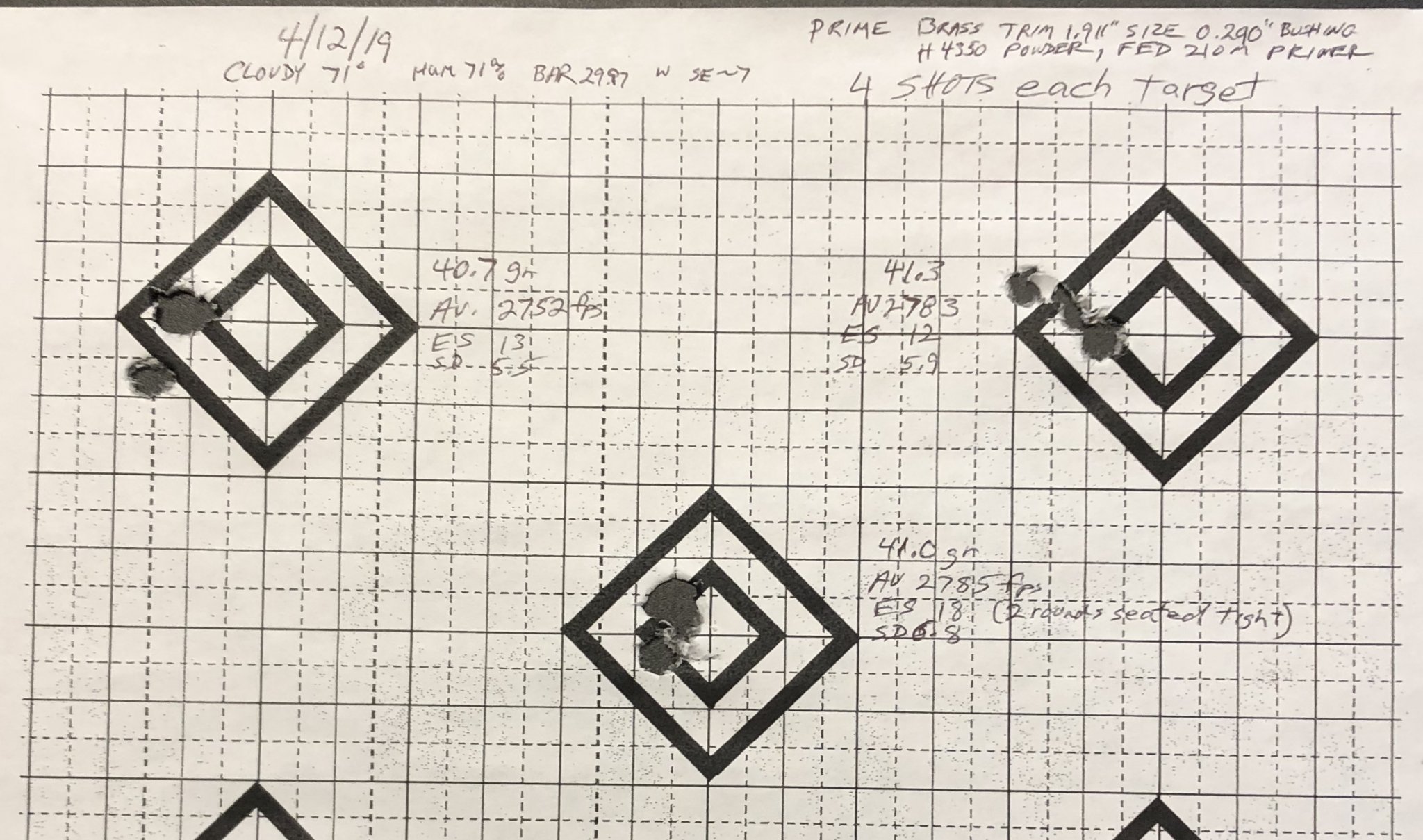

I'm quite intrigued by the discussion of 147ELD stability. Here is a photo of yesterday's 100-yard intro-OCW test with Prime brass (previous shooting, including Frontline, was Hornady brass). On the left-hand target, the low round was the cold-bore shot. Four rounds on each target, fired sequentially low-medium-high charges on left-middle-right diamonds, repeat 4x. Then one round of each charge on 540-yard target. Low and medium charges stacked, high charge maybe 2" higher, 2" left.
So clearly the rifle likes the 147ELD out to 500-600, but, in this Prime-brass sequence, velocities are low-ish (still higher than box-printed velocity).
But, to be honest, I have never been that consistent at 800-100, with other bullets in either this rifle or my old Tikka.
