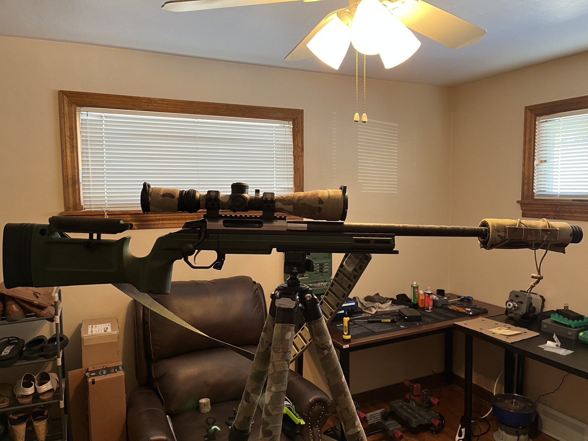

I’ve tried a few different ones and keep coming back to the KRG bravo for my tikkas. I’m also in PA and shoot my 6.5 CM suppressed 100% of the time and from a tripod. I don’t hunt from “deer stands” unless it’s archery season. Good bit of walking unless I just sit in a field waiting for the ground hogs to pop up.
Currently weighs in around 11.5 pounds all loaded up. 18” carbon six sendero barrel. Prior barrel was a 20” PVA light Palma which put it at 12.5 pounds. Not an ultra light but I’m not hiking many miles at altitude with it either.
