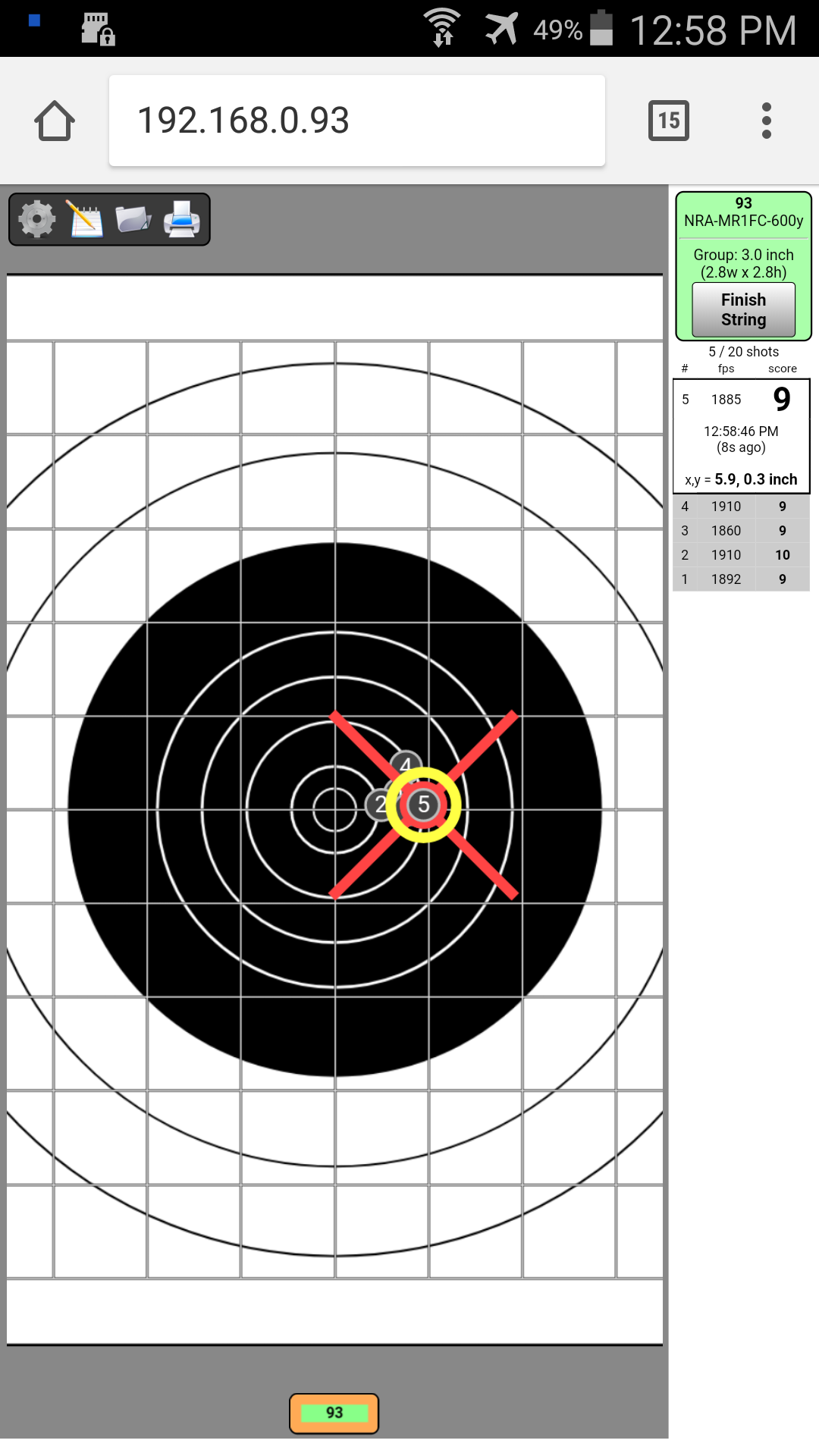

    This was yesterday. 3" @ 600yds
    Reactions: jeffmedlin and Jmo
    It's a target system someone has at a local club over here they use at the 600 yard line to verify dope and velocity. Apparently there was a 5mph wind.
