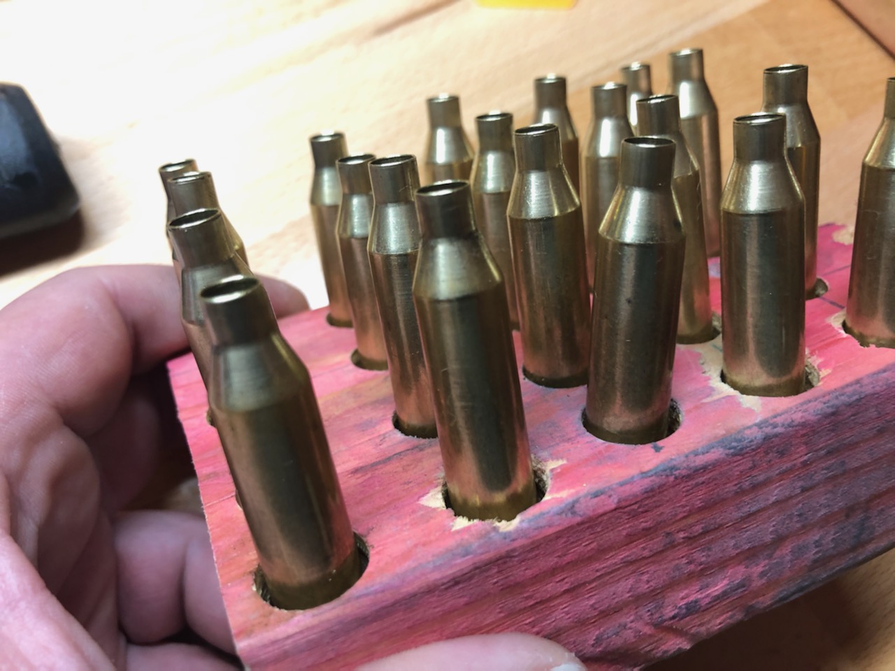

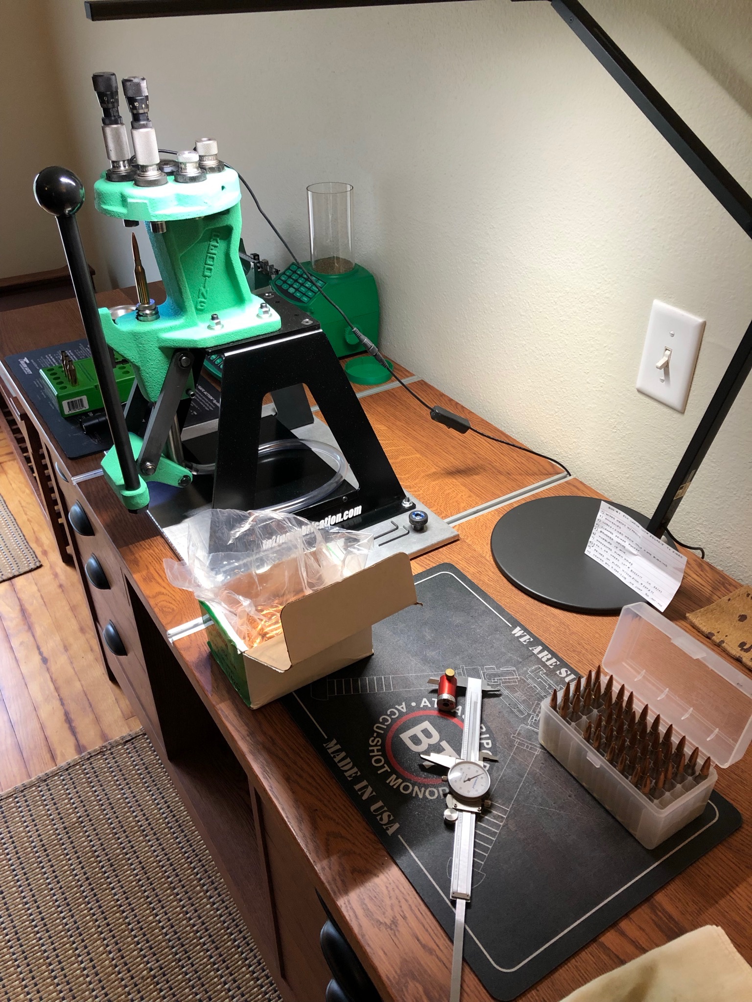

I’ve started my reloading process. All I got done yesterday is;

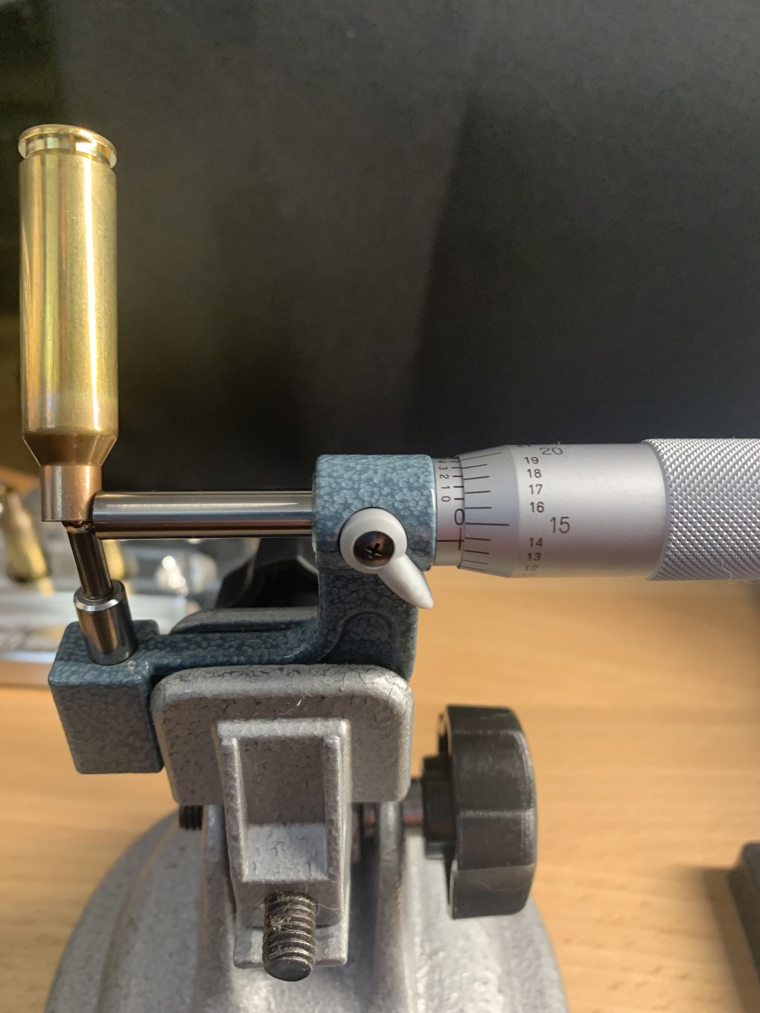

• measured 12 of the cases neck widths and got the mean & medium (0.0136 / 0.013621)View attachment 7689939
• annealed 100 of the virgin Lapua brass LRP (AMP Mark II)

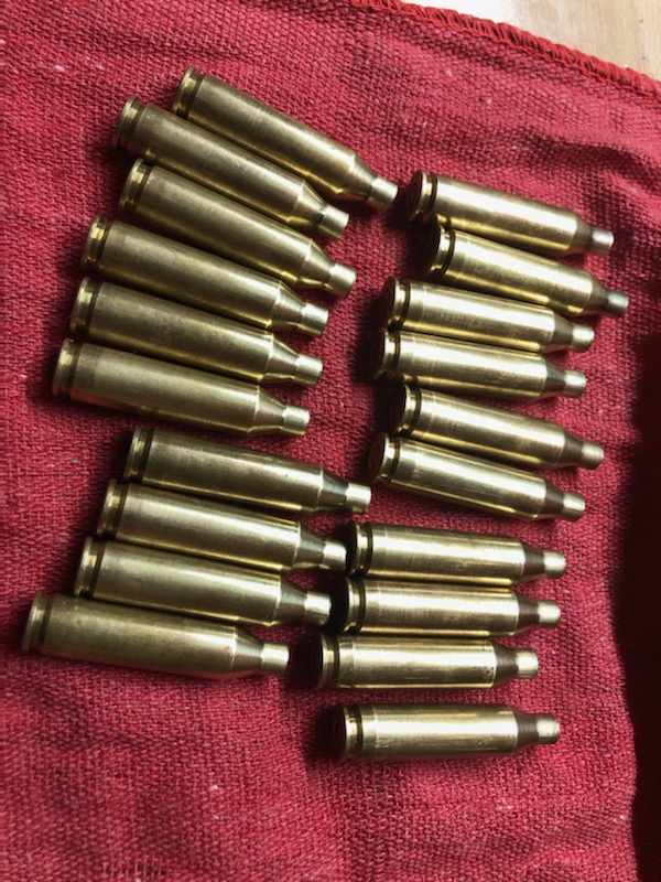

• expanded using .265 mandrel to obtain uniform neck openings View attachment 7689940
• got the SAC sizing die setup with .289 bushing & .2625 mandrel installed
• tested sizing die using 3 Hornady cases that I also put through the same processes
• confirmed setup on the Henderson Precision trimmer to 1.910”, trimming the Hornady cases
Tonight the goal is to size and trim all 100 of this 1st batch and anneal the next set of 100.
How you liking the Zero press?

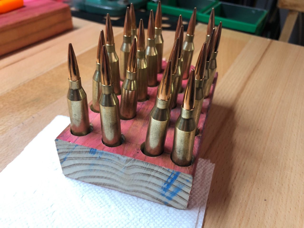

Went to the range to find what it takes to hit 2700 FPS in a BR with 112 MatchBurners... Only to have my 9 volt die in my MagnetoSpeed after 3 shots. Luckily my starting charge was maybe .1 - .2 under where I need to be.
Pulled all my unshot ammo apart and built up a seating depth test with my guessing charge to see if I can improve upon the group size.
What powder? I'm using 33.7 gr. of H4350 behind them and getting around 2850 in a 6mm Dasher. That load is more than 2 gr. under max. I'm thinking if you looked at H4350 or possibly RE-17 you could get it. Fiddle with seating. I've been on and off the lands and they are holding around 2/3's MOA @ 300 and 400. Which is alright for F-Class. Not so much straight bench.

26” Barrel
Peterson Brass/CCI BR
SW Precision
112 MatchBurner
29.9 - 2686 with good ES/SD
30.0 - 2693 with good ES/SD
I’ve got them at 0.035” off the lands and they are staying in the .2 - .4 MOA range for me.
My only gripe is that, as long as they are it’s difficulty to get them to seat straight for me for some reason. My run-out is above where I’m use to with Berger 105’s but the gun doesn’t seem to give a shit.

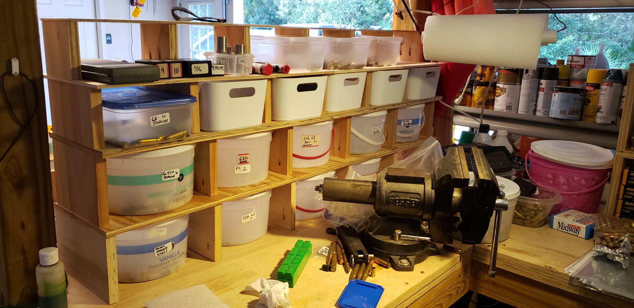

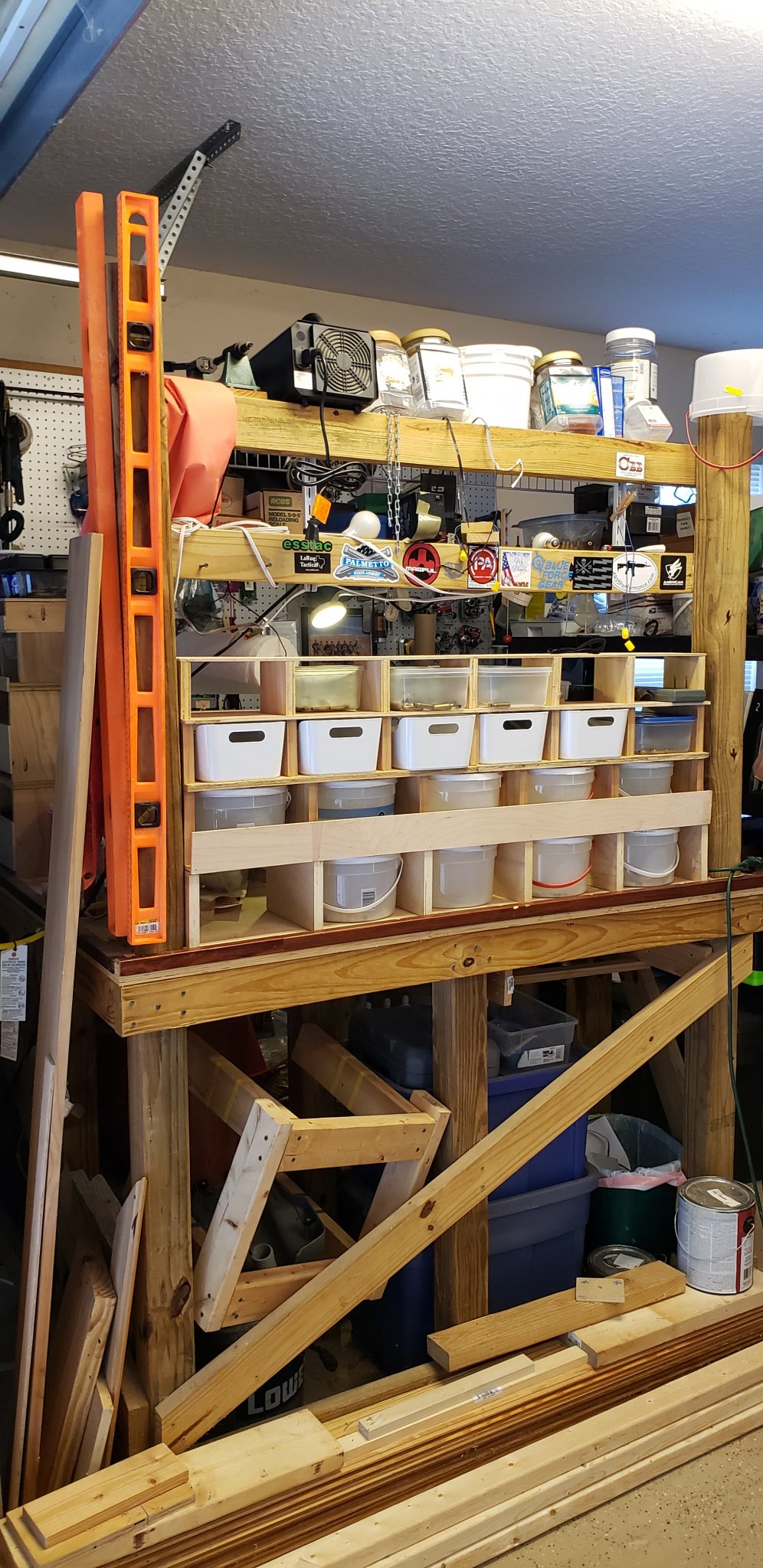

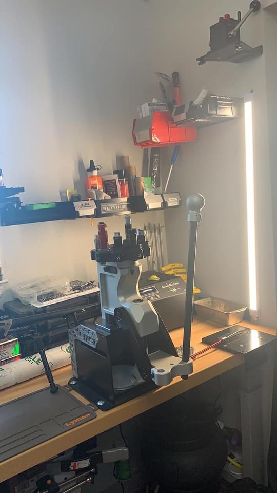

Continuing my rampage against the scraps from other projects I added some shelves to my second bench for brass storage.
Limited space on one side of the garage. Next step will be improving under-bench storage with shelves to get the last things out of the blue tubs.
My reloading area is kind of like the Atlanta VA hospital - added onto as time and money permits heheh.
Knocked the dust off of my K&M expander mandrel for setting neck tension, only to be reminded of why it was collecting dust.
Trying to troubleshoot where/why this mandrel wants to introduce a lot of added run-out into my case necks just makes me see more dollar signs. 🙄

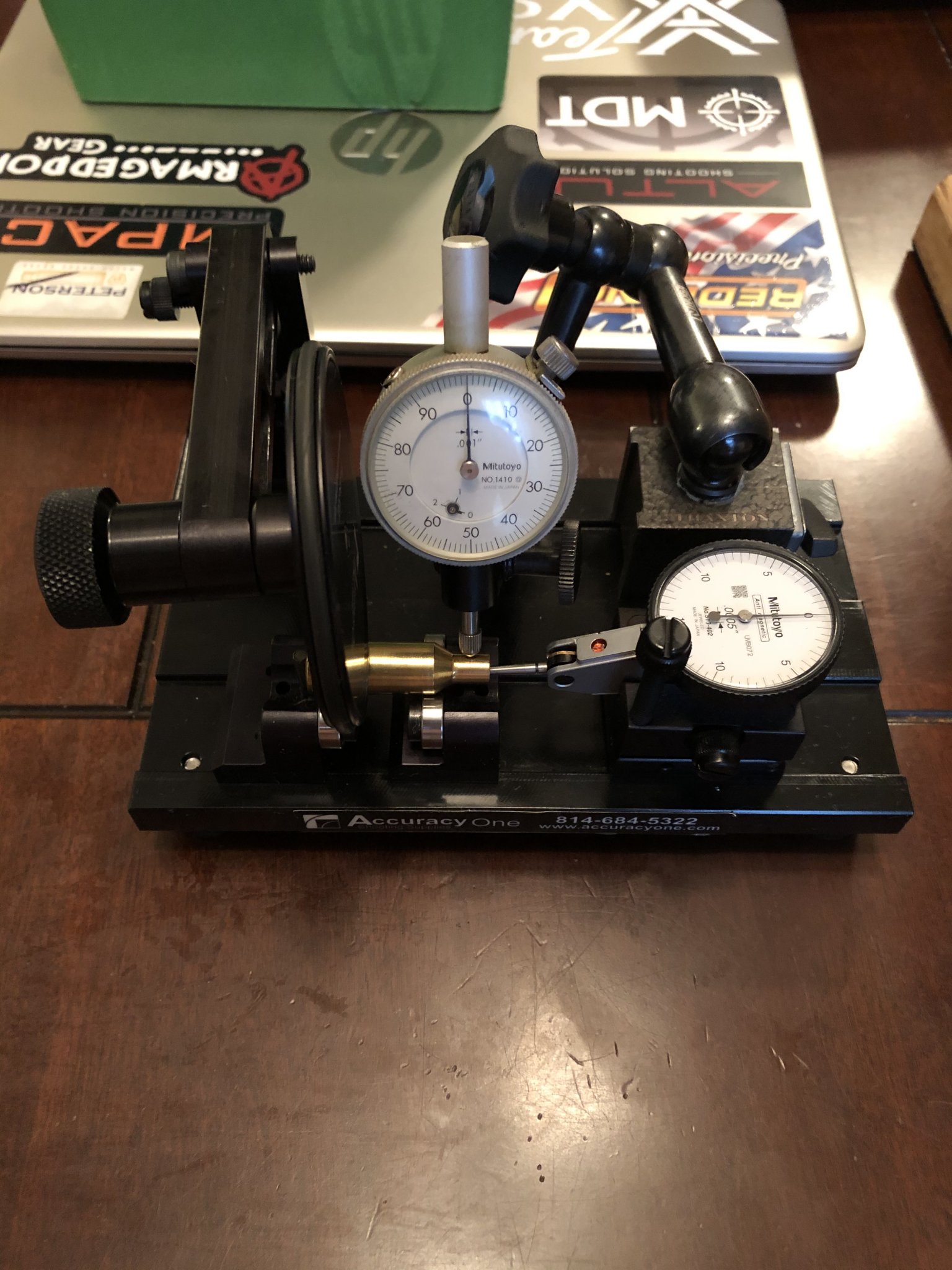

If you stop measuring runout, you won’t have that problem. Most would say neck tension is far more important.
I'd agree with you on that, and it shoots well as it is currently. Part of me is trying to asses my methods of using a mandrel and validate a proper method of employing it, as it isn't regularly used in my brass prep process and I'd like to incorporate it... as correctly as I can.
I have been running the mandrell after trim and champher.
I dip the neck in grafite then run mandrell leaving the remaining grafite in the neck for seating.
Not sure if this is best practice. Loads definitely improved with mandrell use.

Could you list your process? Thinking about getting a mandrel, but don't know if its worth the gains.
Does your low runout ammo shoot tighter groups?
Preface: I use a RCBS Reloader Special made in 1980 that has more wiggle room than a WW2 1911, so your mileage may vary...
To keep run-out down while using the mandrel (yes, I isolated the run out to being caused by the mandrel), I had to remove the spring clip on my shell holder, clean the face of my tan and my shell holder, and be VERY meticulous abound how the case mouth approaches the mandrel (spin the case under the weight of the handle, and give the shell holder a spin).
Ive only had a chance to shoot the reloads that used a mandrel with runout I’m happy with to 600, and no, groups were not substantially better. My ES/SD was down about 20% though.
Instructions on the mandrell say to let it float so the other things would not make a difference.
Too many top shelf shooters using mandrells to count.
There has to be something else causing problems as in a worn out press? Possibly you could shim some of the play out.
The mandrell pins will center themselves inside the case.

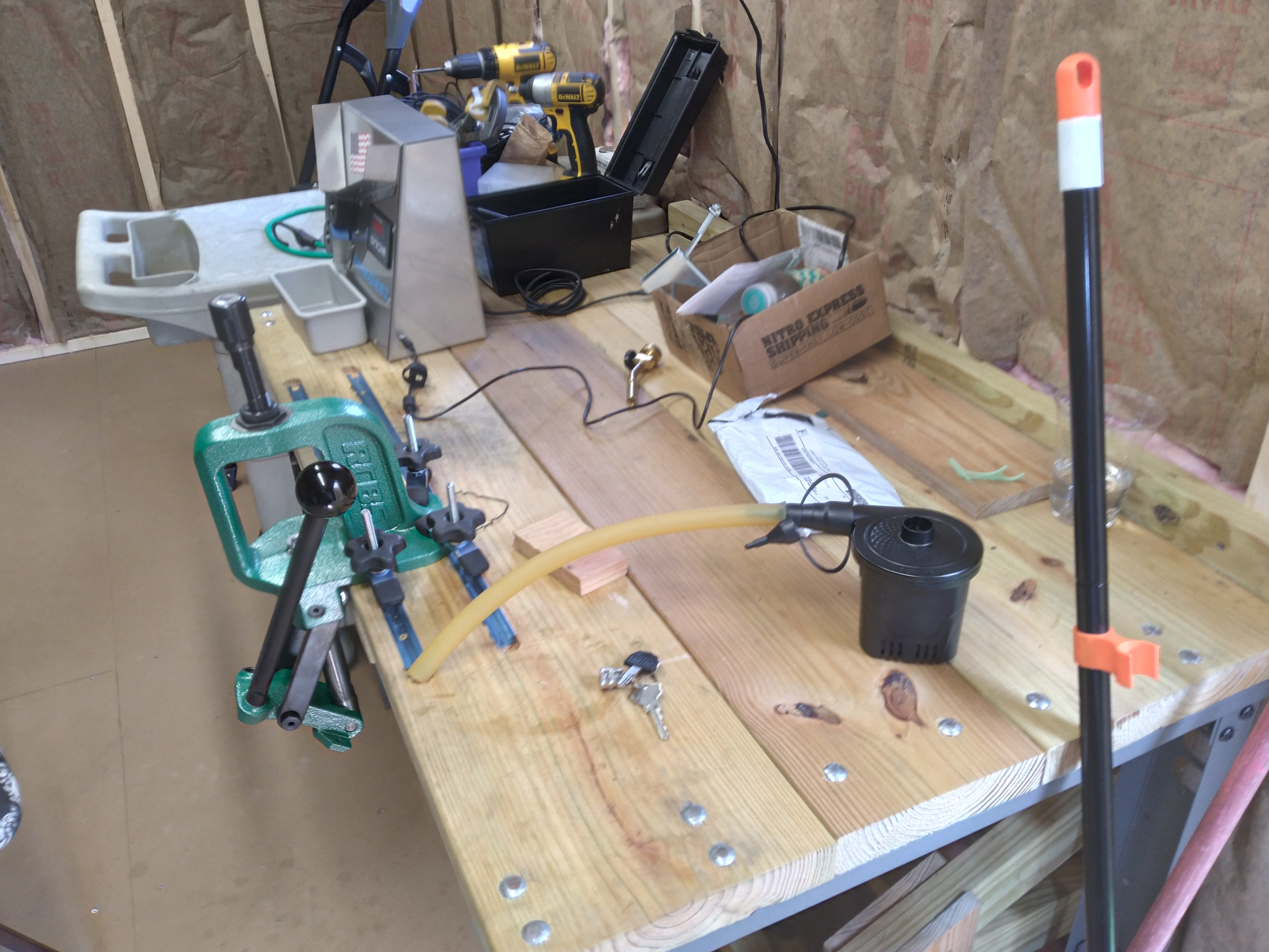

set up another 200 pieces of brass primed waiting for powder to be chosen for Sundays shooting :giggle: also my air mattress pump arrived lol and it moves a lot more air than my chamber chiller and is 1/2 the price , noisy little bugger but I don't care about noise need to try it with the hose and make sure it fits in the chamber . sort of neat little toy for cooling the chamber while at the range it's powdered by its own rechargeable battery .

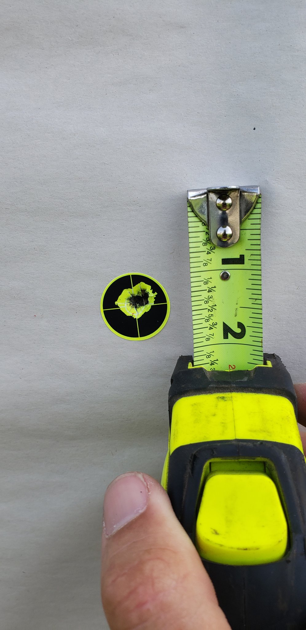

Loaded a 7SAW seating depth test, headed to the range and shot it. Chrono numbers look decent, but I’m not real happy with the accuracy results so I’m gonna try again with a lower charge weight. I’m near top end of pressure, so I’m hoping dropping velocity a little will settle down the accuracy.
Are you letting the mandrel float or did you add a lock ring?
The mandrel holder is 1/4 turn past co tact with an o-ring under the lock nut. The mandrel is tight in the body.
Im fairly certain it is my old as dirt press giving me problems. RCBS is sending me a free set of new pins for it, but floating the shell holder and rotating stuff seemed to help.

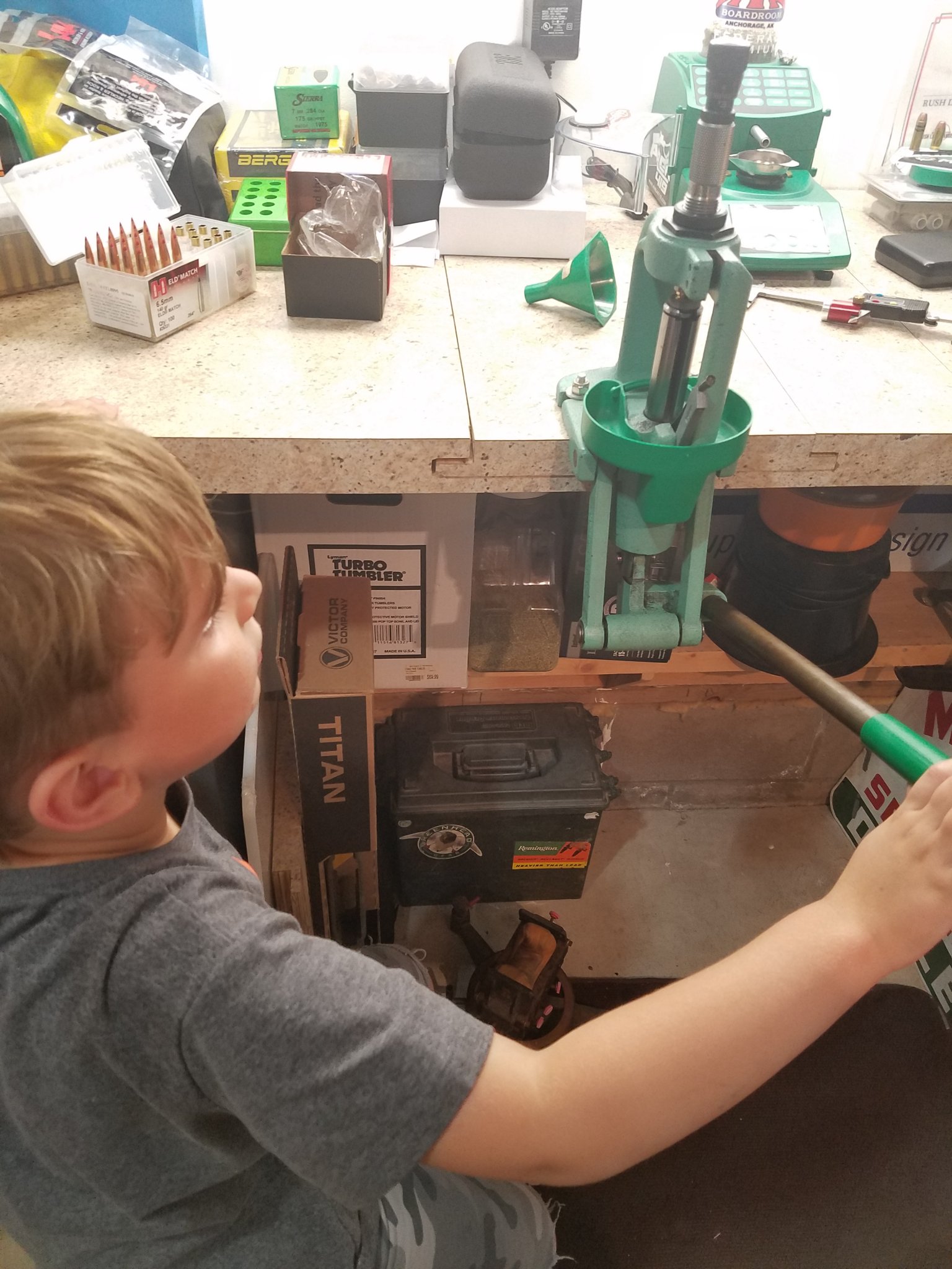

I shot another 10 FL sized and 10 FL then mandrel this evening with the kids, round robin style. ES/SD decently lower with the mandrel. Accuracy was at about the same for both groups of 10.
My K&M mandrel did not come with any type of lock ring. It's designed to self center
Mine definitely did, though I bought the kit probably 12 years ago for neck turning.

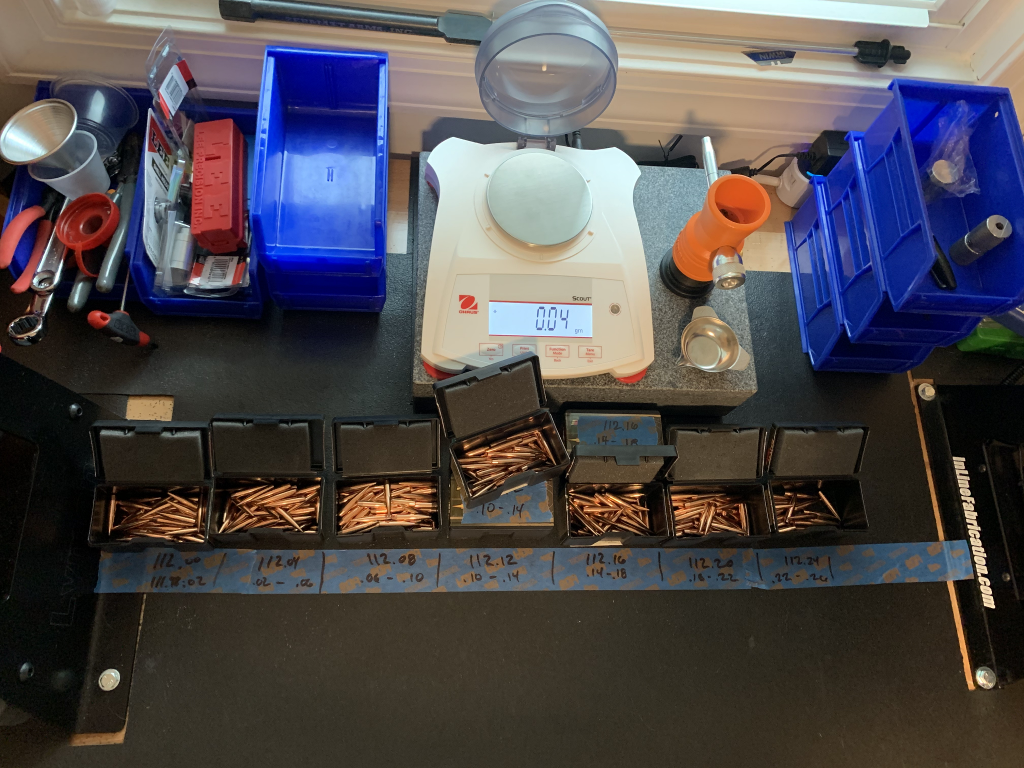

First time sorting bullets for me... just wanted to see if I'll actually notice any improvement downrange. .243/6mm 112gr Barnes Match Burners
... not sure if what I'm seeing is good or bad because I've never really weighed bullets before, but so far I've opened a lot of boxes and I still don't have 300 of the exact same weight and I'm pretty burnt out on doing it already.
I almost hope that I don't see any obvious improvement on-target, because I'd rather never do this again. This sucks. 😜
(I know the scale isn't showing zero, I had just turned on the ceiling fan.)
