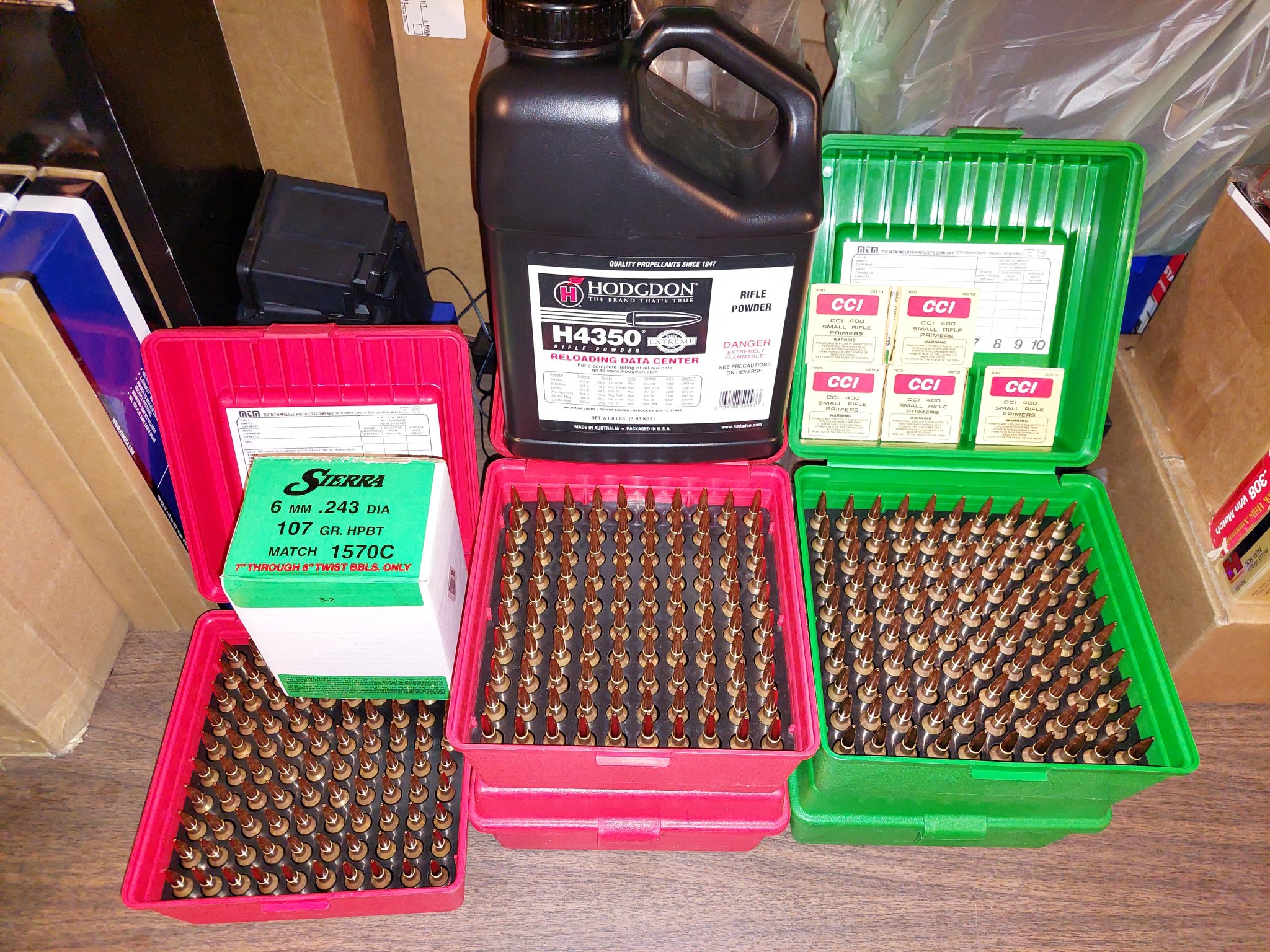

Interested in your 223 / 69 / tack load, could you expand on that a little.
That is my next load to do development on.

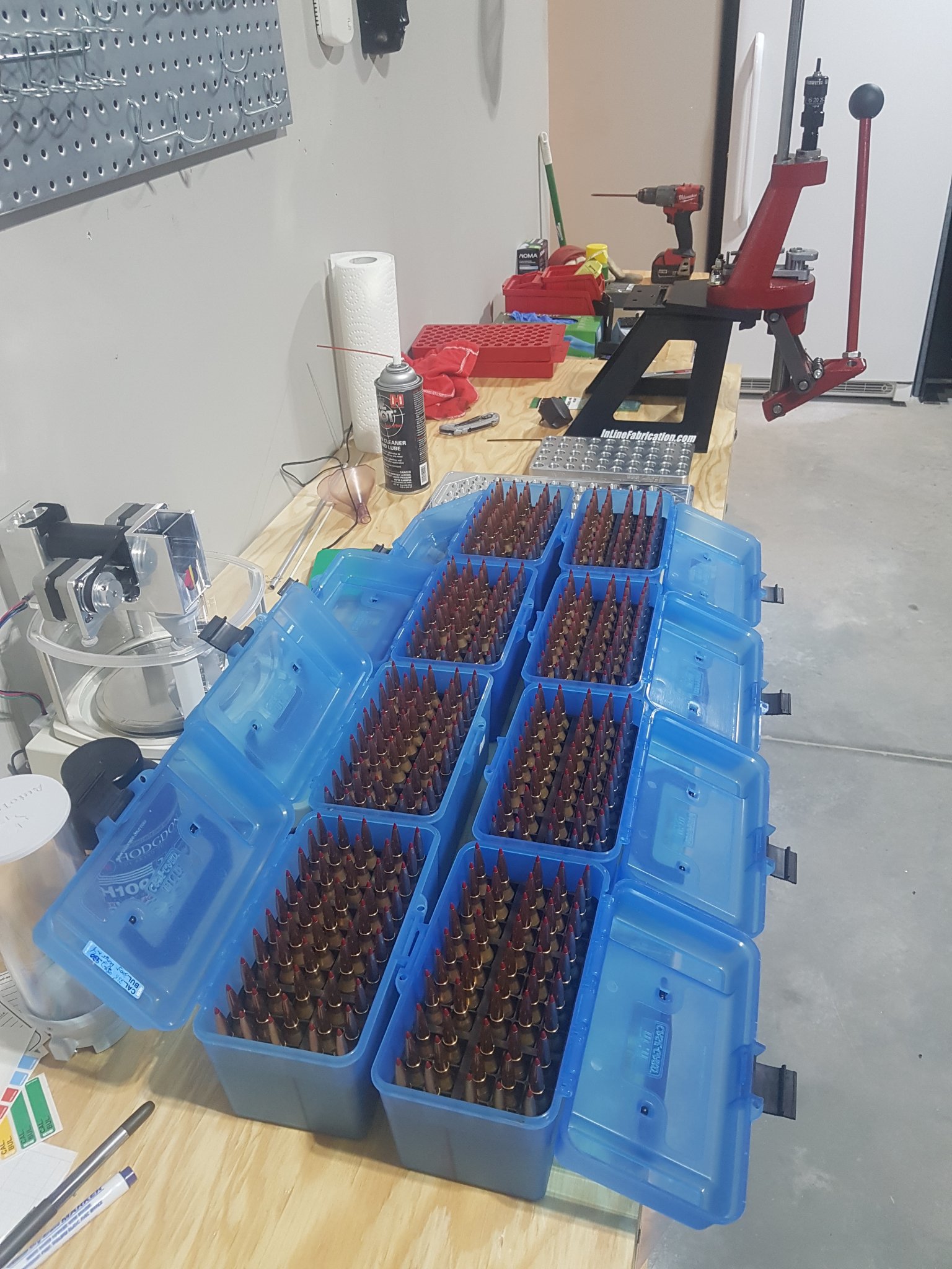

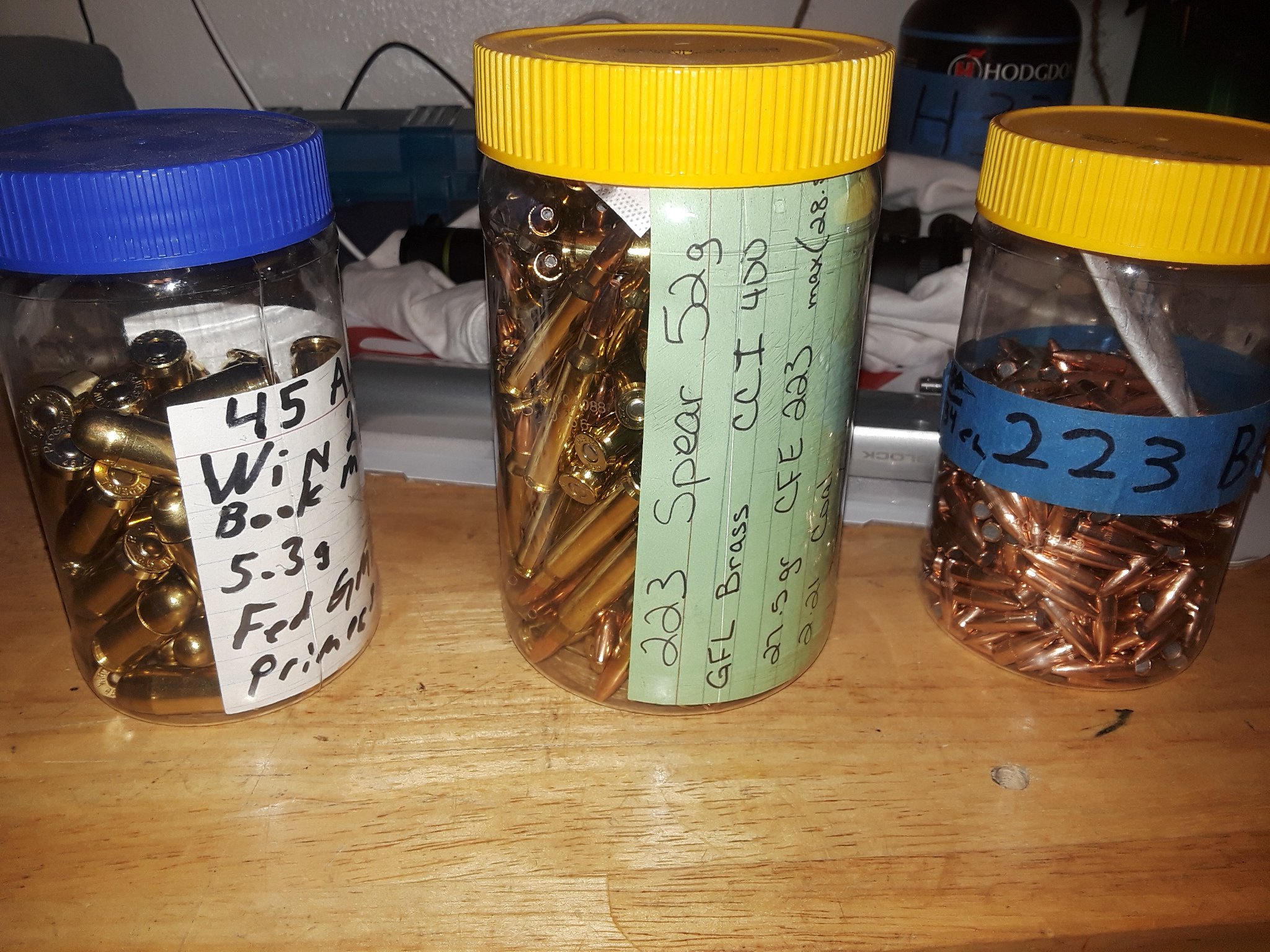

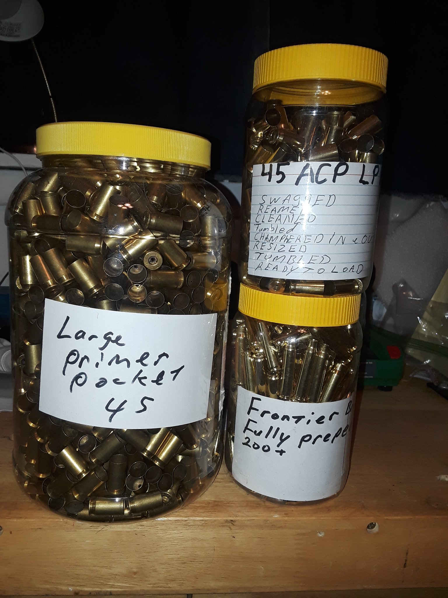

100 round boxes ? Why ?View attachment 7923960
Everything except ladder tests / development goes into these for working stock and range grabers.
The big penut butter size stores 120 223 and fits the side pocket on a ruck. View attachment 7923961
Free and a reasonable give away size. Controls people wanting to dive into big ammo cans for a range orgy.
I get the boxes for $2 ea and they're designed for purpose, so why not?!

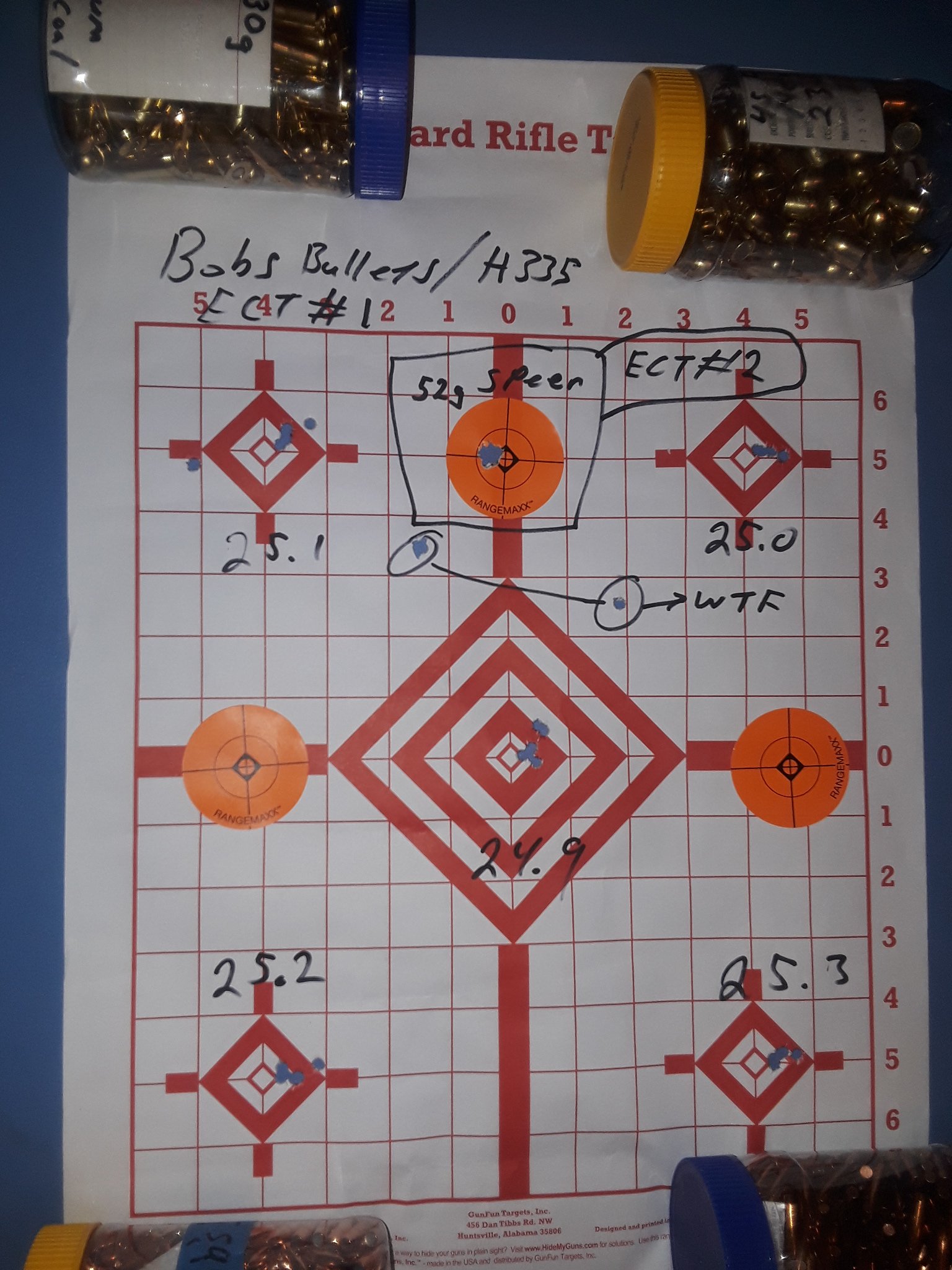

That will make enough to bother setting up the dillon for the bobs/ H335.

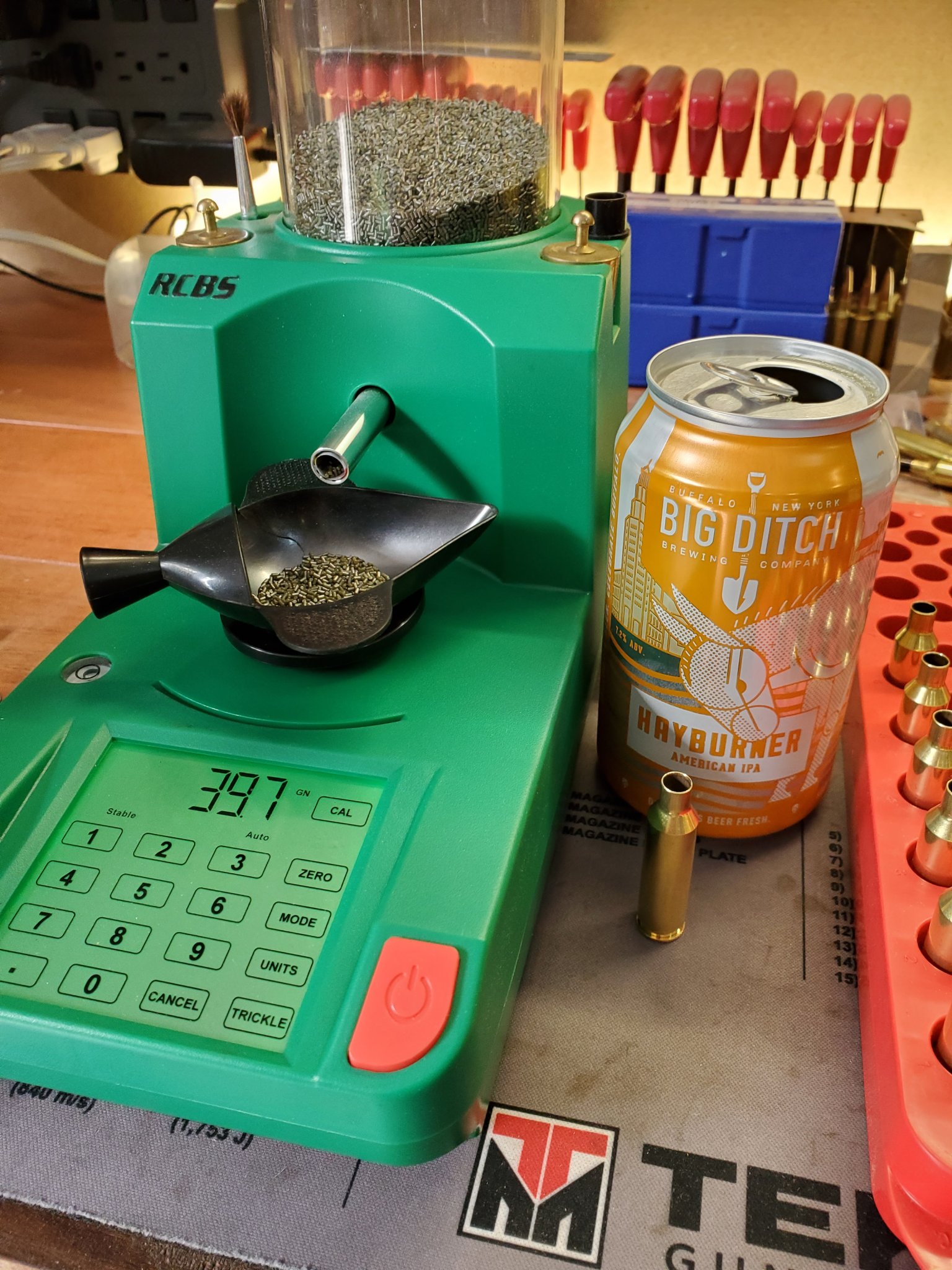

My problem is 25.2g or 25.3g ?
Interesting string at 25.0g.
The 52g speer is gtg.
Note: This sheet was shot at 50 yards.

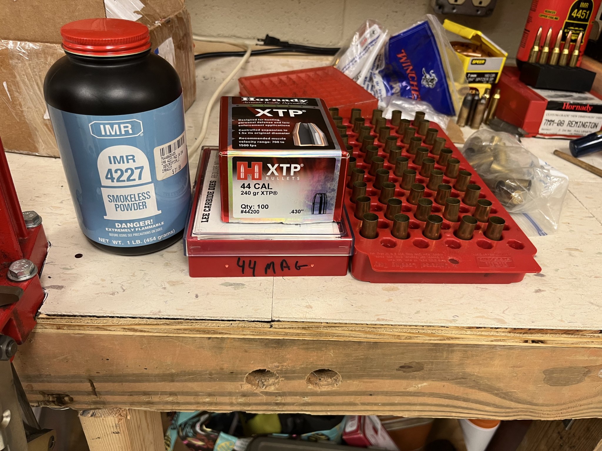

Made up some dummy rounds of 44 mag going to see if the 255gr SWC gas checked cast bullets will feed through my 1892 clone.
According to Lyman these should be seated coal 1.68” but max saami is 1.61 so I’m curious to see if they they will cycle.
If not, 44 spec cases it is

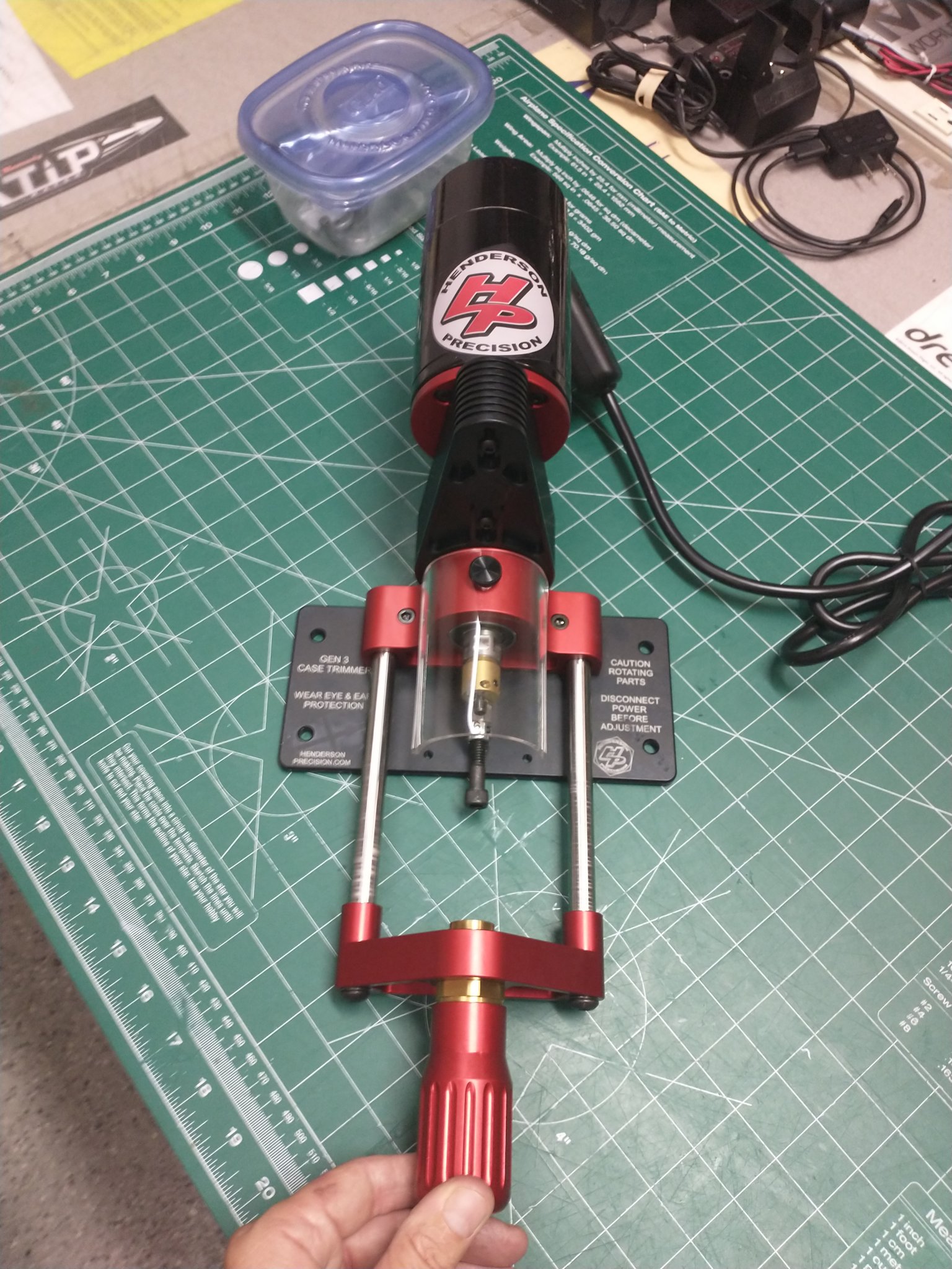

I finally got tired of hand trimming cases after a couple of years and decided to go all in on the Henderson Precision Case trimmer. What use to take me an hour and a half is down to fifteen minutes, I couldn't be happier. All fifty cases were within 0.001" of each other and the chamfer and debur is top notch. The unit arrived three weeks after placing my order, still waiting for the catch bin and #3 collet to arrive.
Ya, the Henderson is the best thing going these days. All the Giraud guys are holding on. Even tho their sore fingers are slipping

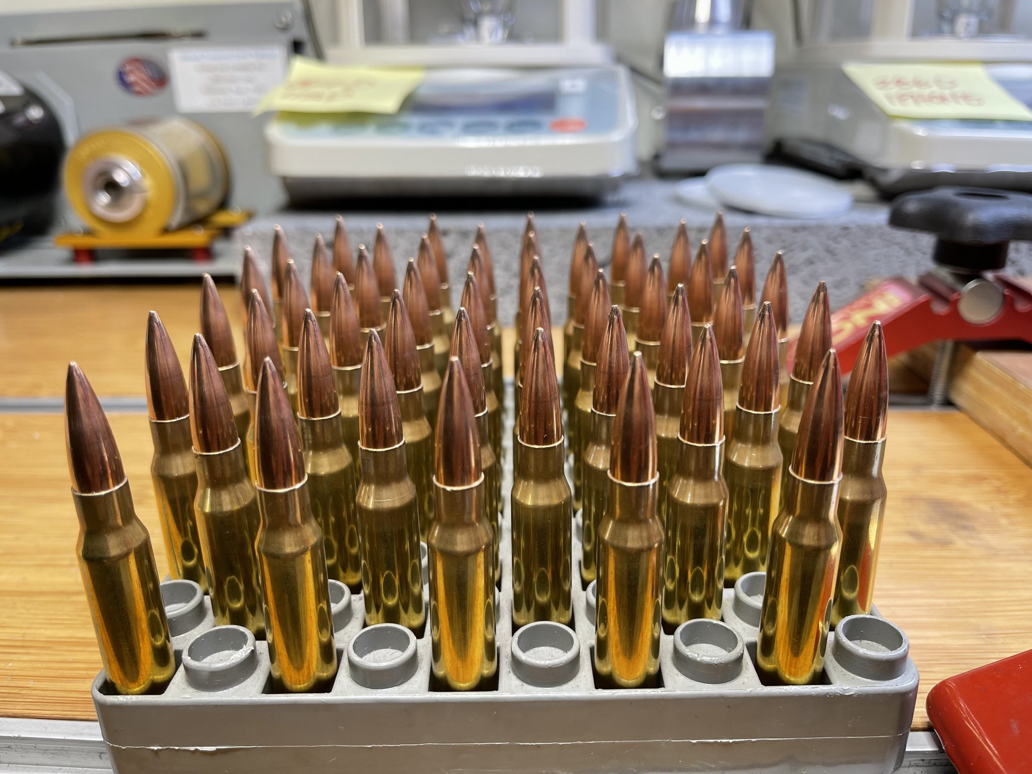

Just 50 308 Win from the last of the 150 pre-primed Winchester brass I had put away since moving on to Lapua brass a while back.
I use a lighter projectile for the critters we cull here at night:
*125 grn Sierra SPFB over 39.4 grns AR2207 (H 4198). Rem 9 1/2 primer, 40 Lb neck tension, BTO of 2.192 (0.005 off the lands) COAL of 2.689" .
Velocities Avg 3026 with around 18 SD which, is great for Win brass.
Ten rounds into 0.8 MOA more often than not.

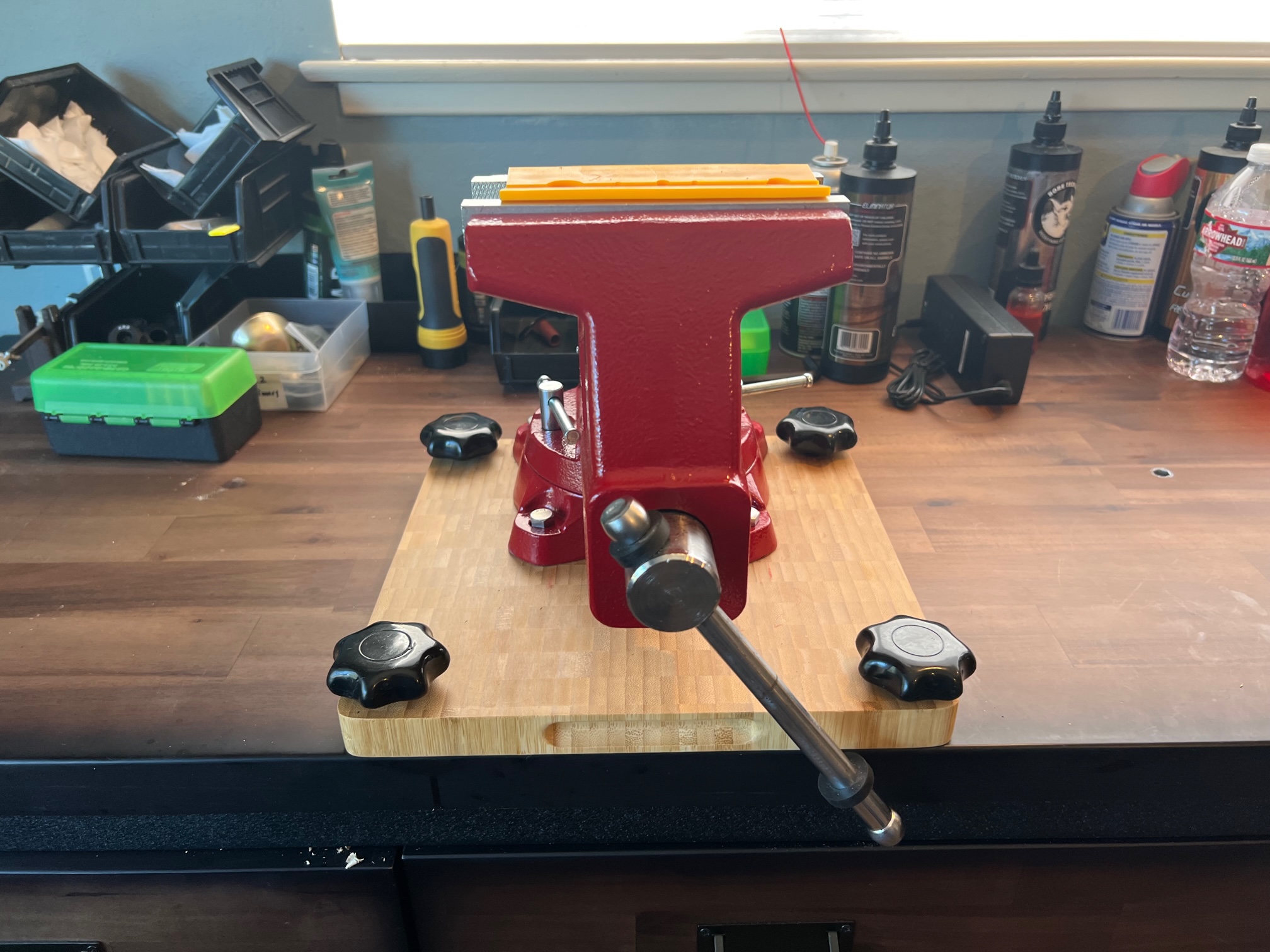

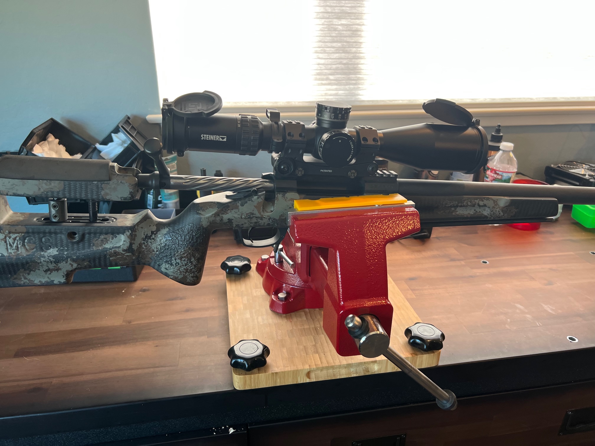

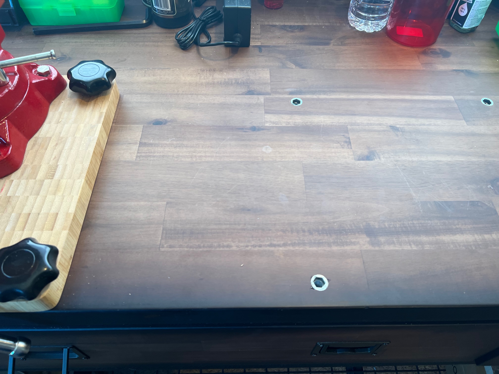

Getting ready to move everything reloading related from my shed/man cave into a bedroom formerly occupied by one of the offspring...
This should just about triple the space dedicated to reloading. It should also free up a bunch of space in the shed for my other hobby... leatherwork.
My bench is cobbled together from scrap lumber. But my wife surprised me a while back with a butcher block top. I rigged it up on hinges so I could raise it up to reveal a storage area underneath.
Worked better on paper than in practice though. I don't recommend it... You gotta move all your crap off the bench top to open it. I knew that going in. But I didn't figure it would be as big a problem as it turned out to be...
The butcher block was heavy enough; bolt a press to the edge and you can kiss your fingers goodbye if it ever fell. I believe I will change it to an "open front" design... Like a lap drawer but just a cubby to keep certain items handy.
Lot of moving and work to be done. Any advice on shelves/organization or must have items?

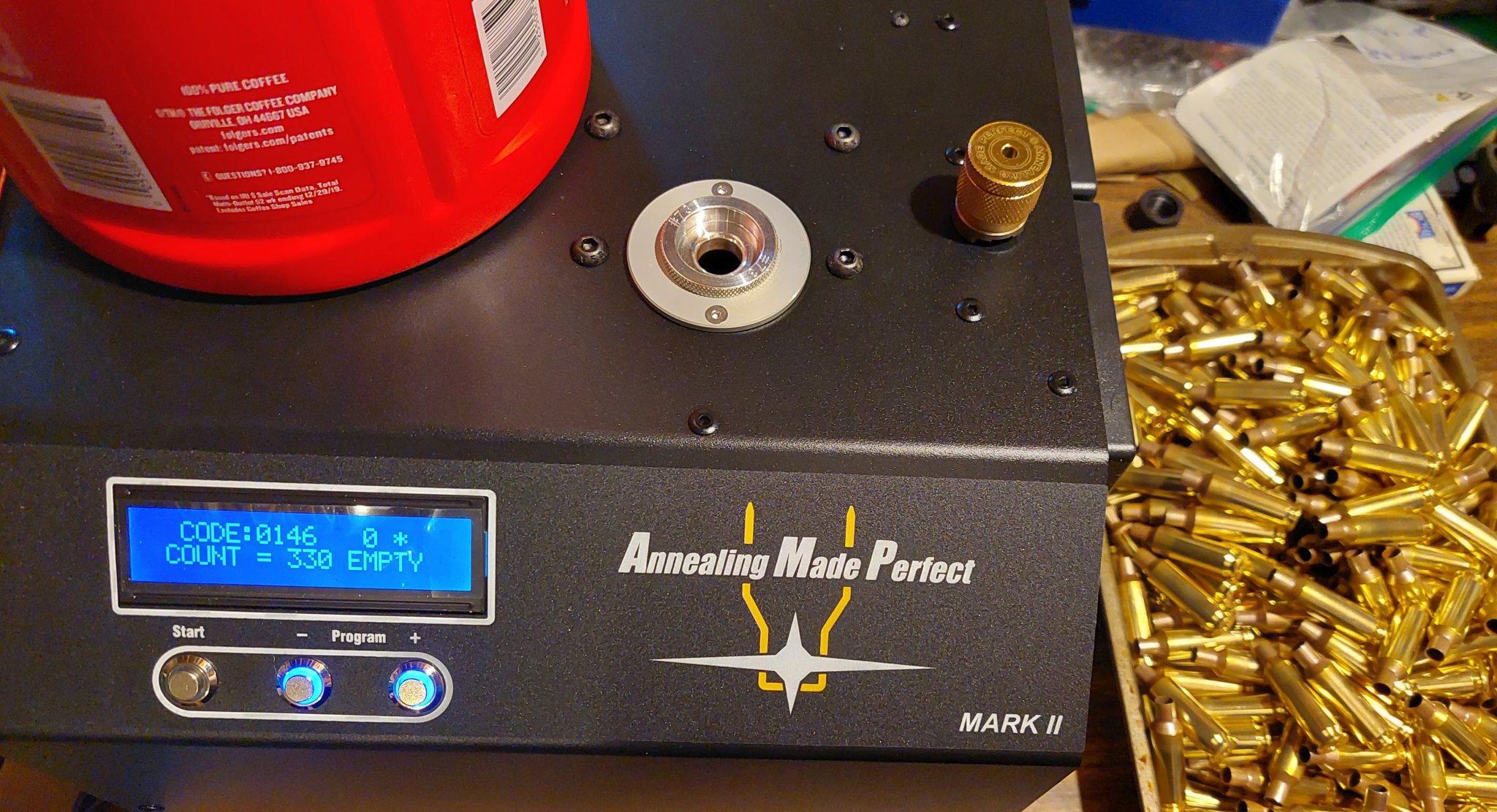

Updated my AMP to latest firmware version, giving me auto start. No more pushing button to anneal. Certainly quicker and beats hitting that thing thousands of times. Always thought that button would be the first to go with all the depressing.
