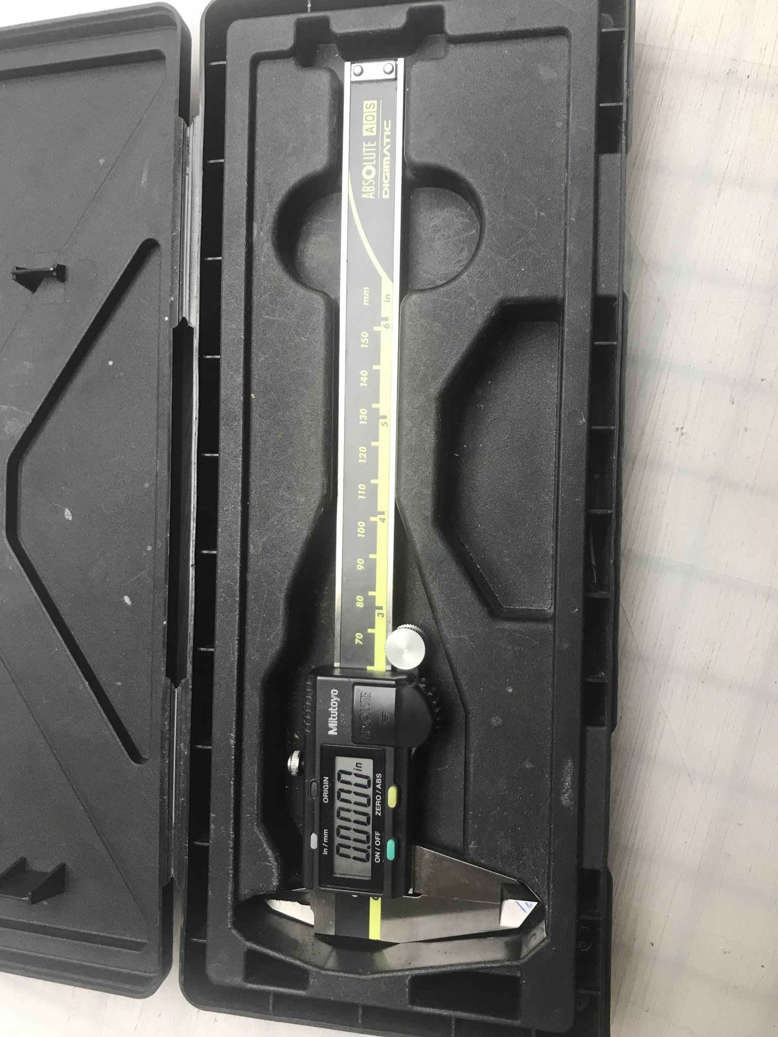

Honestly... for calipers, home depot, husky calipers, lifetime warranty. Going to .000x is plenty accurate for reloading and they are pretty inexpensive. Havent had a problem with mine yet.
I like the summit a lot, but if I was going to go to a single stage in that price range, it would be up to a coax I think, either the frankford or the forester
Reactions: CarbonMTN
Are all digital/analog the same? like a lyman vs RCBS vs Hornady vs Starrett?
No, they are not. The cheap hornady/chicom/lyman/harbor freight are all really the same thing. The starrett should be better quality. That said all should suffice for reloading purposes. The igauging absolute origins are the best value though.
No, they are not. The cheap hornady/chicom/lyman/harbor freight are all really the same thing. The starrett should be better quality. That said all should suffice for reloading purposes. The absolute origins are the best value though.
You never get the cheap caliper issues with these.
I'll have to go to homedepot now. I just wish they made it in a dial too!!!!! but the summit for the price($200) I posted cant be beat. the Co-ax is $330 (best price I could find, *when* in stock) thats $130 more than the summit.
I know, i know, buy once cry once but I dont want to sink a bunch a money into something I'm just starting.
I agree, I love my mitutoyo, you can instantly tell the difference in quality just holding them in your hands compared to the cheap neiko/hornady/harbor freights.
The iguaging absolute origin dont feel as solid but they still feel more solid than the cheap shitty ones and I havent ever had any issues getting easy consistent readings like the fluctuations I got with my hornadys.
@CarbonMTN skip the home depot calipers, they are functional but the igauging are worth the additional 15 bucks up front every day of the week.
Dial calipers are fine but I like digitals so I can zero them on the comparators for cleaner numbers without having to subtract the comparators dimensions.
I use my dials do outside diameter dimensions only. The digital is just handier for everything across the board.
And the battery fits correctly as does it’s cover.
Batteries last longer.
The screws stay tight and don’t disappear on you.
When you zero it stays zeroed.
It doesn’t get tight on all of the sudden.
All things I’ve dealt with using cheaper calipers.
I understand how to read Dial calipers really well and I also understand that digital is fast and easy. but I have a LOVE for LABOR. Thats why I want a beam scale. No batteries, just take it out and its works. I'm not in a hurry to load and go. I like to know that LOVE went into every round.
So who makes the best Dial calipers, are either of these two good?
$29.39
$48.99
Yea I wouldn't worry about messing with the dial calipers. Digitals are waaaaay easier to zero and measure with. Like when using different comparator tools and stuff.
Yea husky ones are pretty cheap, but Mitutoyo and starrets are fucking expensive. When I was working as a machinist, that kind of precision and accuracy was required. But throwing together some 308 bullets doesn't require calipers that cost as much as some pistols, imho. Igauging is alright, they have some cool features. The reason I got a husky caliper was, i broke my last one from harbor freight and needed something that day... home depot is 5 minutes away, so oh well.
$29.39
$48.99
Youll begin to resent the labor side of it and hopefully you dont burn yourself out on reloading before you get into an automated powder scale.
When I started brass prep (trim/chamfer/deburr) took 40% of the total time, powder weighing took 40% of the time leaving 20% for sizing and seating only. A charge master removed that 40% time cost penalty and a motorized trimmer with a three way cutter took care of the other 40%. What use to take me from sunday until thursdays to compelte for the next weekend I can now pretty much complete on Sunday, Monday if I fart around with it.
Just realize that to compare your shoulder measurements to anything you find published youre going to have to subtract your comparator dimensions each time. For a before/after with your gear its fine. Its beyond that where the dials make communicating anything difficult.
And neither linked are not really great... I got a pair of cabelas dials that are the same thing as those more expensive rcbs dials you listed and they only cost me 25 bucks in store. They still sit on my counter. But at some point, I dont know exactly since I dont use the frequently, the dial itself shifted. Still seems to measure fine when compared to the mitutoyos... but one day the indicated zero location went from being at 12 oclock on the face to 9 oclock. Spinning the backing paper got it back to reading fine. "These are stupid fucking problems to have... but a problem none the less."
If you are dead set on dials for some reason and really do want the best then the brown and sharpe, starrett, mitytoyos will still be the best just like they are in the digitals. These three are lifetime purchases in most cases. The cheap rcbs/hornady/neiko/harbor freights are a short term investment.
And if I had the benefit of hindsight when I was first starting I would have skipped it entirely and gone to the iguaging ha dit been avaliable. And I would have probably still grabbed my mitotoyos when I found them on sale for 80 bucks just out of curiosity.
If it seems like Im harping on this fact a lot that the cheap ones suck its because I am... because the cheap ones suck. It only takes using them next to a better quality caliper to make clear the differences instantly. Take advantage of our collective experience so that you can enjoy the hobby more than fight it.

Another vote for Mitutoyo calipers. I got mine for $125 off Amazon...worth every cent. My cheap Frankford Arsenal caliper never held zero perfectly and it drove me insane.
