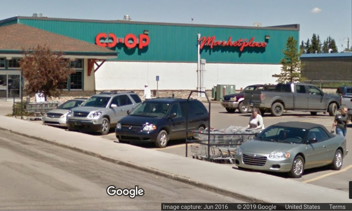

Snow which is always present in Calgary and North of Calgary
The structure in the distance is a tall TOWER and dish antennas have very narrow beamwidths so that isn't the cause.
I have to admit that I don't know what I don't see
Reactions: QuickNDirty
The wireless key fob carrier frequencies, currently 315MHz in the US/Japan and 433.92MHz in Europe.
That's a pretty low frequency in the grand scheme of modern data communications. Way below CDMA, GSM or LTE.
Most likely a noisy transformer somewhere most likely. You get all sorts of crazy frequencies out of those.
You know what, this piqued my interest enough to hop on google maps. The photo in the article is from 2016 and was ripped from a street view car.
What I don't see is anything from 2019.

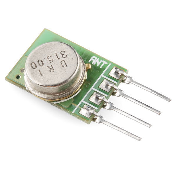

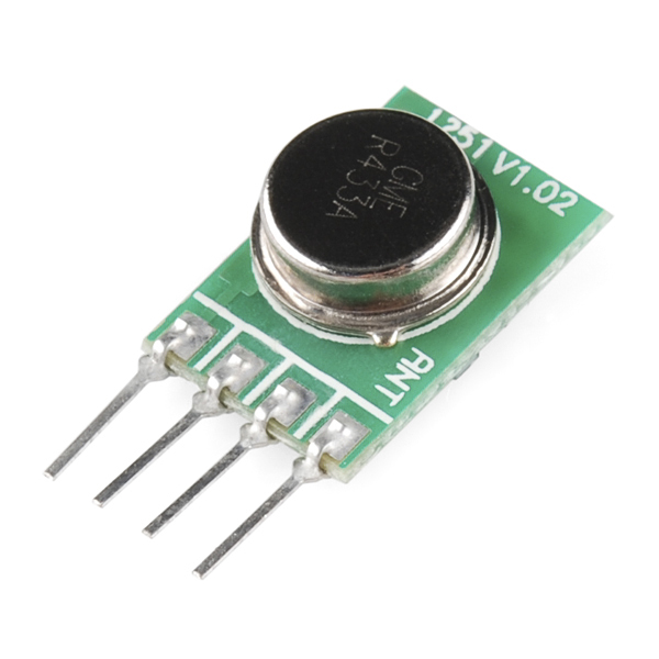

The frequency used by some car manufacturers can be close to amateur or civil repeaters, and Beofang uhf radios, cheap 433 mhz transmitters used for radio control.
Do Japanese cars use 433mhz keyfobs in Canada?
If not they use the 315mhz band.
Here's a list of some U.S FCC aproved 315mhz devices.
https://fccid.io/frequency-explorer.php?lower=285&upper=315
If you wanted to disrupt a lot of keyfobs (totally illegal) for fun then $5 low power transmitter modules for 315mhz or 434 mhz might do the trick.
