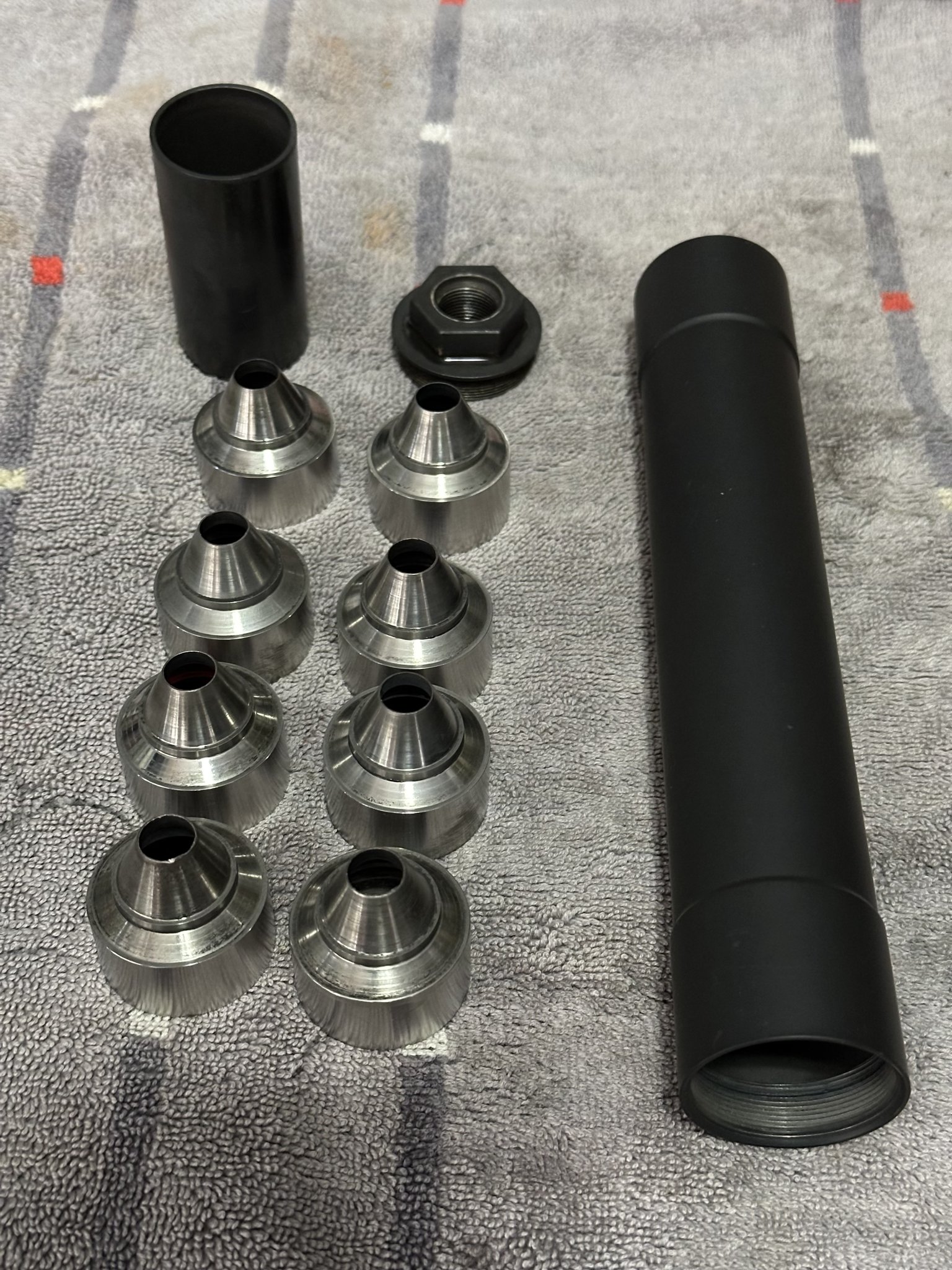

What does a dirty silencer look like? I mean a silencer that really needs cleaning?
I have two silencers, and I have only used one so far: a Banish 22. I have probably run 200 Mini-mags through it. Someone somewhere told me it should be cleaned at around this point.
I opened it up, and I would guess there is around a tenth of a gram of crud in it. I looked at some sites describing the problems with dirty silencers, and they said one issue was the weight of the crud. Since there is nearly no crud in my silencer, my best guess is that I am nowhere near the point where it actually needs cleaning, so the real must-clean round figure is probably more like 20000 than 200.
But I don't really know.
I know this: CLR really does work without scrubbing. It knocked the carbon off my baffles with no effort. I got a jug, and I'm going to use it for silencers and nothing else. I'll soak the parts in it and pour it back in the jug, I'll reuse it until it quits working. I tried ammonia, citric acid, and Oxy-clean, and they did nothing. I haven't tried powdered brewery wash, which removes nearly anything, but it's expensive.

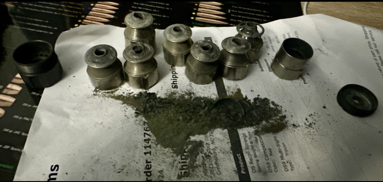

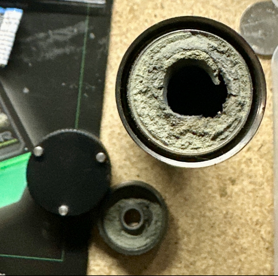

Dead Air Mask after a few rounds…

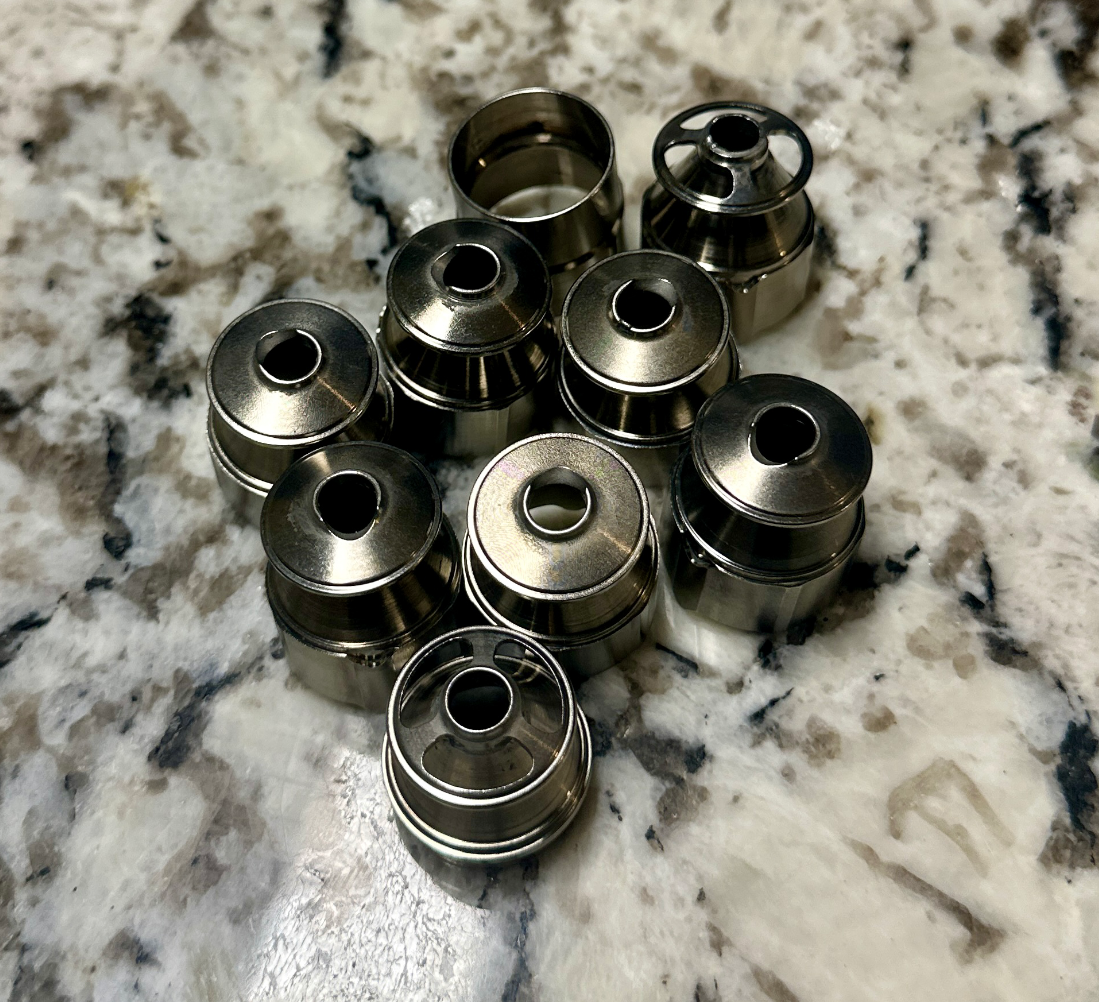

I clean my suppressors after every use. Not necessarily because it “needs it” right then, but each time it all disassembles easy and is easy to clean.
Great thread. Have been shooting a banish22 also and going through the cleaning pains and thought mine was dirty until seeing Gunny’s. Have had no luck with cleanig solutions but have not yet tried CLR. After seeing Gunny’s results, ss media has moved up the list of cleaning methods.
Gunny - do you do anything different for the baffles than for brass? I assume a bit of detergent and water?
The silencer is back at work. The CLR made the crud fall...the frick...off. Period. The baffles look like they have never seen gunshot residue.
Next time, I won't take both end caps off. There is no reason to. And I'll get a toothbrush to clean the hard grit out of the threads so the cap on the muzzle end will go back in.
